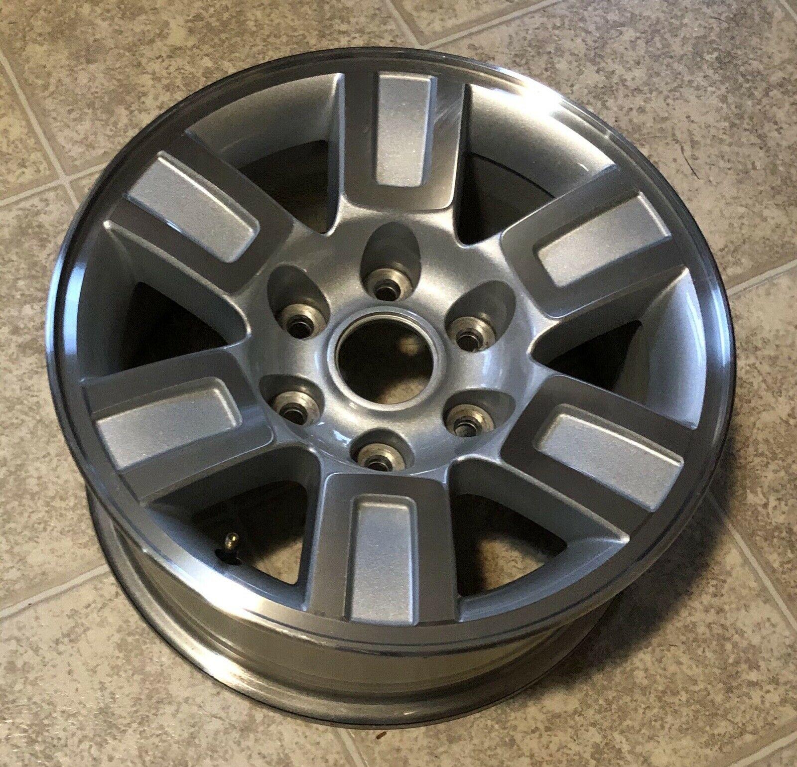

What is this wheel?
slowmachine
Jul 18, 2020
930
1,972
New Hampshire
There is an ad for a set of these on eBay, and I don't see a single photo of them anywhere else other than a classified ad on a UK website. Claims to be a 16" OE wheel for 2019-2021 Ranger, part number 9965-68-7060.

I saw those Mike, and wondered the same thing. So, I'm in for the answer also. They're nice looking wheels.

They would be excellent non-rusting winter wheels, if they actually fit our trucks.

I asked the seller to clean the back of the wheel and shoot clear photos of all of the markings. He says that he got them from “Ford, in Detroit.” Not a Ranger owner, just trying to make a buck.

FROM ranger european and asia pacific inclueded australia RANGER 3.0 L DIESEL turbo attention this rims is a large of 7" = maximum tyres 265 mm and also THE OFFSET IS + 10 mm on your ranger it's + 55 mm your external parts of rims go out 45 mm may be outside of your fender. for the bolts no probleme 6 x 139.7 (or5.5")
7Jx16 ET106x139.7
7Jx16 ET106x139.7
Thank you for this information. The seller stopped responding to my questions. ET10 will not work for me.
