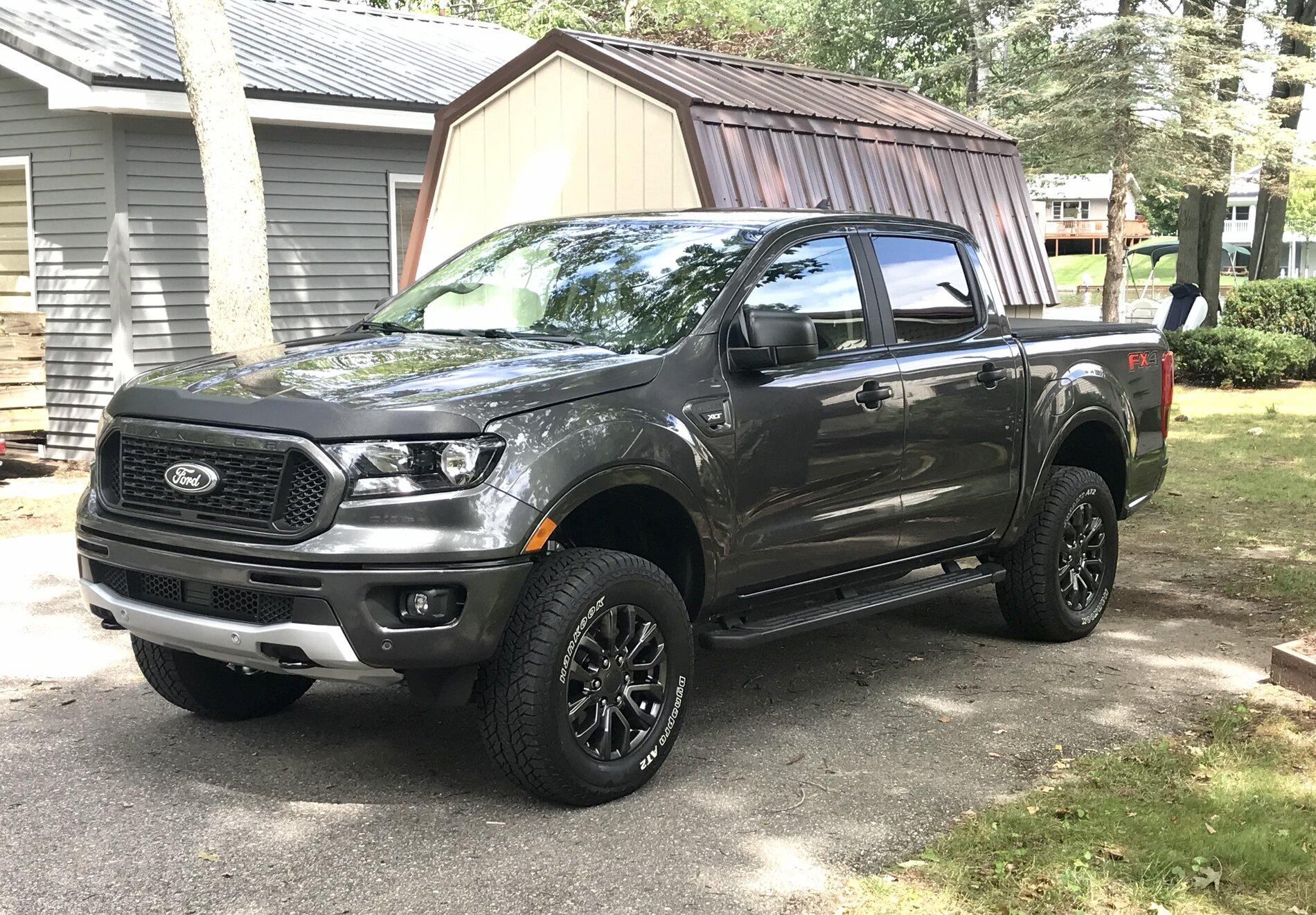

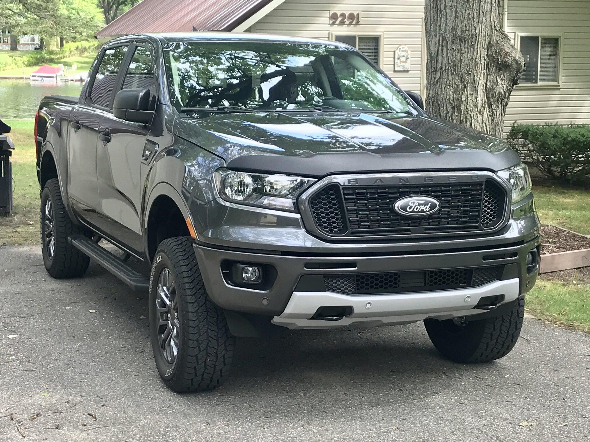

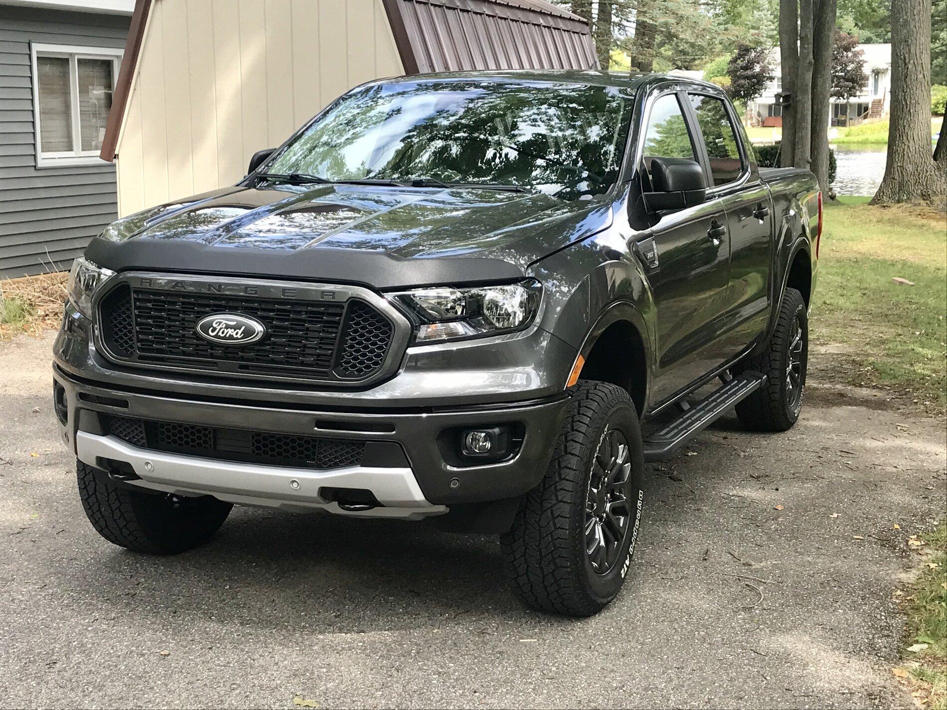

I know I posted this in the ‘General’ Section under another thread but thought it might be helpful here as well.....

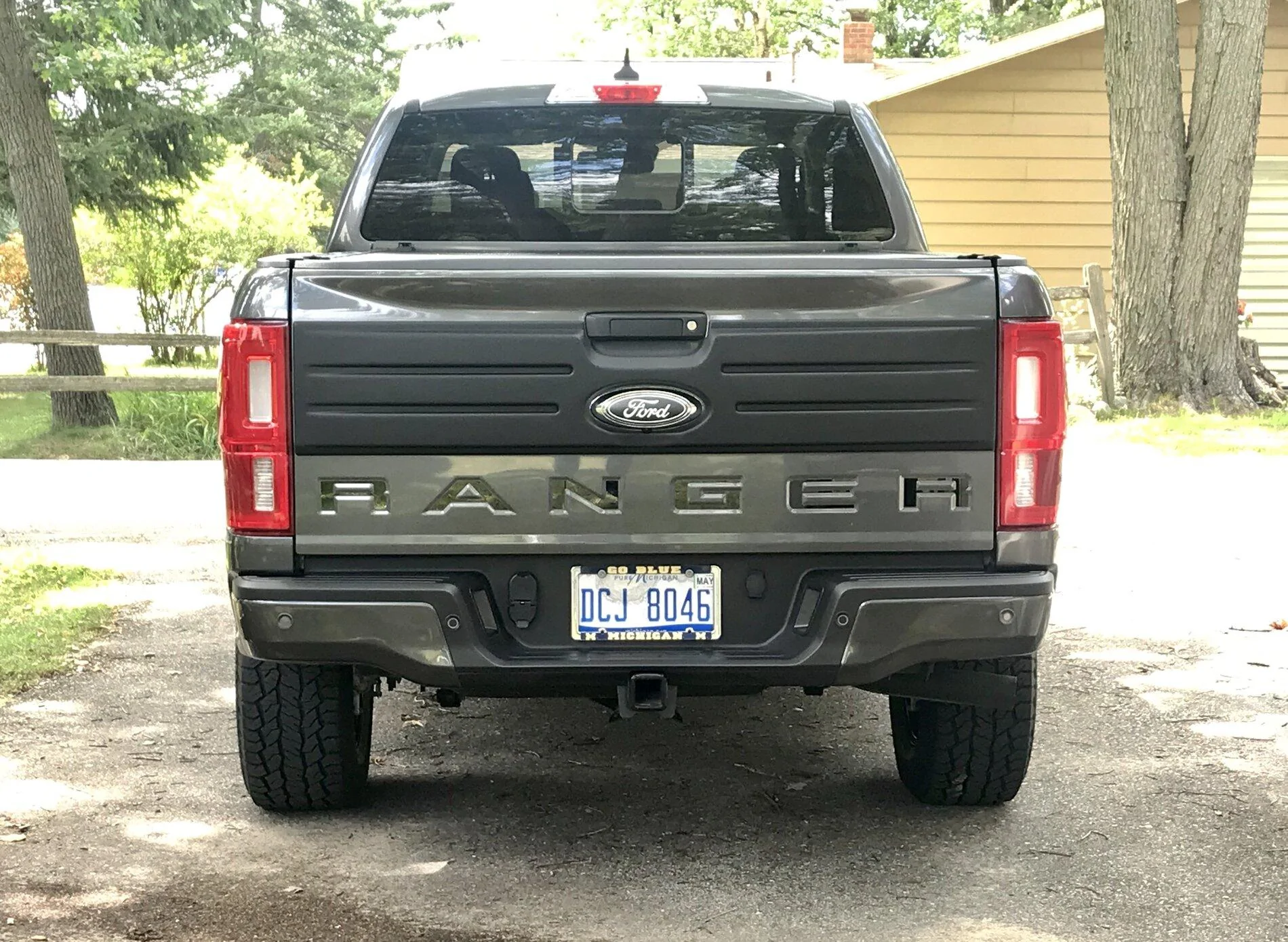

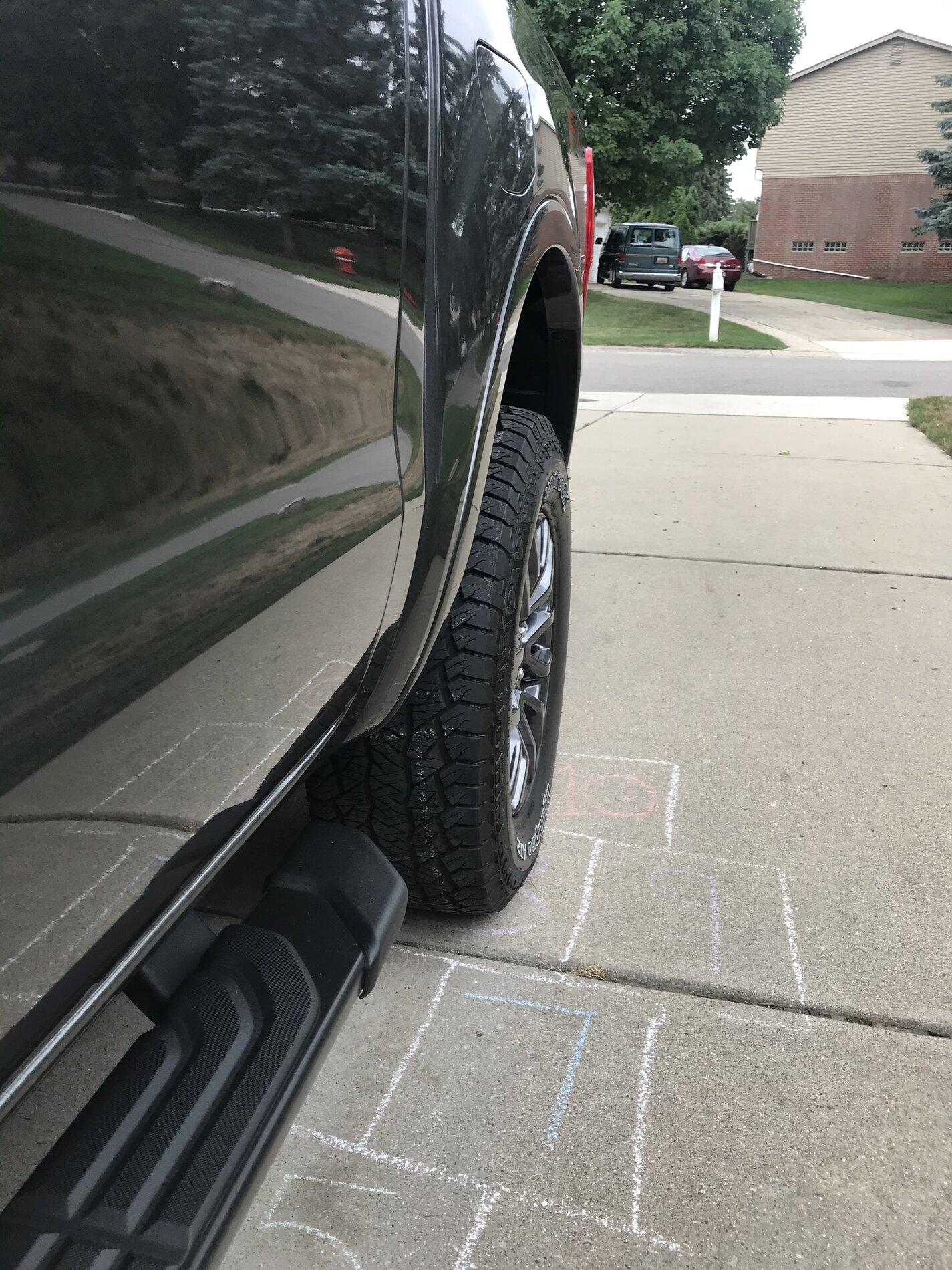

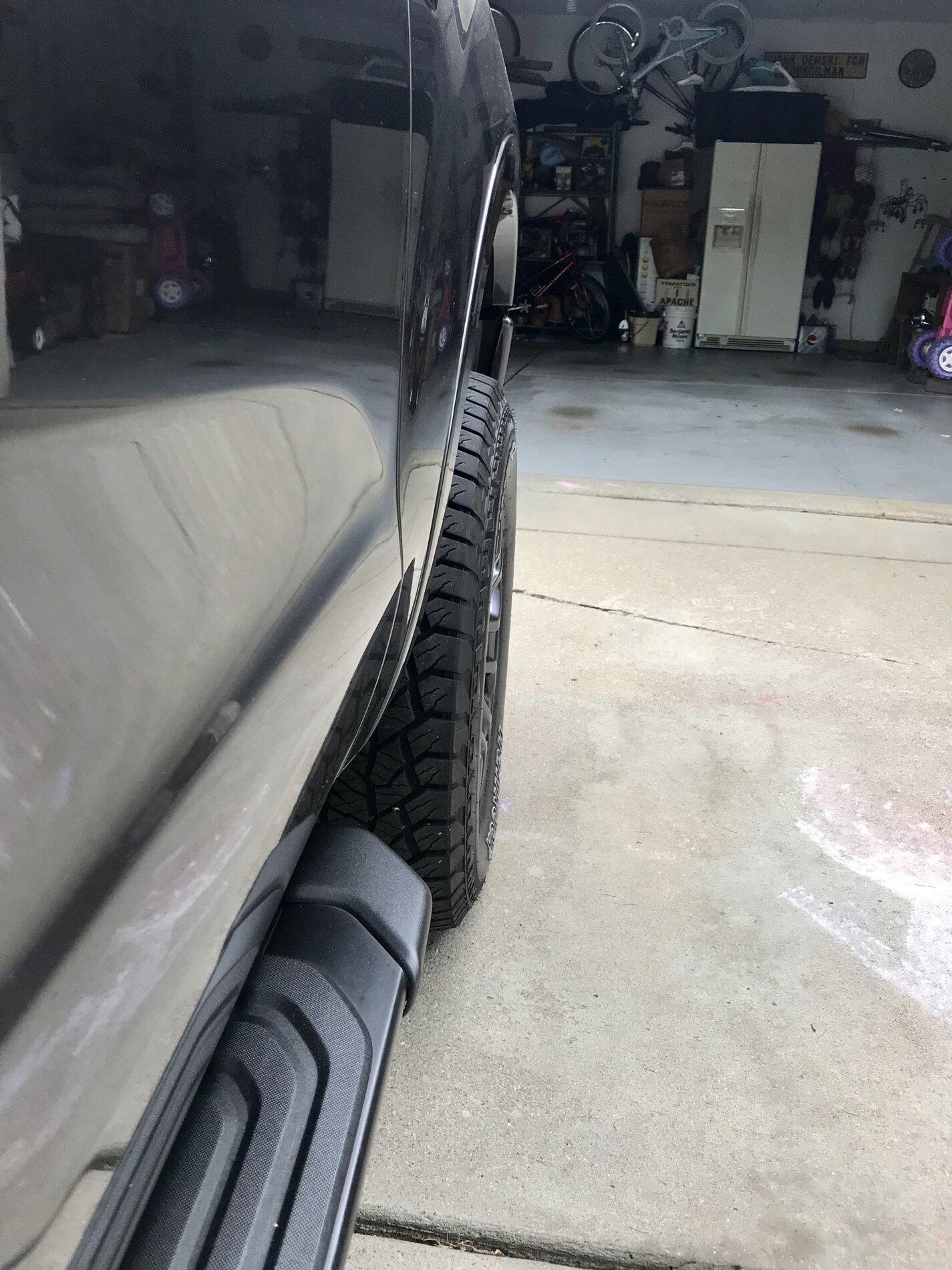

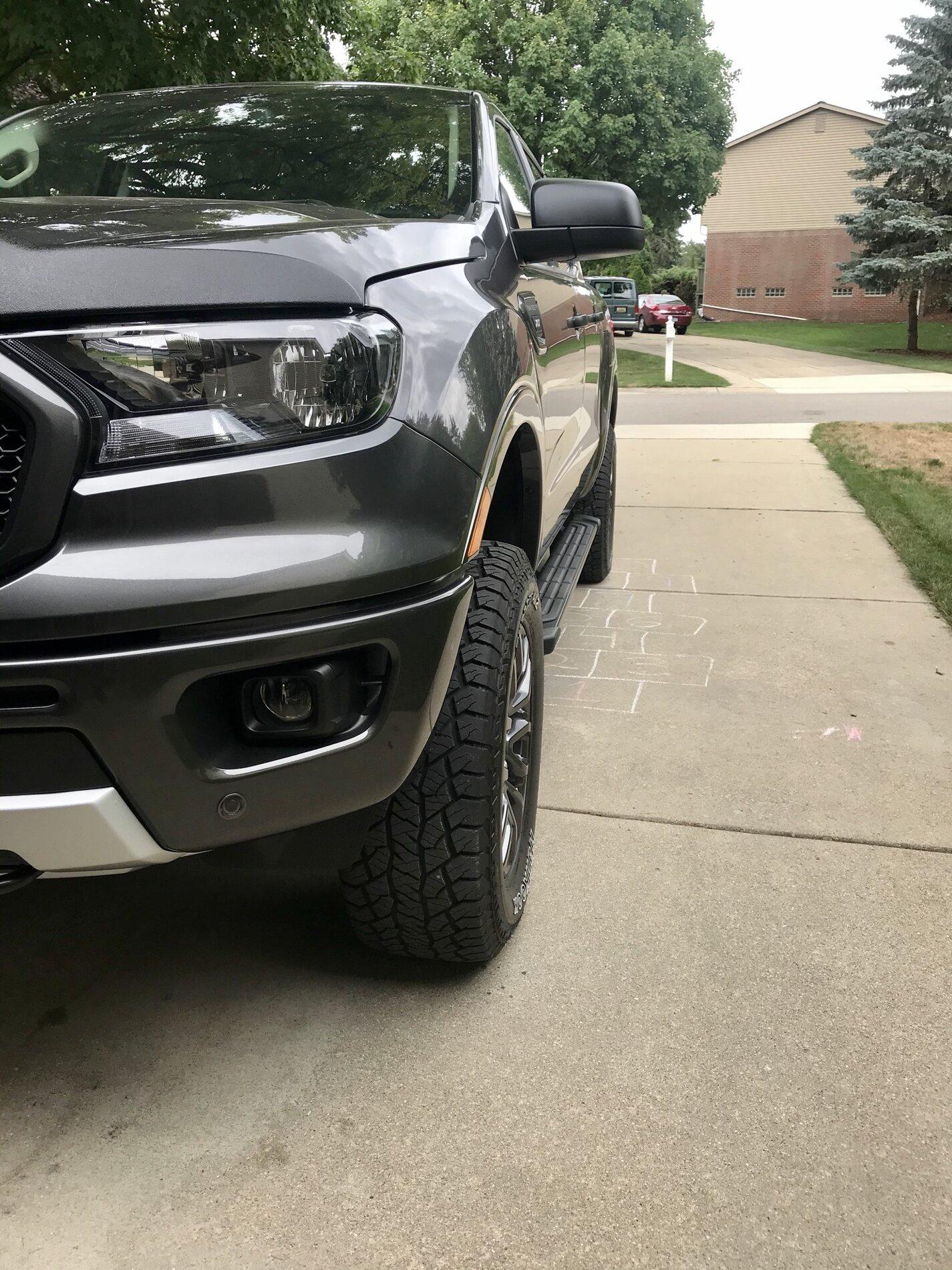

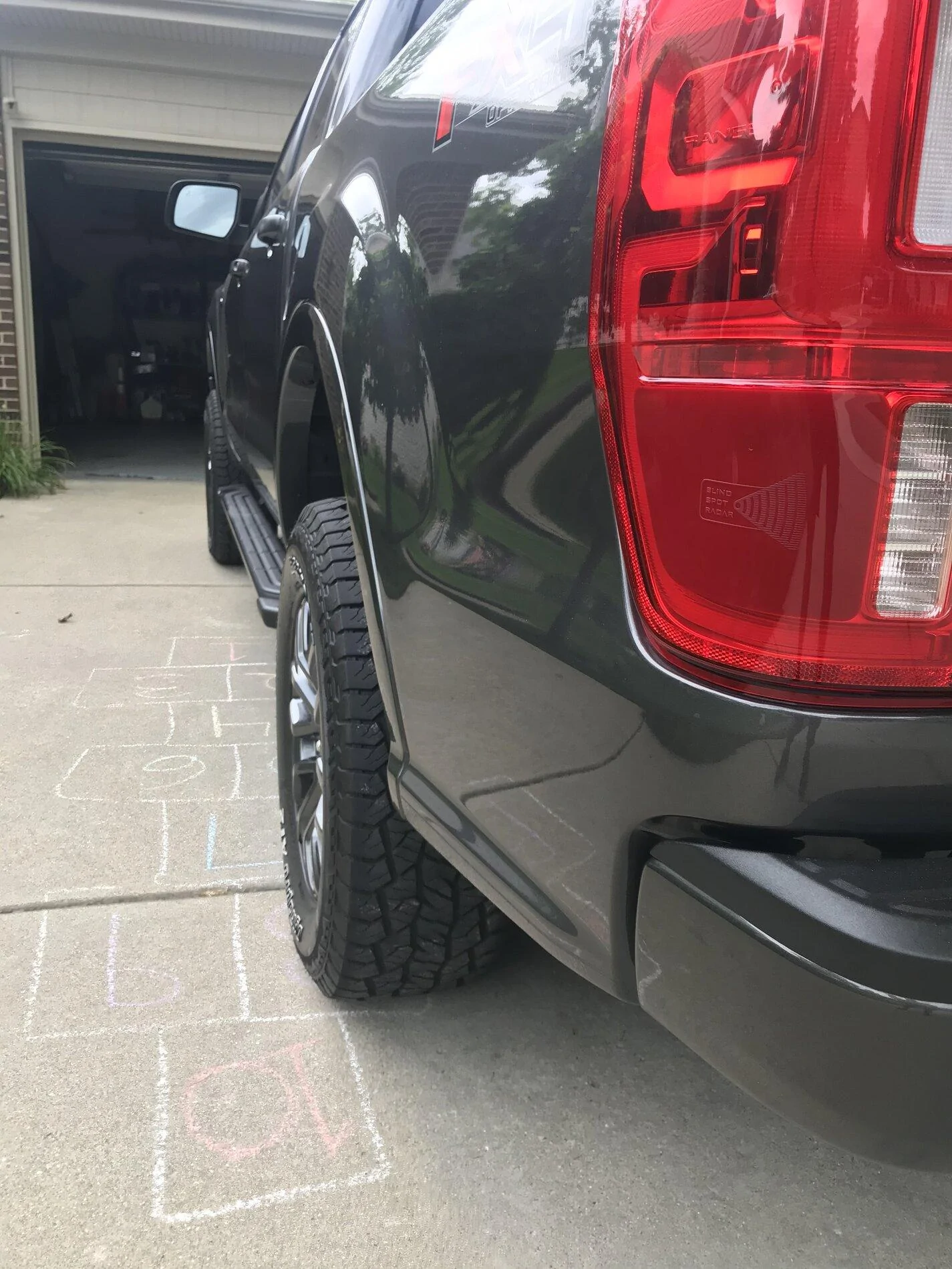

After much debate I ordered and installed Faction Fab 1 inch wheel spacers.
I was torn between these or Bora. The Faction Fab look to be high quality and all the specs seemed to reinforce that.
Ordered from Stage3 on Tuesday and on my doorstep Thursday! Kudos to Stage3.
I installed them today and wow - what a difference they make. I think the 1 inch is perfect bringing the tires out just enough - couple this with the 2.5 inch level and ‘this’ is what a Ranger should look like. I think I’ll be happy with them.....now just have to wait for the tires to wear so I can get bigger ones!

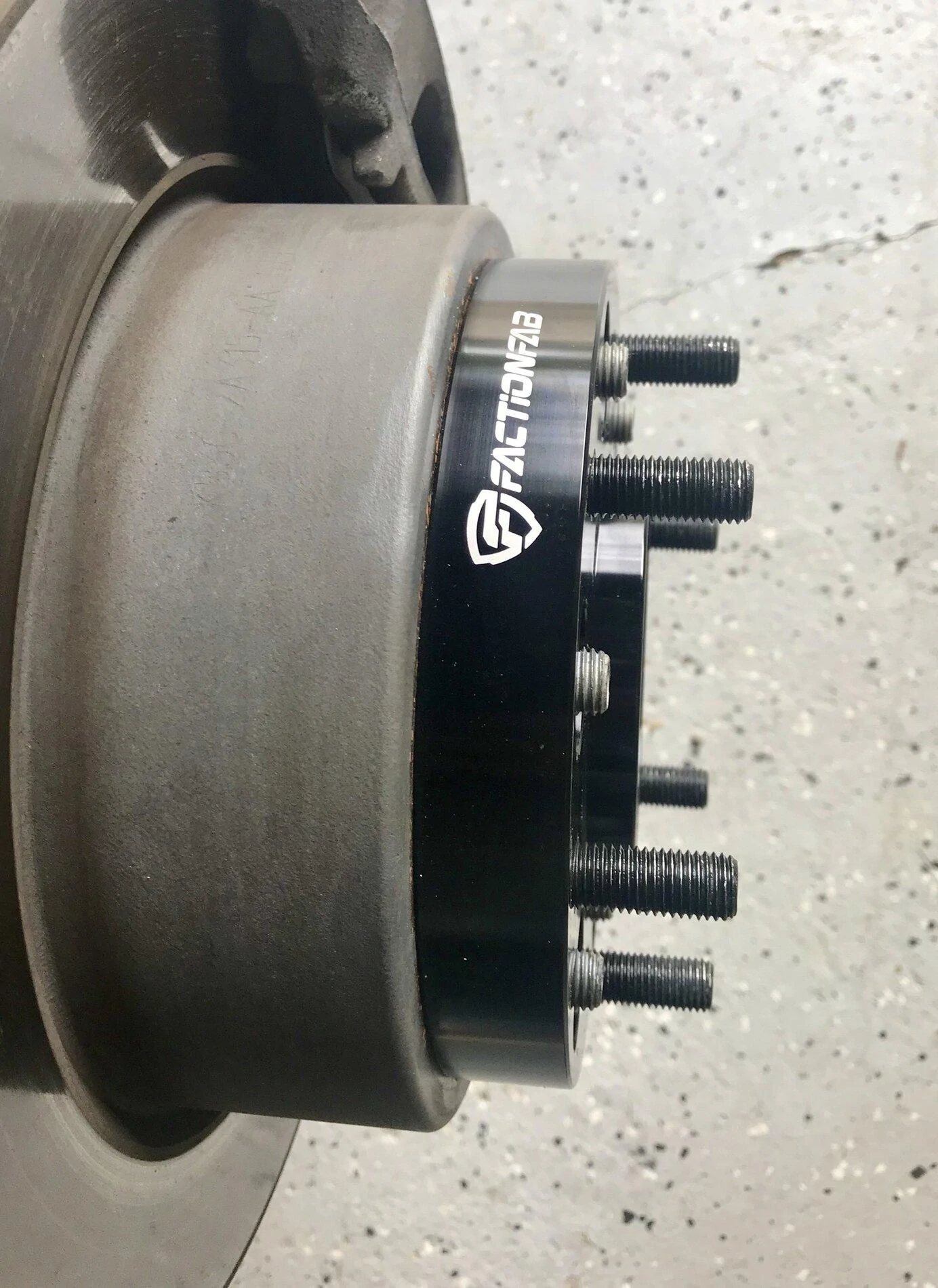

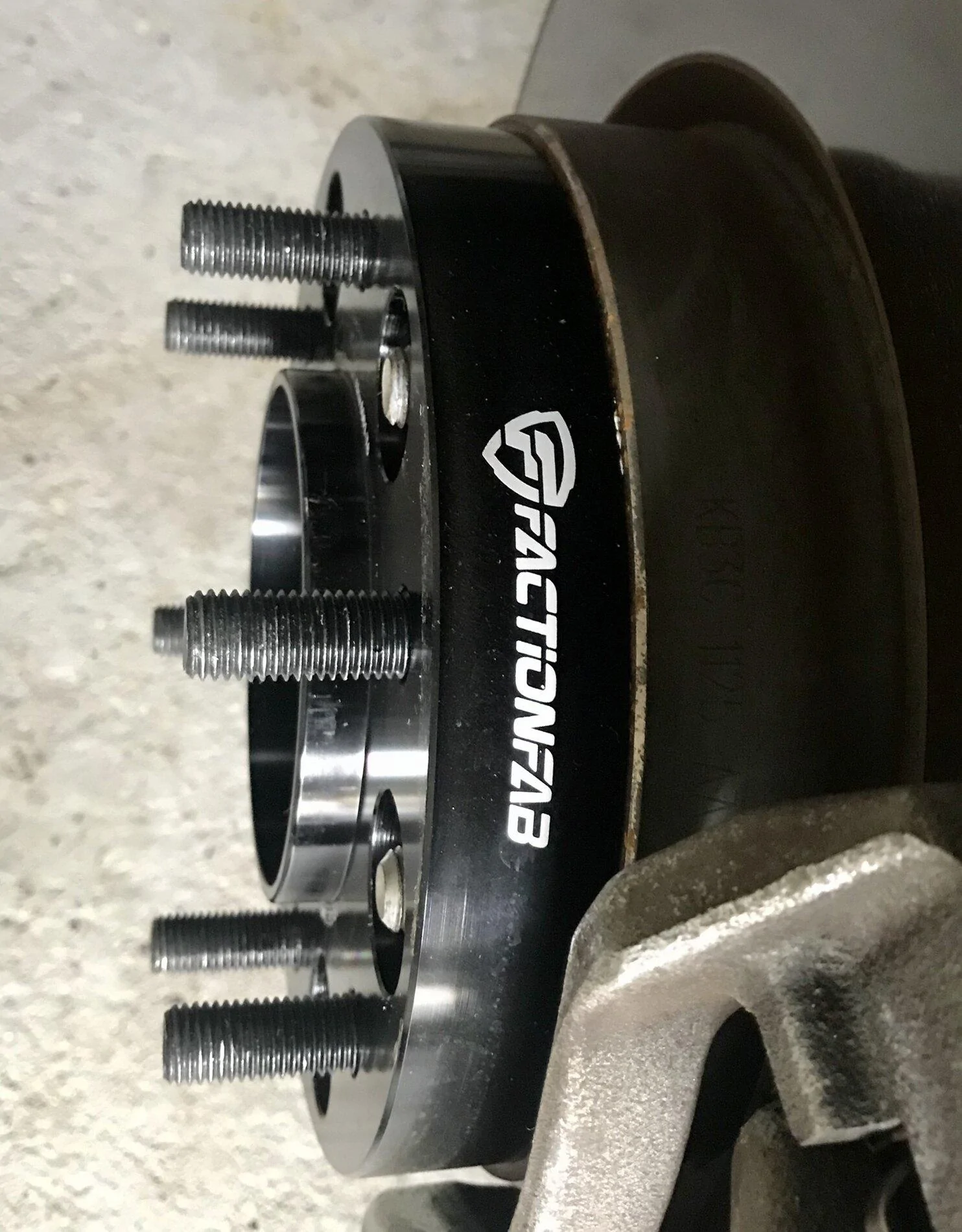

Thought I’d add this information as it might be helpful for someone looking at spacers and concerned over what size the wheels can accommodate.
Here are pictures of my front and rear hubs with 1 inch spacers.
Be aware that at least on my Ranger the rear studs are a bit longer than the front. I have no issue as the factory magnetic wheels have pockets on the backside. But....I think anything less than 1 inch (like 3/4 inch) would pose a problem and most likely require stud trimming.
