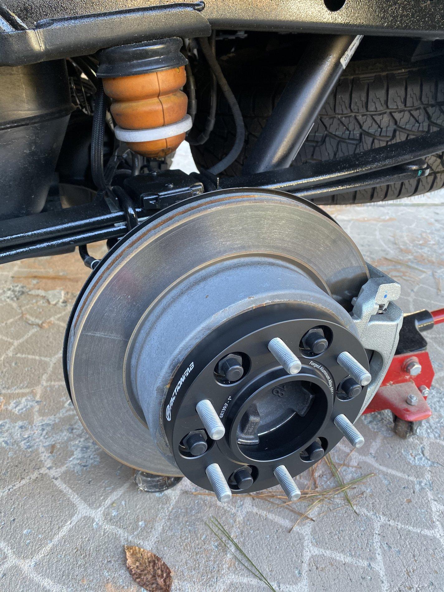

You will be good. I have the factionfab 1” spacers with my stock 17” magnetic sport wheels. The back of the rim/hub is recessed between the lug holes and everything bolts up fine. Your truck will look awesome!

I have the fab faction 1in spacers on my lariat

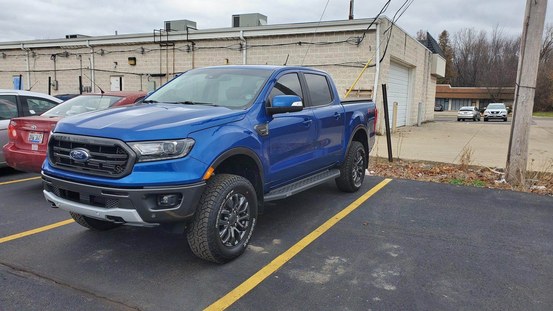

That looks better for sure. Pretty much flush with the wheel openings?
Right just need to get my nitto terra grappler g2 285-70-17 on now
