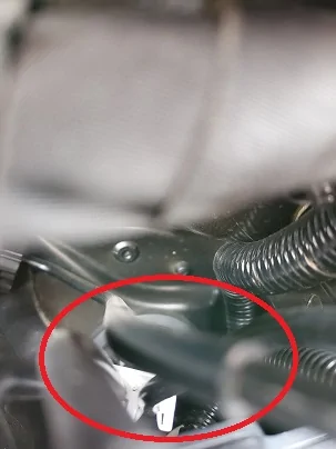

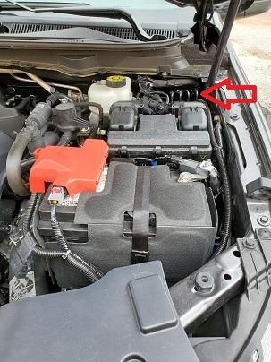

Has anyone located a good pass thru in the firewall to get some amplifier wires from the battery to the rear seat ? Pics of location access of possible
You can't really see from the pictures but there is a rubber plug on the firewall just behind the brake line manifold. There is also one in the same place on the passenger side that I pictured earlier.
wickedZ1
Ken
Nov 22, 2019
105
80
Pa
Also an access point on passenger side as well.
