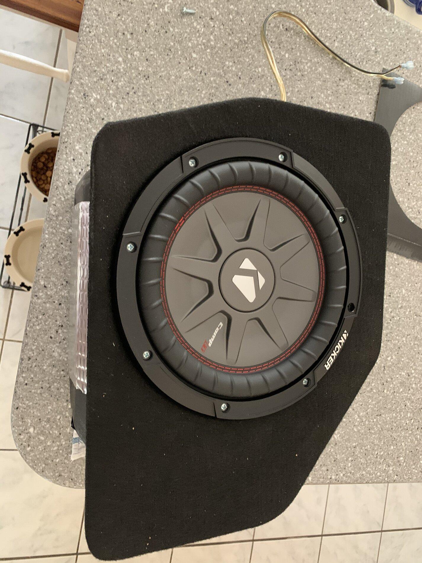

I used this box,drops right in.Bought it used,but believe it can be had from E-bay
It drops in on the passenger side under the Seat on a crew cab.
It’s a shallow Kicker,but hits nice.I’m feeding it with a Rockford 400W rms amp.
Glad to hear you like it. I've had thr box for a while. Just need to get the sub and amp ordered to install. Did you use any polyfill?
I did,and also wrapped the box with good sound deadener as it is not very thick and will flex.Wrapping it greatly improved the bass,made it hit much harder.
