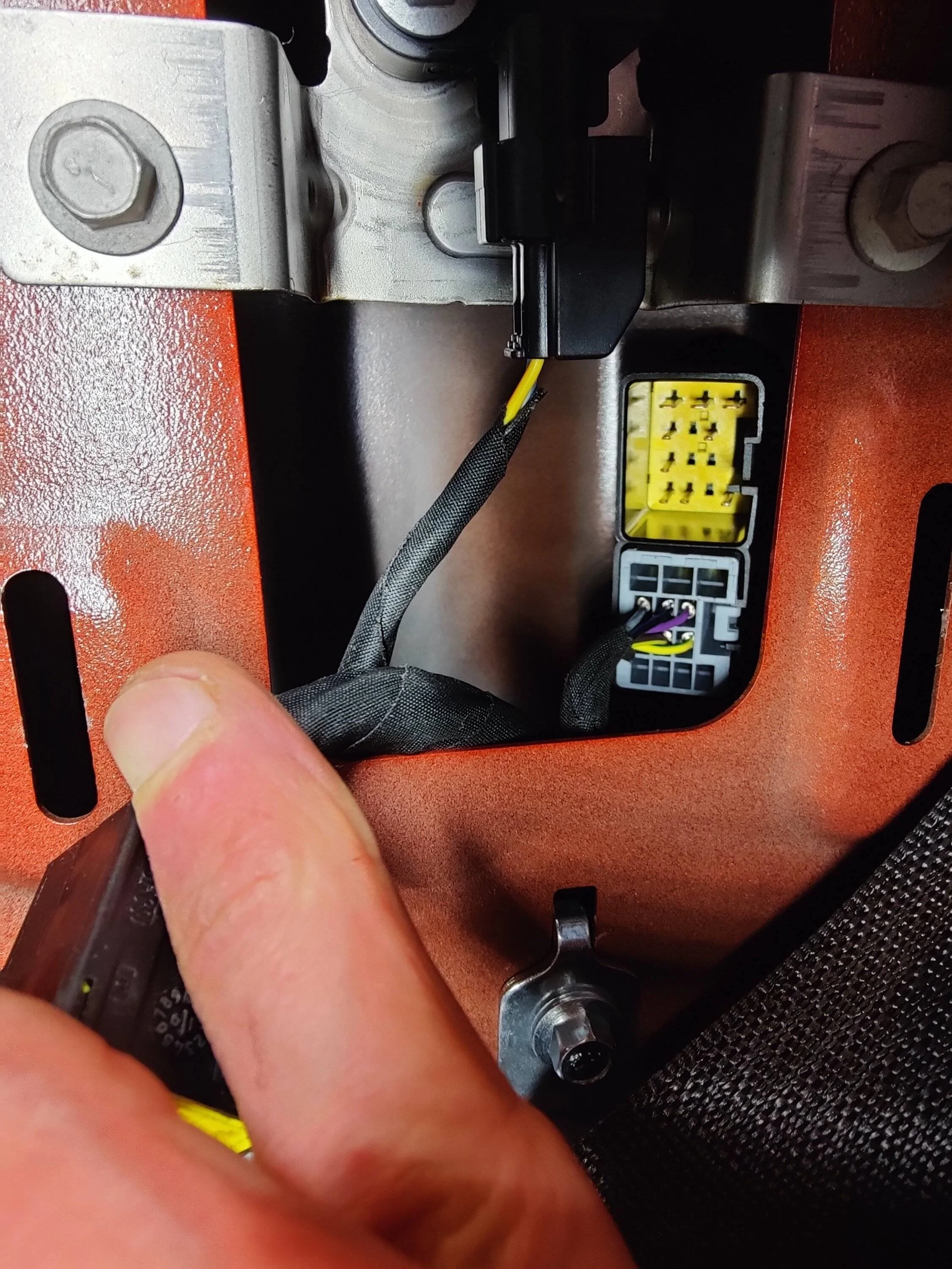

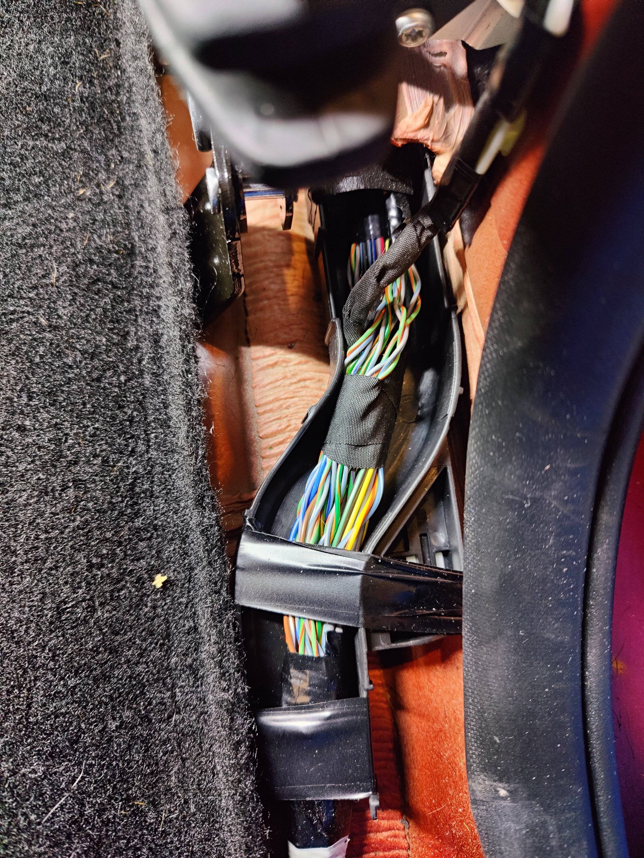

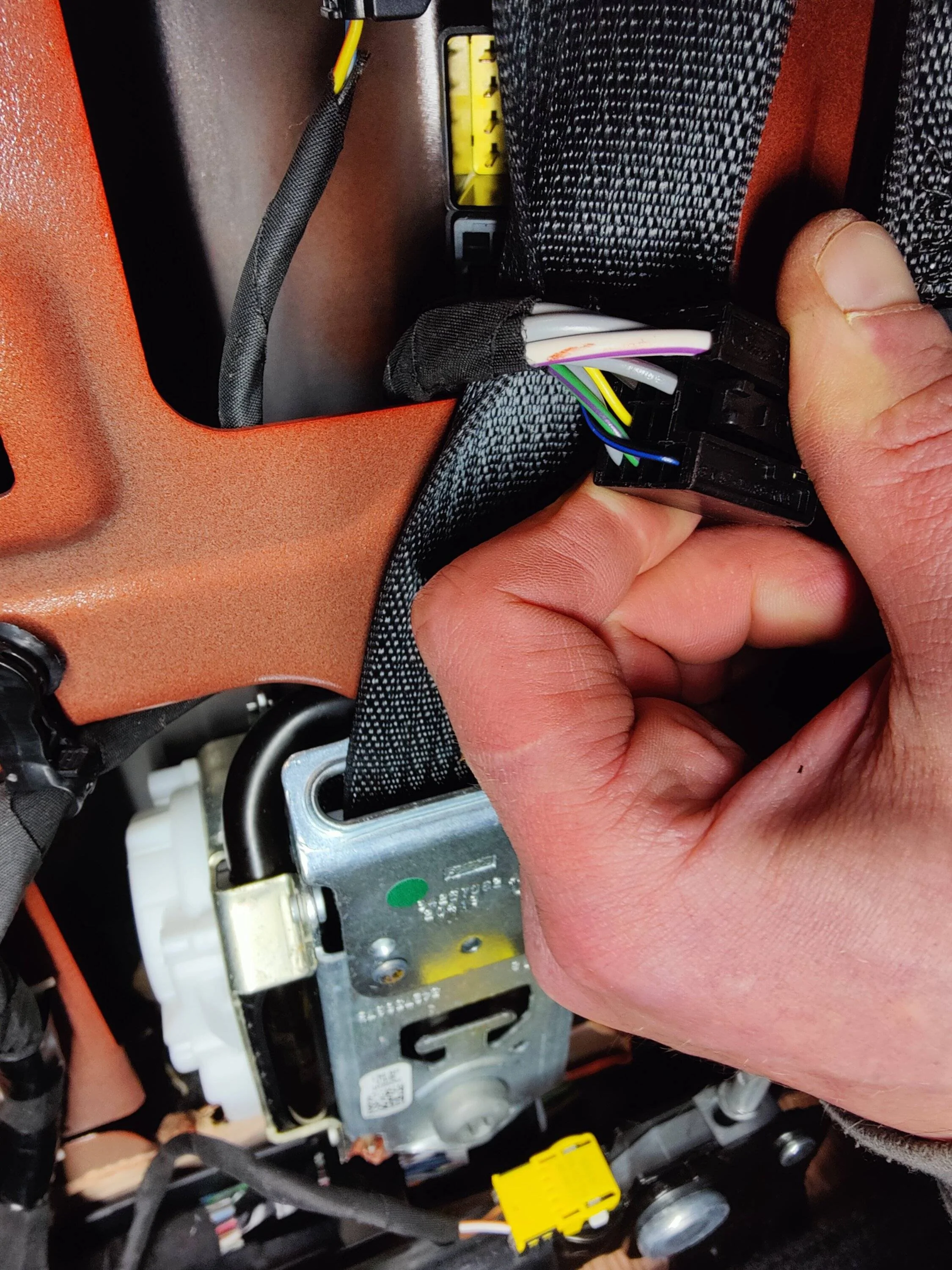

I need help locating the proper speaker wires. I removed the passenger side b-pillar and located the bundle of wires that enter the rear door, but cannot figure out which ones are for the speaker. Scouring this forum for help, I found a document (DirectWire info) someone posted that describes the wires as the following, which doesn't seem to match what I see. I saw a whole bunch of posts related to sub installations, including this model, but couldn't find any information or pictures that would help me.
Left Rear Speaker (+/-) Gray/Violet - Brown/Green
Right Rear Speaker (+/-) - Green/Violet - Gray
What are the correct wires, and can I also tap into the left rear speaker wire from this same location? it looks like the wire bundle runs along the passenger side, and could loop around to the drivers side. Or do I need to also tap into the passenger side speaker from that B-pillar? Is it just easier to access behind the head unit?

Pins 12 & 13 are speaker wires.
12 (+)
13 (-)
Edit: At both doors LR & RR - Separate

follow-up: install was a breeze with your info. Wire taps into the rear speaker wires at the b-pillar/door sills, and ran the power wire along drivers side and through the firewall right where the hood latch goes through. 2 hours.
