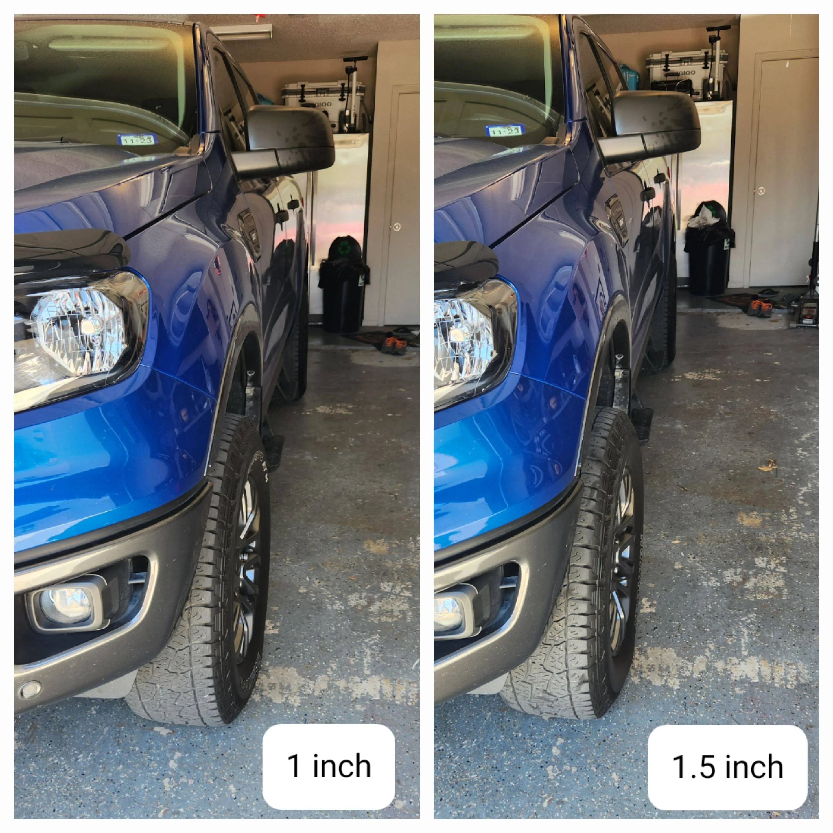

I just swapped 1.0" to 1.5". No issues with either. I have a set off FF 1" spacers for sale if anyone is interested!
