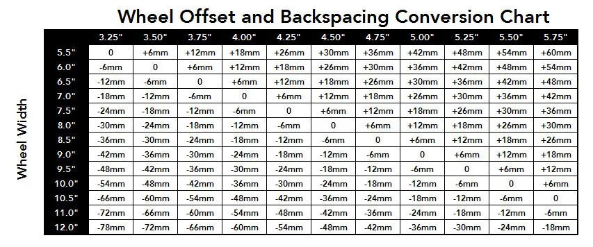

I did not hear him address backspacing - unless I missed it. I get that backspacing is just another measurement of offset. Or is it the same thing as offset?
I can find charts showing wheel width and backspacing.
So 4.50" on a 9" wide wheel = -12mm offset
So I can just say, "My wheel is -12mm offset" or "My wheel has 4.50" backspacing" and they both mean the same thing?

Back spacing is just the measurement from the mounting surface to the back of the wheel. It is something you dont have to worry about much if you already know the offset and width since you can make the necessary calculations with that.

They are 2 completely different measurements. You can calculate one from the other. For offset to backspace you need the rim width divided by 2 +or- the offset + the width of the wheel lip
Example an 8" wide wheel with +25.4mm offset(+1"offset) wheel lip of 12.7mm(.5" lip width)
8/2=4 4+1=5 5+.5=5.5" backspacing
Change to a 8.5" wide wheel with the same +25.4mm offset and it has a 5.75" backspacing so just stating your offset without the rim width and a little math tells you nothing.
Backspacing is a more useful measurement for things like spindle to wheel clearance. Say 5.5" backspaced wheel clears but 5.75" does not. A manufacture can just say it requires a maximum of 5.5" of backspace to clear. The wheel width does not matter in this instance because backspace does not change if wheel width changes.
