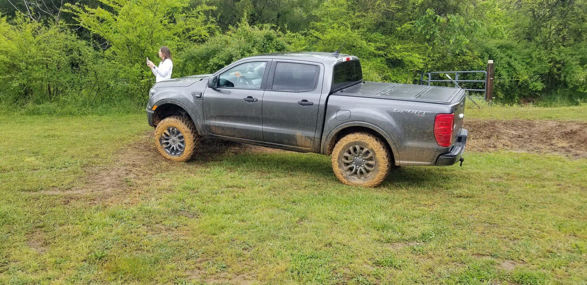

I'm running 1.5 on my Ranger. It has been offroad many times with no issues. I used some thread lock on the posts when I installed to assure bolts didnt back off. Love the look. Beware 1.5 sets tires out about .25 of an inch. Which through mud and road debris on side of truck. At least with mud tires haha.

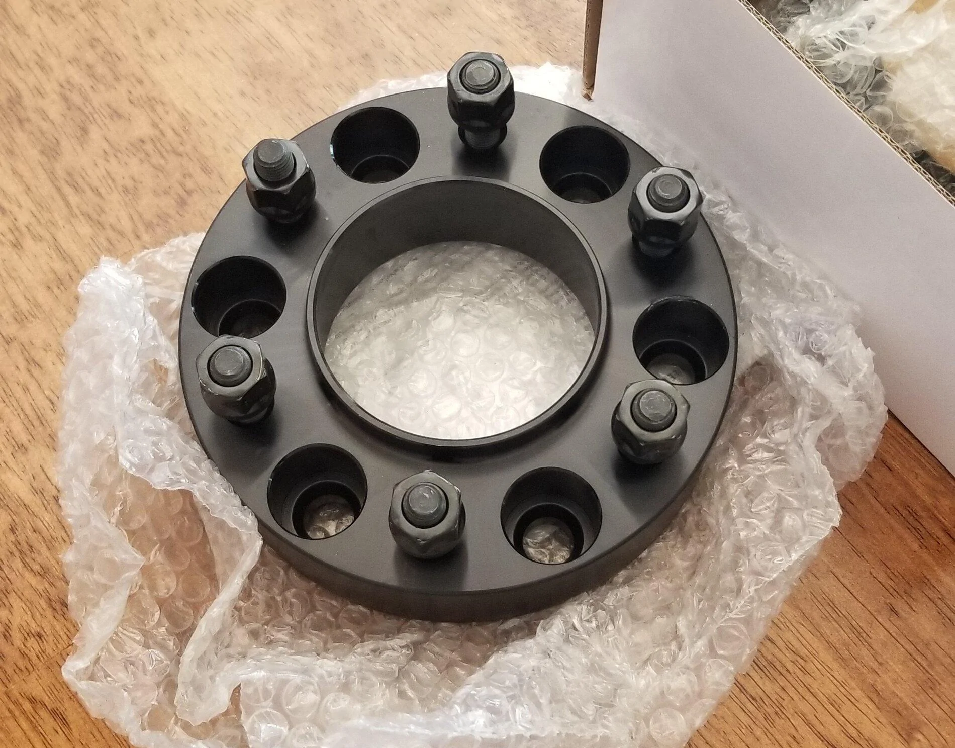

The spacers have a few concerns. First and most important is thread engagement...Or how many threads does the lugnut engage with spacers vs what the lugnuts engage Stock. Ford does not have a minimum engagement spec, but does say that on exposed threads that there must be three threads visible as they may be imperfectly formed. So if you have spacers that only engage three threads on the lugnuts...JMO...you are on thin ice. I guess if the lugs can take 100 ft-lbs you are likely okay. Again, JMO.
I do not like spacers, but many folks here have run them at different thicknesses and let these folks comment on if you are okay with 1.25" spacers.
