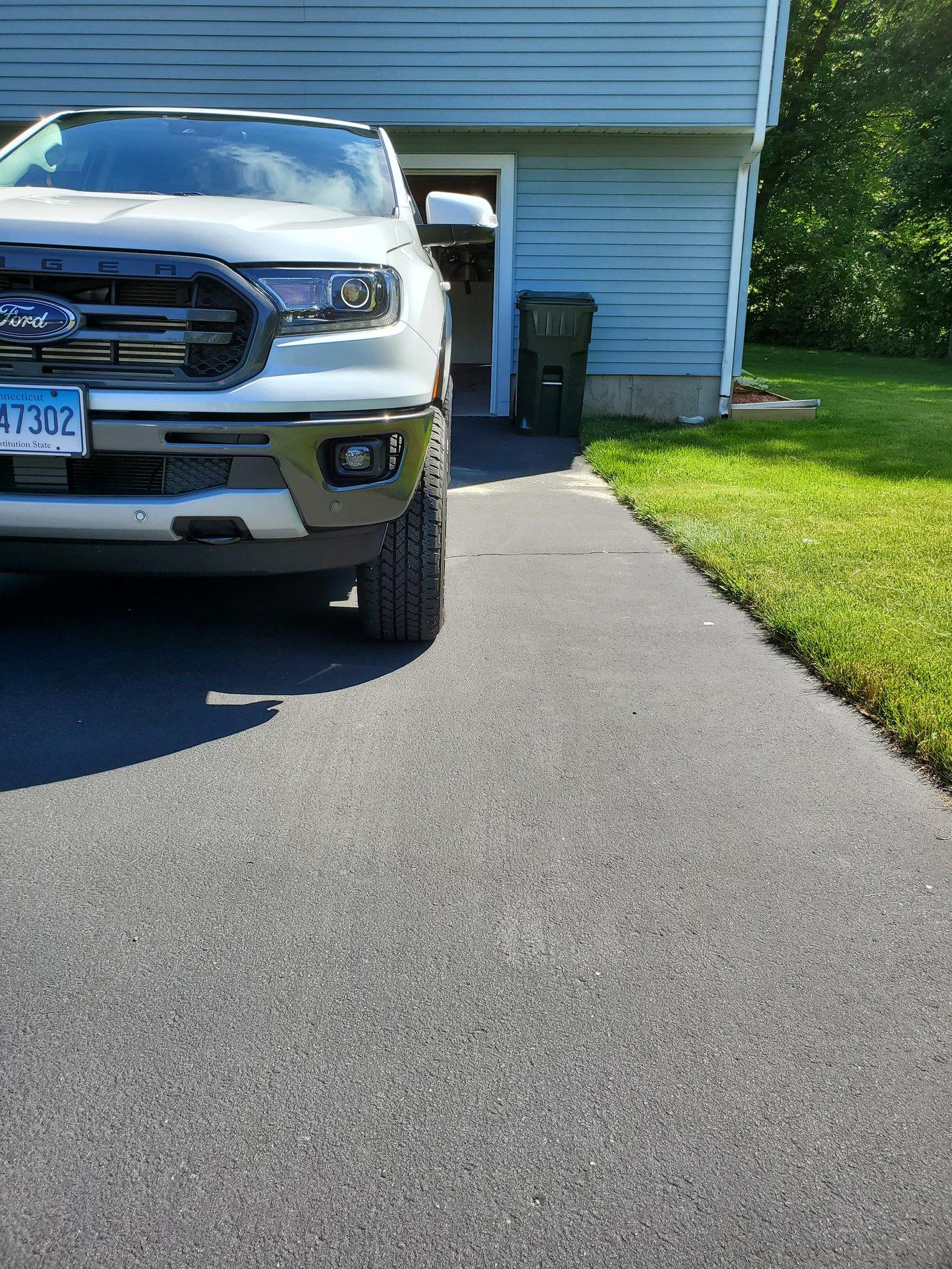

I run stock tires, and after my leveling kit, I was looking for a wider stance. I went with 1.25" Bora from Stage 3. Hub centric as well. The handling is better as well.

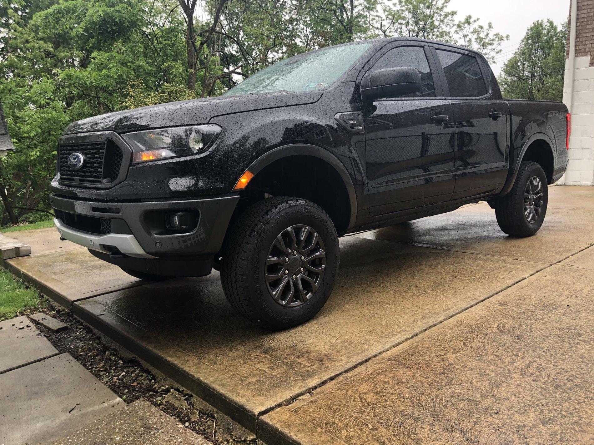

Do you have any pics of it you could share?

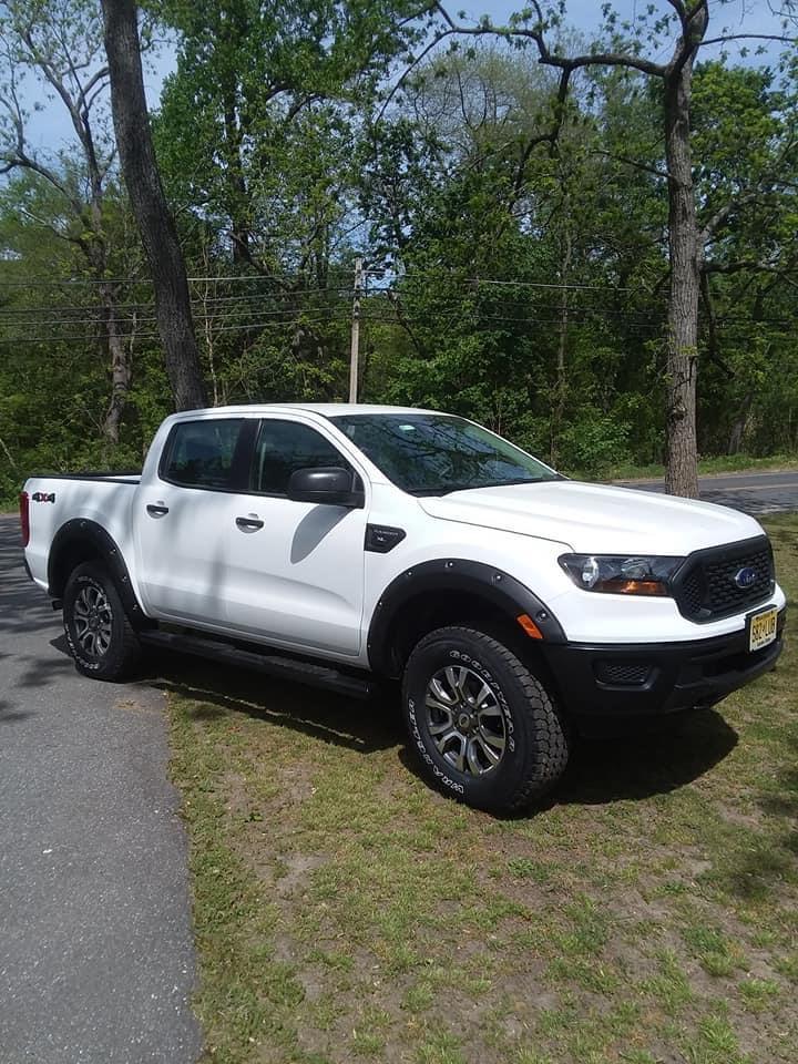

That makes sense. What size/brand tire and spacers are using running?
I went with a 1 inch spacer. Bora is the brand. I wish I would have went with a 1.5 to be honest. My tires are Goodyear wranglers. 275/70r18. The 33 inch tall tires give the truck some attitude without being noisy. These ride like stock.

First responder
That looks good. Thanks for sharing.

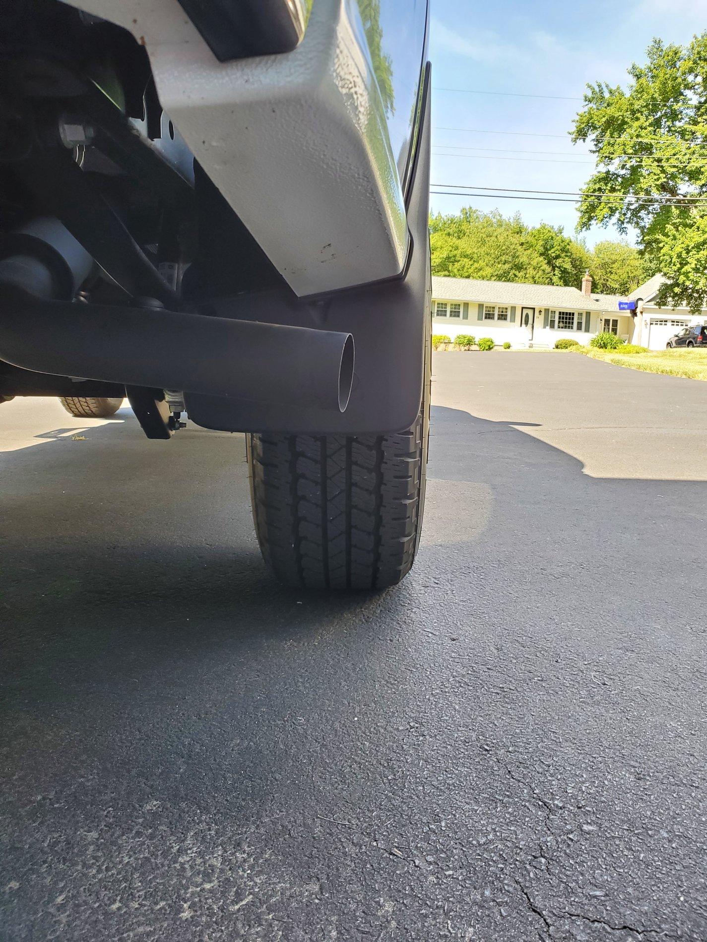

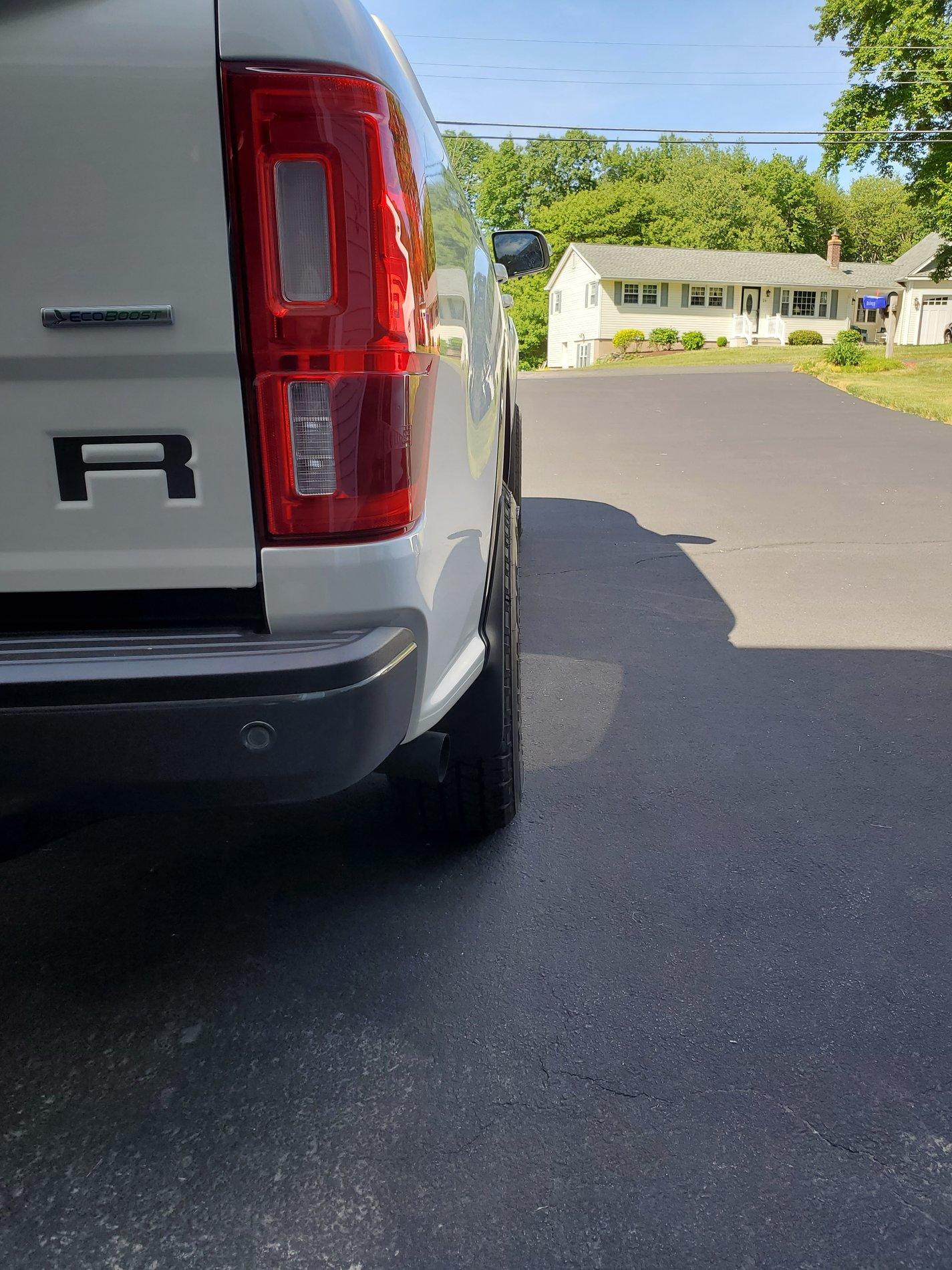

My original thought was 1.5" Bora's, but glad I went conservative with 1.25" The tread still stays behind the mudflaps, limiting the amount of spray down the side. I guess you could easily find a mudflap to cover the tread though. I liked the look of the ford molded flaps.

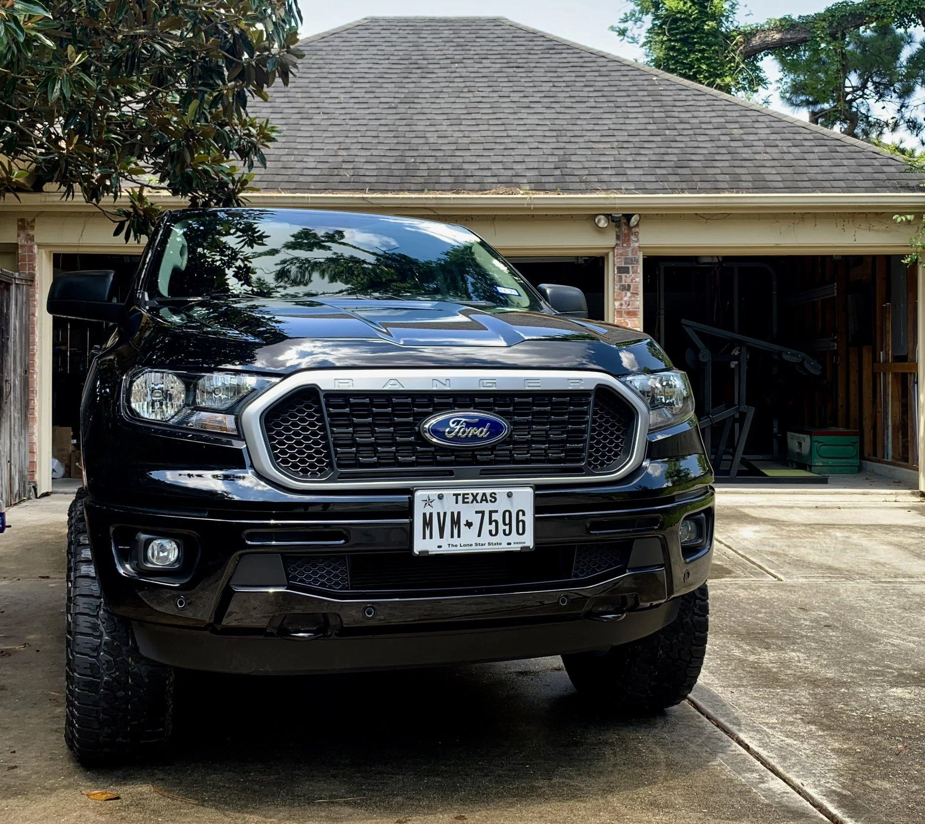

1.5 spacers on 265/70/17. Removed plastic from crash bar, adjusted crash bars. 2.5 level.
Not to hijack the thread, but looks like my build is going to look about the same. 2.5” BDS level and have been debating some FactionFab spacers, been back and forth between 1” or 1.5”. Been debating between tires too, Terra Grappler G2’s or Toyo OC AT3’s the same size as yours...
