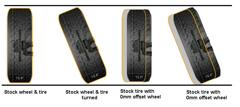

Adding spacers is like moving to a lower offset wheel. Stock offset is +55mm. Adding a 1.5 inch spacer is like moving to a +17mm offset wheel, which sticks the tires out and allows for wider tires to clear the knuckle - it’s a lot of “poke” but you might push your tires out to the point where they hit the crash bars at full lock. Here’s what I mean......
The lines in the image below represent the crash bars - the shaded tires on the right are in the pushed out position.
You want to avoid that.
