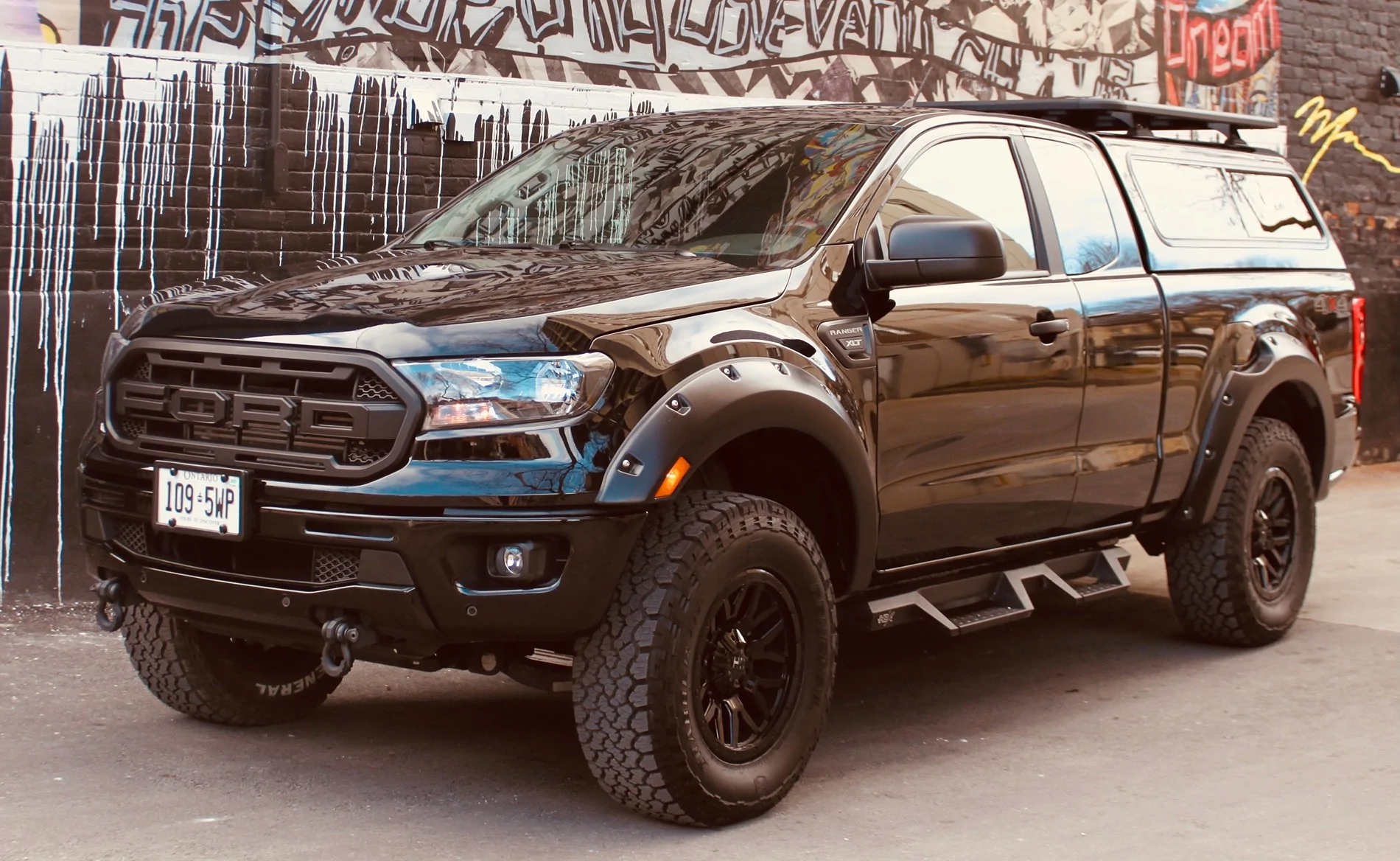

My wheels are from a Canadian company so that won’t be much help but they have a +15mm offset and I run 275/70R17 General Grabbers. My setup includes Fox shocks set at 2” and ReadyLIFT crash bars.
The tires perform well in all conditions and wear well. My offset creates a bit of poke but I usually have fender flares that keep stones at bay. If you can’t find 285s in the tire you want, 275s are still plenty big.
Without Fender Flares - an inch or more of poke
275/70R17 vs. OEM (255/65R17) - still quite big

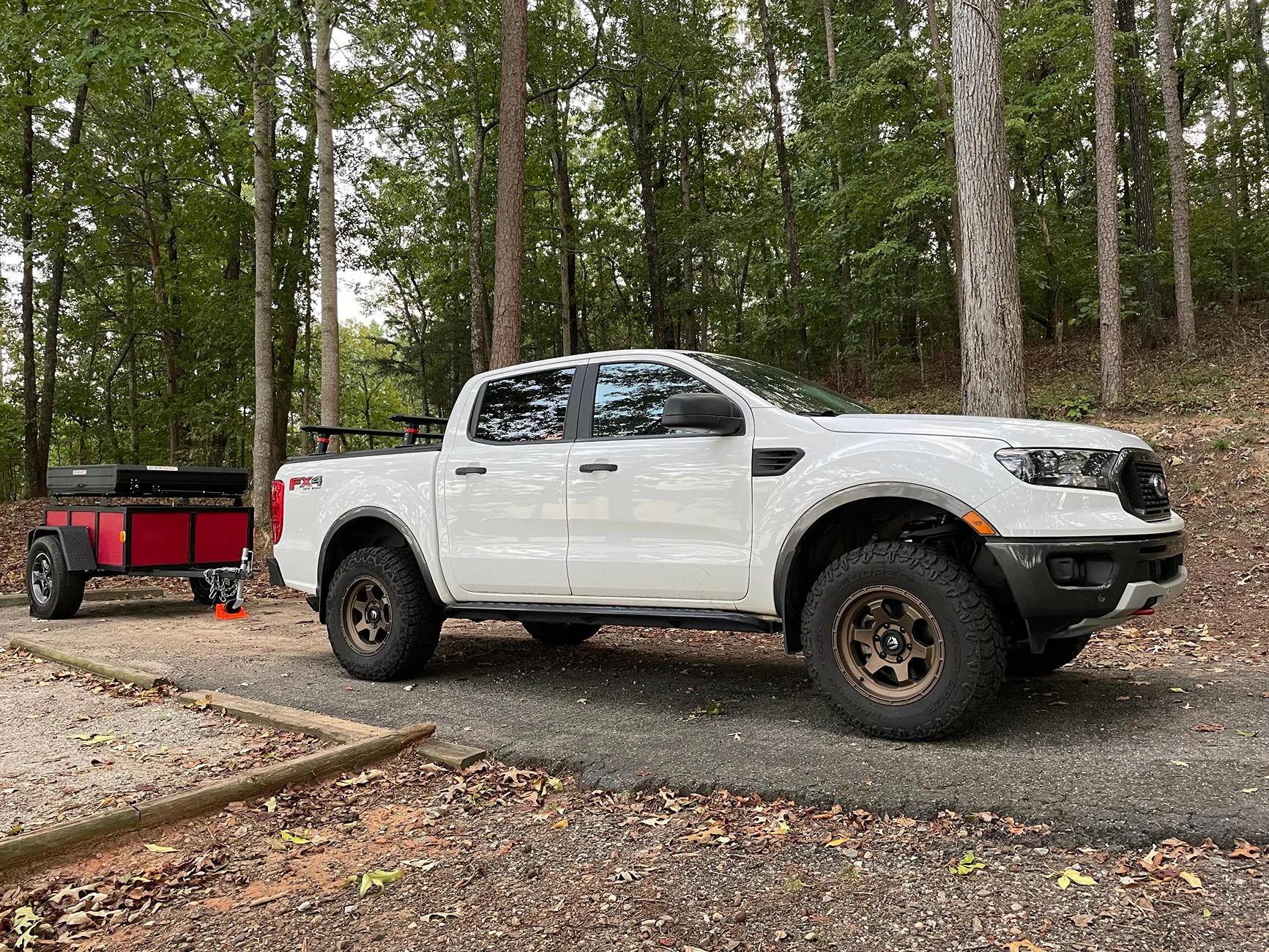

I'm running 265/70/17 tires on bronze Fuel Shok in 17x9 with a +20 offset.
Bilstein 5100 set at 1.8. Still factory crash bars and no rubbing.
The rear has Tremor leafs so a slight lift there.
And here is the "poke".
Excuse the red square where I used this image to point out the ACC sensor.
