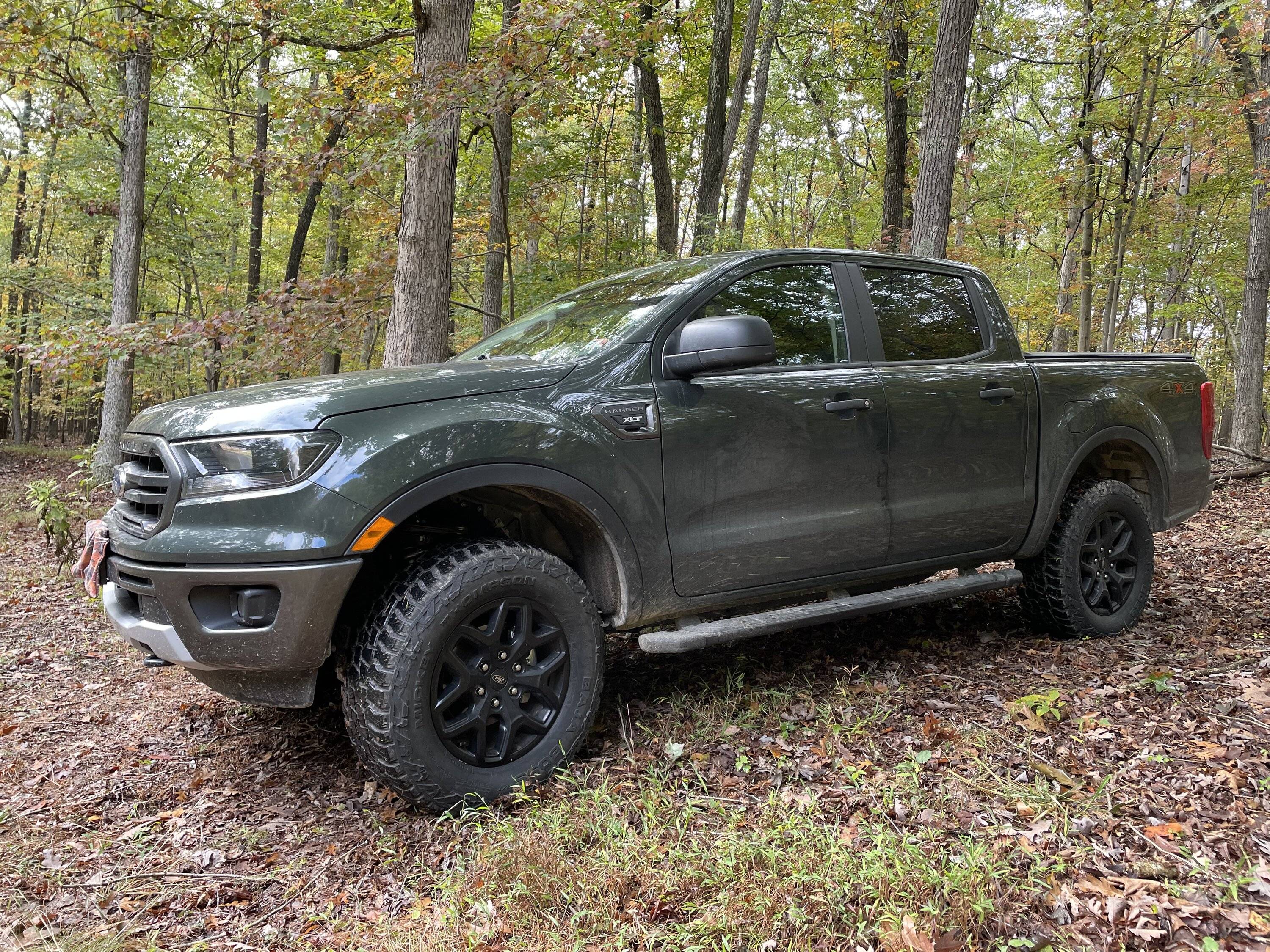

updated photo
Looks sharp. Any chance you could take a pic down the side of the truck? I'm considering something similar....but probably 285/65. Mine's not leveled, but I'm probably going to add Bilstein's or Rancho's all the way around and lift the front slightly at the same time that I get the tires. I have a feeling it will feel like a different truck!

Thank you , i'll send a photo of the side, i am looking to add a small spacer like a 1/2" as its pretty close to the guts. As far as the ride is concerns the Fox kit has made the ride great. A lot better than stock.
