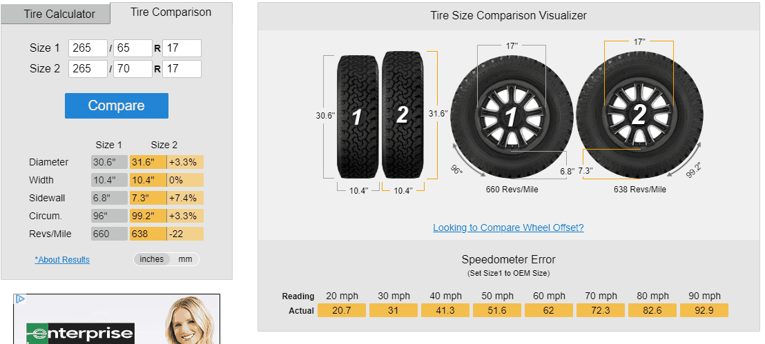

My dealer just gave me the run around too. So I resorted to Forscan. So with the bigger tires your speedo could be reading low. About 3.3% in my case. If that made the difference in getting a speeding ticket or not. You could have paid for the Hypertech.
