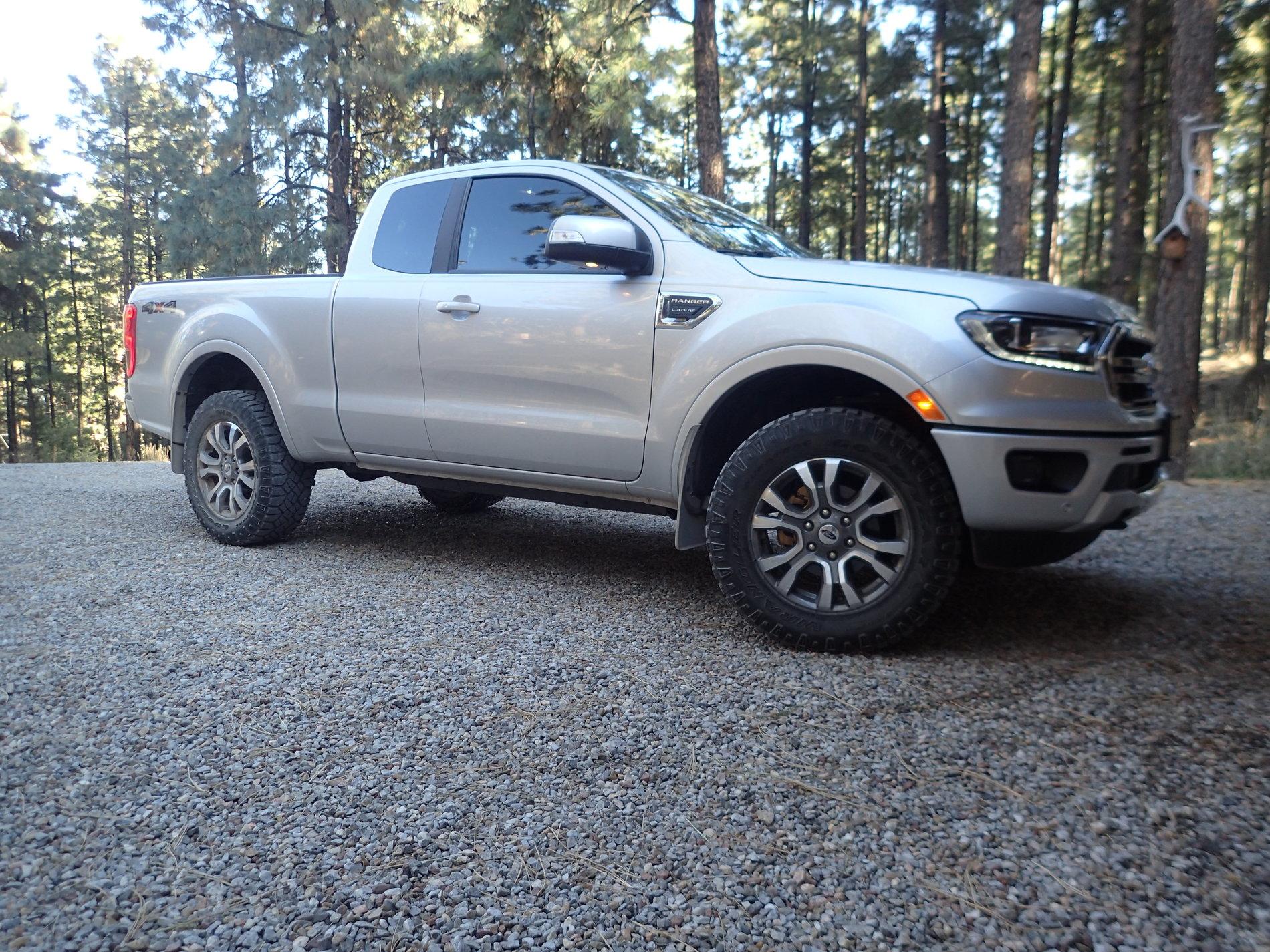

I have Nitto Ridge Grapplers 255/80/R17 tires. Measure 32 5/8" tall. My speedo according to a GPS speed app is off by the following:
Speedo MPH - GPS MPH - Difference
40 - 44 - +4
45 - 50 - +5
50 - 56 - +6
60 - 66-67 - +6-7
65 - 72-73 - +7-8
70 - 78 - +8
80- 88-89 - +8-9
90 - 98-99 - +9
Sometimes it bounced between two speeds thus the two numbers.
Has anyone used a tuner to adjust for larger tires? If so, what brand? SCT says no such luck and no timeframe for when they will be able to.
I mount a set of 275/65R18 Goodyear Wranglers in place of stock 265/60R18s during our brief New Mexico winters and worry about our local fastidious PDs through our village and nearby pueblo. So, I used a GPS to figure out that I must add one mph through 35, two through 50, and three at 70+.
So far, so good.
