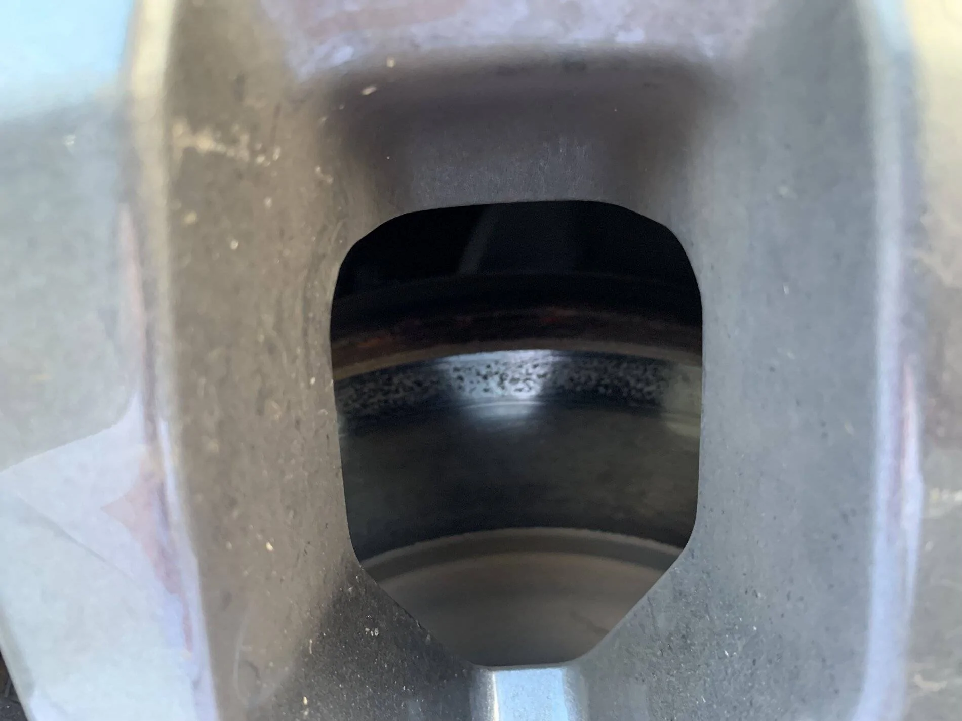

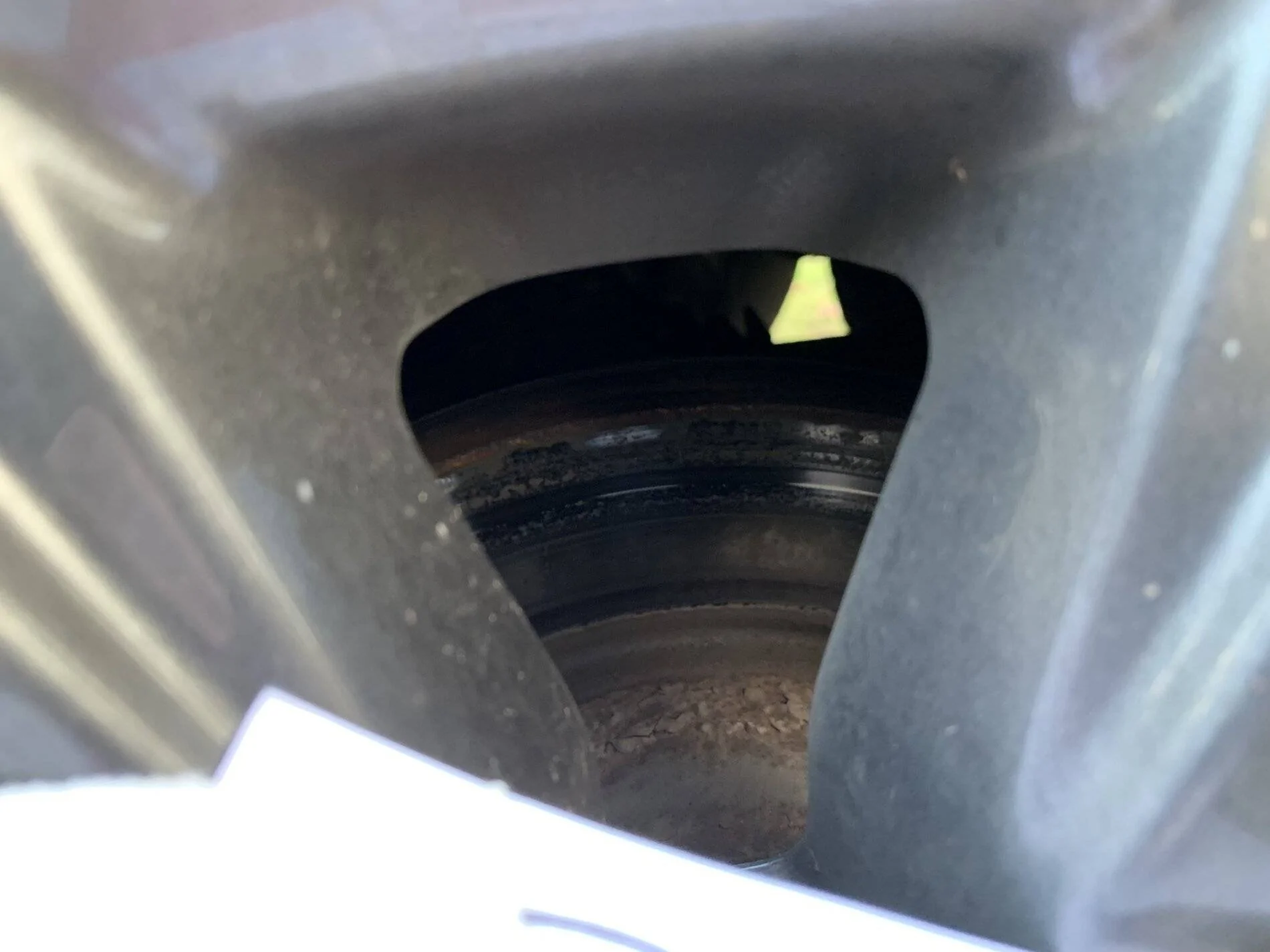

I was just at the Dealer for an oil change (25K). They said my pads were down (need to verify) and the rotors are scored, see photos. Autozone has some coated rotors and pad, nothing in stock locally, but looking like ~$500+ for all four corners. Not sure if I can get the rotors turned, that would certainly help with the cost. Will take a look at Rock Auto. They have been hit or miss (mostly miss) with various brands on any longevity for my Honda Odyssey, terrible design. For what it's worth my 09 Tacoma brakes lasted ~75K!
