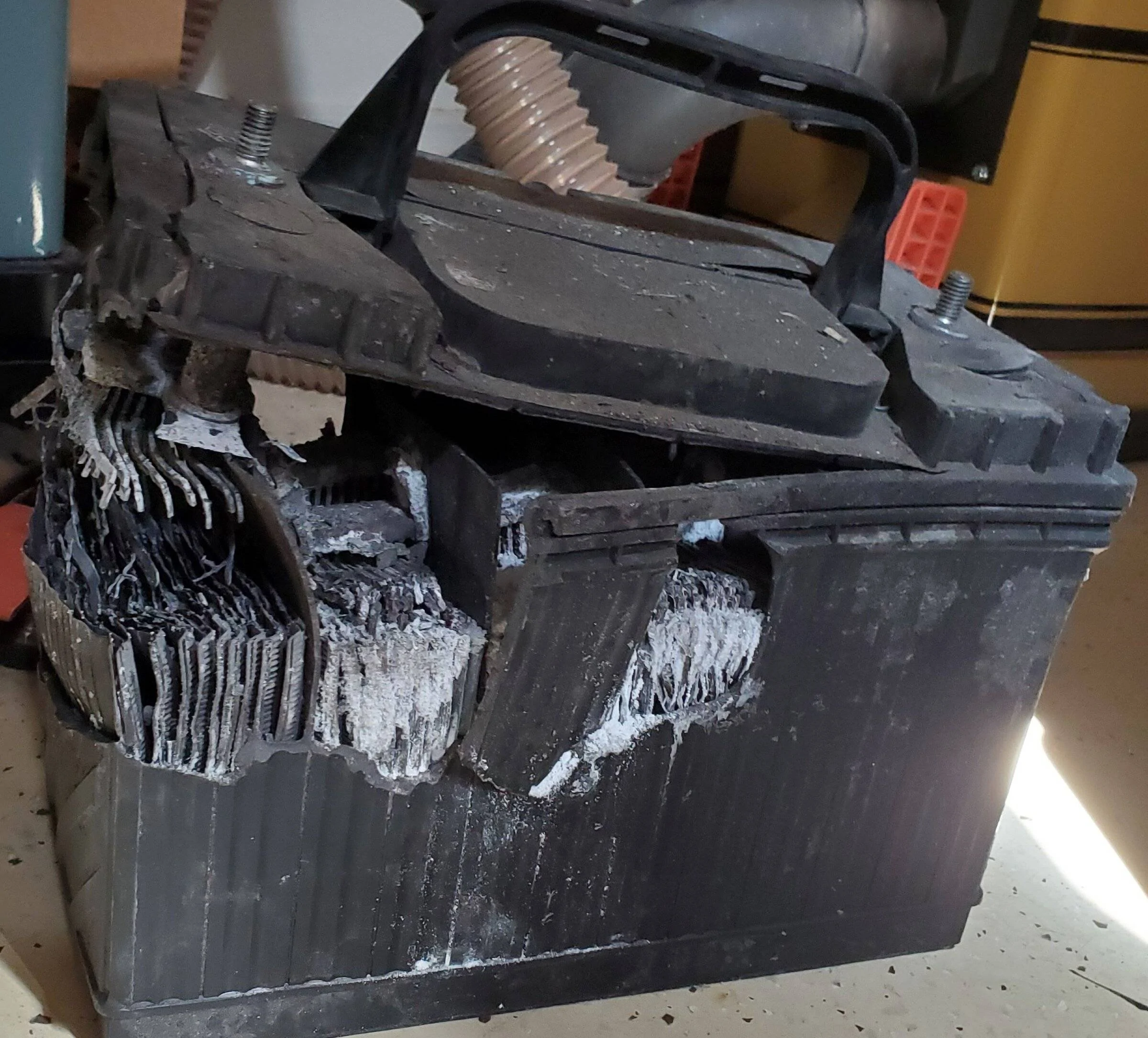

Wondering if your charger hiccuped and reversed the polarity. A maintainer type could possibly do this. If the battery cells are out of balance, some cells will discharge before the others. As it continues to discharge, they will start to reverse polarity. Now, if there is an external factor that keeps the current from flowing, like for instance, when the batteries are in a series, and then one goes bad, the battery will start reversing polarity on some or all of its cells.
