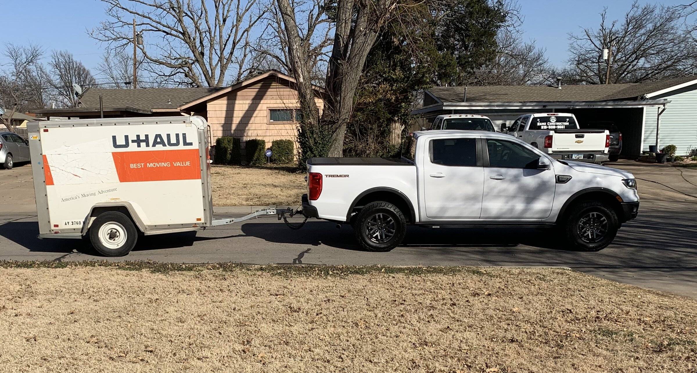

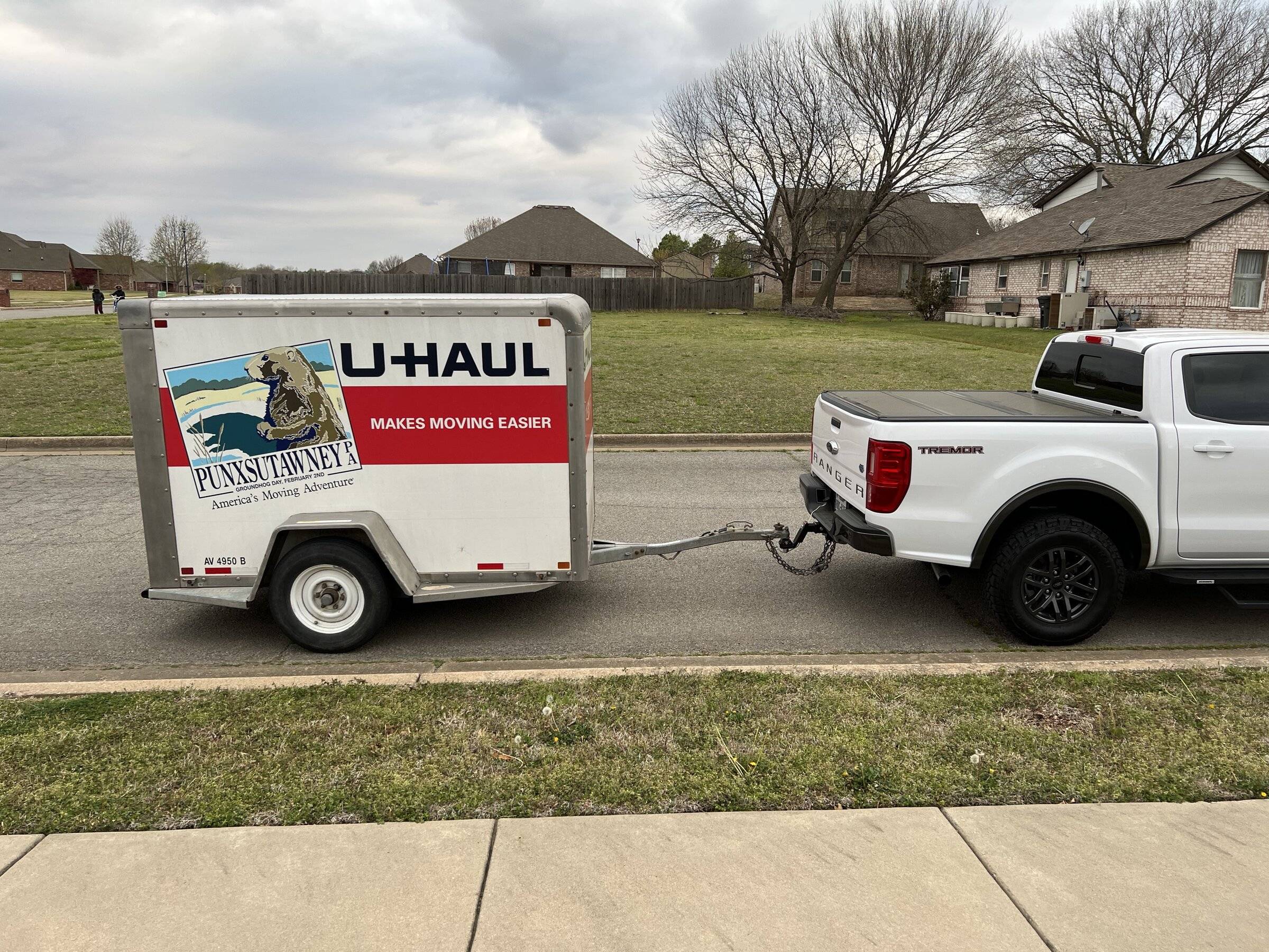

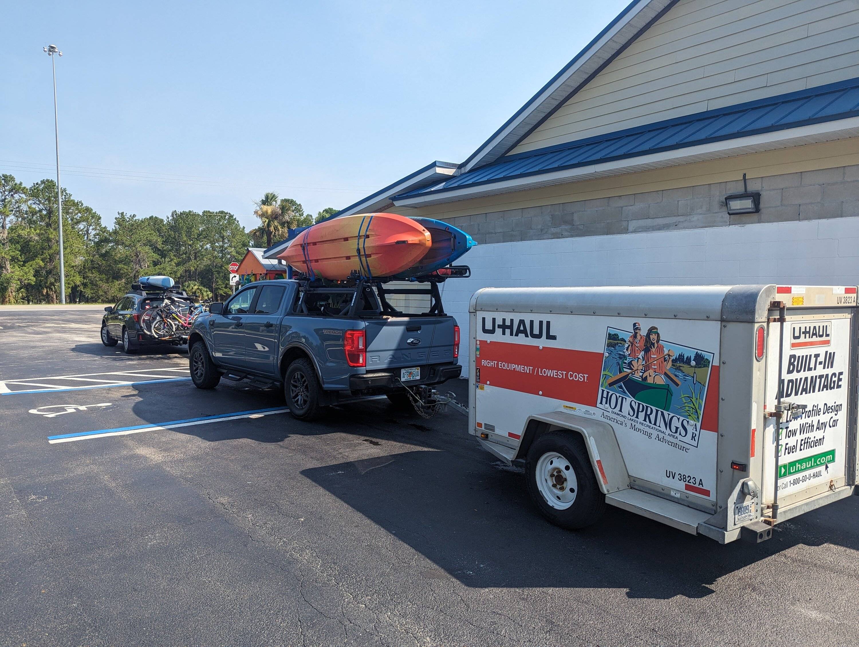

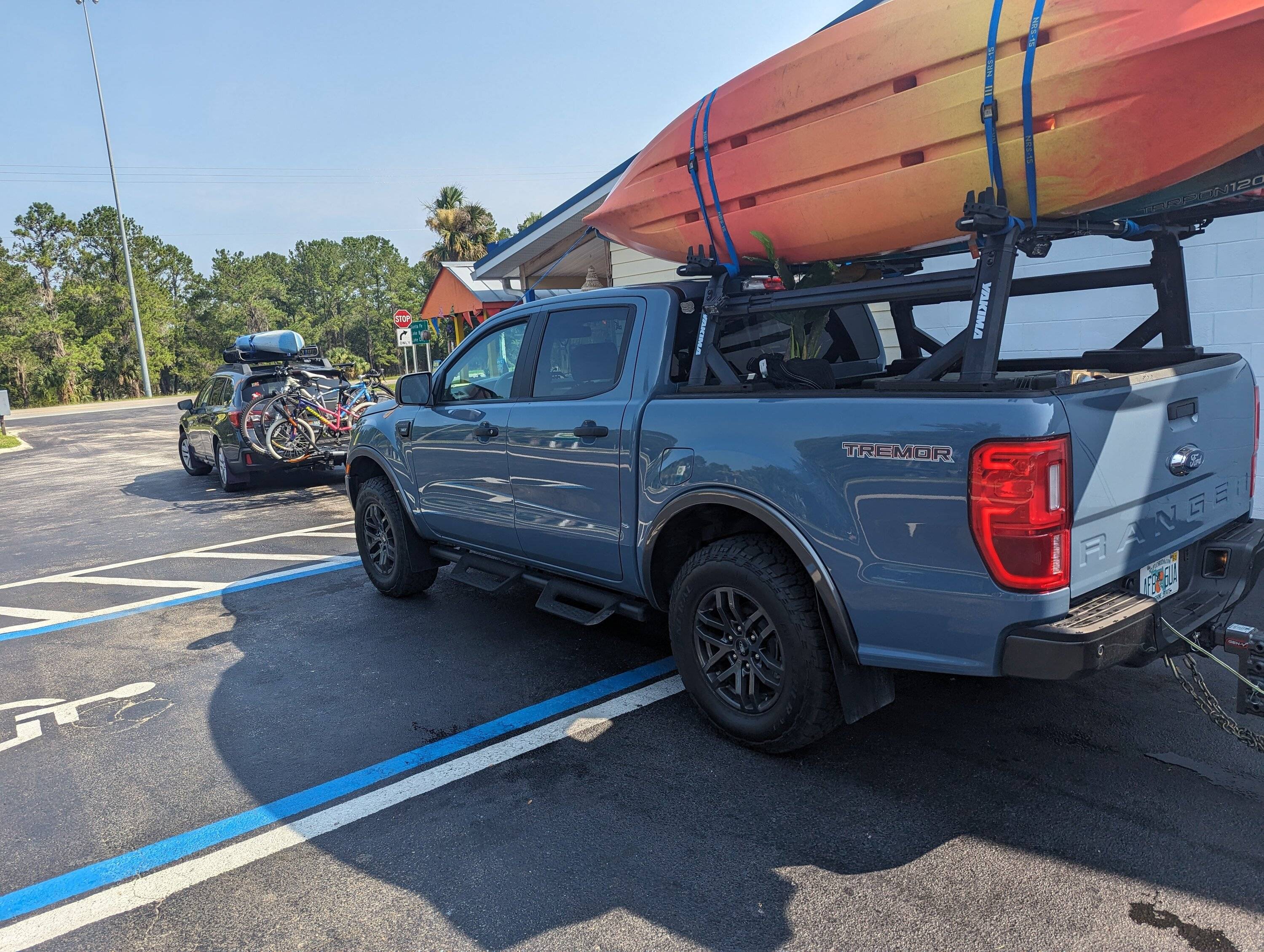

I am still a novice at towing, so take this with a grain of salt.
I have towed a couple of U-Haul trailers recently with my Tremor. U-Haul sold me a 2 inch drop hitch, but I did not like it that much.
Before renting another U-Haul trailer, I bought a Curt RockerBall Cushion Hitch Ball Mount with 5" Drop with Anti-Rattle Pin from Amazon. It has a 7500 lb. rating.
https://www.amazon.com/gp/product/B083LDQYBM/ref=ppx_yo_dt_b_asin_title_o05_s00?ie=UTF8&psc=1
The Curt drop hitch was great! The additional drop was much better, and the combination of the anti-rattle pin holding the shank tightly in the receiver and the RockerBall Cushion made the drive much more pleasant. The trailer was more stable, and there was less jerking when accelerating and stopping.
I am attaching two photos of the truck and trailer with the two different drop hitches for reference.
