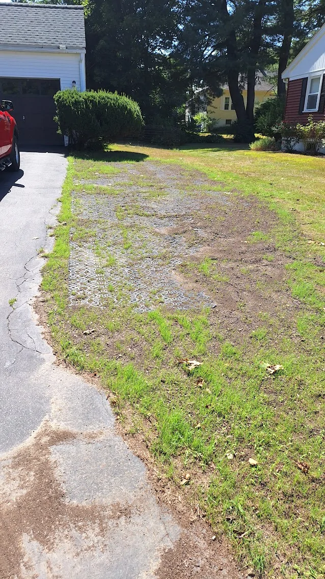

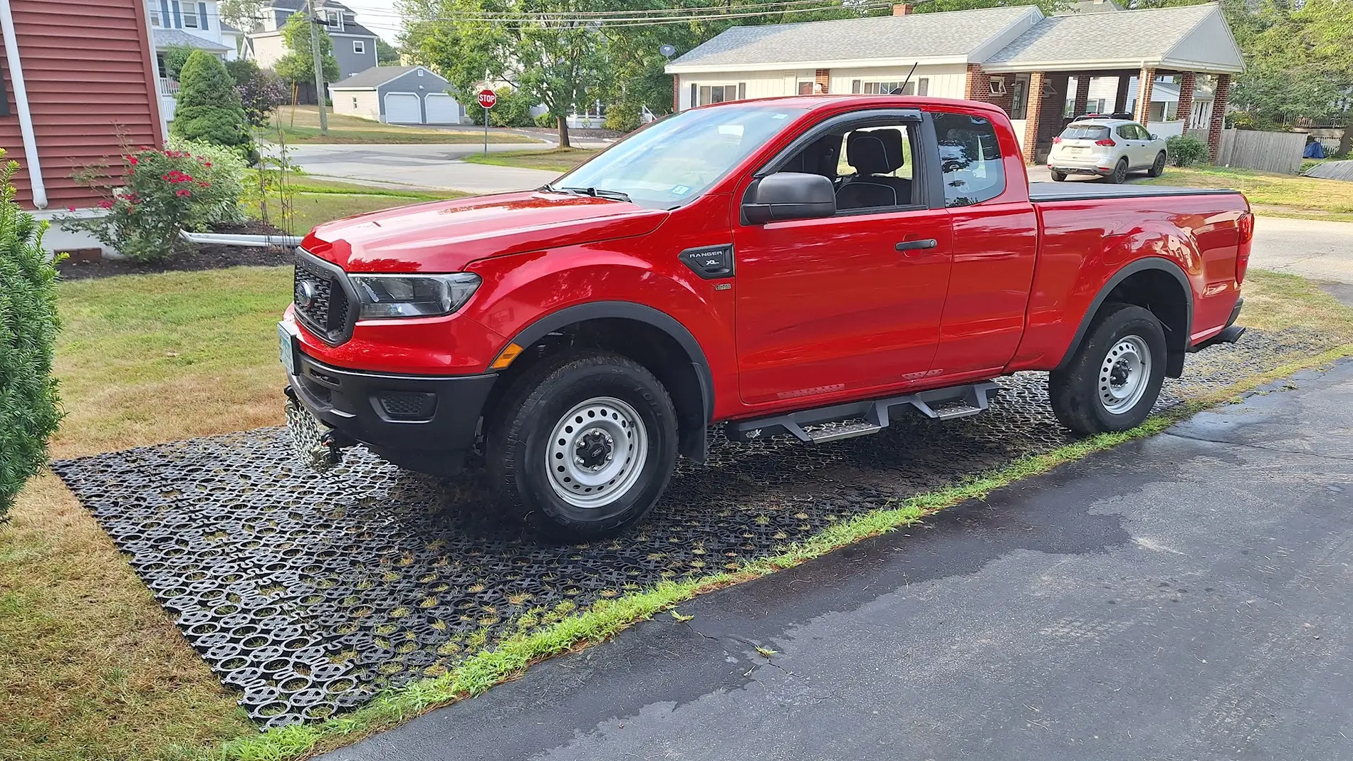

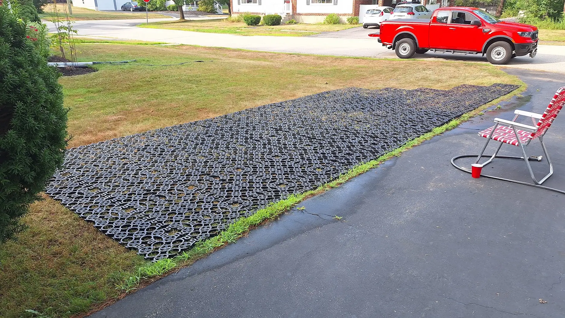

Here's a follow up. This stuff was a PIA but a water-filled lawn roller got it done (and I was done too!).

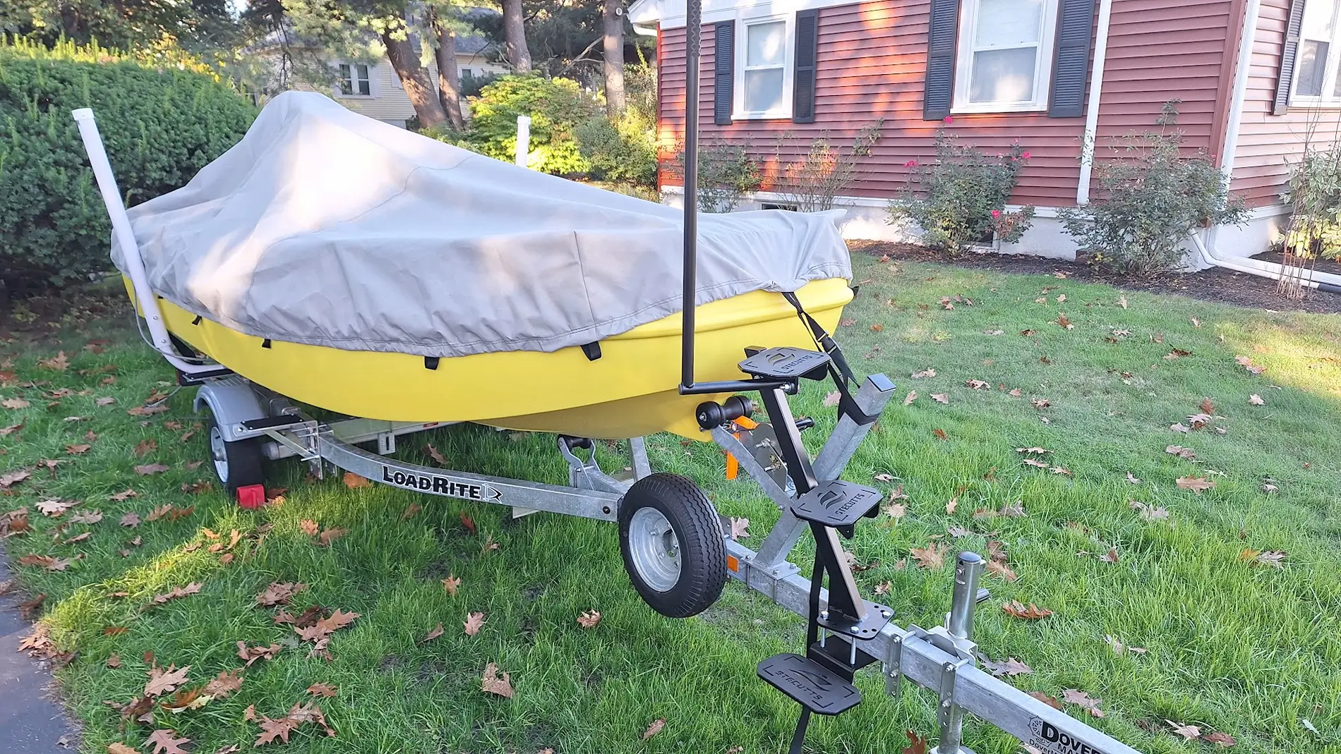

Several grass seedings and lots of water an it came out pretty good. I'm happy with it and will us it much more for Soupie in the winter. Right now the boat's on it, but that'll go to the backyard once the ground freezes.
As it is now ...
How it was laid out, before lawn roller.
After lawn roller and first grass seeding ...

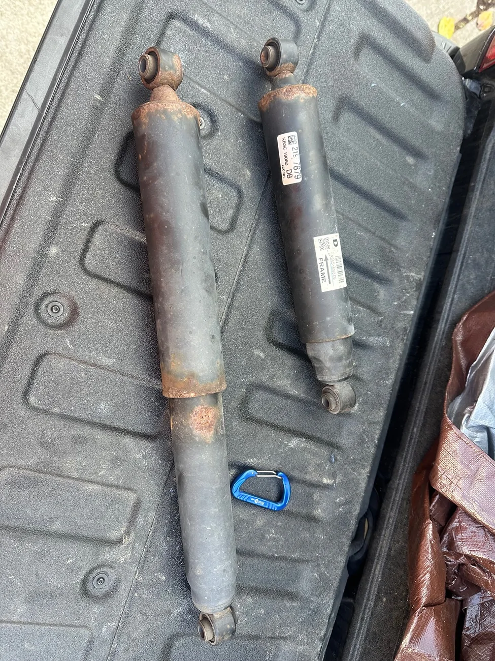

So I actually couldn’t wait until the weekend… I installed on my lunch break today. Took 65 minutes from opening the toolbox to closing it, and I dropped the spare tire. I didn’t run into any issues at all.
I’m gonna wait a few hours to drive to let the locktite blue set but holy smokes my old rear shocks were absolutely blown. The one on the passenger side quite literally has zero resistance going in or out, it’s basically a slide whistle. I have a feeling this is going to DRASTICALLY improve ride quality.
The one on the driver’s side still seemed to be decently firm, I would guess slightly less so than the bilstein but not significantly so. Although I’m just going off of memory since I didn’t compare side by side. I used a ratchet strap to compress the passenger side shock as it needed to be more compressed than the drivers side. The hard part was getting the bolt in while holding it compressed, I jammed that carabiner in the picture underneath the driver side to wedge it in place when I got it to size. If I was doing it again I would’ve used the ratchet strap on the drivers side.

Damn, those snow belt winters are tough on steel.
They sure don’t call it the rust belt for nothing 😉. I’m gonna attack the underside of my truck pretty aggressively this weekend with a wire brush and a few cans of fluid film. I figure that’ll get me through this winter since most of the winter I’ll be in Charlotte where they don’t really use so much salt or anything. Then next year I’ll look into professional rust treatment, but I’ve already blown my truck budget way out of the water for this year

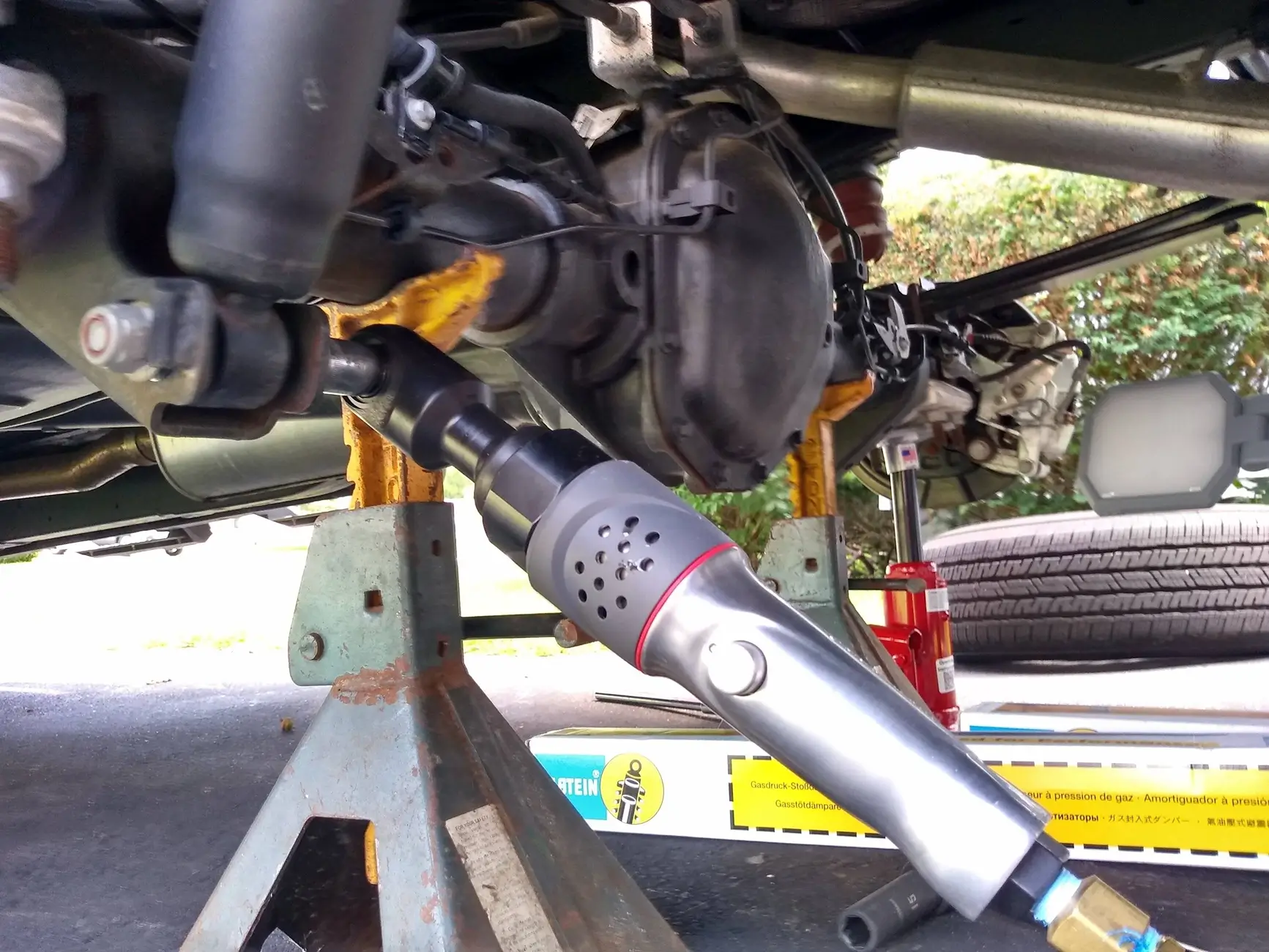

Here's my install of 4600s just to give you a frame of reference. I liked doing it and did so at a relaxed pace over an afternoon.
https://www.ranger5g.com/forum/threads/what-did-you-do-to-your-ranger-today.3511/post-601633
