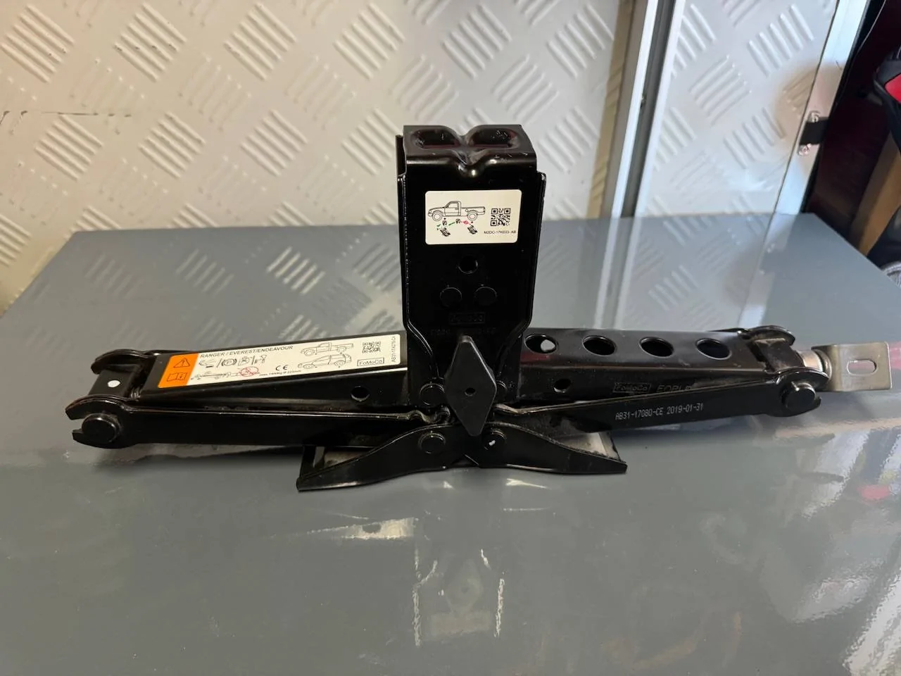

OK...gotta ask....what is a Bronco Jack Adapter ??? And does that mean it will only work on Bronco's ???

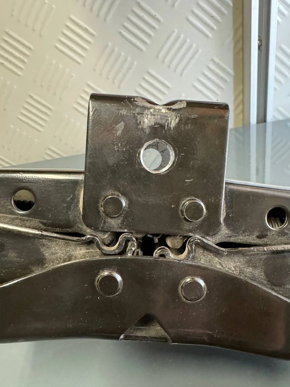

No it’s an extension that goes on top of jack. I’ve lifted my truck and don’t want to carry an additional jack. But Some modification required to Ranger Jack had to drill hole bigger to make hole line up and force adapter on jack. Bronco jack must be a little smaller. I got the idea from another member but he used Raptor F-150 jack with Bronco adapter. But it will work with Ranger jack with some modifications.
Glad you asked didn’t realize I had to modify to make it work but it’s good to go now.

I deleated my post as I googled it up and found what it's for (I had an idea what it was).
But, the silly excuse for a jack the came with the Ranger....that went out to the shed the first week. I carry a simple 8 ton bottle jack with a Safe jack extension and a half dozen RV "leggos" in my swing box.
