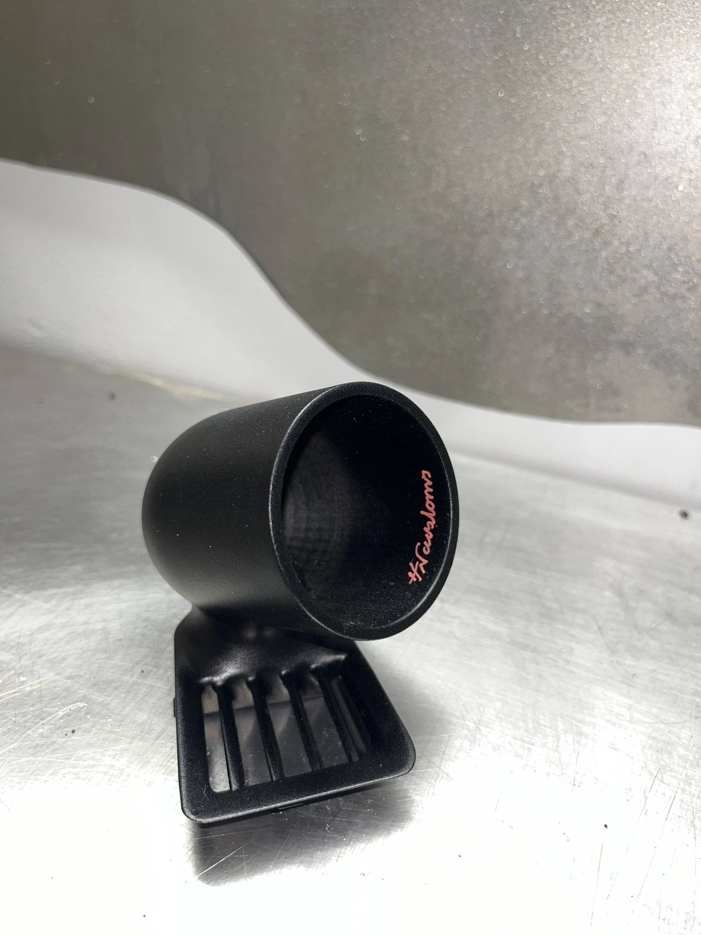

It replaces the drivers side defrost vent to add a 52mm gauge.

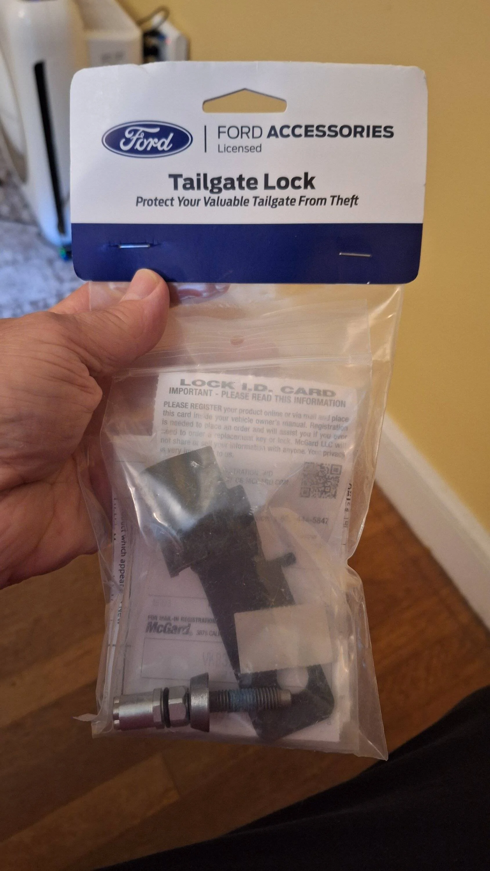

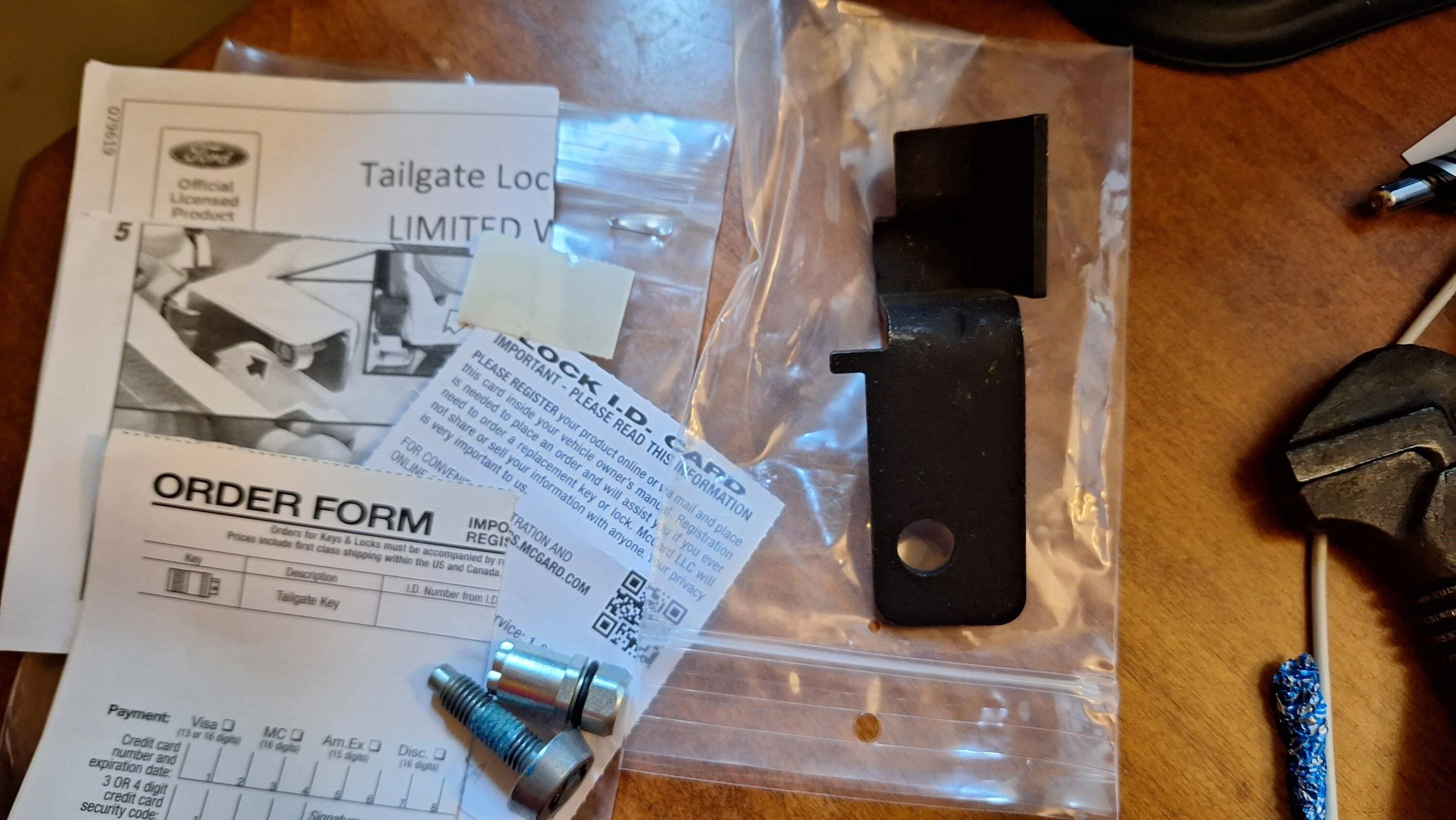

https://www.levittownfordparts.com/sku/vkb3z-18168-a.html
And it came inside of two (2) resealable bags - I guess I know this lock is fresh!

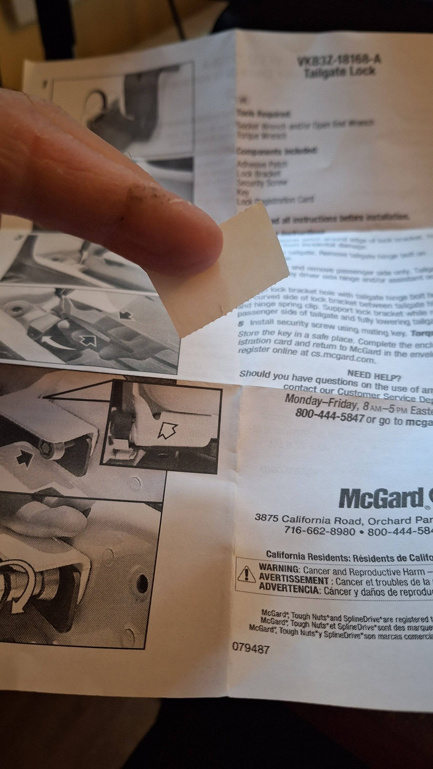

Is this little piece of paper supposed to be the "Adhesive Patch" mentioned in the instructions?!?

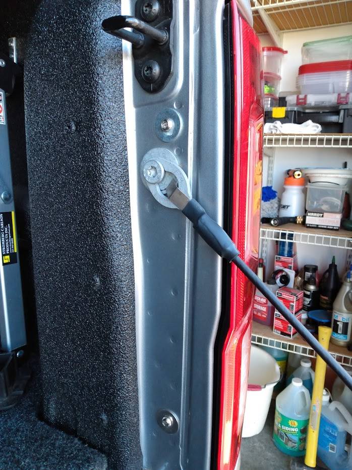

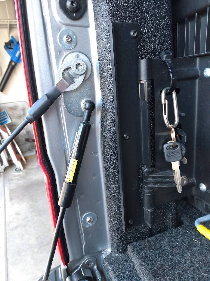

David...that's what I did...changed the taillight screws.
Ever see the pack of security torx screws in your local AutoZone/Advance Auto/O'Reilly in the license plate section ? Pack of 4 is just a few $$. The screws are an almost exact replacement for the OE taillight screws. Pack even comes with the proper security torx tool to put em in.
Can't take em out without the proper tool.
If your not familiar with them....it's a torx with a small integral post in the center that requires the proper torx security bit to remove...has a hole to accommodate the post.
I do have a set of tamper-proof torx bits and now, thanks to you, may soon be able to use them!
If you think this is a good solution, that's plenty good enough for me - thanks! =)

David...forgot to add...you'll need to use some washers as the OE stuff had a captive washer on it. I just used some stuff I had on hand.
