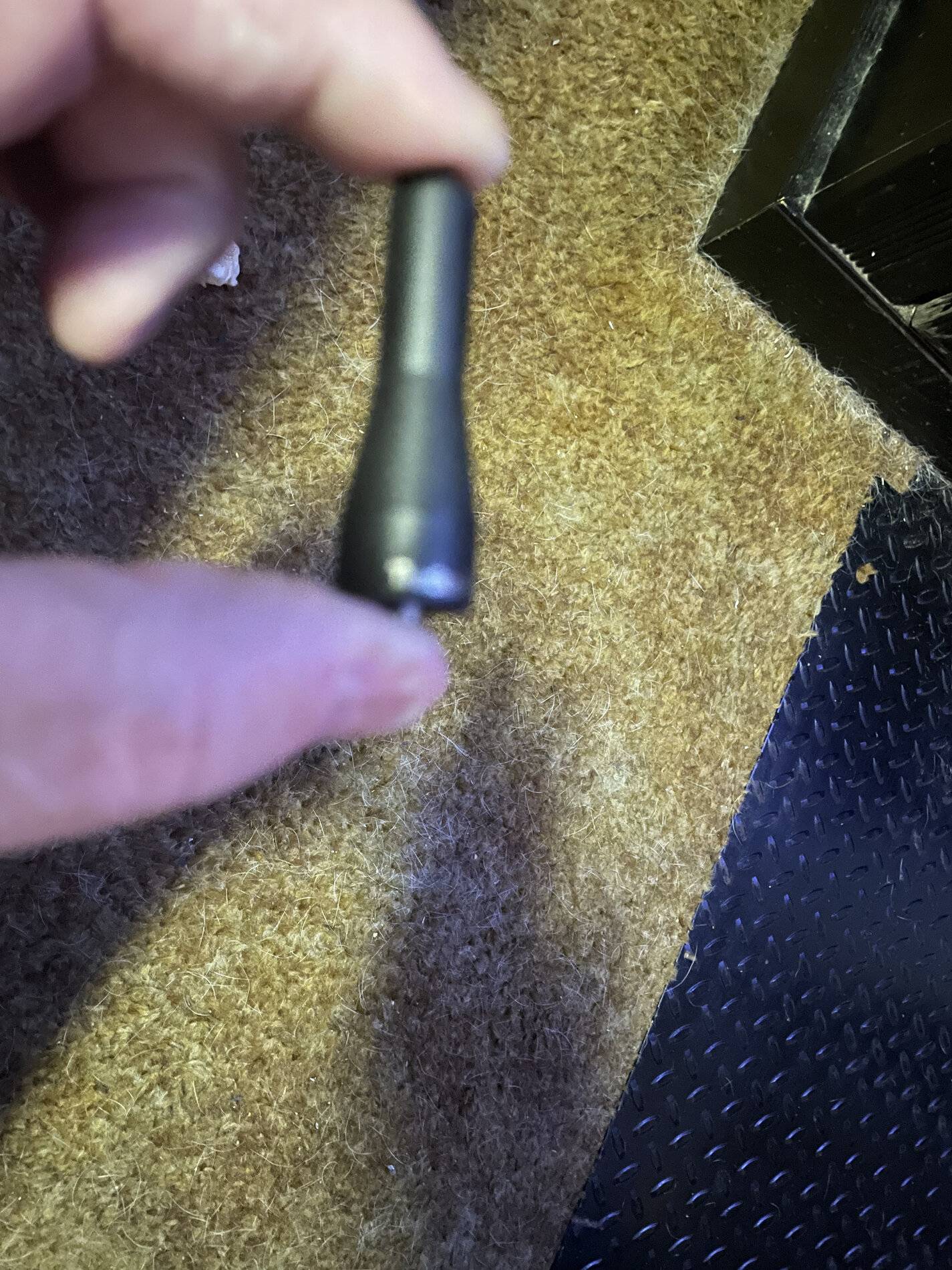

Harley worth mentioning, but, this came today.
Nice, I have one but took it back off as the difference for reception in rural Vermont from the factory antenna was significant.

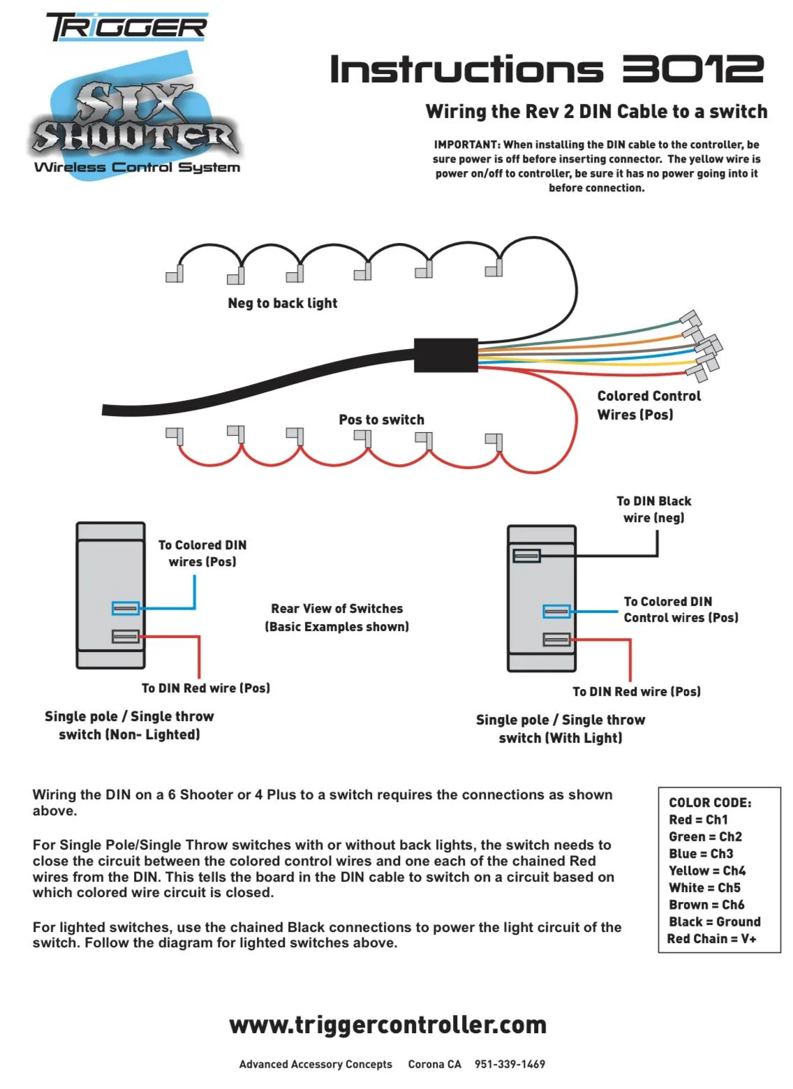

I have been looking for a setup like you're describing, but I am missing the adapter that lets you use the LightForce switches. Is there something not in this picture?
That little baggie next to the Trigger box is what Tigger calls a “DIN Connector Harness.” It plugs into the back of the controller, gets routed through the firewall, and connects to your standard switches.
https://triggercontroller.com/product/trigger-din-connector-harness/
Some might ask “Why would you do this when the Trigger is designed to avoid running cables into the cab?” But, this still makes for an easier install, running one cable instead of several, gives you the stock look of the Lightforce facia, with the benefits of the Trigger, such as dimmable lights, remote switches, and strobe functions.

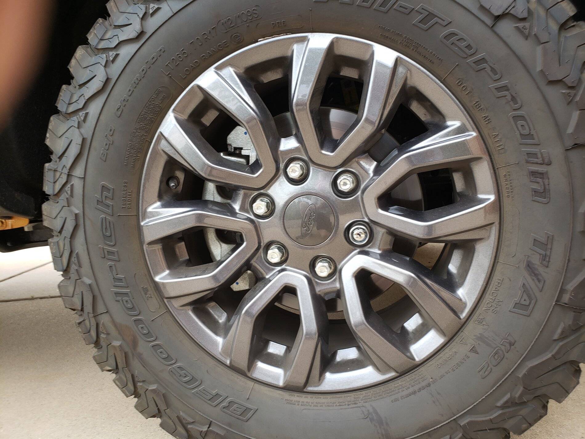

Got my new black lug nuts and installed them. Look much better than the OEM two piece nut with the magnetic sport rims. Match the OEM lugs for size of taper and bulge size. Checked thread length and fit, all good.
Torqued one up and seat matches well. We'll see how they last.
Got them off Amazon for $24.29 +tax for a set of 24. I'll post a link when I get on my computer.

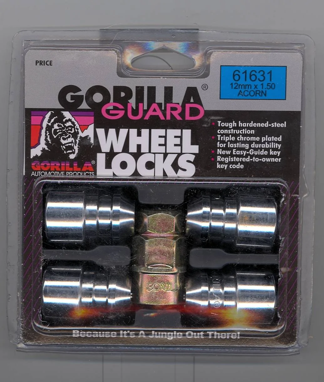

Lee, just curious...are you planning on installing Lug locks? Got them on mine.

No, tire and wheel theft is not a big think here in the upper Midwest. My opinion on wheel locks is they only slow Down the rookies anyway. Pipe that slips over them and a 4 pound sledge. Bam, snap the stud. Just a bigger pain when you need to rotate tires.
