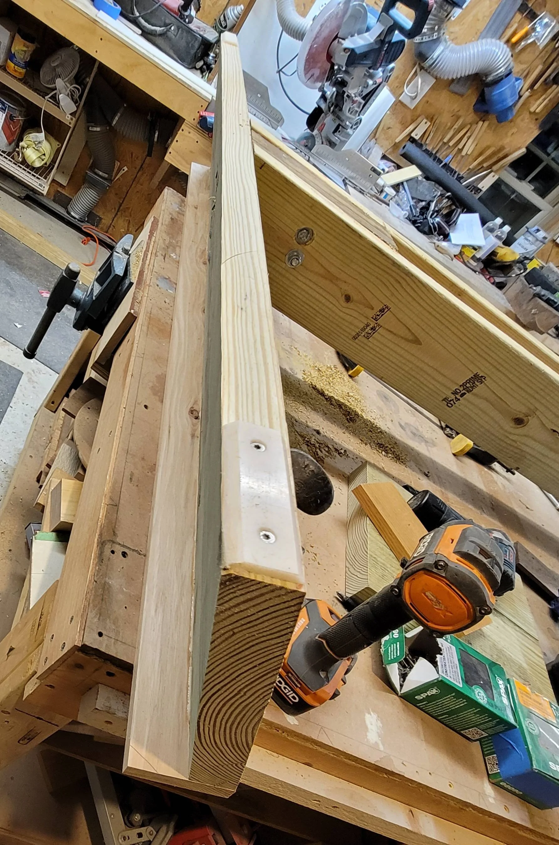

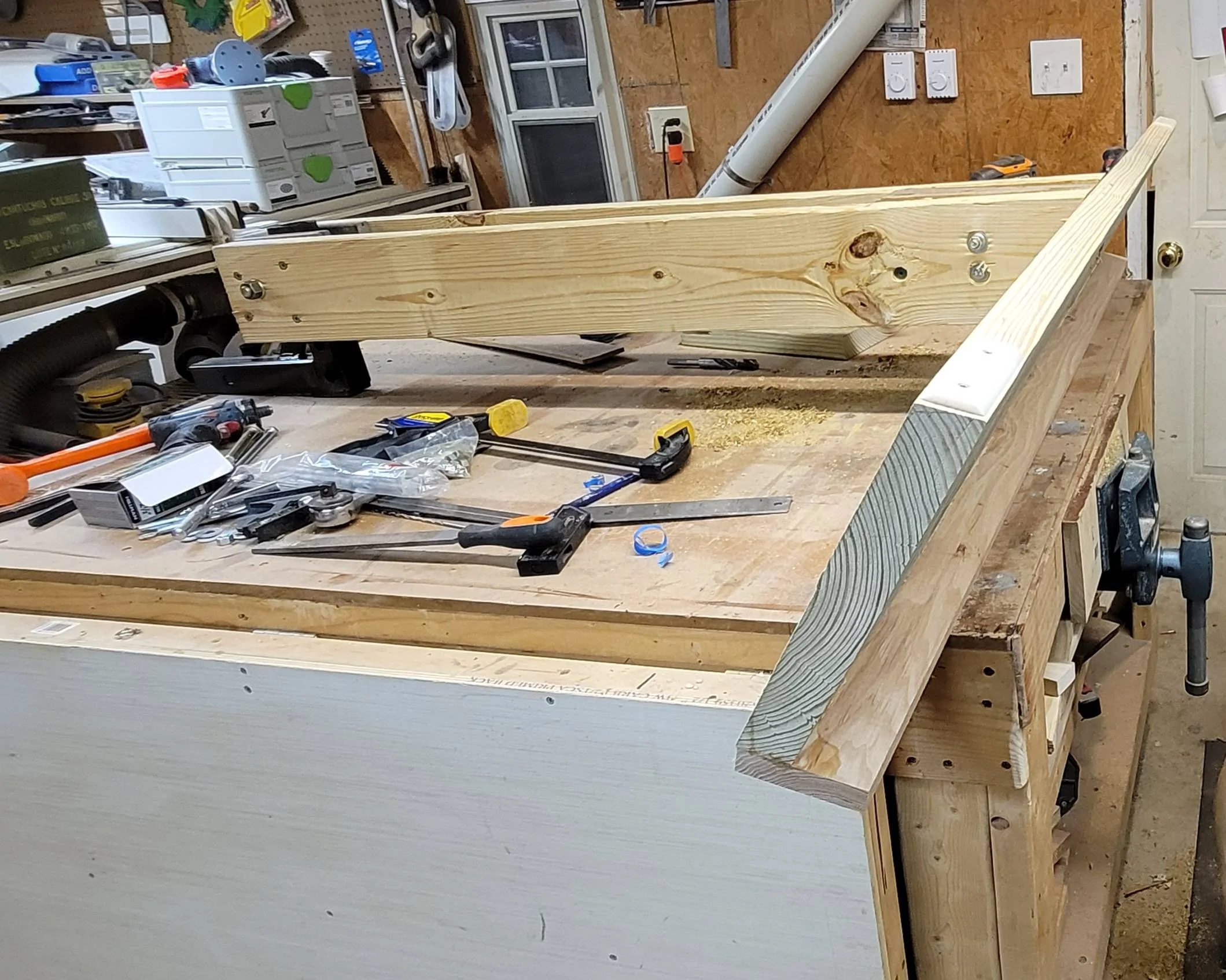

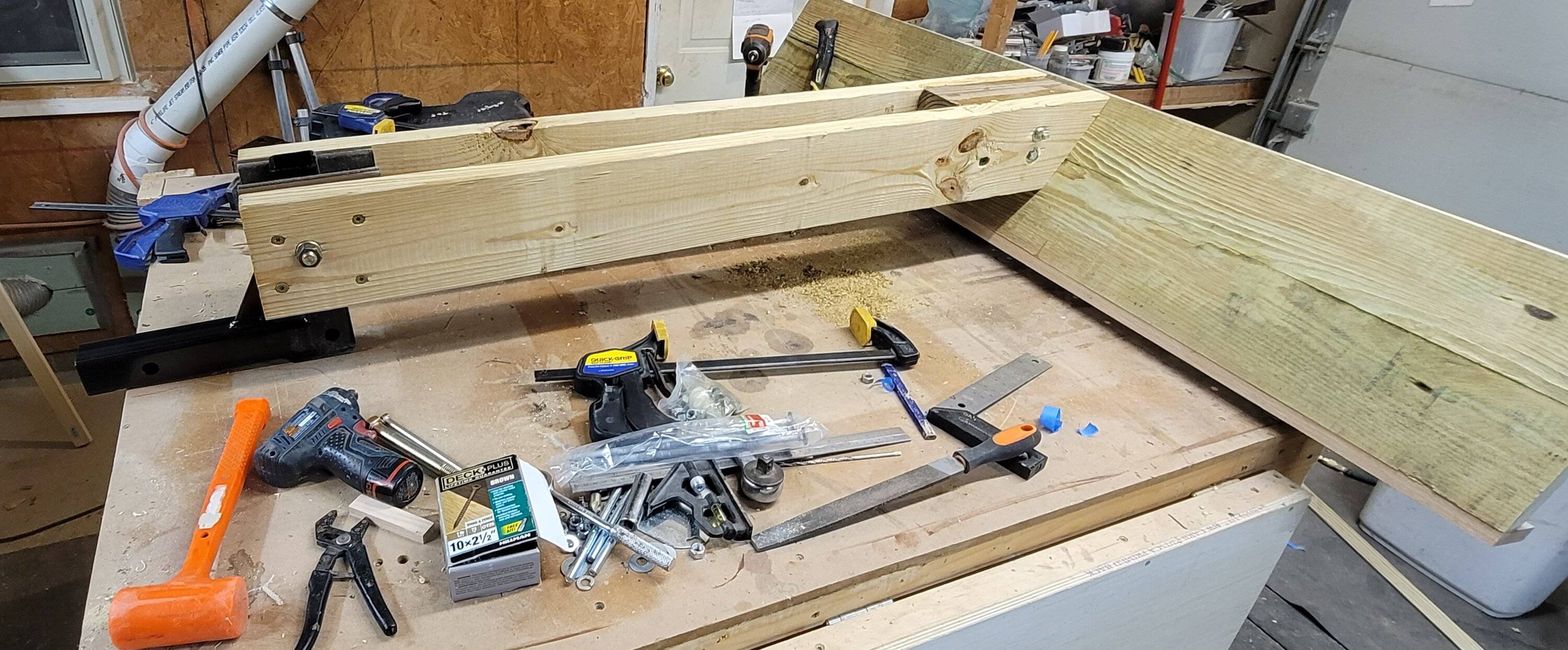

I built a rear snow plow for my Ranger, finished it last night late. I adapted the design off of a couple I saw on YouTube. I will post more pics and a video later. I dont own a welder so I made it from a drop hitch and treated lumber. I won $80 on scratch off lottery tickets I got for Christmas plus a $50 gift card from Lowes, I still have a few bucks left. Has a hickory 1x4 attached to the top to roll the snow
And instead of using g hickory as the skid/sleds I cut 2 pieces off a piece of HDPE plastic (slippery 1/4 Inch use of for wood working jigs etc) my can of DuPont slick spray for my snow blower arrived yesterday so I coated the blade with it to see how it does on wood plus sprayed my snow blower chute. If the spray on the wood doesn't last I will coat it with Johnsons paste wax for wood. Blade is upside down in pics, had to attach the plastic to the bottom.
I bought a 12 volt atv winch at Harbor Freight that came with a wired and wireless remote but I won't encorporate a lift right now, I will need to see what gauge the power wires are and run it to the battery when it's warmer.
I made the blade width to sit just inside the tires so I can back.out of the garage without hitting anything plus it will line up with my rear camera backup assist lines. my driveways straight easy peazy.
a treated 2x12 blade and a treated 2x6 for the arm, a spacer at the hitch. I used an 8 inch grade 8 bolt to attach it to the hitch . Other guys used a piece of 4x4 to attach the blade and arms, I had a piece of 4x6 I forgot to rip to 4x4 so I had to go buy longer 3/8 carriage bolts, no regular bolts in that length in stock. Only put in 3 instead of 4 so I added to 1/4 inch x 6" construction lags.

Hmmm, interesting Mike - any thoughts on adding angled bracing (like on a wide push broom) to handle the torque if one side gets into heavier snow than the other?

Yes Duke, I have some angle metal and also some long lengths of leftover 1 inch metal conduit, I didn't see any flex to speak of in the camera while pushing the wet stuff at the end of the drive but I was busy watching what I was doing. It worked fantastic! I need to run errands and then I will upload video to YouTube and link it. I will have to use the snow blower first for the drifting to my right as I back out, I can't get the angle on the truck and blade. If I push from the other direction I will bury my trash cans. I had only a fee minutes of cleanup with snow blower and shovel compared to over and hour of standing out in that wind chill next time.
