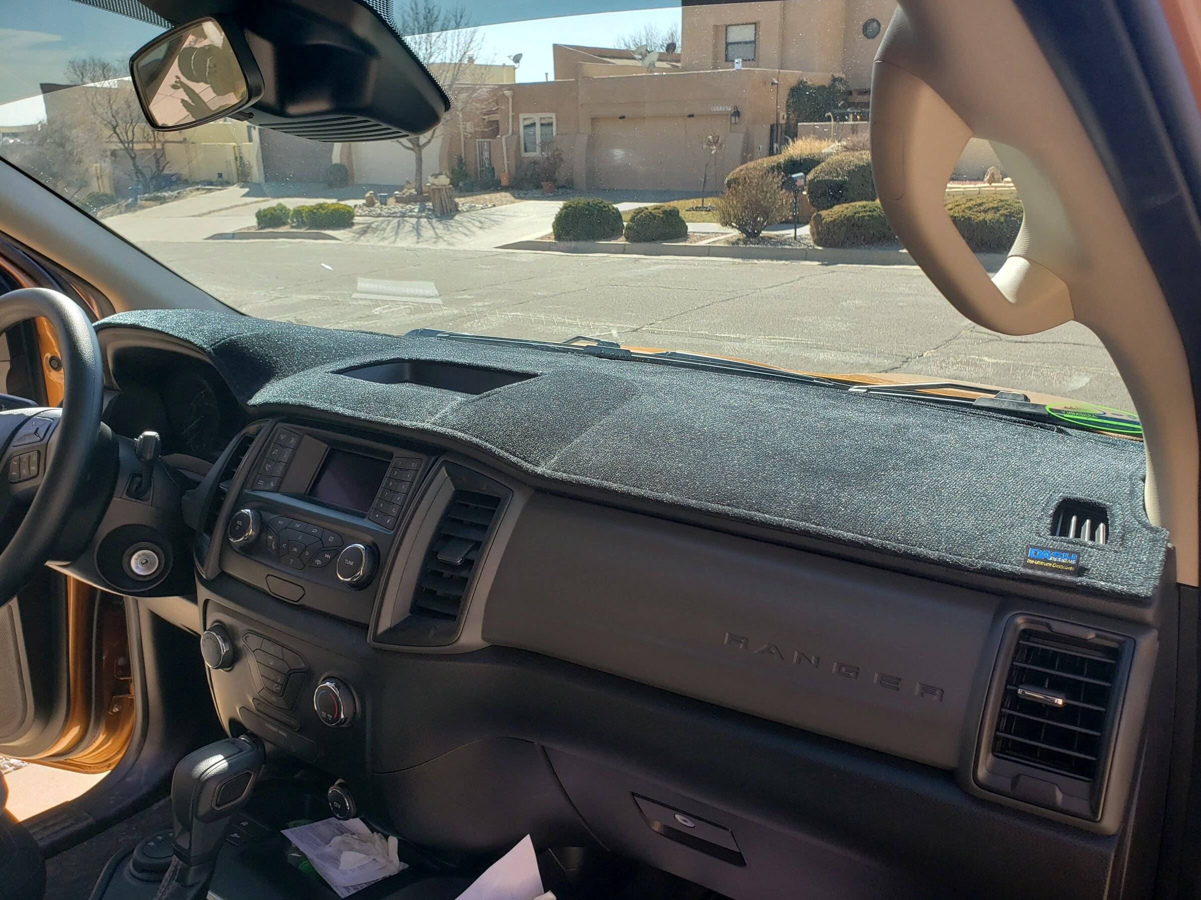

Just got this on. Power is amazing!
Make sure you change your blinker fluid next. That's good for an additional 25 hp. :shock:

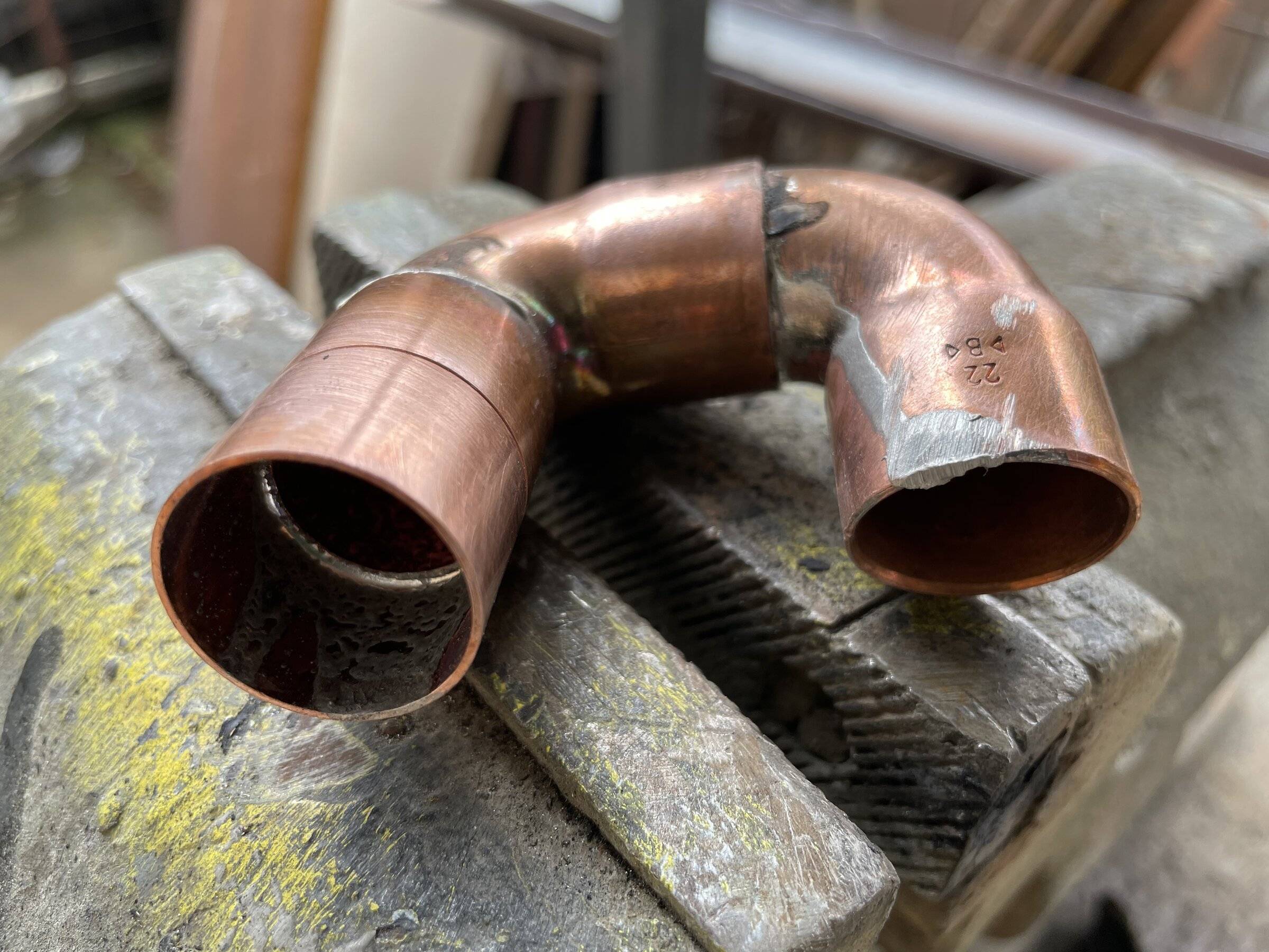

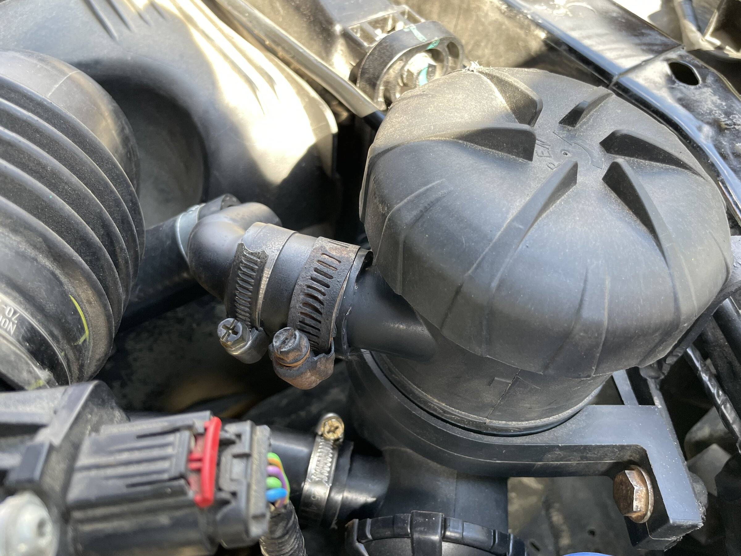

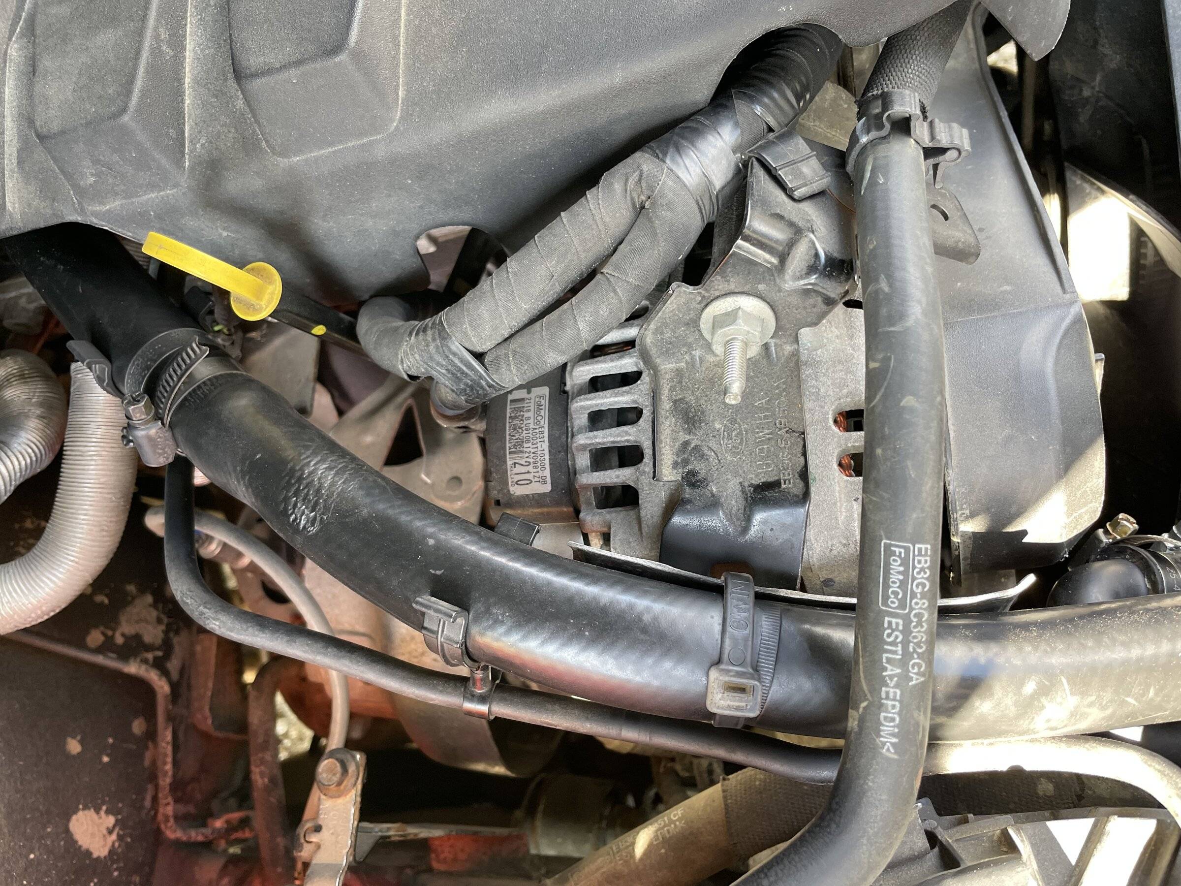

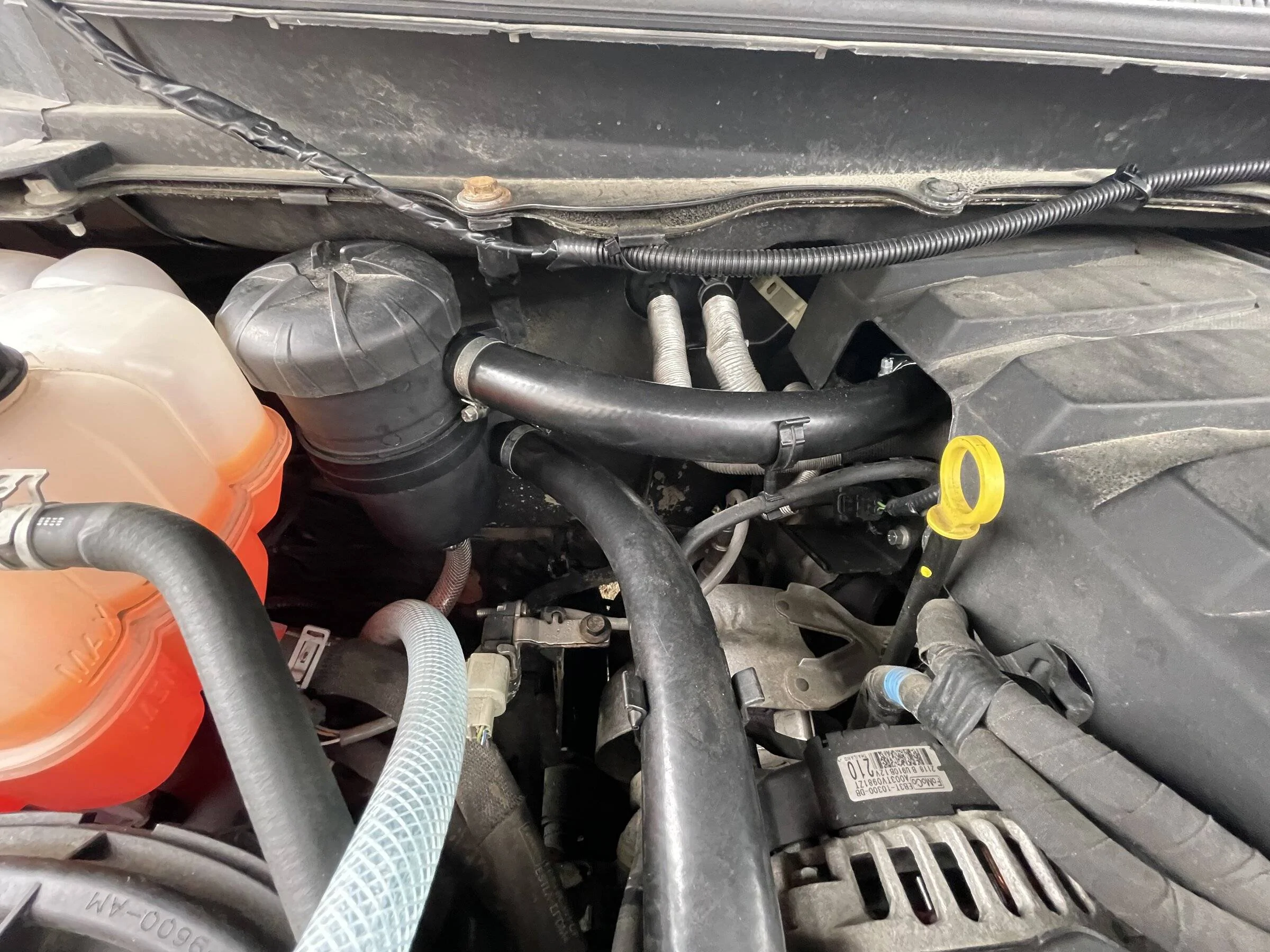

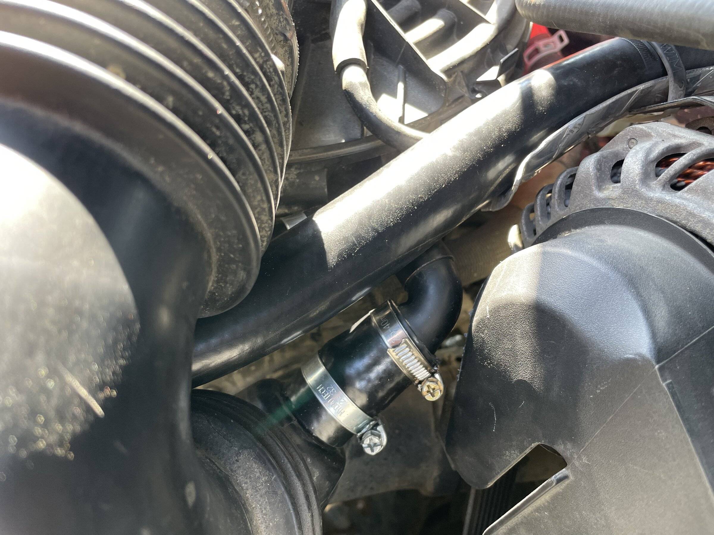

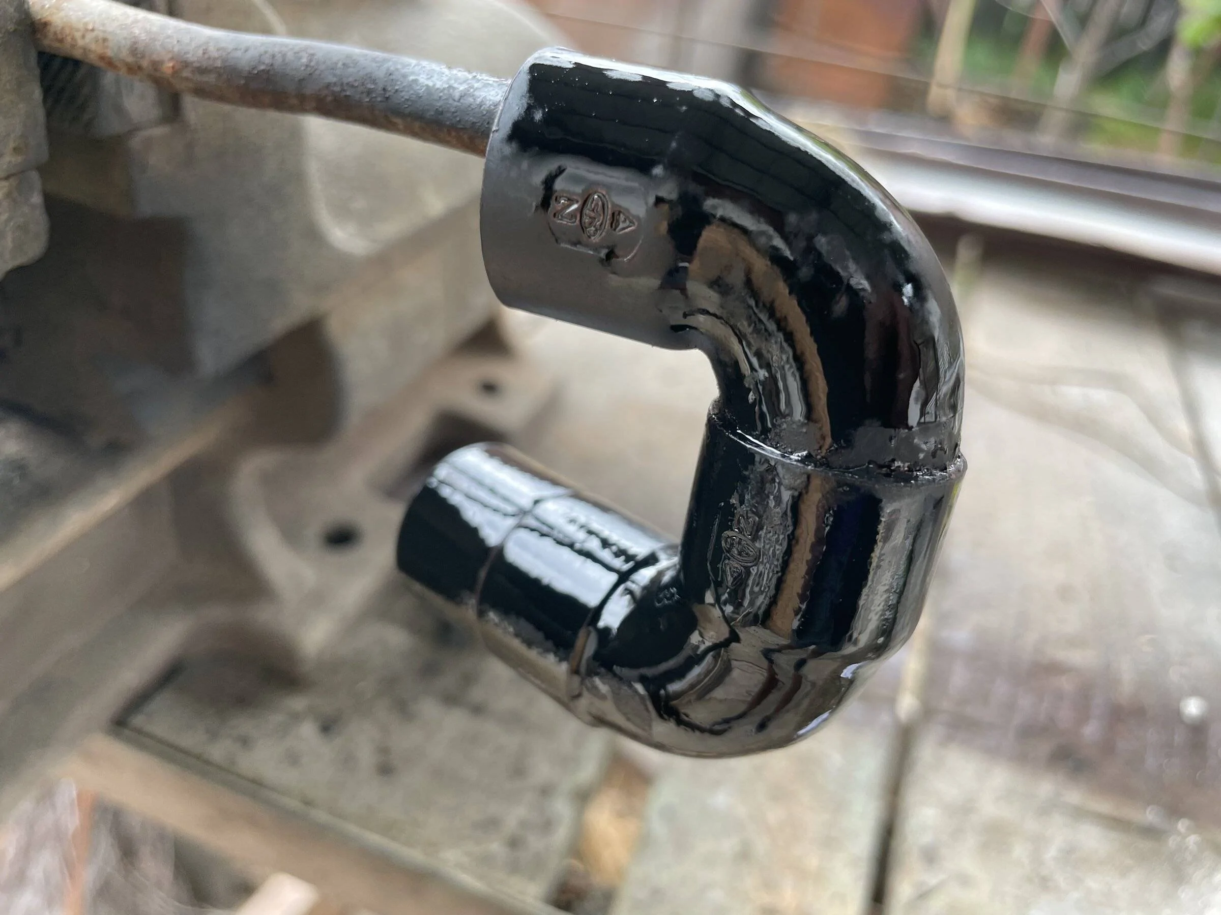

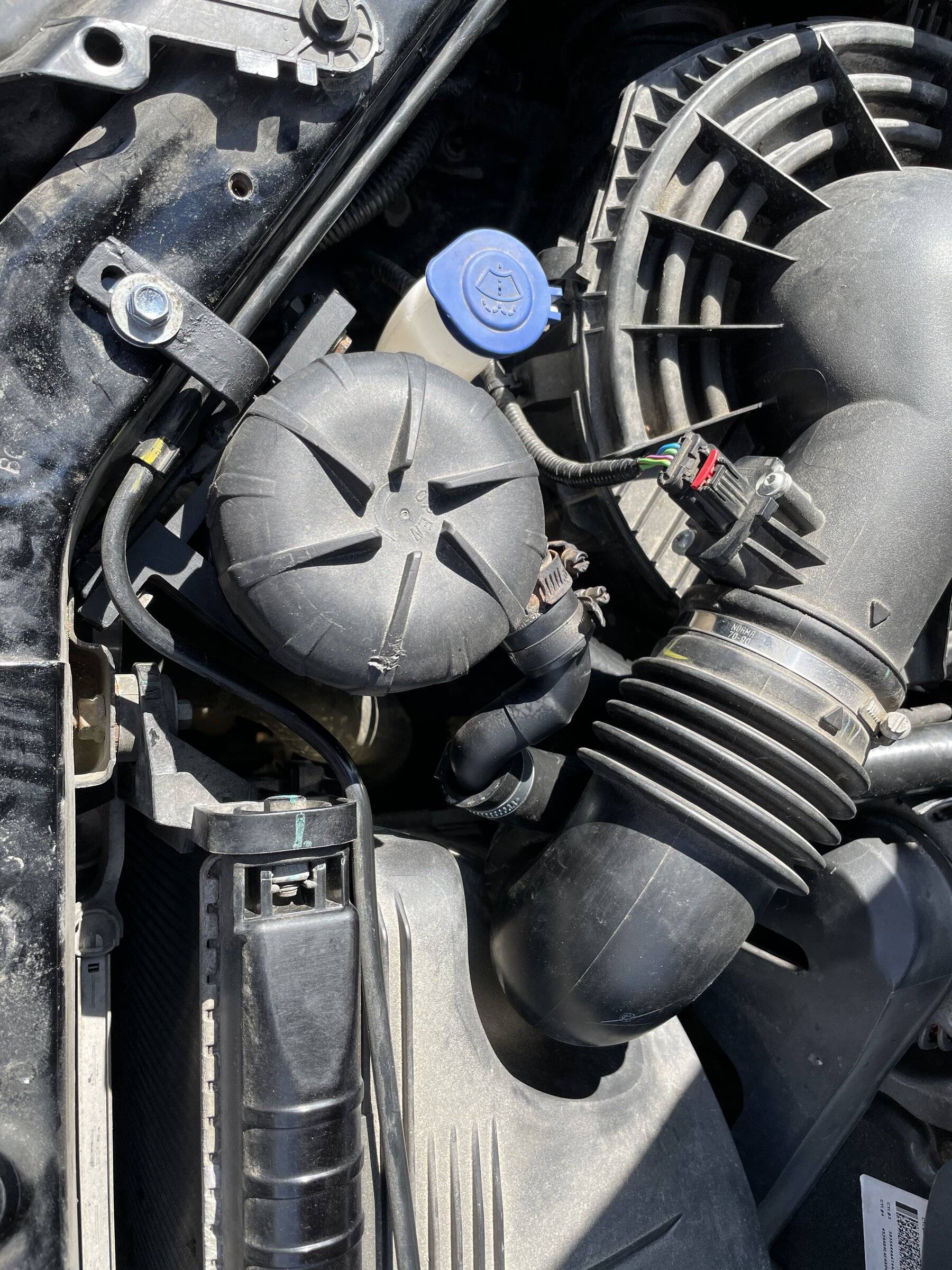

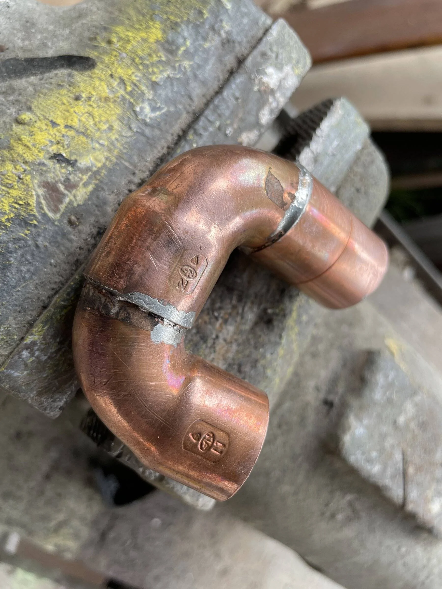

It’s been too long since I did not a true DIY mod, being busy with home construction.
I was not happy with the poor result of the catch can. It was catching water only, due to the hot location over the turbo/exhaust and near to the coolant expansion tank. The oil smelly water would probably condense well while the catch can was cold, but that’s it.
So, I’ve done some welding and soldering and oil rated hose in order to reroute it to a cooler location while trying to maintain an OEM-is look. Now, it sits in between the headlight and the grille, still pretty close to the air hose coming out of the turbo, but there’s no other place to fit it. The small 2.2 diesel is a huge engine.
