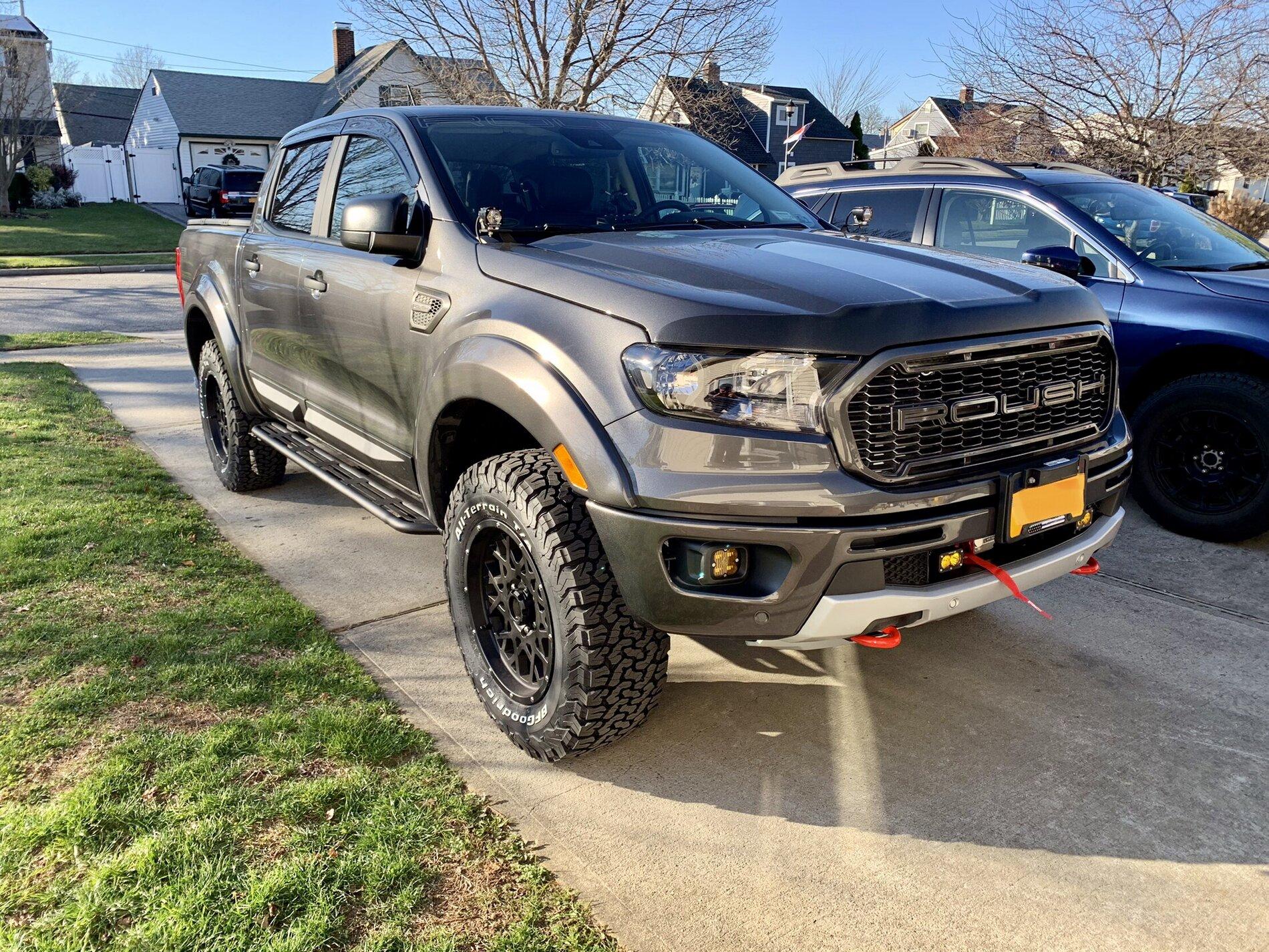

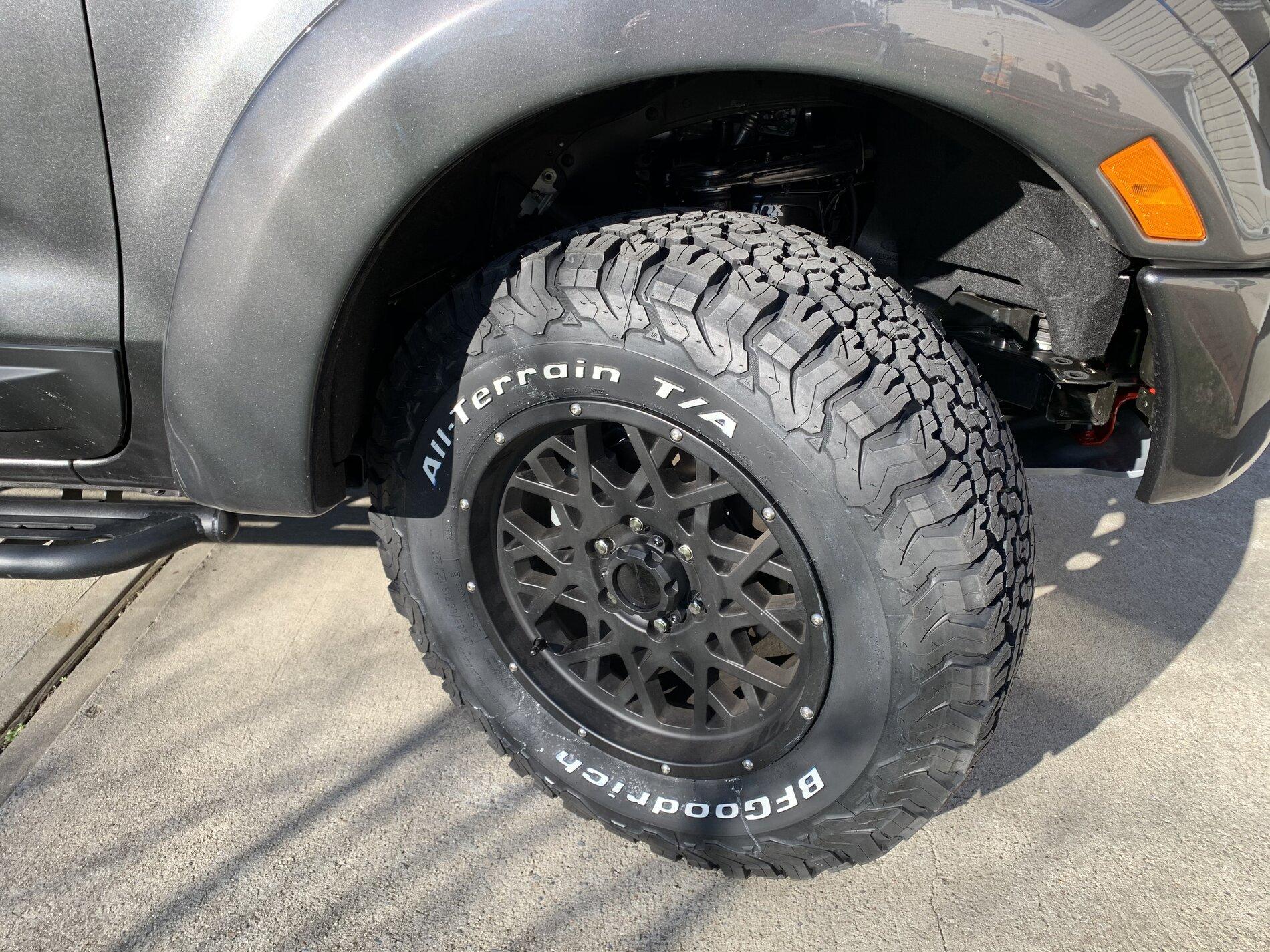

I was gifted a set of KO2s last week ?
285/65/18.
I really like the stance and the look.
(Fox 2.0, rubs on rear intrusion beam at full lock, no issues up front, front crash bar delete...waiting on BDS kit.)
285/65/18.
Great looking tires and wheels!

Quick update:
While still waiting on my BDS intrusion beam kit....
I Adjusted the rear crash bars and pushed it all the way back.
No more rubbing! :like:
I now have about 1cm space for both driver and passnger side,
at full lock.
