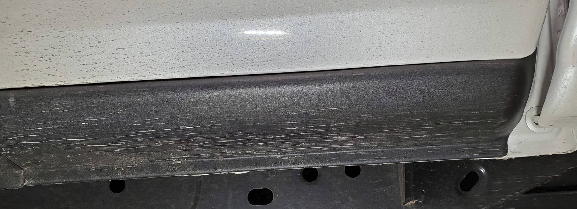

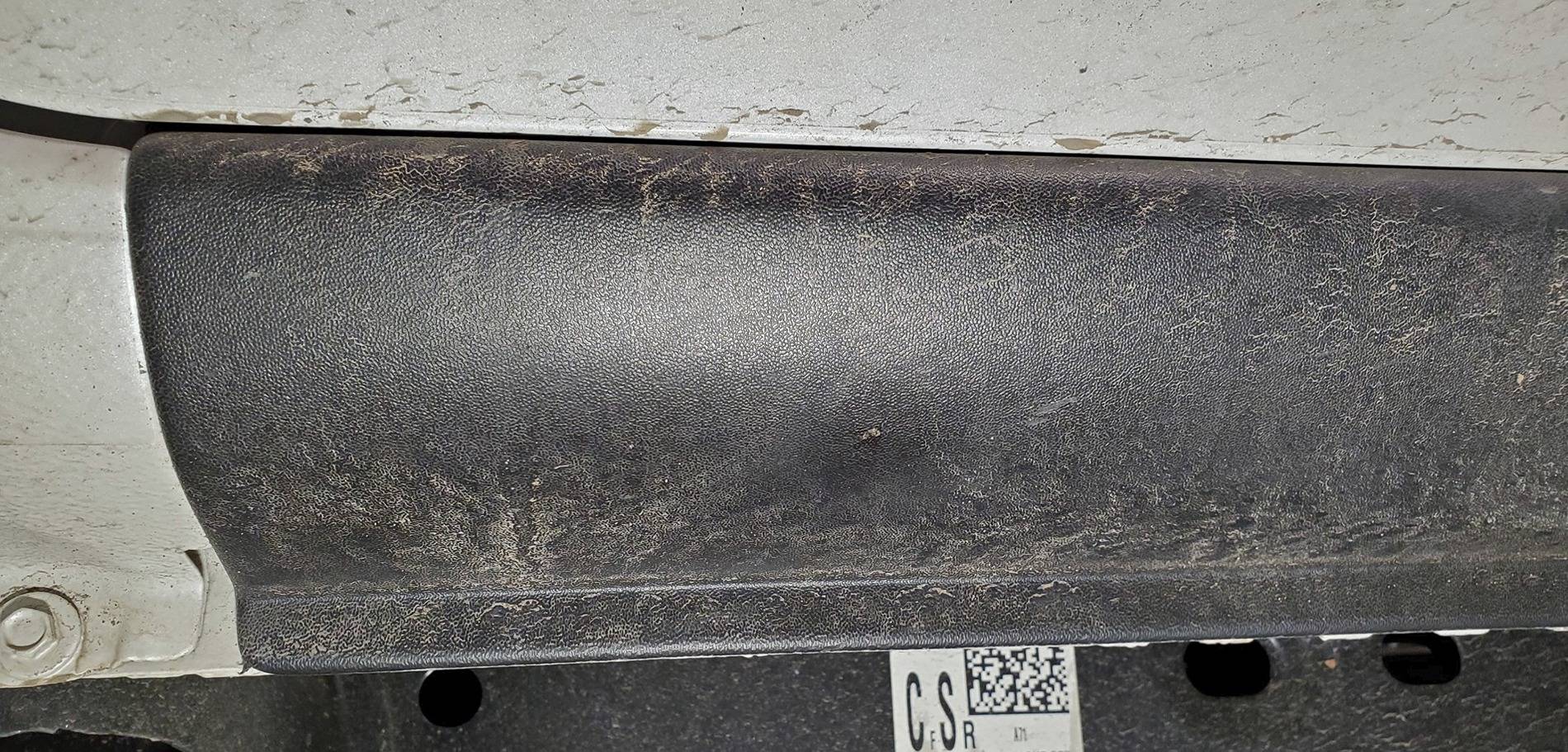

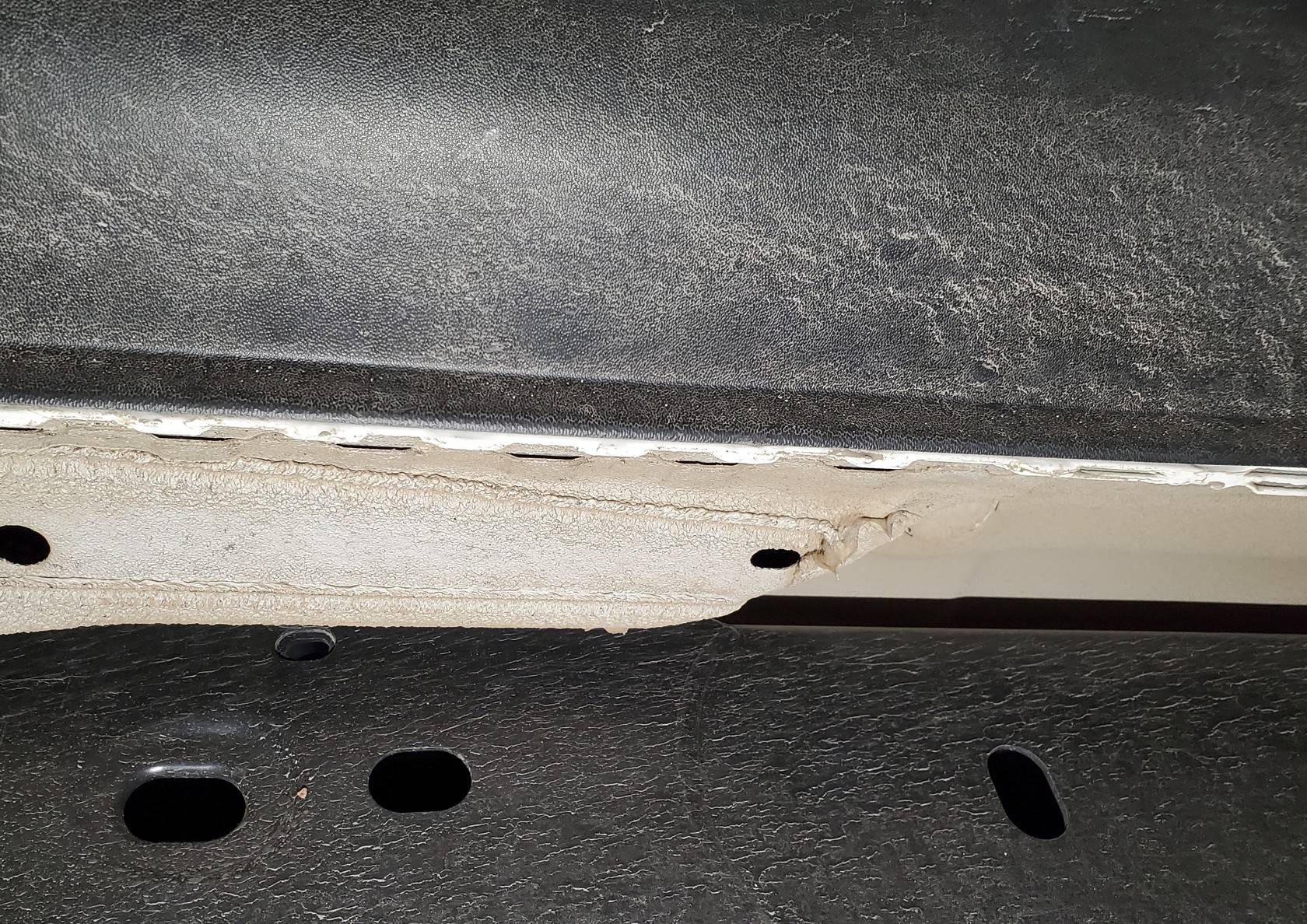

In yesterday's issue of how I'm spending my retirement money, I installed the Ford armored sill protectors on my 21 SCAB. They are made by Bushwacker. They don't fit perfectly to the pinch welds to say the least but they're alright. I wouldnt buy them again though. Previous owner had some small metal sill protectors on and hot glued them. Needless to say they came off and took some paint with them. Shit.

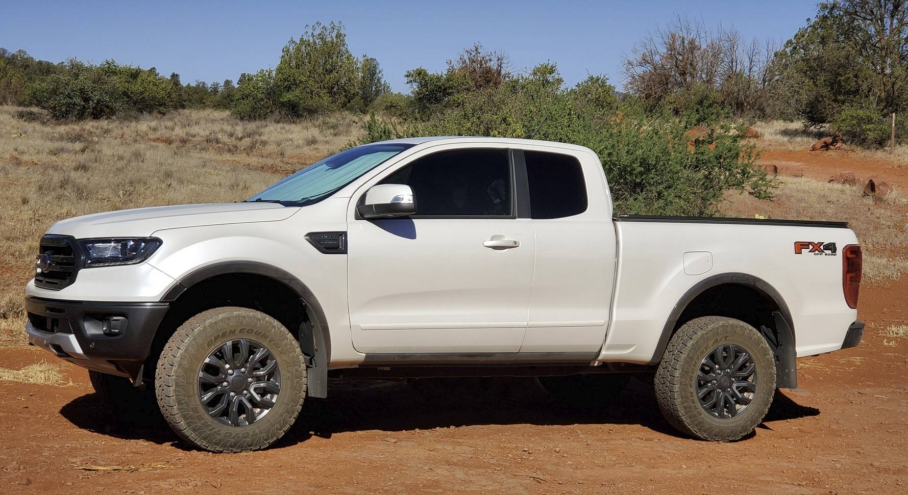

Shortly after buying our 2020 SCab, I installed the Bushwacker "Ford Ranger Trail Armor Rocker Panel & Sill Plate Combo Set". Couldn't be happier. Excellent fit/coverage, rock solid, and basically indestructible. Not even a scuff after years of tromping in/out with our dirty hiking boots.
With several 2-sided tape strips for installation, they are a bit challenging to get fully seated. If not fully seated, they won't reach the pinch weld.
I contacted Bushwacker to suggest making an additional piece to cover in front of the rear tires to protects from rock chips. Crickets. So far our PPF is holding up.

Nice looking Scab!

Roger that, I have the same ones. Beautiful SCab! I'm sure they'll hold up based on your feedback. I'd say if there is a slight design flaw it's that the pinchweld protrudes in a few spots and isn't flat all the way across. It's slight but noticeable when you look up close. The bottom touches and sticks to them but has a small gap otherwise. Not horrible but not awesome.

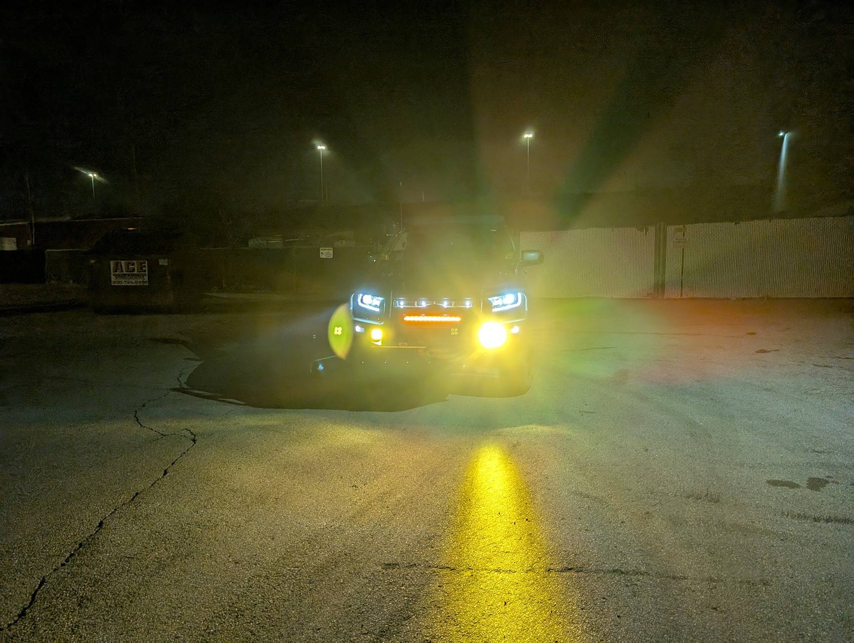

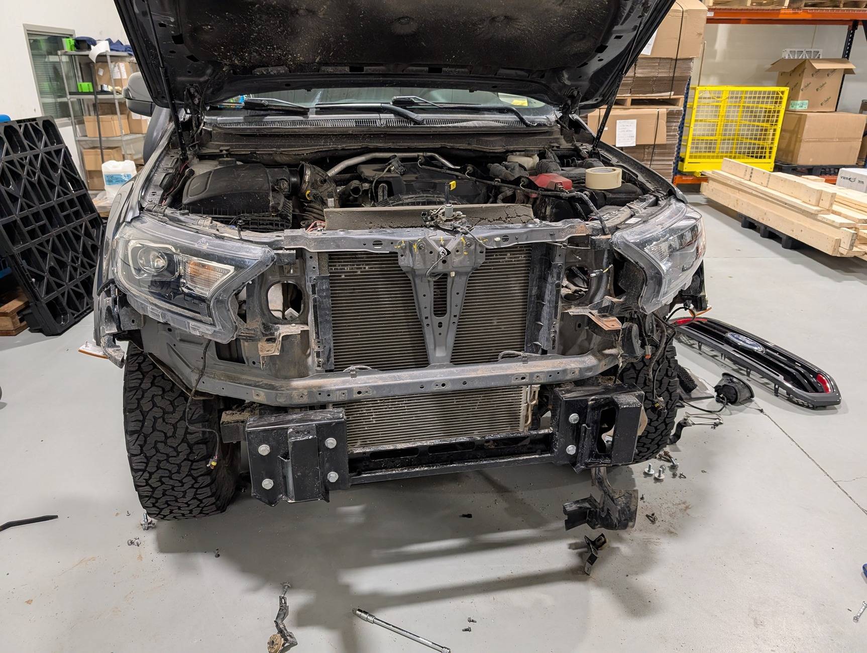

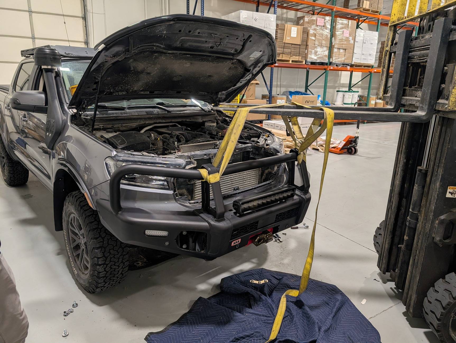

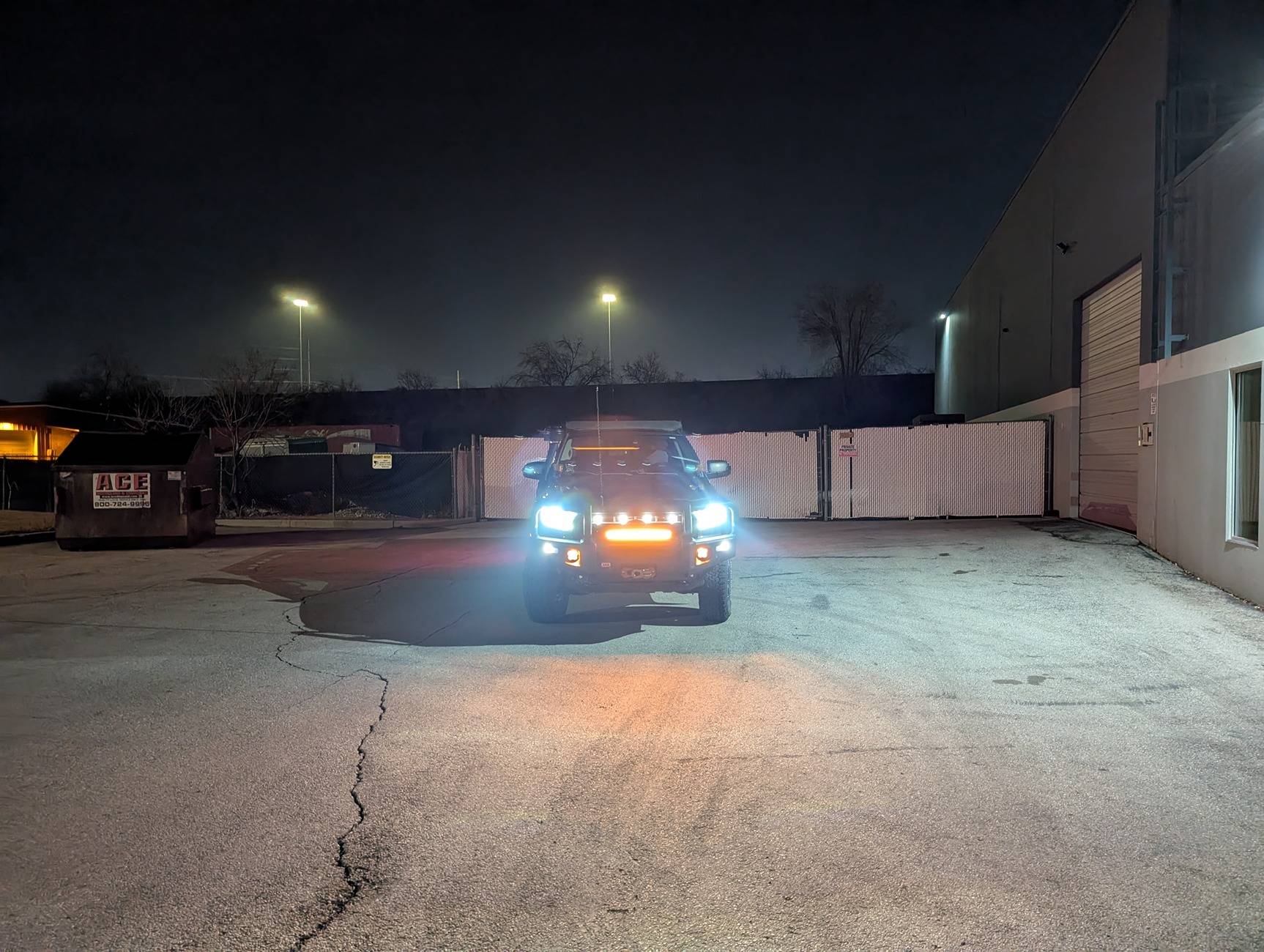

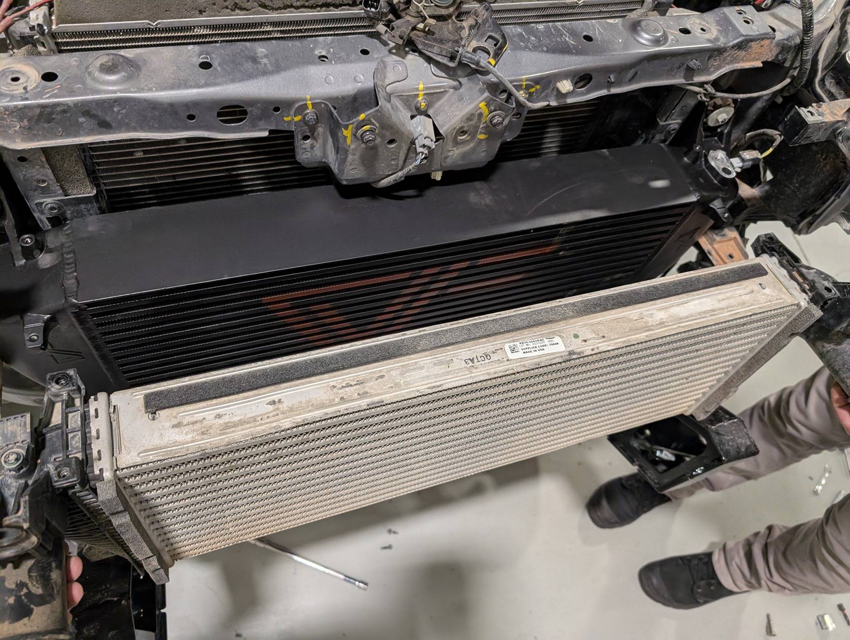

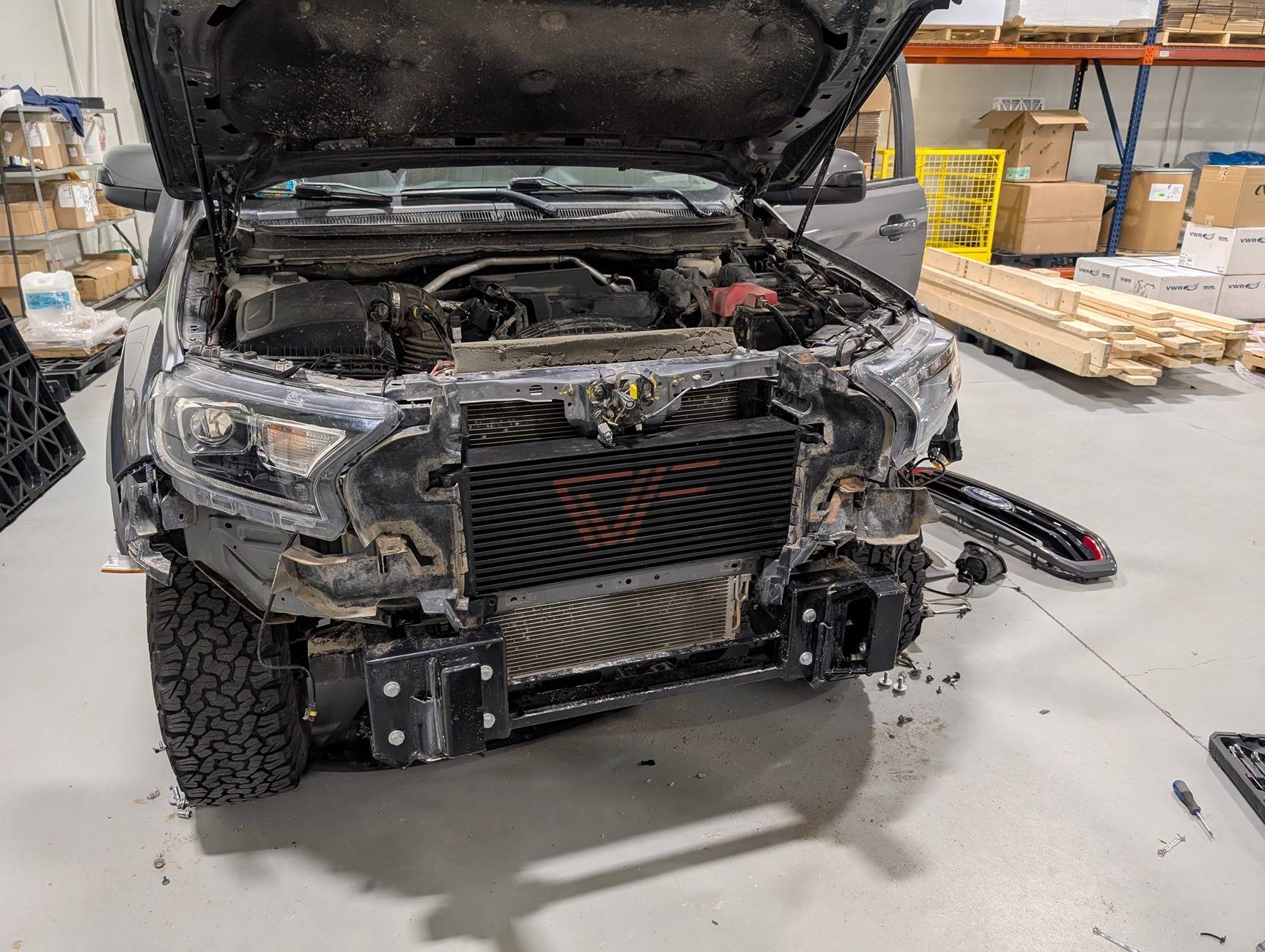

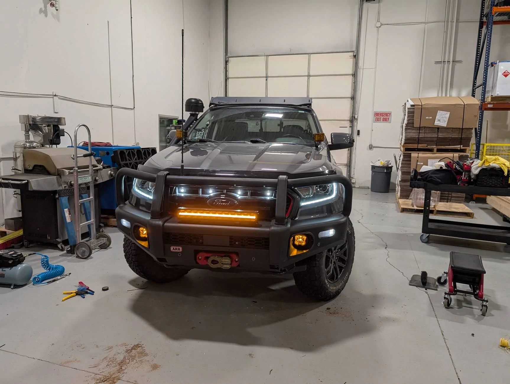

Swapped out the crappy ARB Fog Lights for some nice diode dynamic fog lights, added new charge pipes and an intercooler from CVF. What an nightmare. I can tell right off the bat the Ranger is a lot more responsive on the on the throttle and makes more turbo sounds.
I am sad to report for @Colo_Ranger and @Dhouse ...I tried my damnedest, but you have to remove the bumper and the facia. I could not get the grille out with the bumper on and could not extract/install the old/new intercooler with the facia on, that or I am not skilled enough. Luckily for me I set my bumper up so I could remove it a little easier....Still a PITA. Took me all day with help.
I also didnt take a pic of the charge pipes, unless you knew what you were looking at they honestly look pretty standard.
On a side note while I was looking for for the fitment instructions so I could re-torque all the bolts I noticed ARB has removed the fitment instructions and Summit bumper for the 5G from their website.
It do be thicc though
I need to re-orient the left fog light :(

Nice !

Looks good! What brackets did you use for the fogs?
