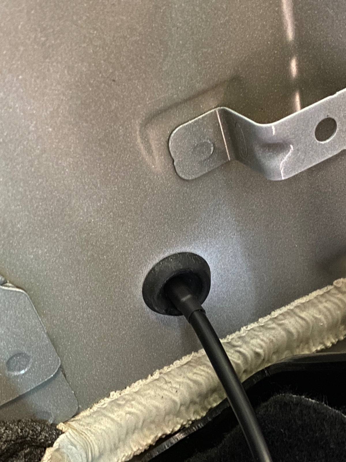

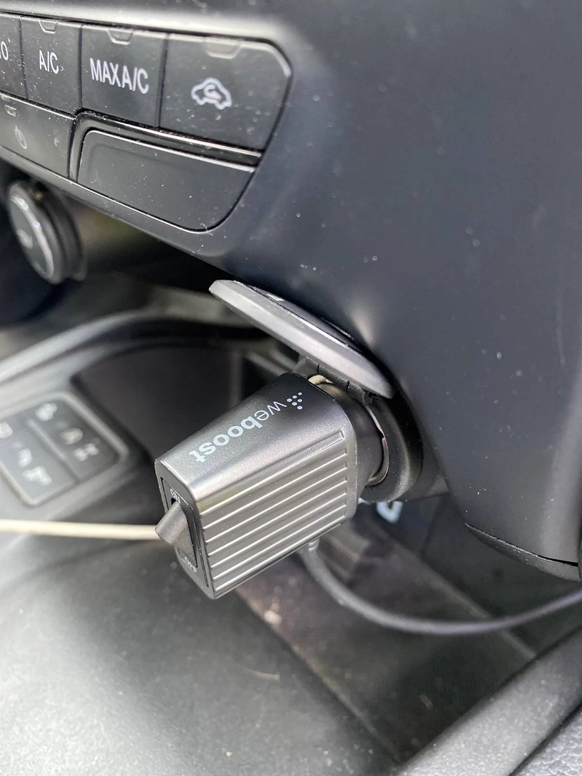

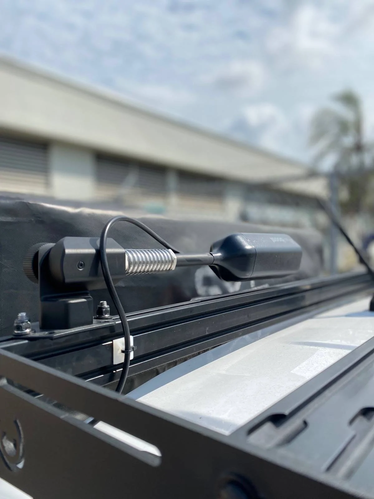

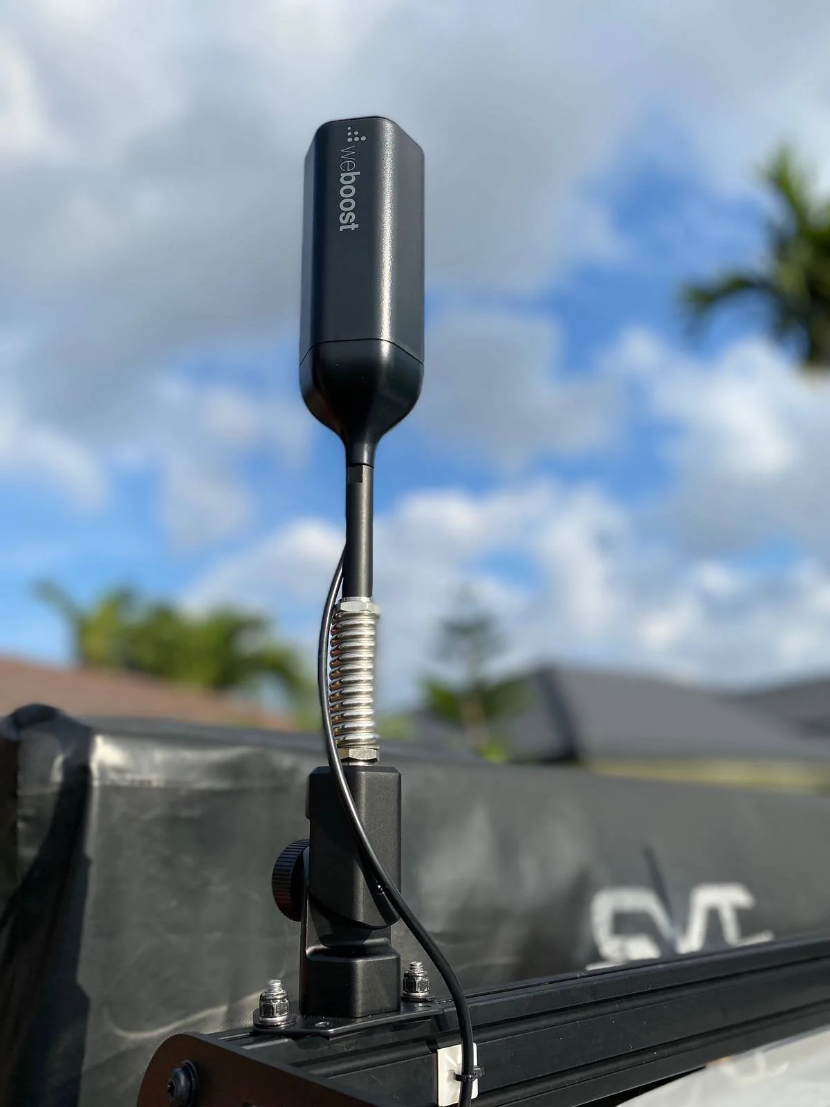

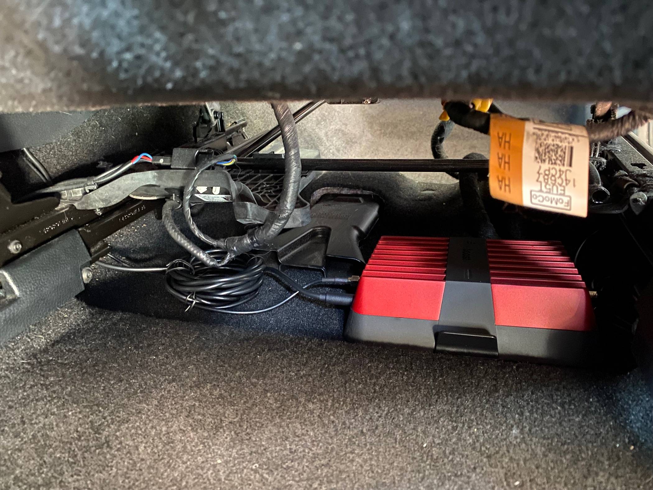

Last weekend I installed a WeBoost Overland Cell Booster. Mounted the antenna without the mast on the passenger side rear of the Prinsu Rack. Cable was sent down between the cab/bed, and enters into the cabin via a grommet on the lower half of the cabin. The main unit was placed under the passenger seat, and interior antenna was ran through the dash tray, and behind the dash to the center console. Took a quick trip into Big Cypress Preserve and the unit was able to pull one, and sometimes up to two additional bars of service.
