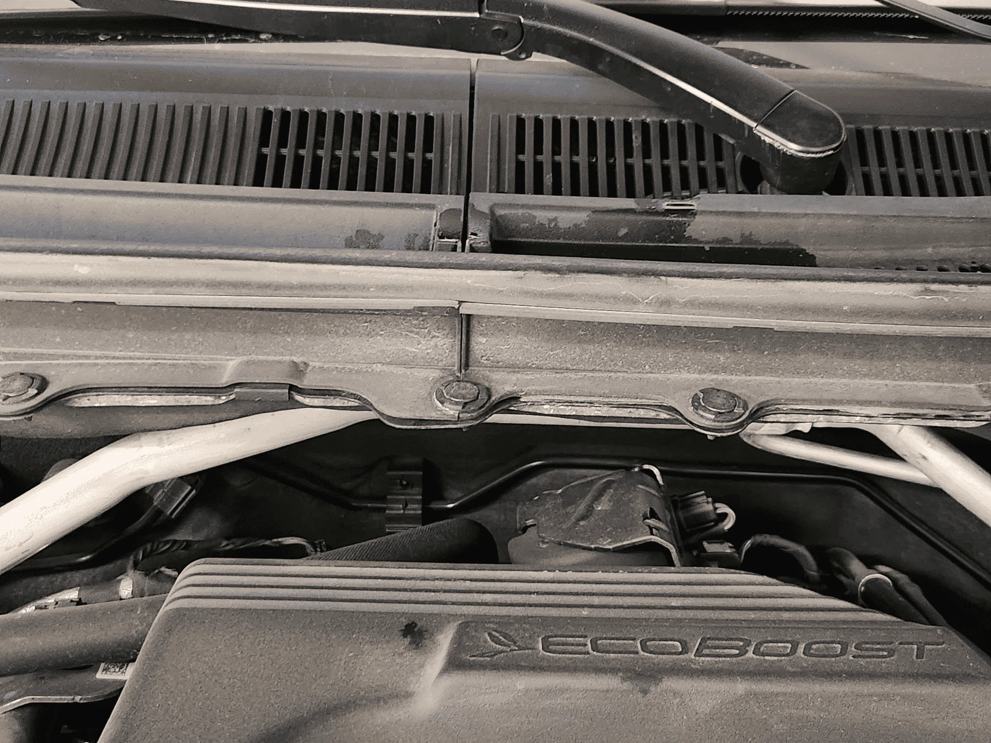

I also tackled the mouse prevention screen on the Air Inlet Cowl.
Used a 120 Grit sanding screen and some HVAC Tape. Hard to make it look pretty with such a small space for access. (but it works)
Note: I park in garage, but still wanted to take the extra step to prevent entry into the cab. No rodent evidence noted in the engine bay either.
As the cowl was put back together, I added some RTV in the seam between the (2) halves, not pictured. This is the water drip point down to the top of the engine, again this was just an extra step of PM to prevent any water making it down to the spark plug wells.
I added some flashing tape over the seam as well.

Where do you pull the cowl out at? Anyway you can post up a pic of where to start on that? I cant seem to figure that out... tried several times. thanks a million!
airline tech
Aug 24, 2022
4,482
8,551
Midwest - KS
Aircraft Tech
Pull the push-pins out (passenger side) and it will lift up and out of the way
The push pins are the small plastic plugs on the front side of the cowl, you will have (1) not picturted in the upper corner of the passenger cowl.
The vented part = the cowl
Under this plastic cowl is where you can see the inner metal cowl (inlets) for the Air Inlet (Recirculation Door)
