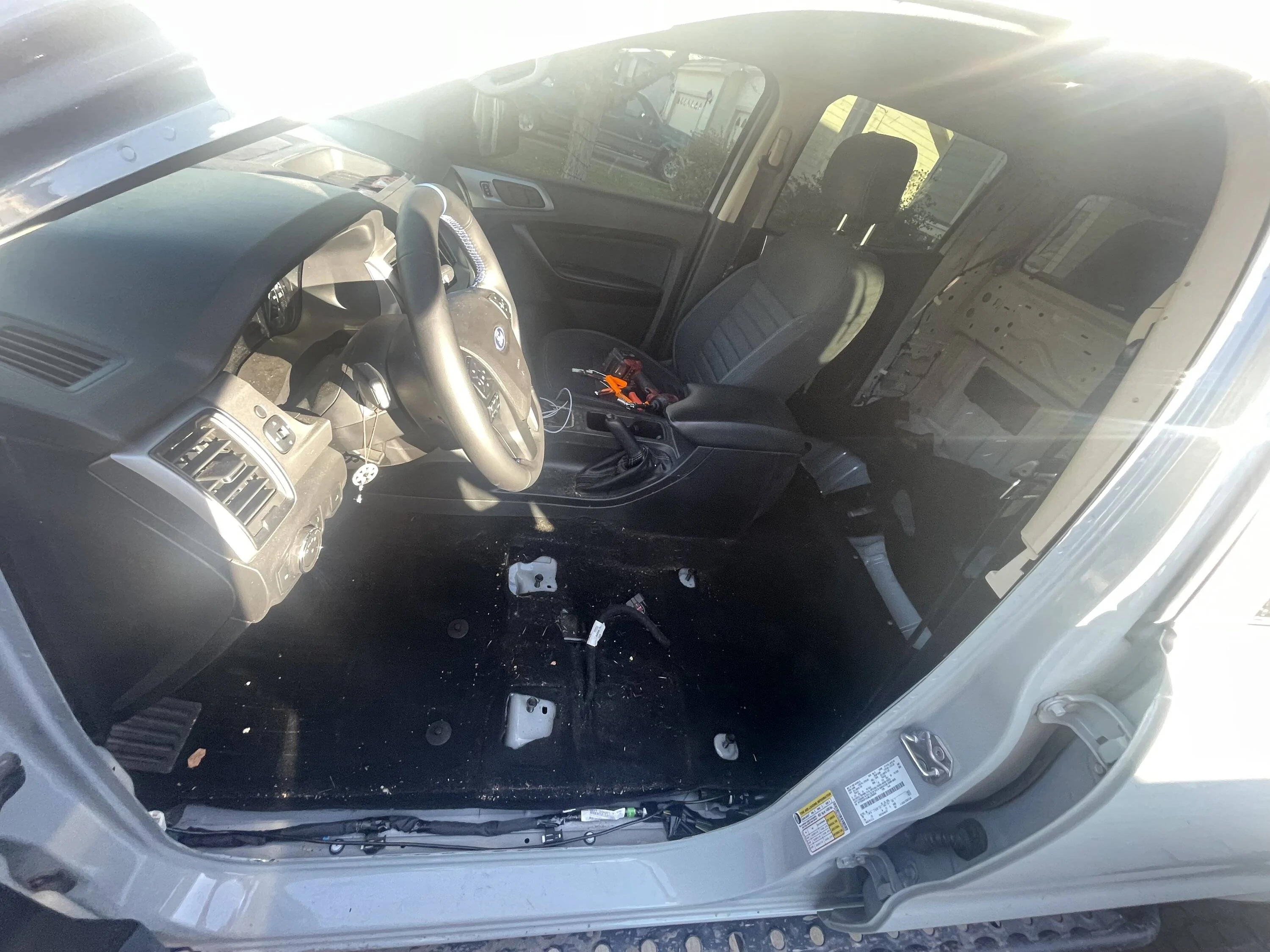

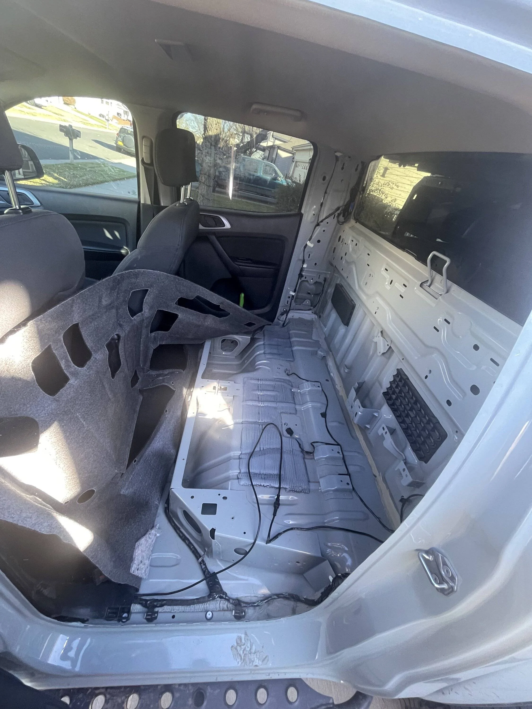

Removed the full interior to do sound deadening tomorrow in the whole cab
Cool, this is on my - Things I want to do list, mainly the head liner, driving in the rain sounds like being in a tin roof barn.
But, while you are there, I was curious about mice entry points, since some have reported evidence at the center console and stowage areas under the rear seat.
Known - Positive / Proven entry point is the Air Inlet behind glove box, my theory is that is the only entry point, and they travel down the transmission hump (Valley - Under the Carpet) and stop at the open areas (Resorts) this being under the center console and go exploring further back and find the wide-open spaces in the cubbies under the rear seat.
Other Theories from members are - The Rear exhaust air grilles and the open holes in the cubby boxes. I am wanting to know if you see any other entry point from the exterior for mice other than the (Known / Proven One.

I’ll take a look today as I install the material. I’m not taking the center console out though I don’t think I will get enough return for what is worth. You only need 80% coverage for a complete improvement in noise. The base is well padded also compared to the back is just the thin carpet so no noise reduction.
The rear vents are a possible point as mice are tiny. Doubtful as the flaps close and all but definitely could be opened if determined. I’ll snap some pics for you.
I think the main inlet would be from the front air intake for cabin air though.

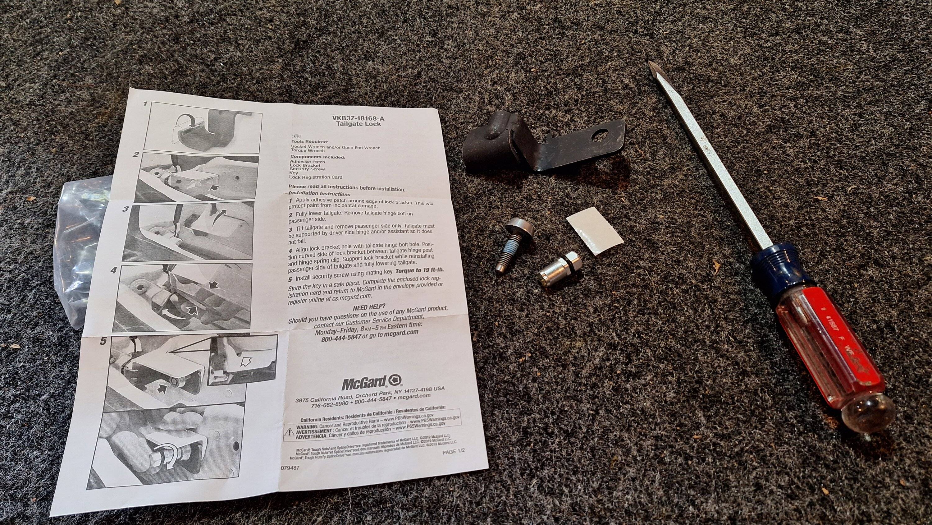

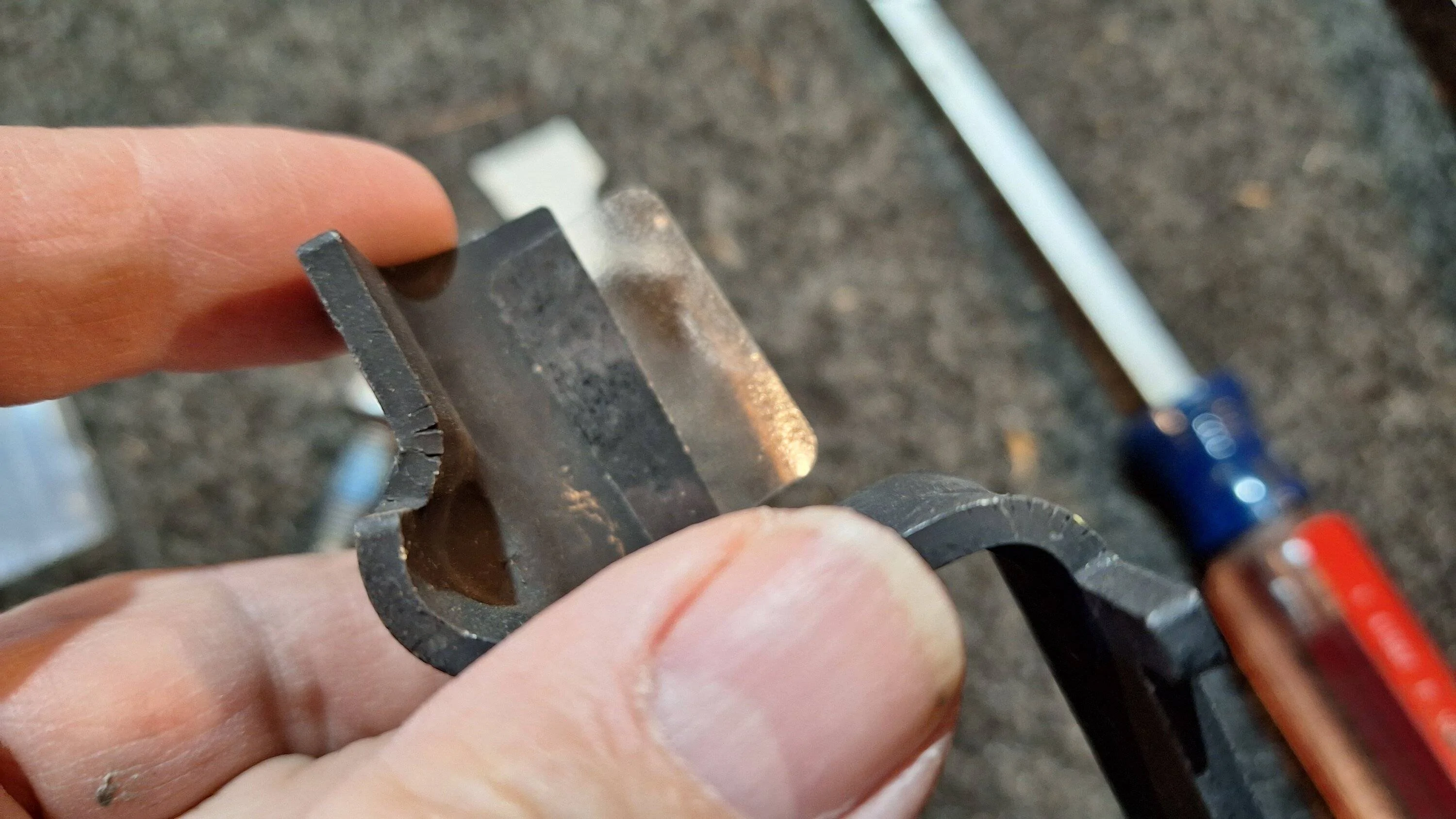

first aggravation was peeling the backing off the "decal" they include, seems pretty useless ... note the tab on the far right pointing into the camera

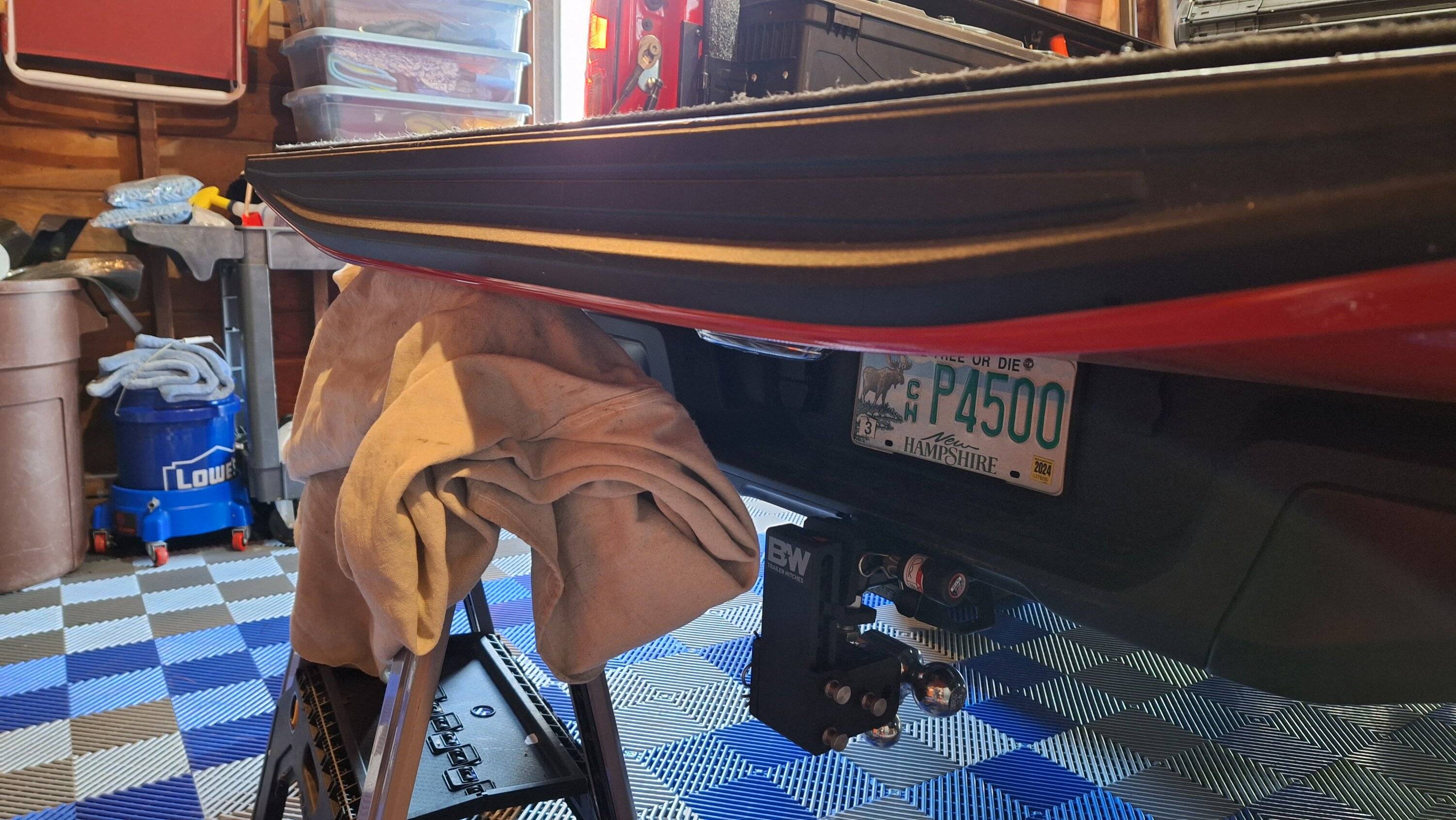

Cheech is too short to help, so I did this to support the tailgate (don't look at my plate #, oh no ...)

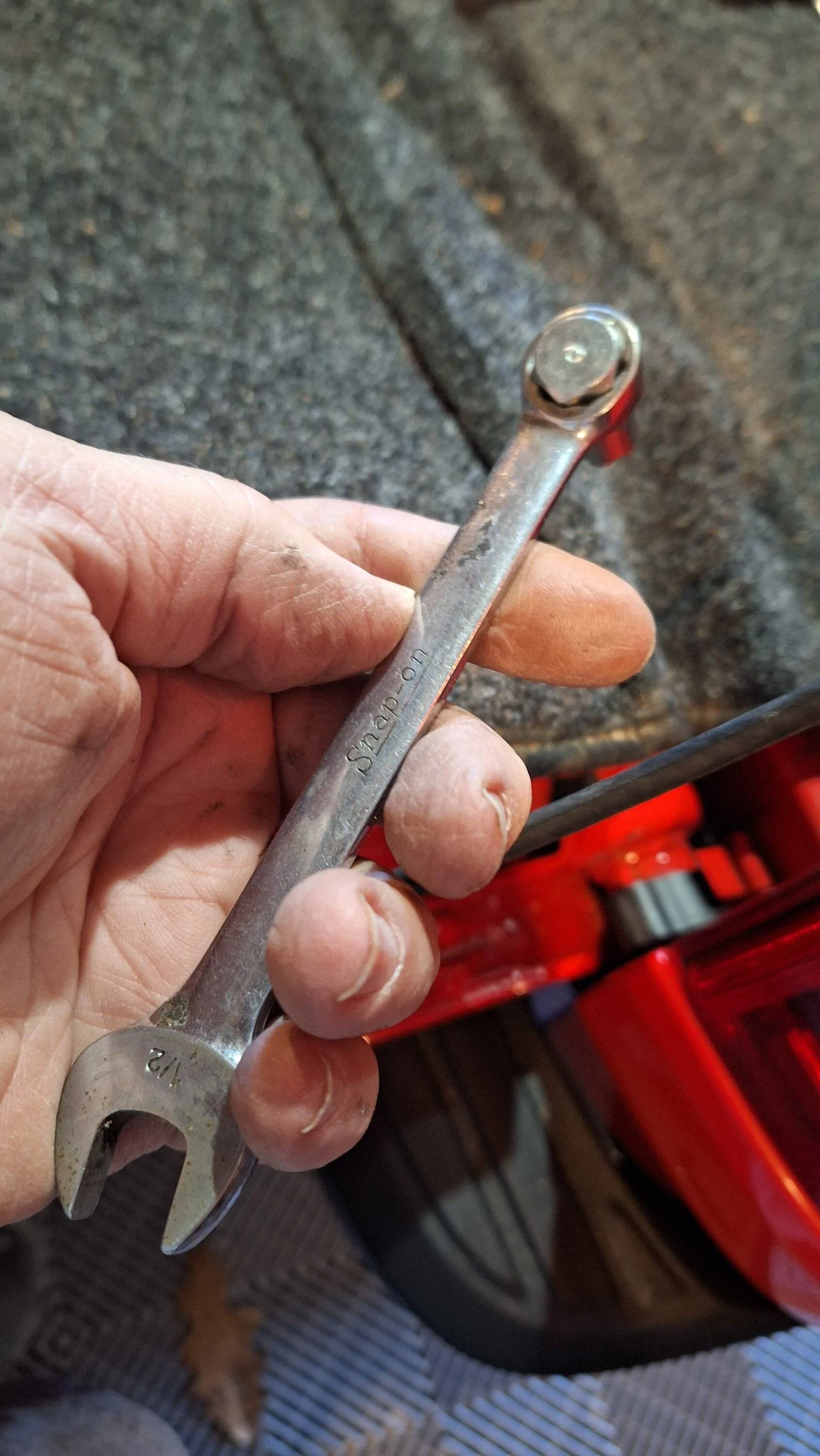

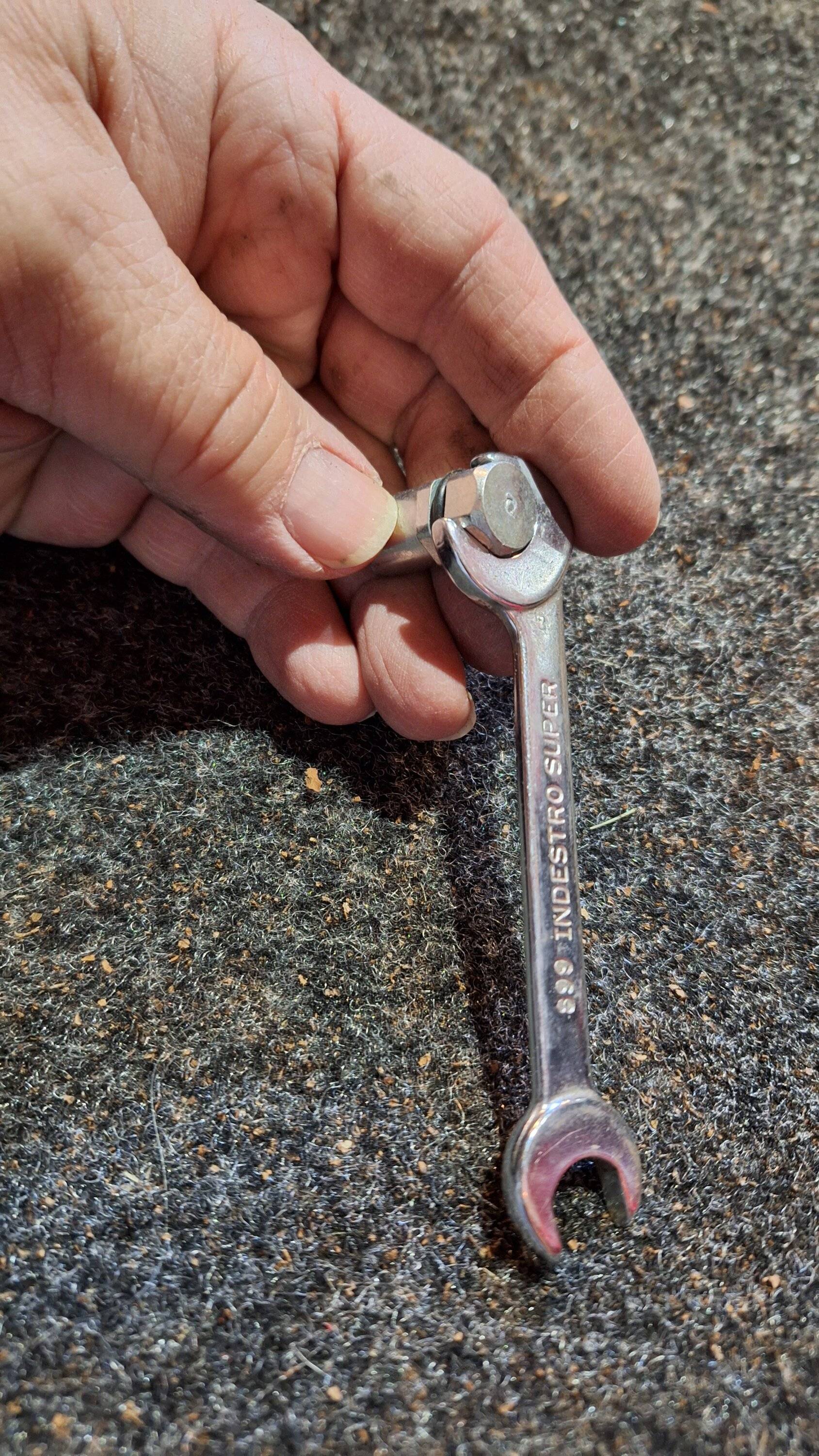

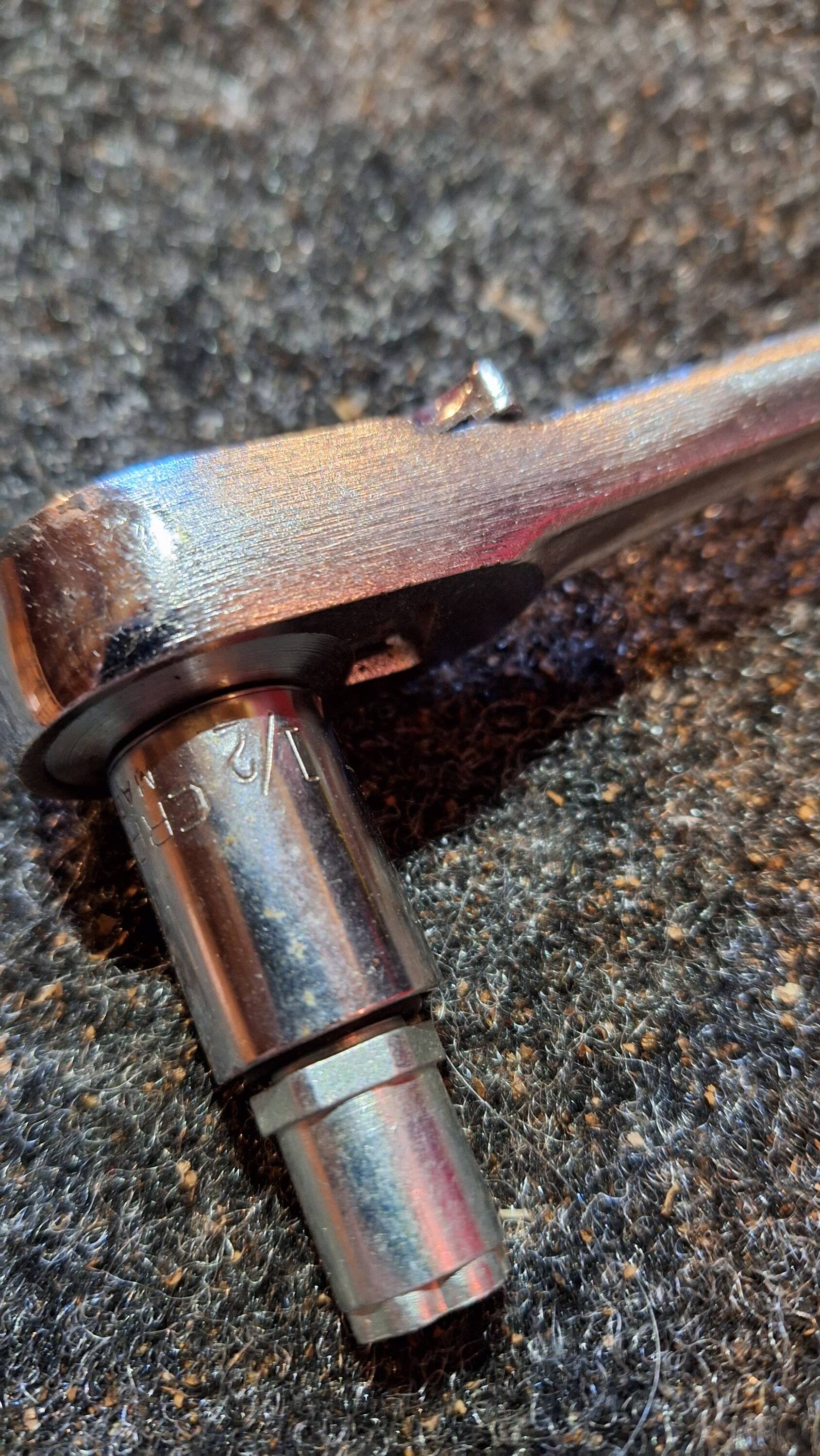

duh, of course the driver is SAE at 1/2" ...
ratchet too big, trying an offset ignition wrench
thank God for the o-ring on the driver to hold it in a regular wrench (almost used new Knipex pliers wrench but was too aggravated to go to the basement bathroom to get it)

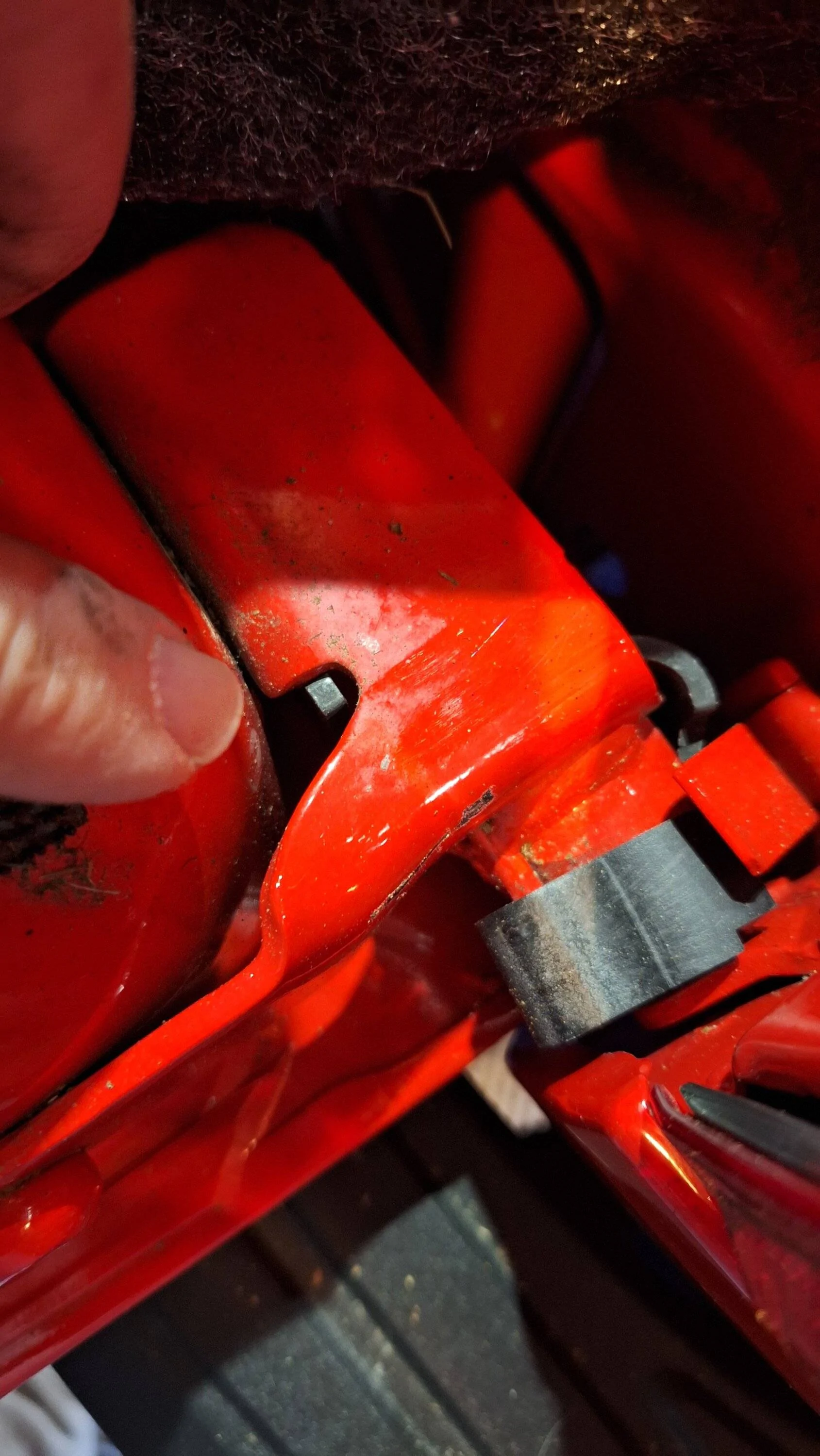

For anyone trying to decipher this next pic, the tailgate is on the right and bed is on the left and the camera is facing out to the passenger side.

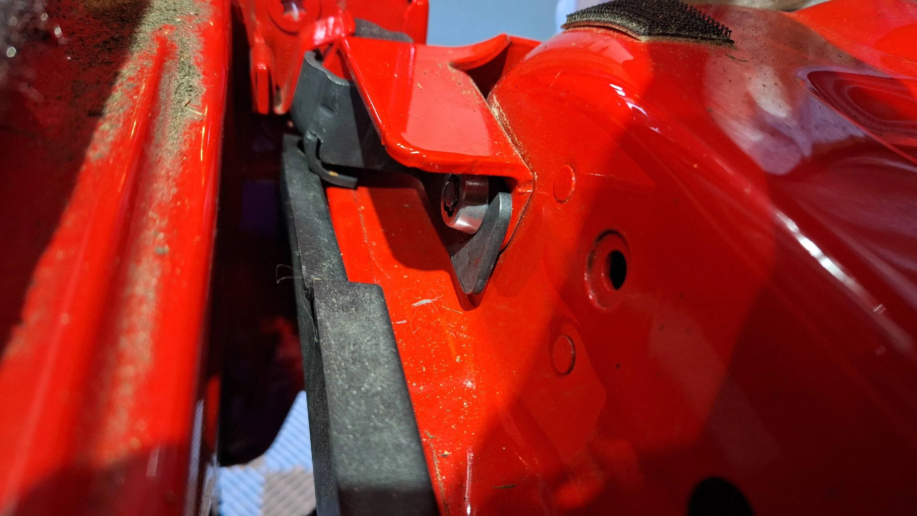

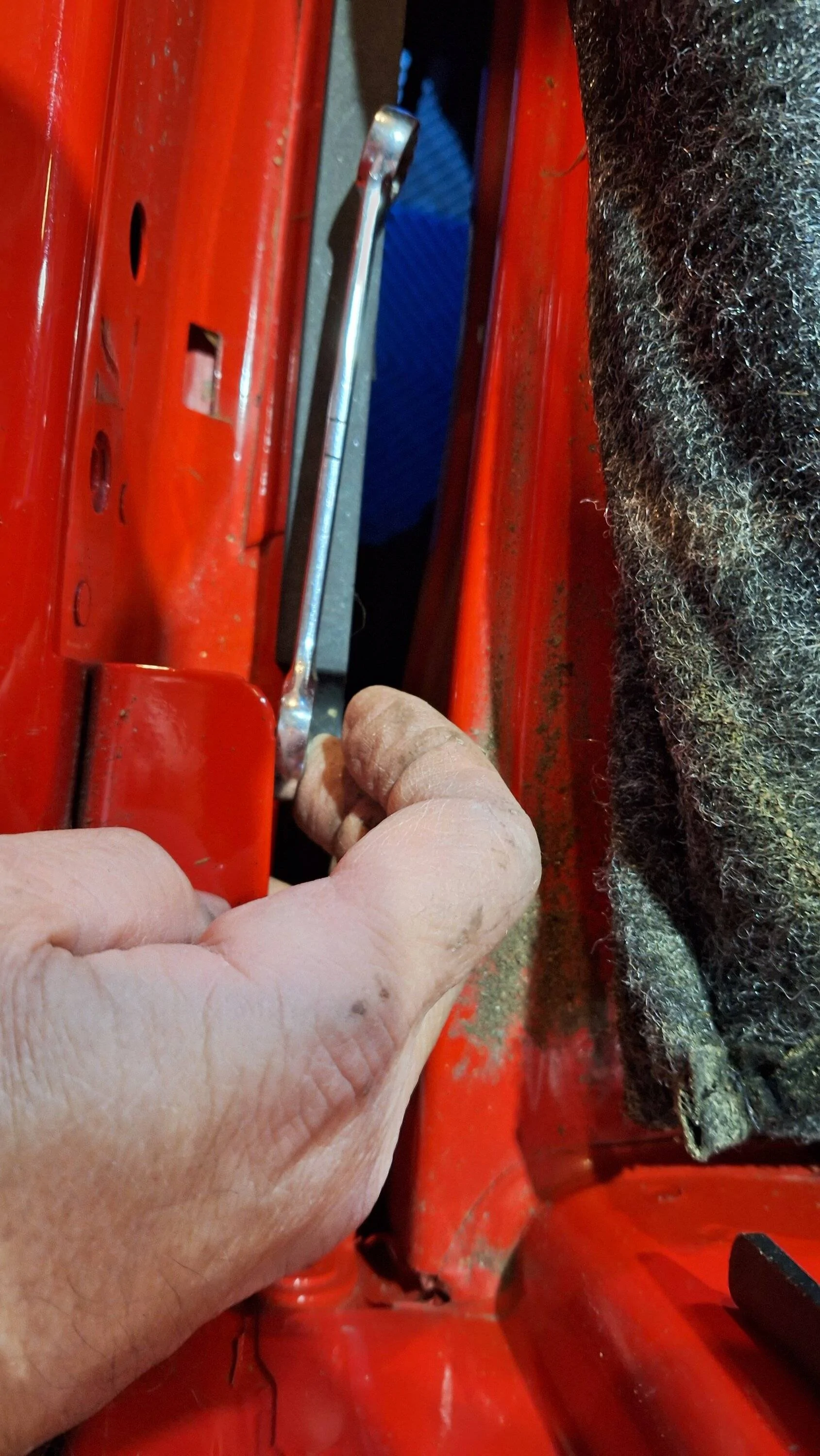

I held the tailgate open at about 45° with my hand holding the McGard bracket from underneath (arm outside of tailgate) and clipped the tailgate back in (I put the actual plastic clip on later).

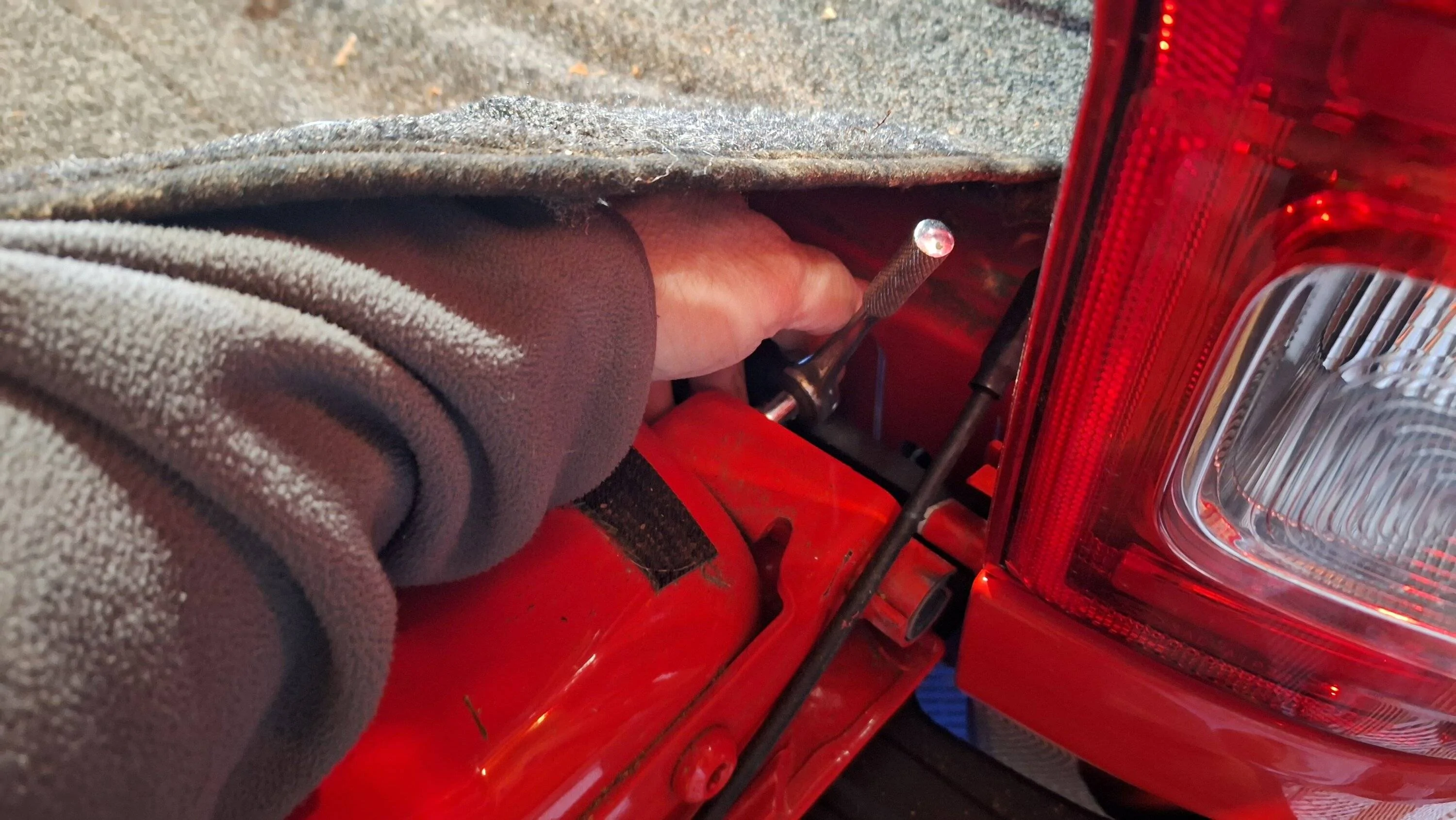

Keep holding the bracket and close the tailgate. Then feel the bolt hole and line them up with your pinky. I started the bolt by hand for several turns (that was a tight fit with sausage fingers and more cussing).
Then I opened the tailgate and drove the bolt home (pic above). Btw, you don't need to unclip the tailgate cable.
make sure this tab is visible here before moving the tailgate too much and before putting the bolt in
