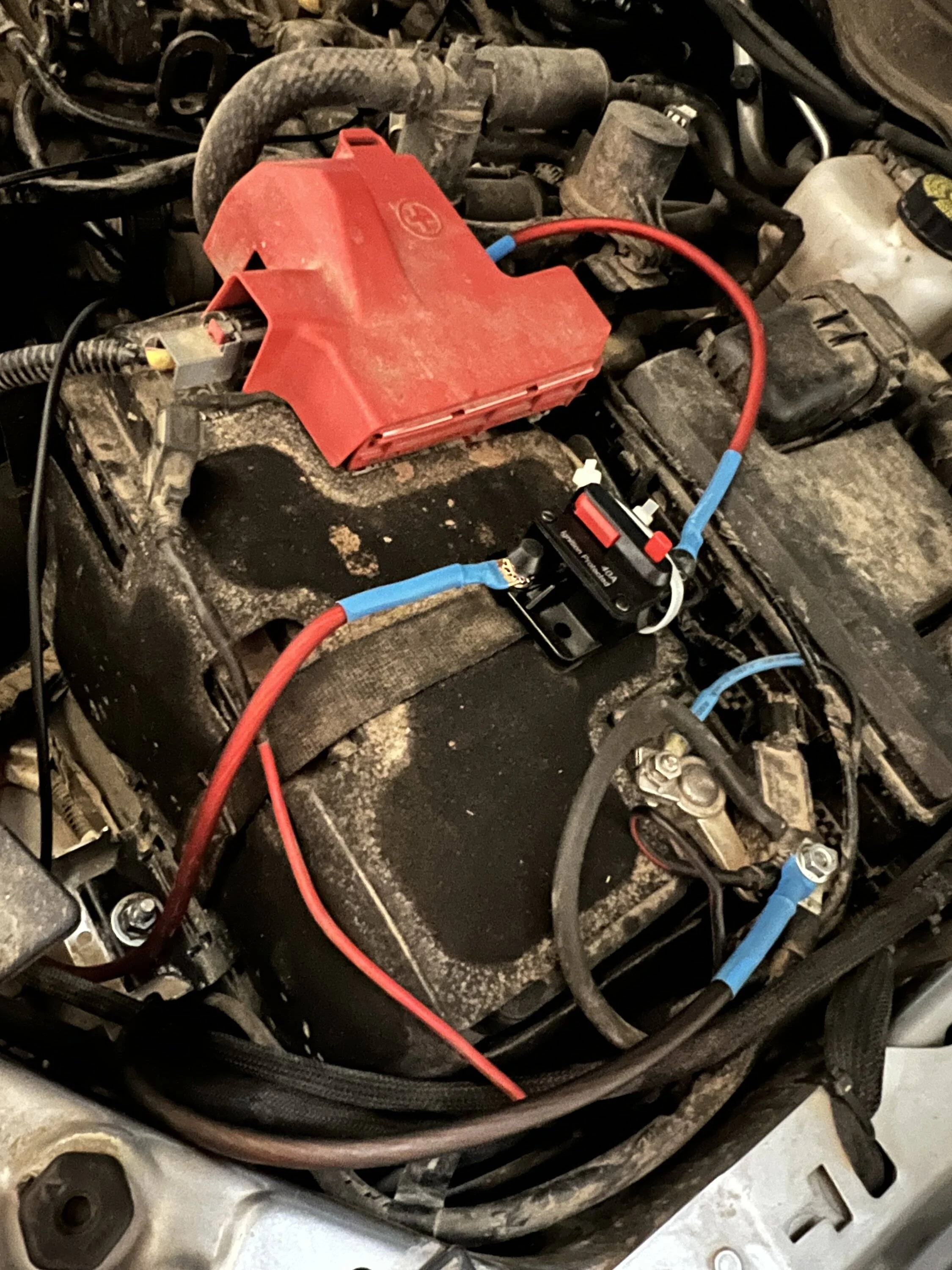

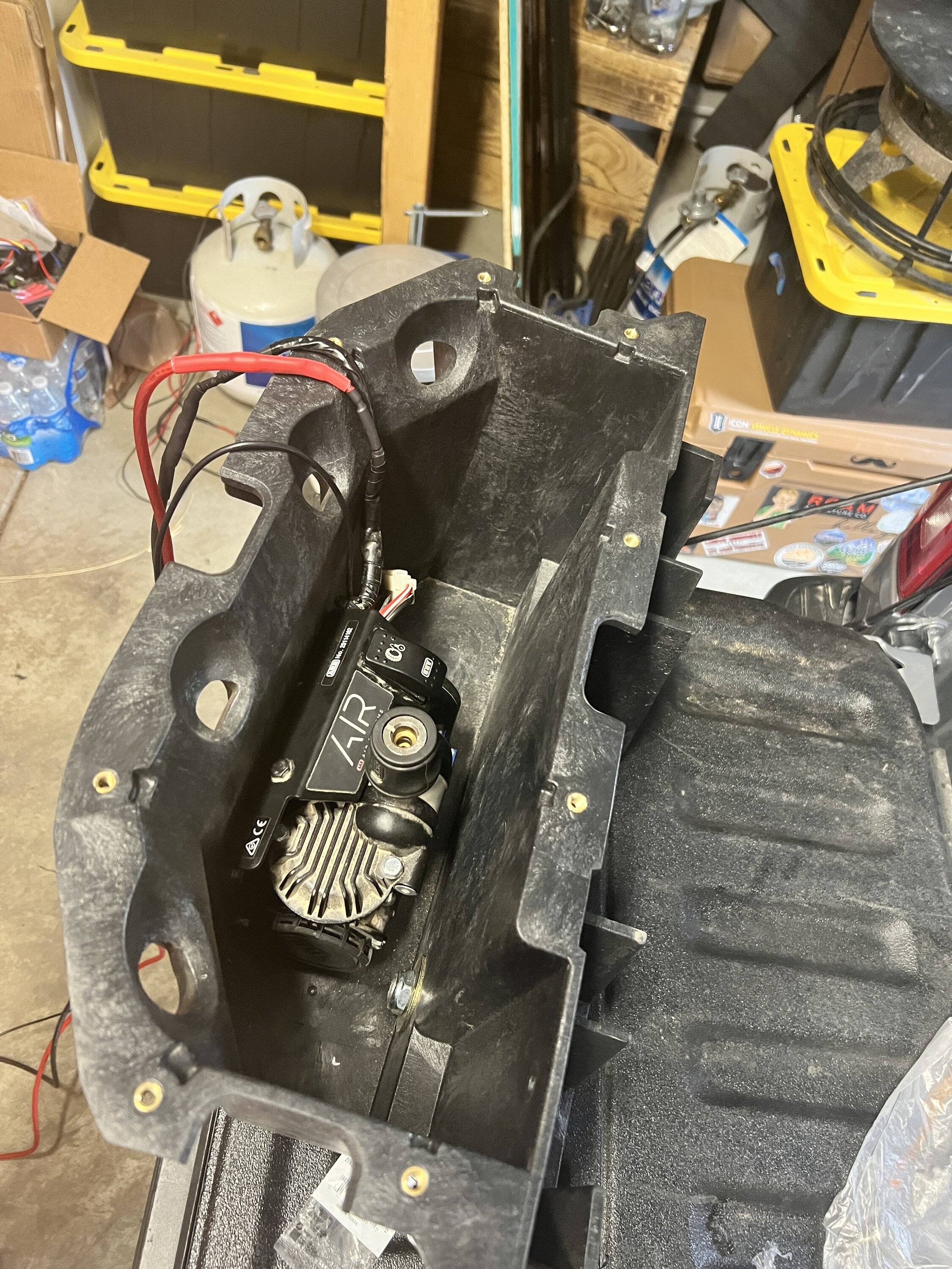

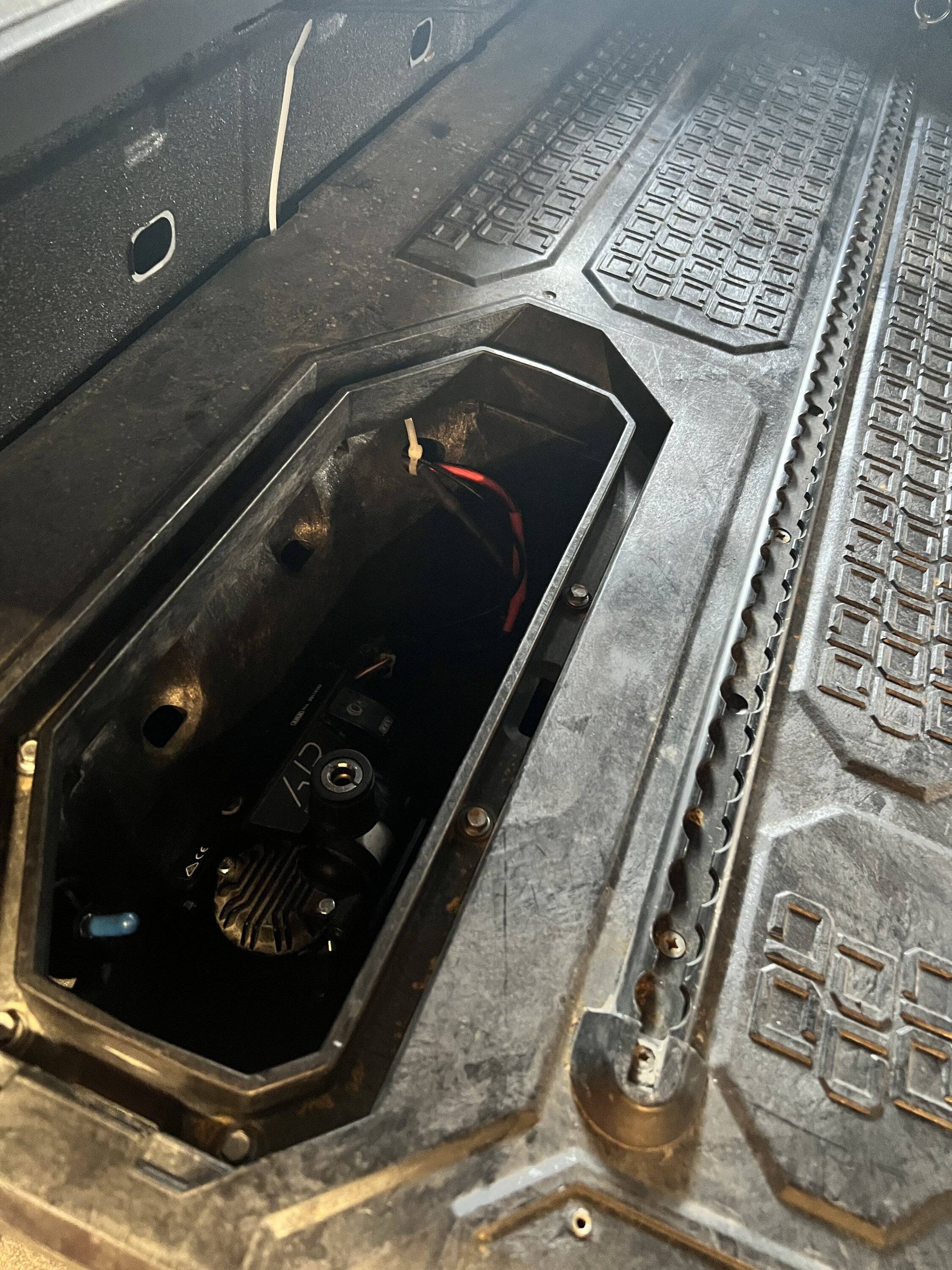

Today I tackled a big project. I installed the ARB single in the Decked ammo can. I ran the wire down the frame to the engine bay and then wired it through the 40a breaker. Breaker location is temporary, I think, since I have a lot more wiring to do, but it works for now. Next up will be removing my Auxbeam controller and installing my Lightforce switch panel. When I do, the switch wire for the relay will be moved to my Lightforce and everything else can stay the same (or be adjusted. I have to run 7 wires through the firewall for the switches, a power and ground for my GMRS radio, and the antenna cable. I am moving the antenna and, in my wisdom, I bound the power/ground and antenna wires together when I ran them last time... so I can't pull one without pulling them all. Its okay though, it will be worth it in the end.

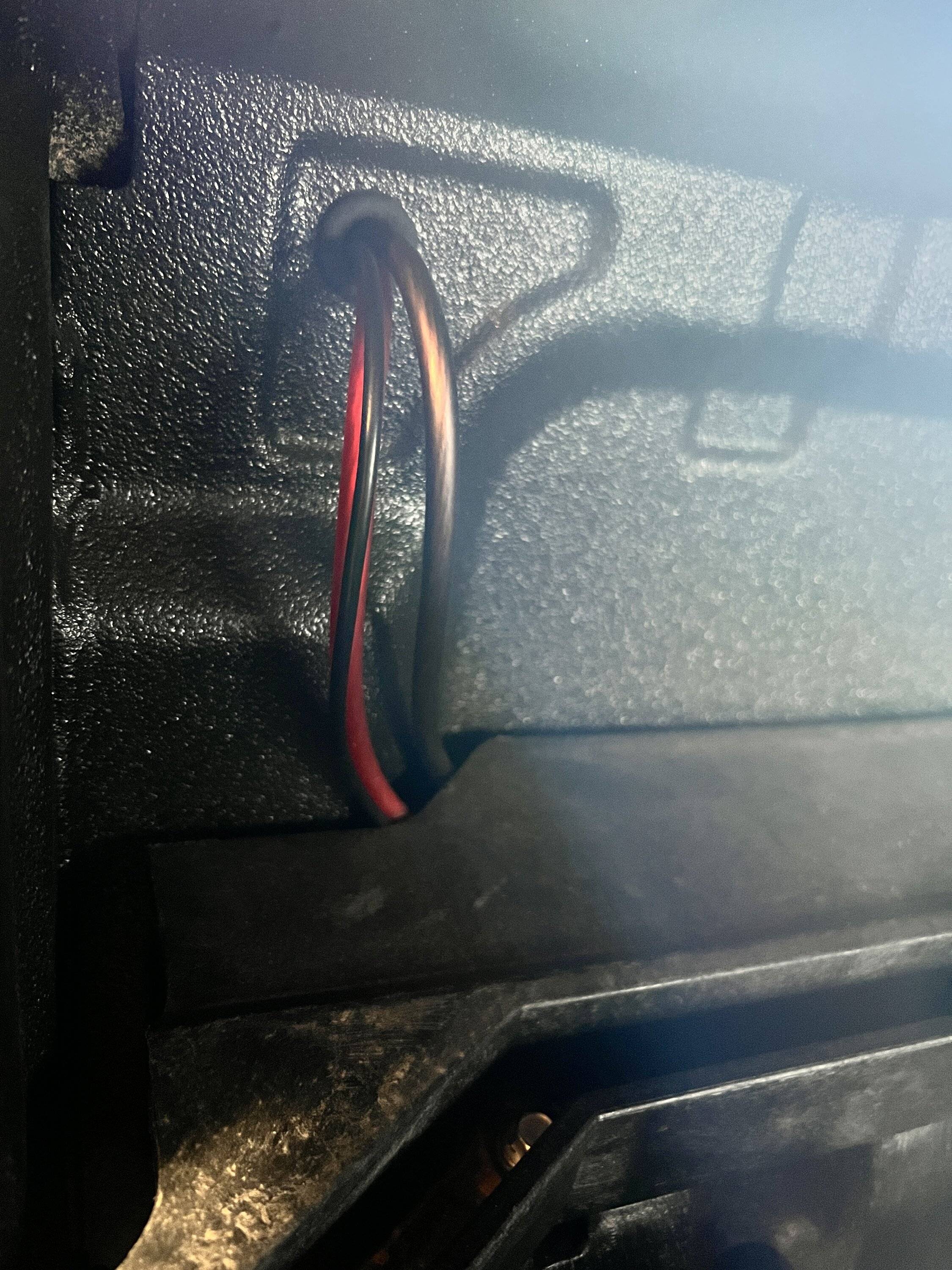

I do want to do something to the wires coming up from the ammo can to the bed, most likely electrical tape to make it stand out less and make it harder to catch on things. I may also pull the wire and reroute the entire thing through somewhere else, if I end up catching it on things. I had to pull the entire left side of the Decked out, so it was no short task.
All in all, I am quite happy with how it turned out. Tomorrow I will probably sneak back under the truck and make sure that I zip tie the power/ground/switch wires so they don't move. They were routed pretty snugly, but you can never be too sure.

Buy a roll of that plastic like wire loom from Amazon, it will look better than electrical tape in the long run...
Also, could the wire run to the front of the bed and out one of the front bed grommets?

I don’t like the plastic loom. I have this mesh stuff, but it’s not big enough for the 8 gauge (x2) and trigger wire. I thought about running it through the front grommets like you’re talking about but it meant I’d have to pull the decked completely out which, yesterday seemed like too much. I’ve been fighting a cold and got tired and tunnel vision. I will probably do that, but it’s does make for a lot of extra work.

I've had some time to think about it and I ordered the linked above. I actually have that stuff in 1/4 and 1/8 size, but ran out of the 1/2" size. It will be delivered today. Tomorrow will be R&R of the Decked so I can cut an 'x' in the rubber grommet at the front of the bed, then down under the cab and back up to the engine bay. This project is about rewiring all my devices so I am happy, which means I get to do this a second time.
