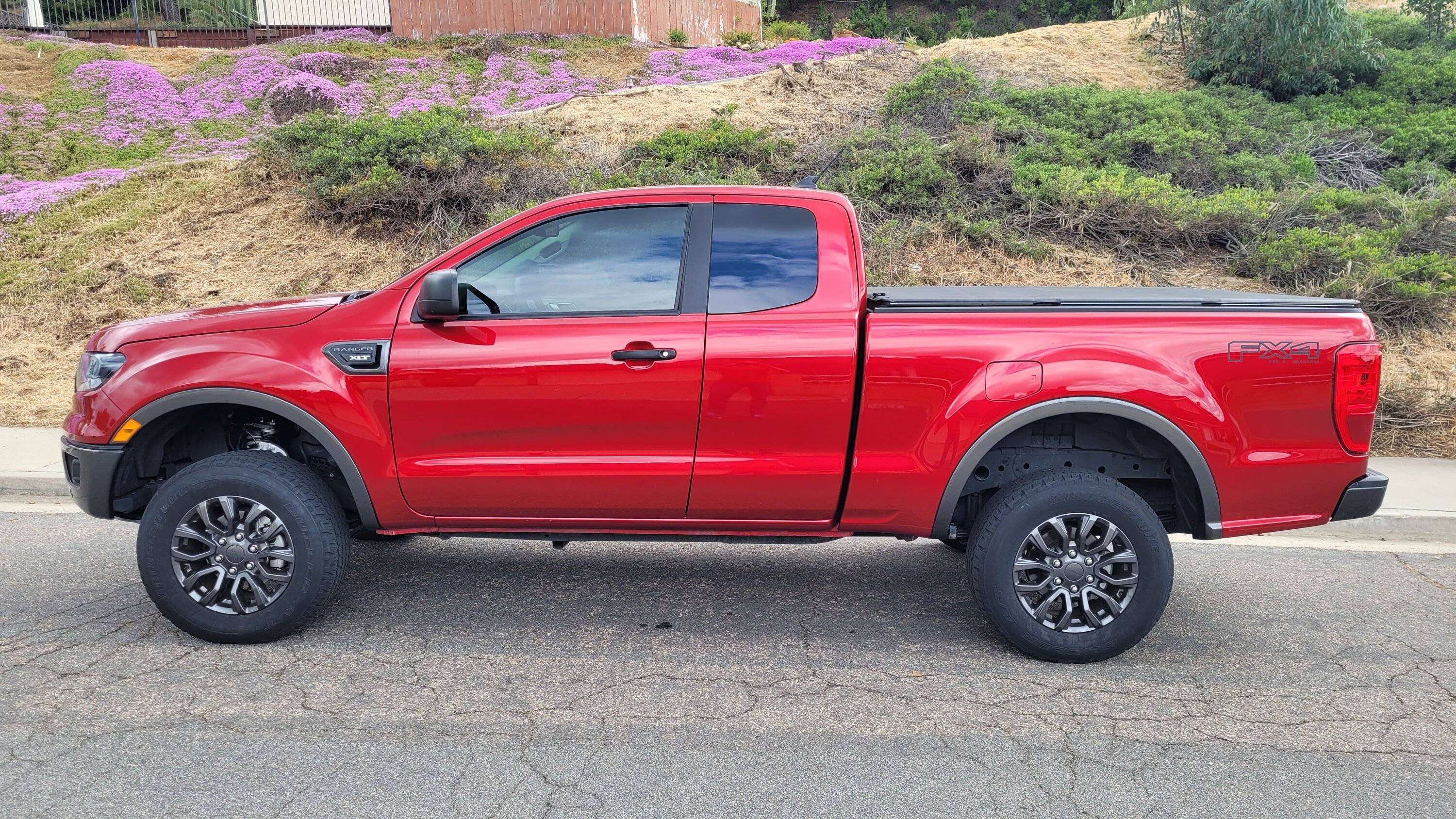

I installed the Eibach Pro-Truck Stage 2 kit with rear reservoirs and SPC upper control arms. It took most of the morning. I installed the rear Global Leaf Springs a few weeks back and it raised the rear over 3/4". I was measuring 39-1/8" at the rear fenders. As a result, I adjusted the front coils to a 2.5" lift overall. The rear still sits a full 1-1/2" higher.
The SPCs are one of the better UCAs out there. I picked them up for $600. They have rubber bushings - so no squeaking, they allow for easy camber adjustment, the ball joints are sealed with Zerk fittings, and they allow for more travel. I measured my droop before and after the lift. Even with the 2.5" lift, I only lost 1/8" of droop.
I did a preliminary alignment myself with the same string equipment and camber gauge that I use for my Mustang when I go to the track. She drives real straight, but I'm still going in next week to have the alignment dialed in. Now I need to decide if I want LT255/75R17 or LT285/70R17 tires.

Have you thought about 275/70R17s? They’re 32.2” and a bit more crash bar friendly than those 285s.

I thought about the 275/70R17, but I don't want a load range E tire. The BFG KO2 255/75R17 is 32.1" tall and much lighter. I like some of the advantages of a narrower tire, but I don't want anything less than 32".
