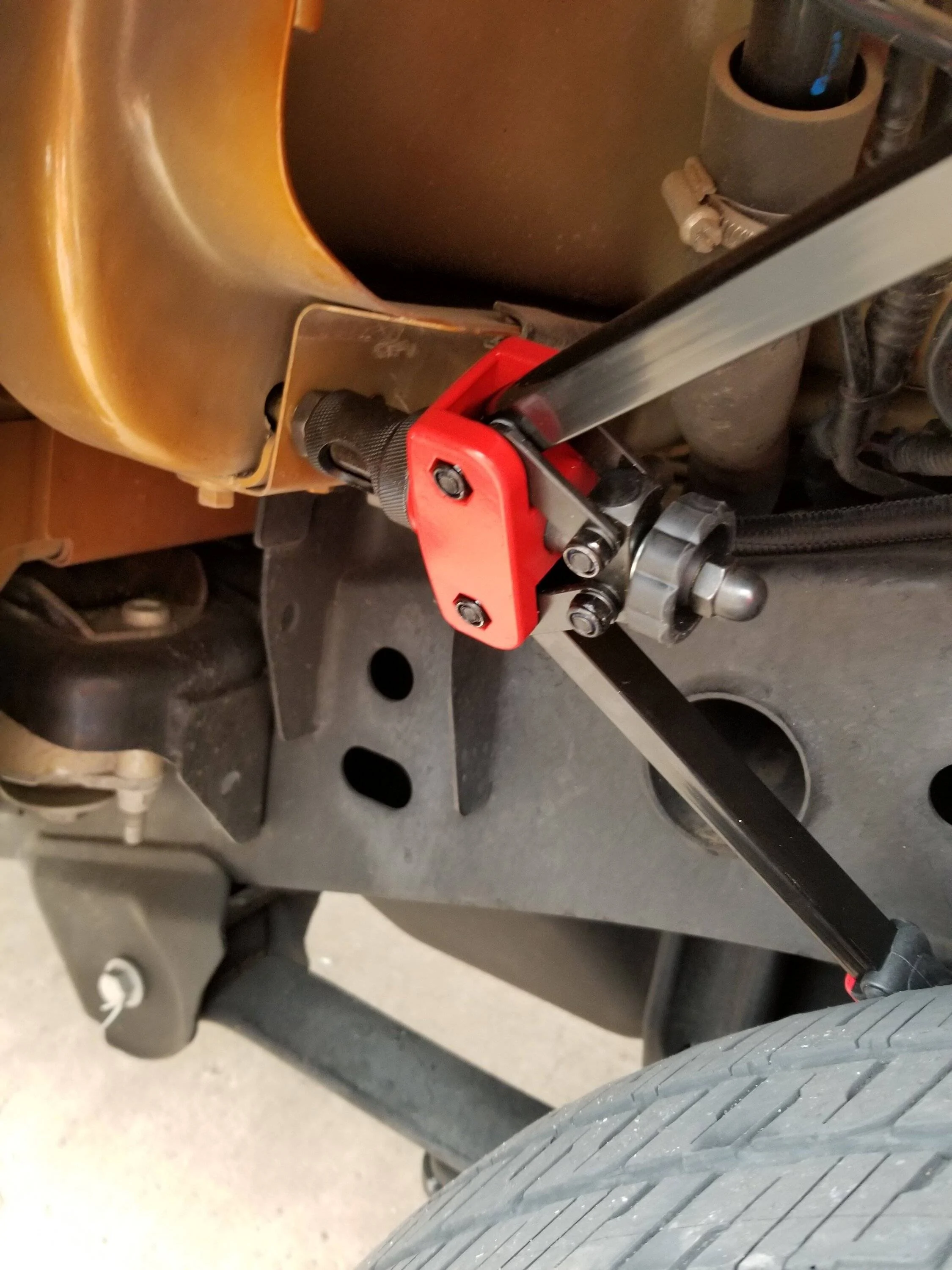

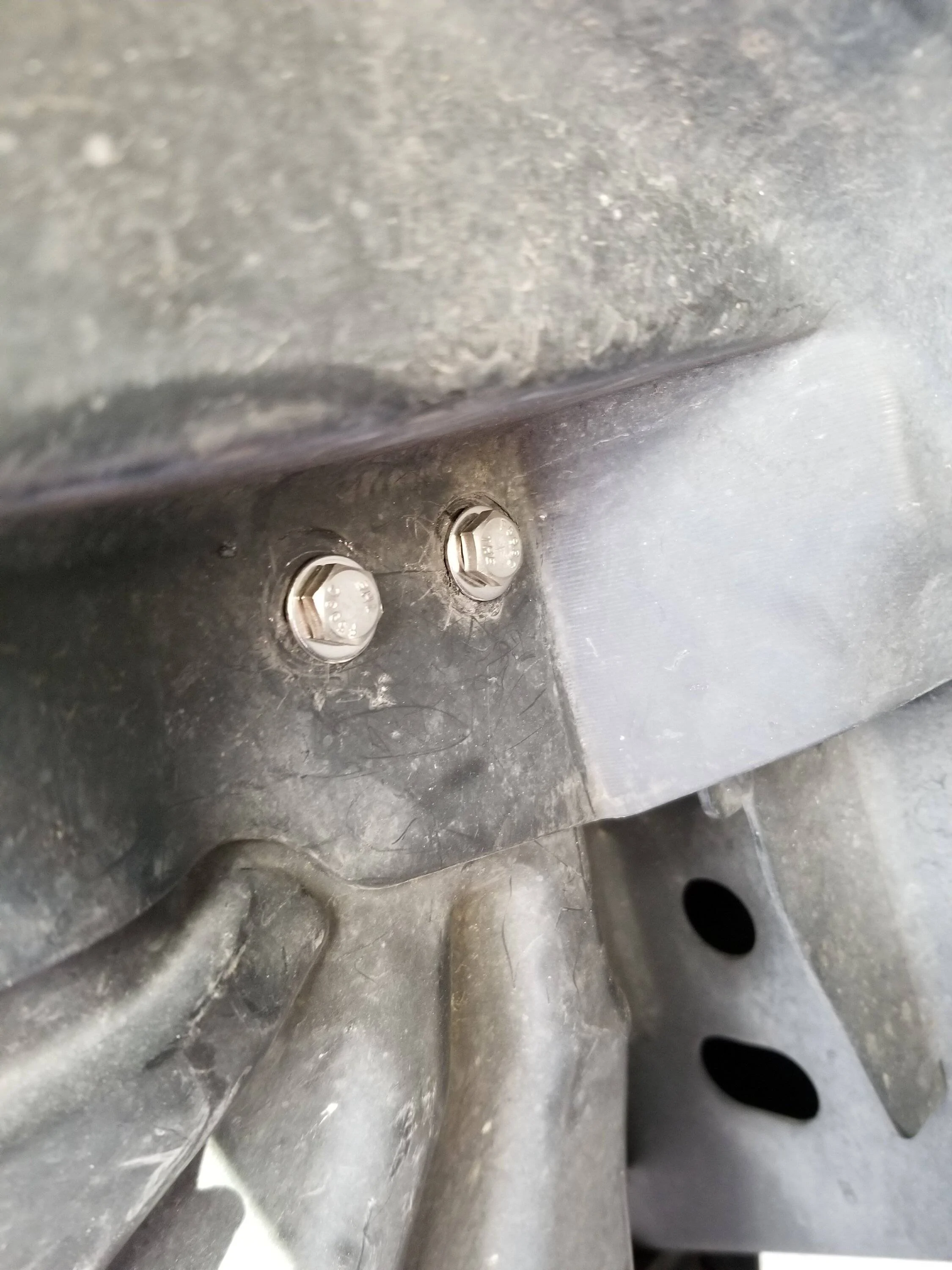

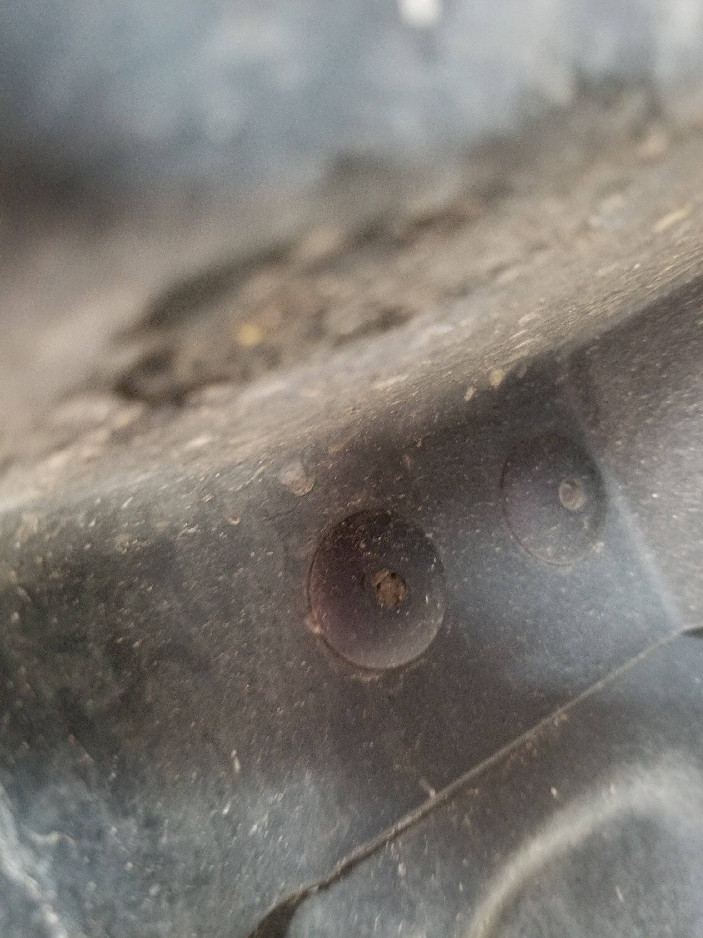

So I am working on adding a 13 gallon fuel cell in a tool box in the bed. It will pump into the fuel tank. First phase is getting access to the filler neck to add the connections for fuel and vent lines to the cell. If you have ventured to the liner under the rear fenders you find it has a bunch of plastic clips and 4 large pop rivets that have to be drilled to remove the liner. To make the area accessible I drilled them out and replaced them with 1/4-20 rivnuts.

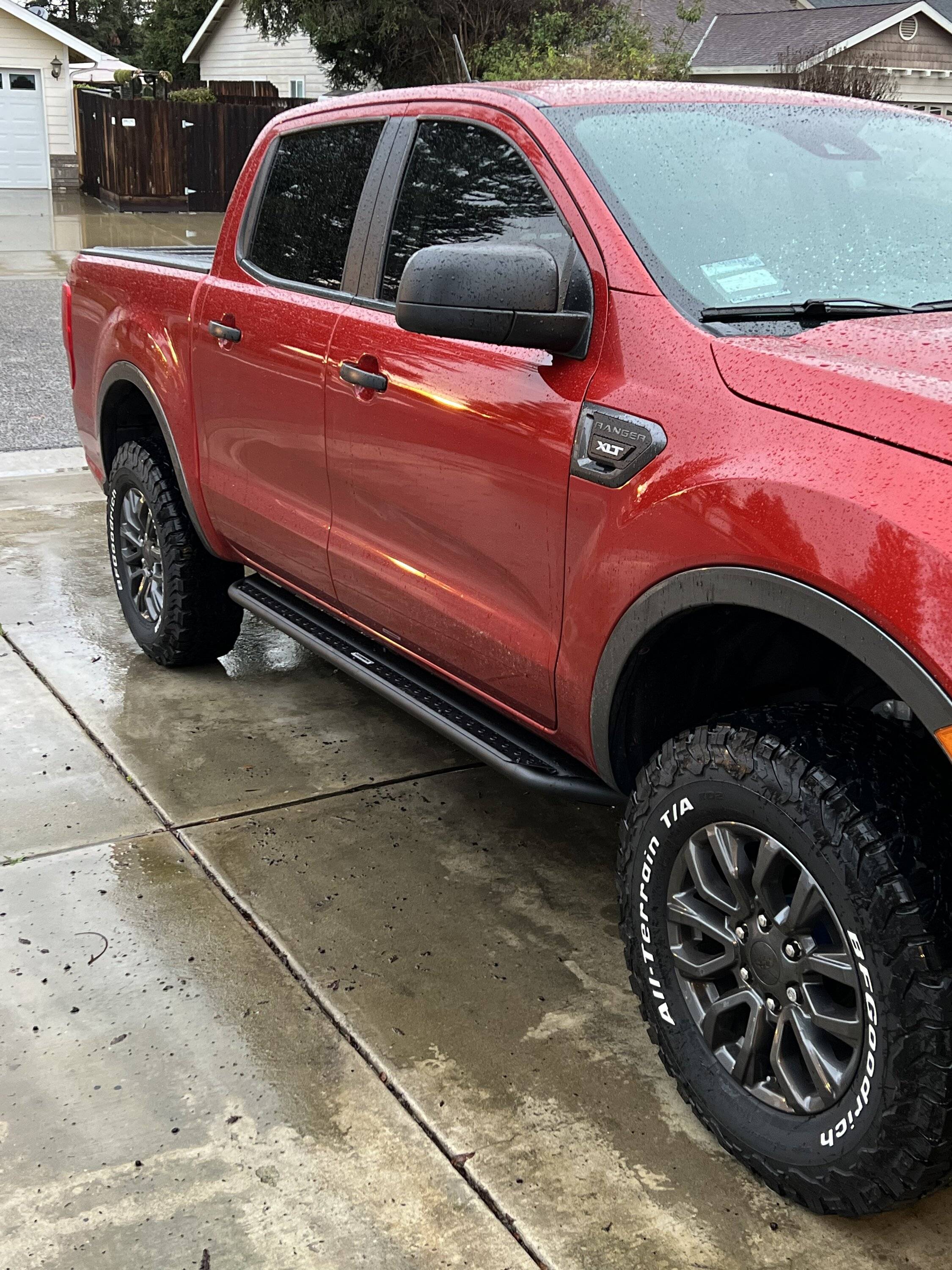

Installed some Go Rhino DSS Dominator side steps. My wife has them on her bronco and I liked them so I thought, why not? I like the way they turned out, and will hopefully help to stop the wear on the seat bolster.
