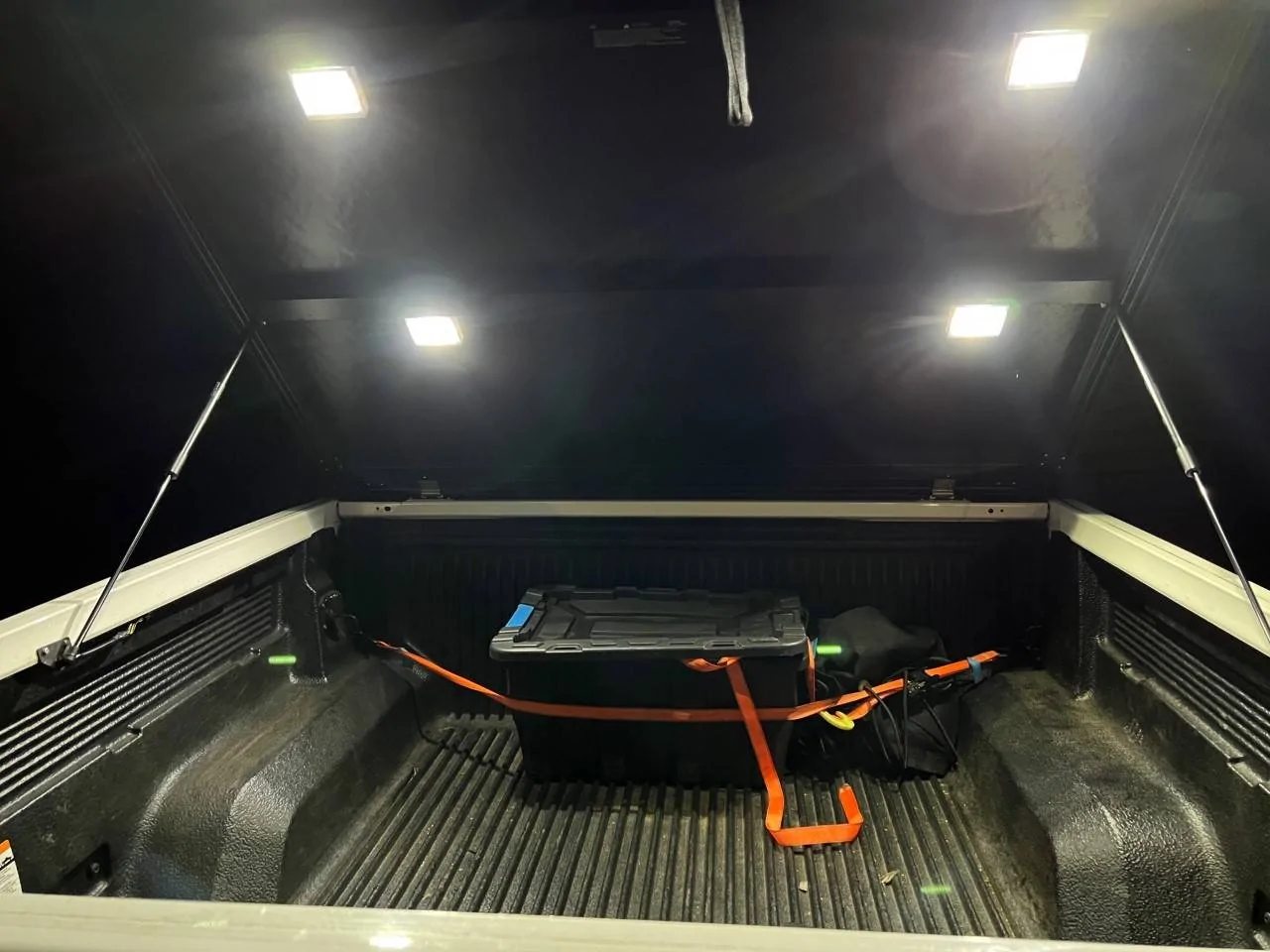

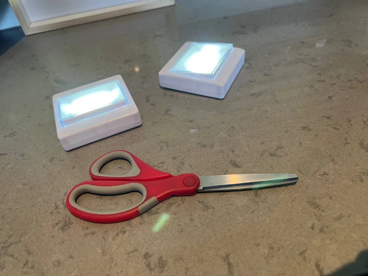

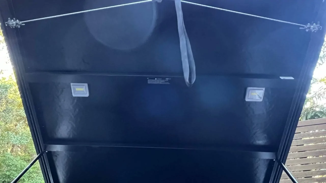

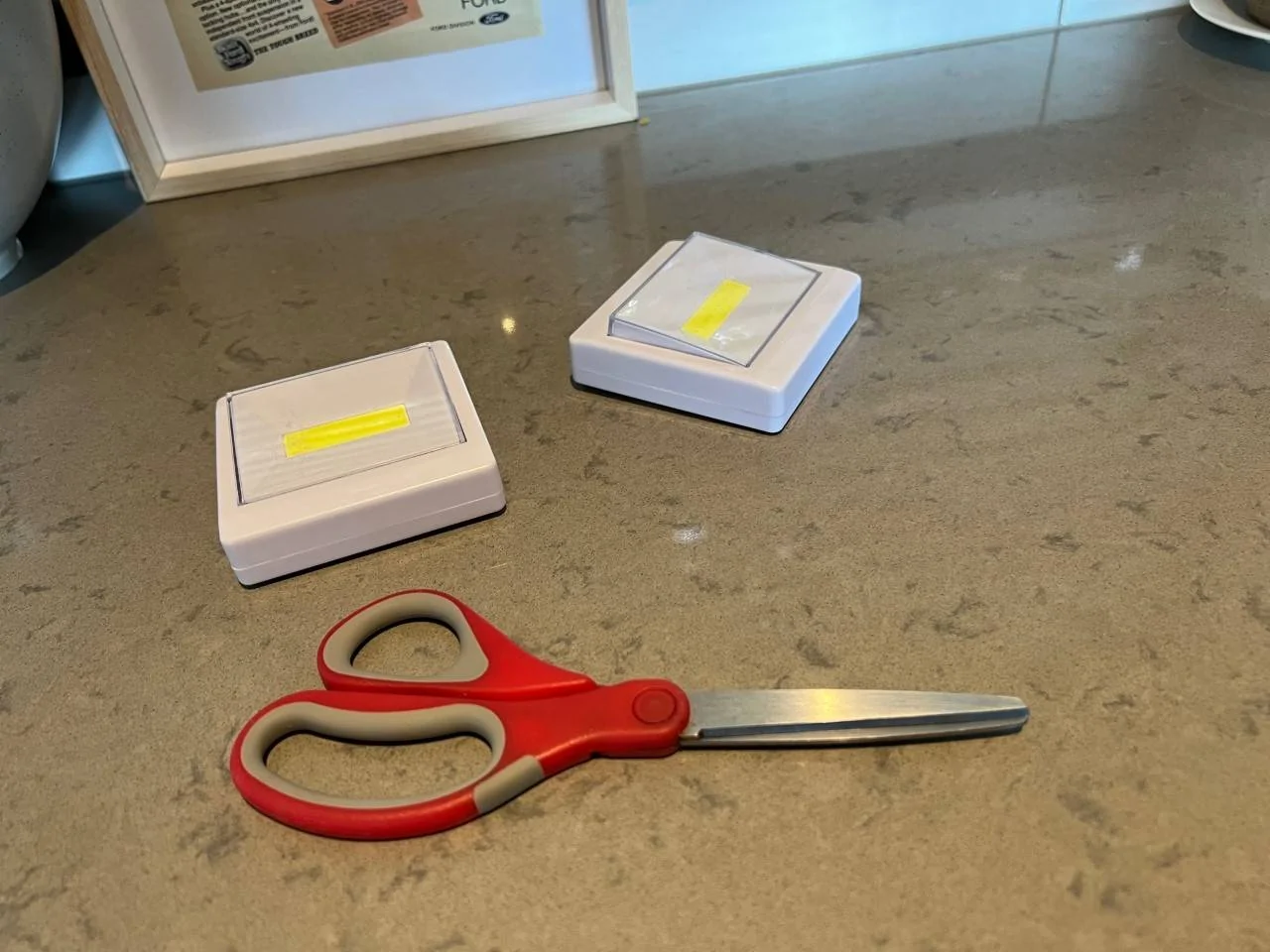

Did the cheapest bed lighting install ever.
Just needed something for nights at the BMX, sitting in the tray, and occasional work duties.
Lights were $2AUD (or about 37c USD lol) and run off 3x AAA batteries. Stuck on with some 3M Command Strips, so you can remove to change batteries.
Only shows two in some pics (testing), but ended up installing four of them. For $8, lights the bed up like its daytime.
Bargain.

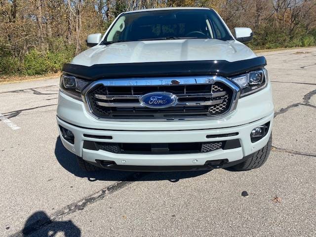

Note: These are the ForScan Settings (My Findings) for those of you who are Upgrading from Factory Halo's to Factory (LED's) and Possibly (After Market LED)
I purchased a Complete Set of Factory Headlamps / Foglamps from Ford Dealer ($2700.00)
It would have cost me more to walk away from As Ordered truck that I waited 7 months to get than a Dealer Ordered Lariat (That Had Them)
I did not want (Ebay) broken tabs on a Brand New Truck
I have a 2022 Lariat - That was Downgraded to Halogen Headlamp / Foglamp at Factory
The Foglamps are on Back-Order, so those are not installed yet
So, I Corrected Ford's deletion of my LED Headlight Assemblies for a piddly $500 Credit.
Here is My Install Notes and Configuration Settings for ForScan:
1. This is on a 22 Lariat that had the misfortune of getting the LED Head/Fog deleted at factory, so it arrived with Halo's
2. In the Install video posted on here, the guy does a quick shot of the Bumper Skirting (outer bolts)
These are located with the head facing forward - if you look up (just in front of the tires) towards the front bumper (you will see them) - Took me a bit to find them
3. The video is correct; the Fender Skirts and Grille are very much a PITA to get loose without patience and finesse
4. Took about 5 hours to get them installed (not including ForScan & Allignment)
4. Now comes ForScan Settings to Make the Lariat LED's Work Correctly, I did some playing with some settings, due to CONFLICTING info on here, that's why I am bringing this to light on my findings to help others on this (upgrade)
I researched 3 Separate Lariat Trim Models - Using As-Built Data to Compare to My Lariat with Halo's
Here They Are:
My As-Built Data (Related to Headlight/DRL Settings - Lariat with Halo's Installed from Factory
BCM
726-26-02 - 0000-0002-0057
726-45-01 - 0A01-0200-0080
726-50-01 - 0280
Lariat As-Built Compare (From 3 Trucks) (All Match these settings) (With Factory LED's)
BCM
726-26-02 - 0000-0001-0056
726-45-01 - 0A01-1000-008E
726-50-01 - 108E

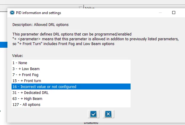

So, I used the 2 recommended GUI Settings at First and this is what I got
In BCM
Allowed DRL Options to (+ Dedicated DRL)
DRL Configuration to (Dedicated DRL)
DRL - Configuration - Changed To (Dedicated DRL) this automatically changes 2 of the Line Codes in the As-Built File Folder (BCM)
726-26-02 - 0000-0001-0056 (Matches my Lariat compare search-As-Built)
726-50-01 - 108E (Matches my Lariat compare search - As-Built)
Now for Allowed DRL Options in GUI, this GUI only adjusts one As-Built File and that is 726-45-01
I had set it to (+Dedicated DRL) but I double checked the (As Built) file and its Hex-Code Read
726-45-01 - 0A01-1F00-009D
So, the Allowed DRL Options (+Dedicated DRL) setting within the GUI, does not change the As-Built File to the correct Hex-Code according to my 3 Lariat comparison trucks.
So, I played with all of the options in GUI, and this is the outcome of each, I will note the changes
on the second set of numbers:
None: 0100
All Options: 7F00
Low Beam: 0300
Hi-Beam: 3F00
Ft Fog: 0700
Ft Turn: 0F00
Dedicated DRL: 1F00
**Incorect Value or Not Configured - 1000 (see below)
Noted: None of These Options gave me my Original as Built (0200), might be due to that I had the other DRL Configuration set to (Dedicated DRL) IDK
If you change the As Built file manually to the (Lariat Compare -Code)
726-45-01 -to - 0A01-1000-008E then look in the GUI (Easy Way) it's listed in a current status of:
Incorrect Value or Not Configured
I may go back in ForScan and Play with the GUI (Options) for DRL Configuration, and see if I can get the GUI format to read correctly (1000) instead of the Incorrect Value or Not Configured
(It's a Curiosity Thing) and I tend to be thorough and meticulous. I'm new to ForScan and Learning
So, I checked Headlight / DRL Operation with both 726-45-01 (1FOO) & ((1000) Hex-Codes
The Headlight's / DRL's work as they should: using both of these Hex-Codes
I decided to manually change and leave this Line Code at (1000) to match my compare trucks
I do not know what the difference between the (2) are (1F00) & (1000) but they both appear to work.
Any ForScan (Guru's) know the answer?
Operational Check:
1. LED Strip - On and Bright
a. With Headlight switch in Auto (Daylight) - So DRL Mode
2. LED Strip - On and Dim
a. Headlight switch in (Headlight) and (Auto - Nighttime)
b. Headlight Switch in Park Lights
c. Activation of Entry / Exit Lights along with Park Lights, Bed Lights, Puddle Lights, Door Locks Activation Etc.
With all that, I also upgraded the Turn Signals to LED as well, while I had it apart. I used the Oxilam 7440 Yellow LEDs from Amazon that others have used and recommended - Man they are BRIGHT
No - Hyper-Blink (at Turn Signals or Dash Indicators)
Before I started my swap, I set up truck at 25' from Garage Door, placed tape across the Top of the projected light source, this way I had a Ref: Line to Adjust them Too, made it so much easier.
Did some other ForScan Mods plus Map Update today as well, so it's been a long day
Sorry, for the LONG Post, but after spending a couple of hours researching the proper Forscan settings and getting conflicting info, I wanted to help others in clarifying the correct settings for swapping their headlights to LED (Factory)
I'm going to post my findings in the Forscan Wiki as well, as they are hidden all over this Forum.
Is it possible to get a Sticky on these settings

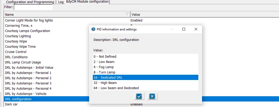

In BCM (Module) - Easy Way
I went back in and played with the DRL Configuration in GUI (Easy Way)
I attempted to change each of the selections, and it flagged me - not supported
Those Options Are:
0-Not Defined
2-Lo Beam
4- Fog Lamp
8-Turn Lamp
10-Dedicated DRL (The Only Selection That Worked)
32-High Beam
64-Low Beam and Dedicated
So, I'm leaving it alone and deduced it's a ForScan Programming Glitch. It works and that was the end game wanted outcome
I am wandering that since my Fog's is still Halo's has anything to do with it, though. We shall see after the LED Fog's get installed
Thanks
UPDATE
I figured it out and this ONLY applies to Factory LED or Aftermarkets that have a dedicated DRL and that is all you will be using.
Set this option to (16) Dedicated DRL - this will automatically set 2-Lines of Hex Code for you.
NOTE: the (16) is a Binary code that is converted to HEX (Inside of the As-Built) Files
Here are the 2-Lines of Codes it sets
BCM
Now set Allowed DRL Options:
NOTE: The Paragraph at the top
If you have only (1) option for DRL, such as Factory LED Headlights, this will show due to the fact that it matches the (16) Binary code you set in DRL Configuration PLUS
This option ONLY modifies (In addition) (Plus) the standard factory DRL.
So, this normal - As I have not added any special (extra) DRL options to the configuration
So, with this selected, here is the last Hex Line of code that is changed (Automatically)
If you do not see this option (highlighted) then go into the As-Built File and manually change it, then when you go back to the (Module) Easy way, this will be shown
I know there have been quite a few posts on this subject and I wanted to pass along my findings
to clear it up
These are the confirmed settings for the Lariat Factory LED Upgrade, now it should also clear it up for those who have installed the (aftermarket) options. With the attached pics, you can see it more clearly and visualize what changes you want to make
Bargain.
Nothing wrong with that! Beats my not-yet-installed lights by a mile!
Looks like it lights it up very well! =)

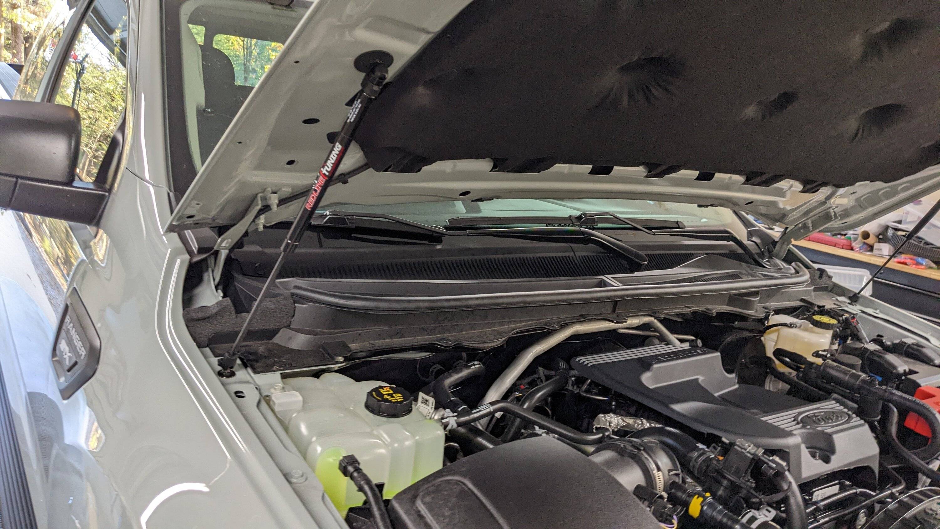

Put in what should have already been in from the factory...
The lower washers included in the Redline kit are too small, so I ordered some black chrome replacements. Have extra if anyone is wanting to put a proper sized washer there.
mokupilot
Jan 22, 2022
283
1,391
The Aloha State ?
22 DeeZee Lariat Tremor, 09 Escape Limited
Heavy aluminum tube logistics and transportation ✈
Yeah, I noticed that. I could go for a couple if you have spares.
