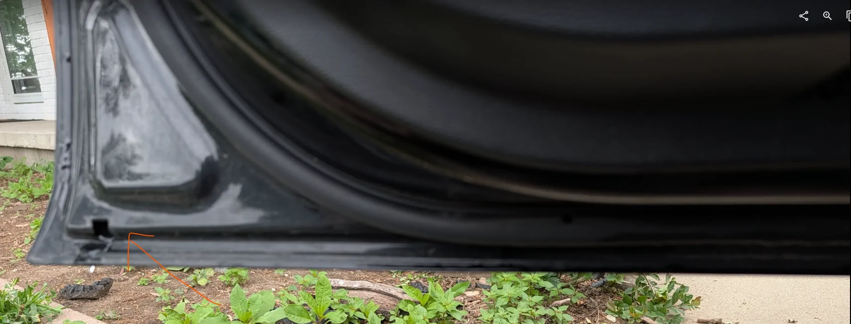

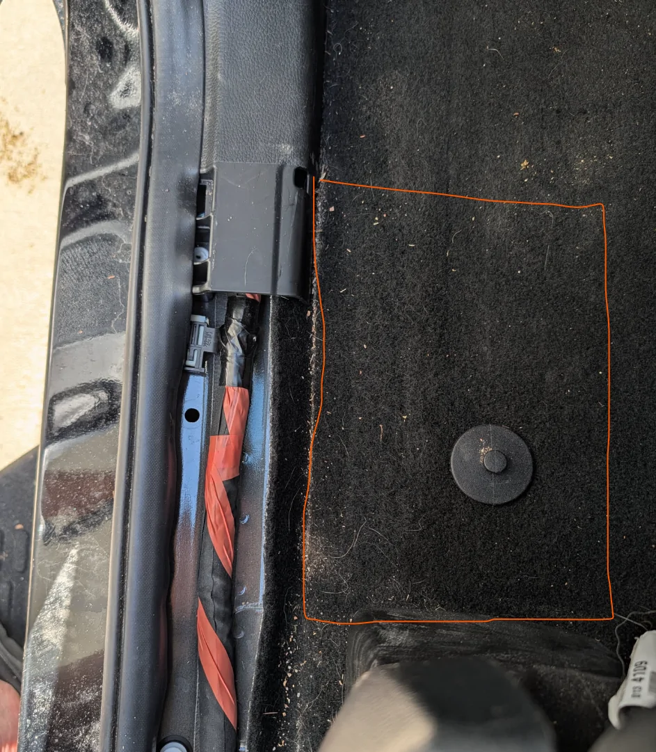

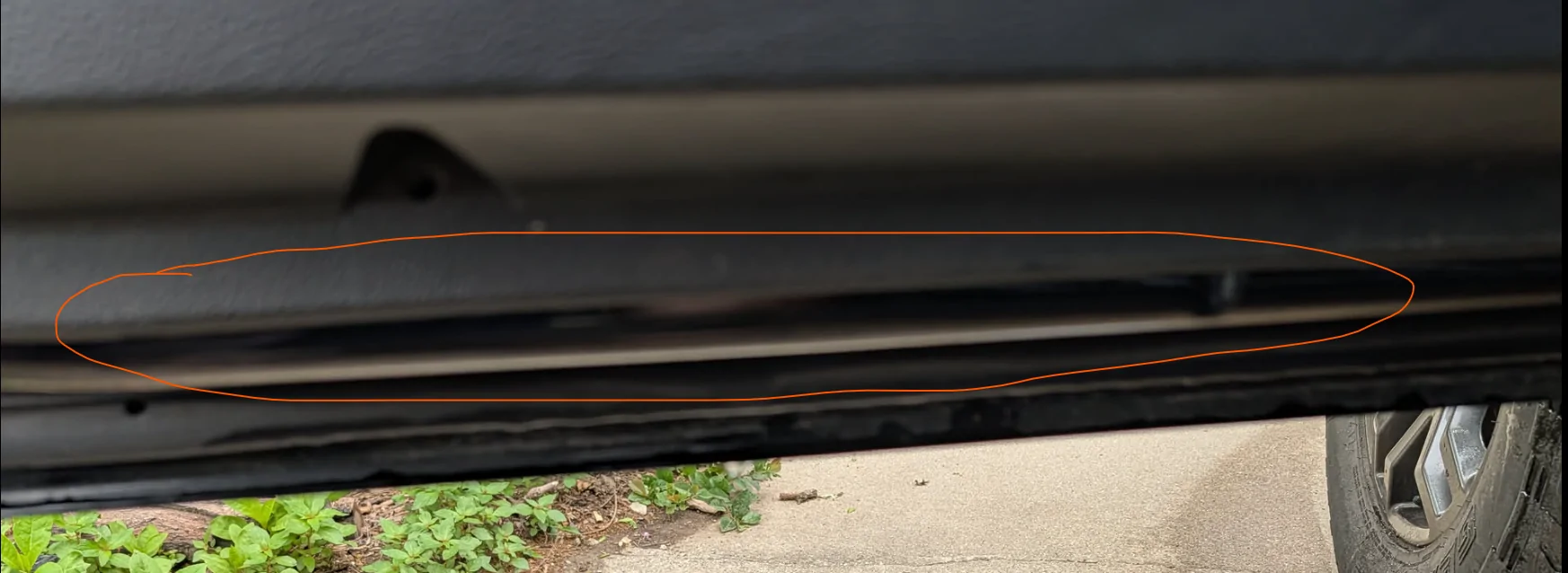

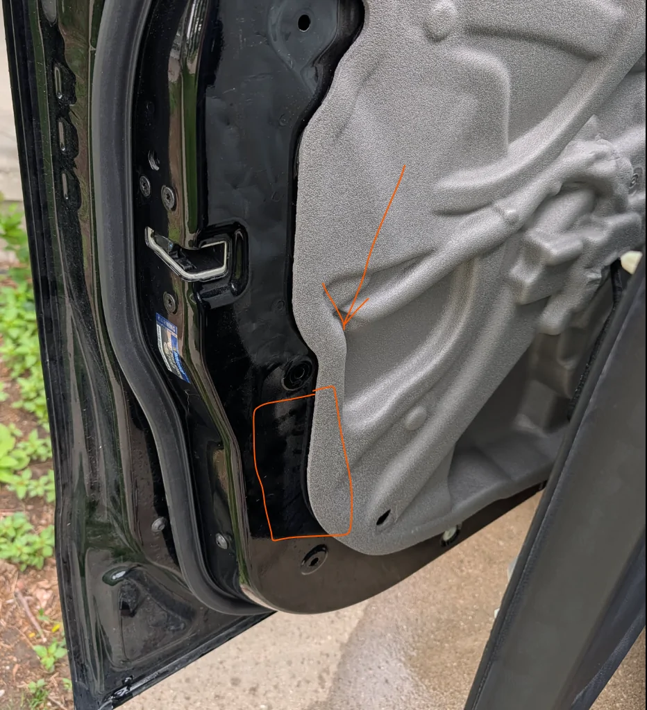

OK here are some pics.
In the photo above, you see where water is supposed to drain out of the door when it is properly sealed.
It was instead dribbling very slowly out of this area which is inside the sealed cabin area.
When i pulled the door panel off, I saw this membrane was separated from the door where the arrow is pointing and there was visible water flow in the area with the square.
Some new butyl tape was super easy to install. I hosed it down for a while and it was still dry behind the interior panel afterward so I think I got it fixed.
