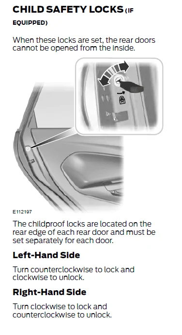

No drivers side heat/back right door cant be opened from the inside

Anybody run into these issues? The heat is whatever but the back door is stuck locked unless somone opens it from the outside

For the door did you check to make sure you don't have the child safety lock enabled?
Yeah thats disabled, other back door opens fine

Ok im stupid i figured out the child lock, now i gotta figure out the heat
don't feel too bad. I made a posting about that key hole thingy on the drivers door of a supercab. why is there a child safety lock on the driver's door? the world may never know.
