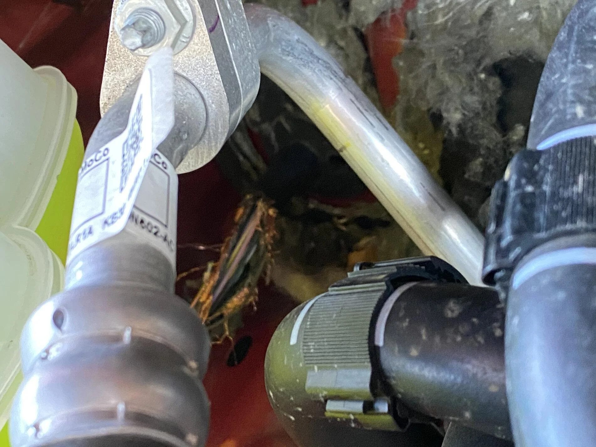

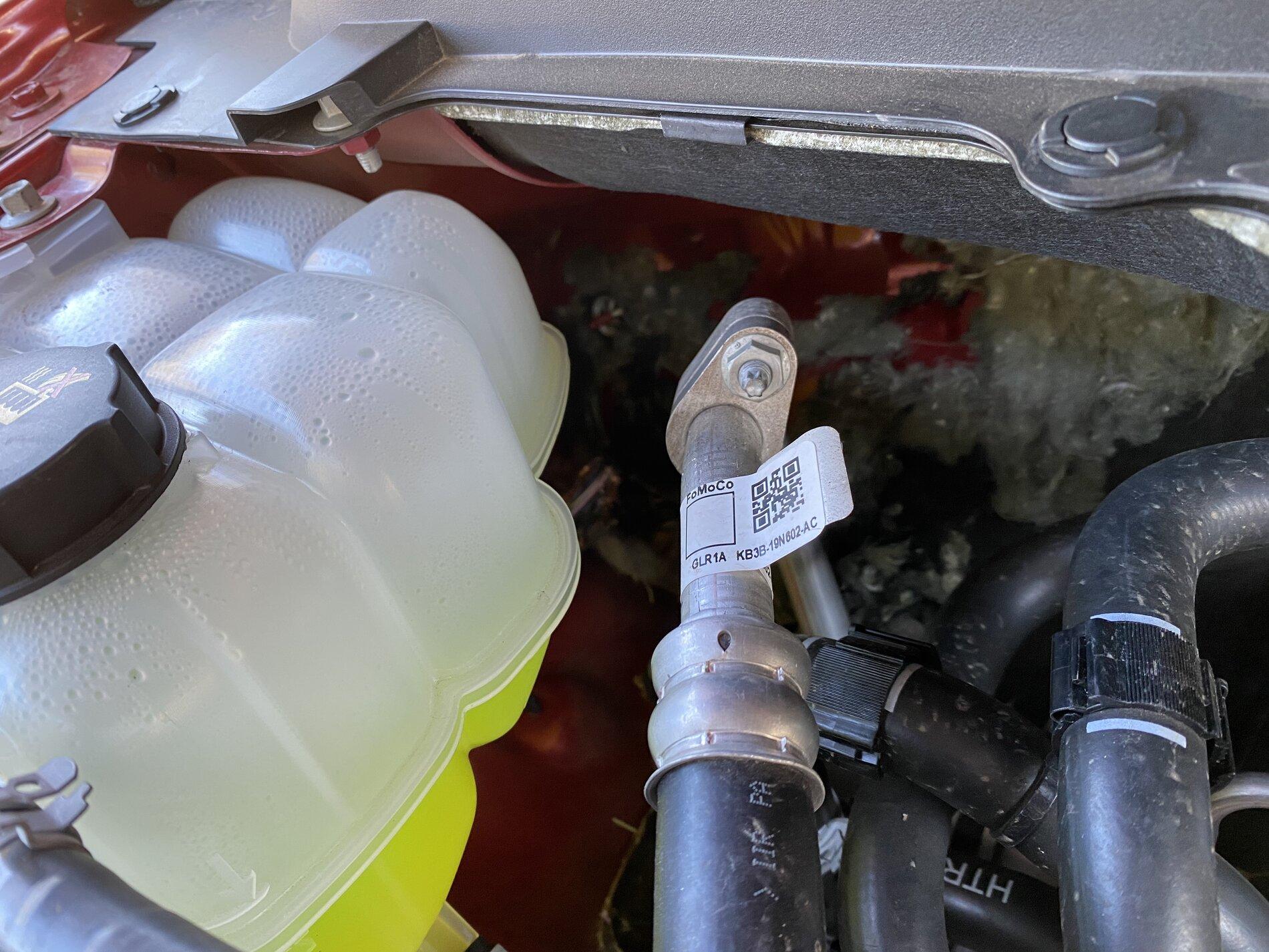

Well I was driving along and everything was fine, then the next time I used the turn signals I got the fast flash like a bulb was out. When I got home I checked and found I had no lights at all on the back end. So I pop the hood to check fuses and I find a dead squirrel under the coolant tank by the passenger firewall. The little bigger was trying to make a nest on that shelf and ate through part of the wire harness that is there. Now it’s waiting time because the dealer can’t get me in till Thursday. Good thing it’s covered by my insurance.

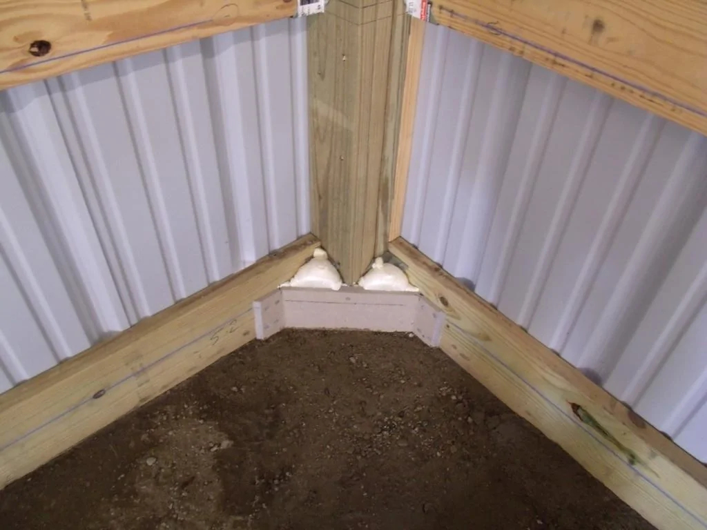

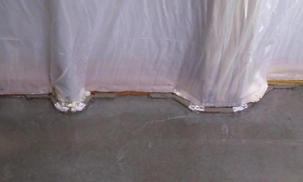

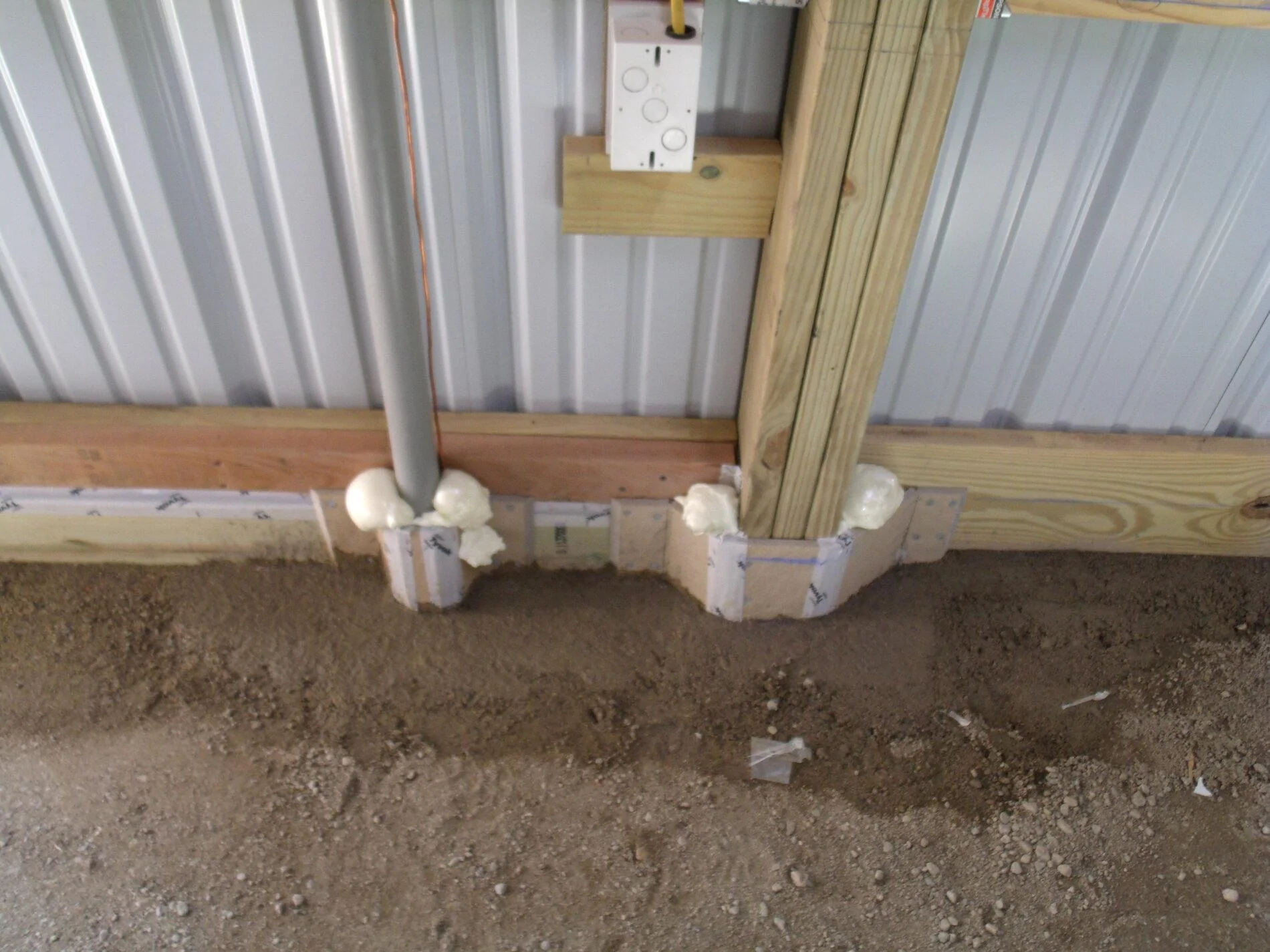

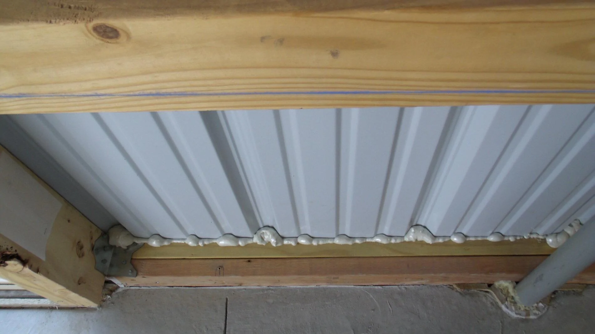

It's worked for the last four years on my barn.

Hey Chance... How Do You Know?
The rodents around here give zero F's about chewing right through it. I think it's probably their last resort, but they chew a perfectly round hole right in it, and go in and out without so much as a second thought. My guess is they have a better way in and out of wherever you have sealed. Put a mouse trap with some fresh peanut butter in it, and report back in a day or two.
If I douse it with hot sauce, they don't come back though.
I've got sticky traps at every door, and have had for 4 years. No mice... no mouse crap nothing. Also no food source for them in the building. Other than the tasty wiring in my truck.
But we're getting off track. My comment was about whatever ingredient they use in the rodent formula spray foam...

Well here is an update. Insurance is more than willing to take care of this repair, but the dealer has had my truck for a week and can’t give my insurance an estimate due to the part number on the harness not matching my VIN in fords system. They daily are emailing ford, but are not getting any answers. Not happy that a truck with 1,000 miles is stuck in the dealership due to ford having their parts system jacked up. I am being told that even when they get that figured out there is no idea if even the harness is available due to parts supply issues due to the Rona. Feeling very frustrated and disappointed with ford right now. The dealer is putting me n a rental on their dime so at least they are trying.
