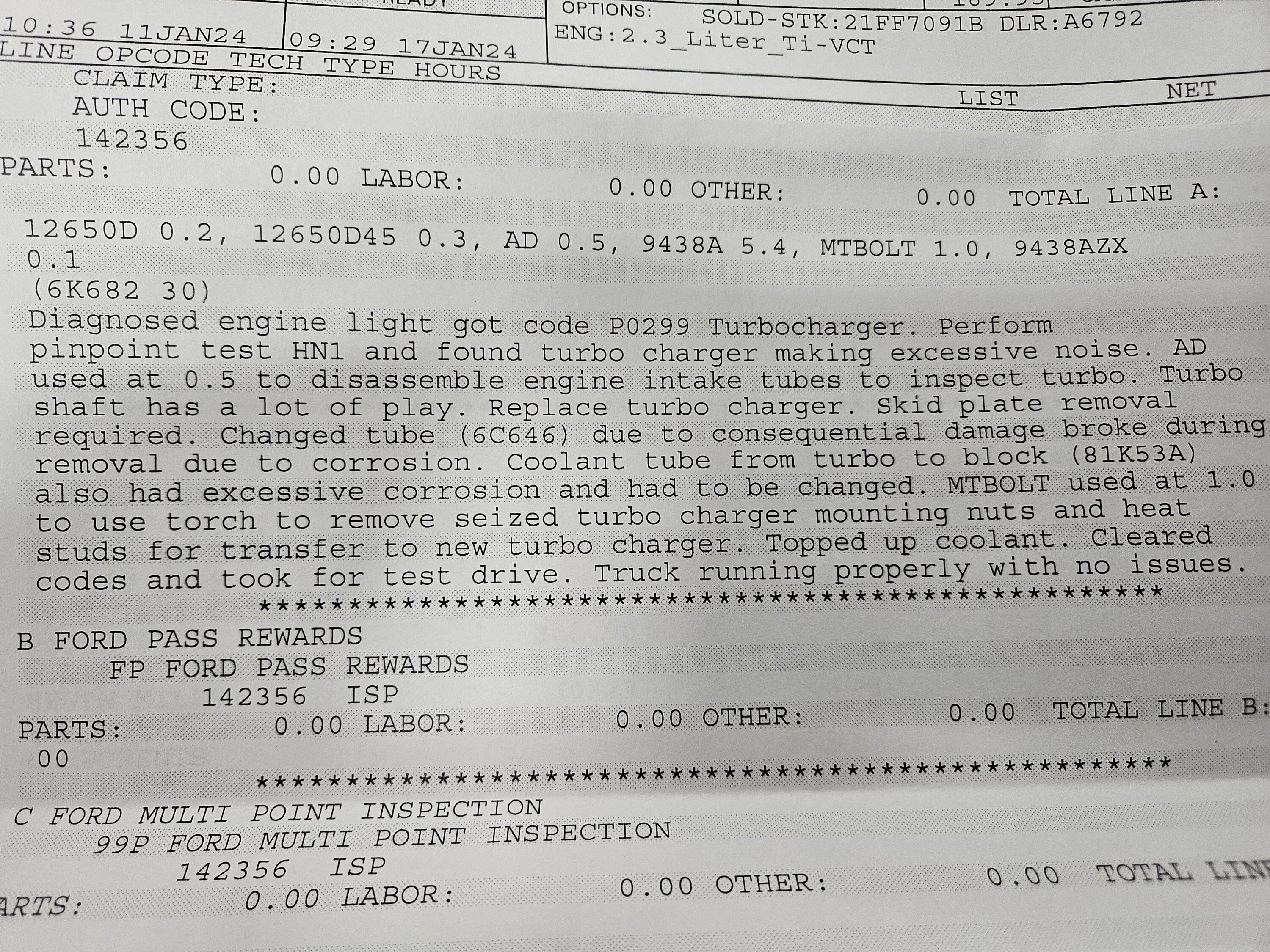

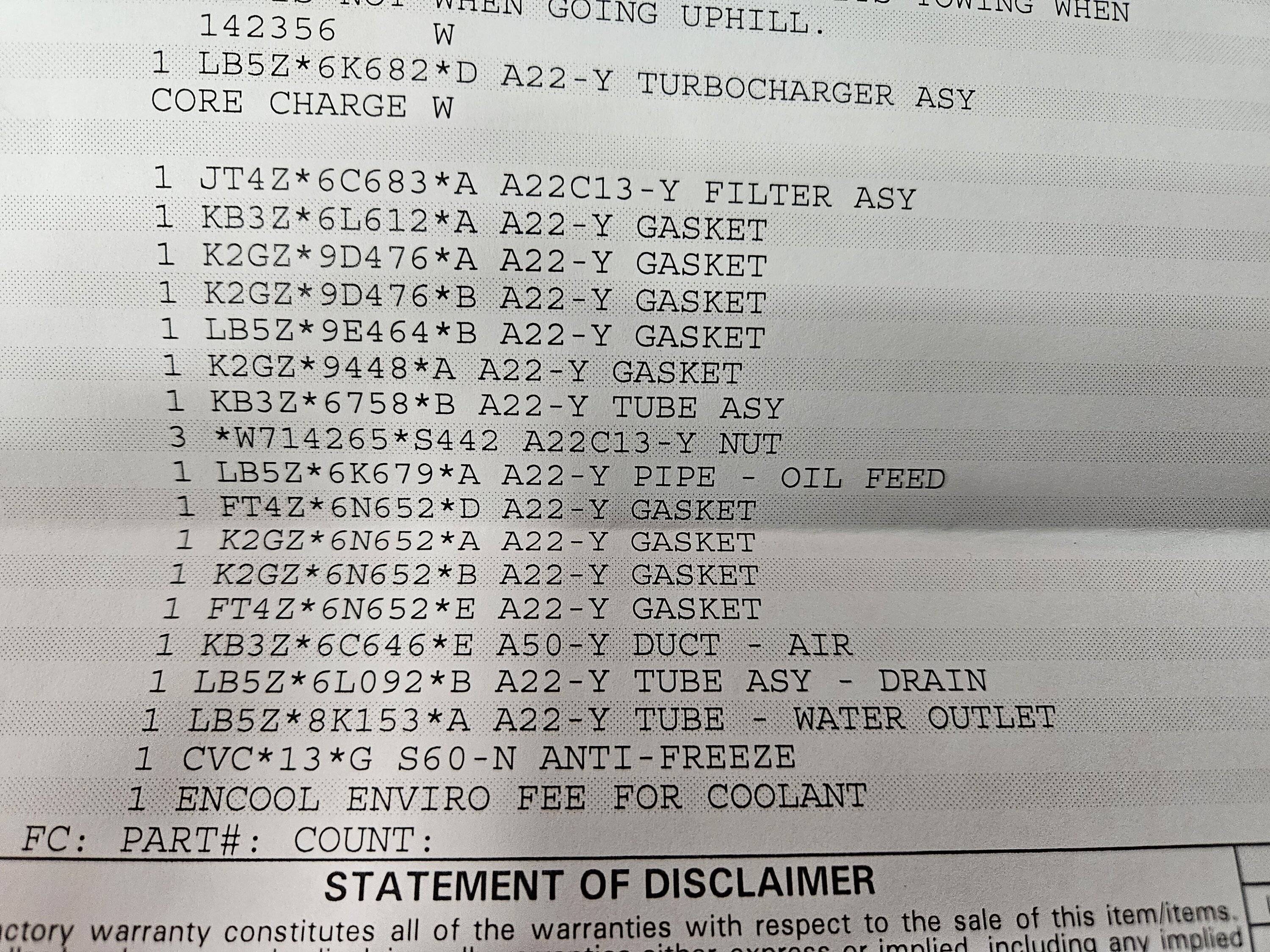

Picking up the truck today, and here's the report on what was done.
Thanks, everyone, for your feedback.
New oil feed pipe ? doesn’t say if old was plugged/restricted but betting it was. Thanks for sharing the info!
And the oil feed screen too. ( JT4Z-6C683-A) ?
