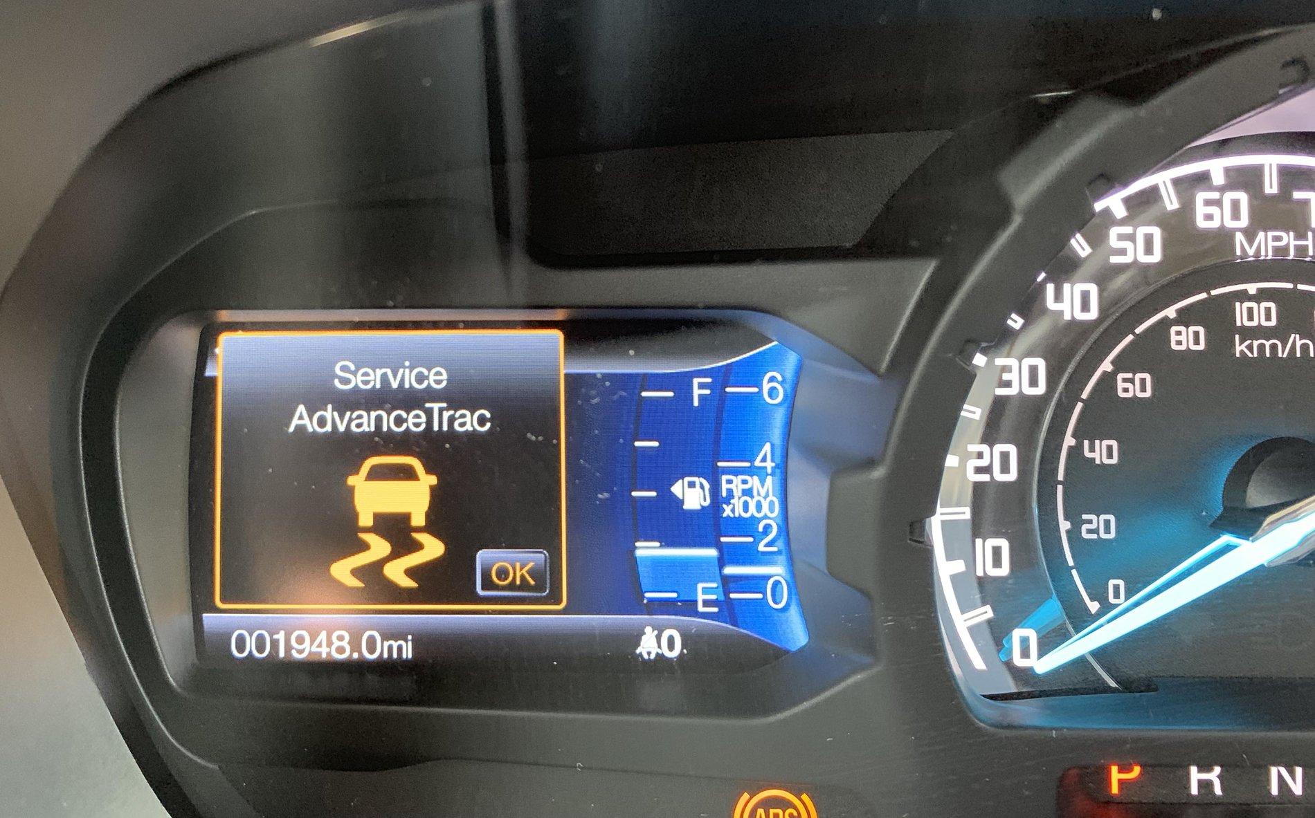

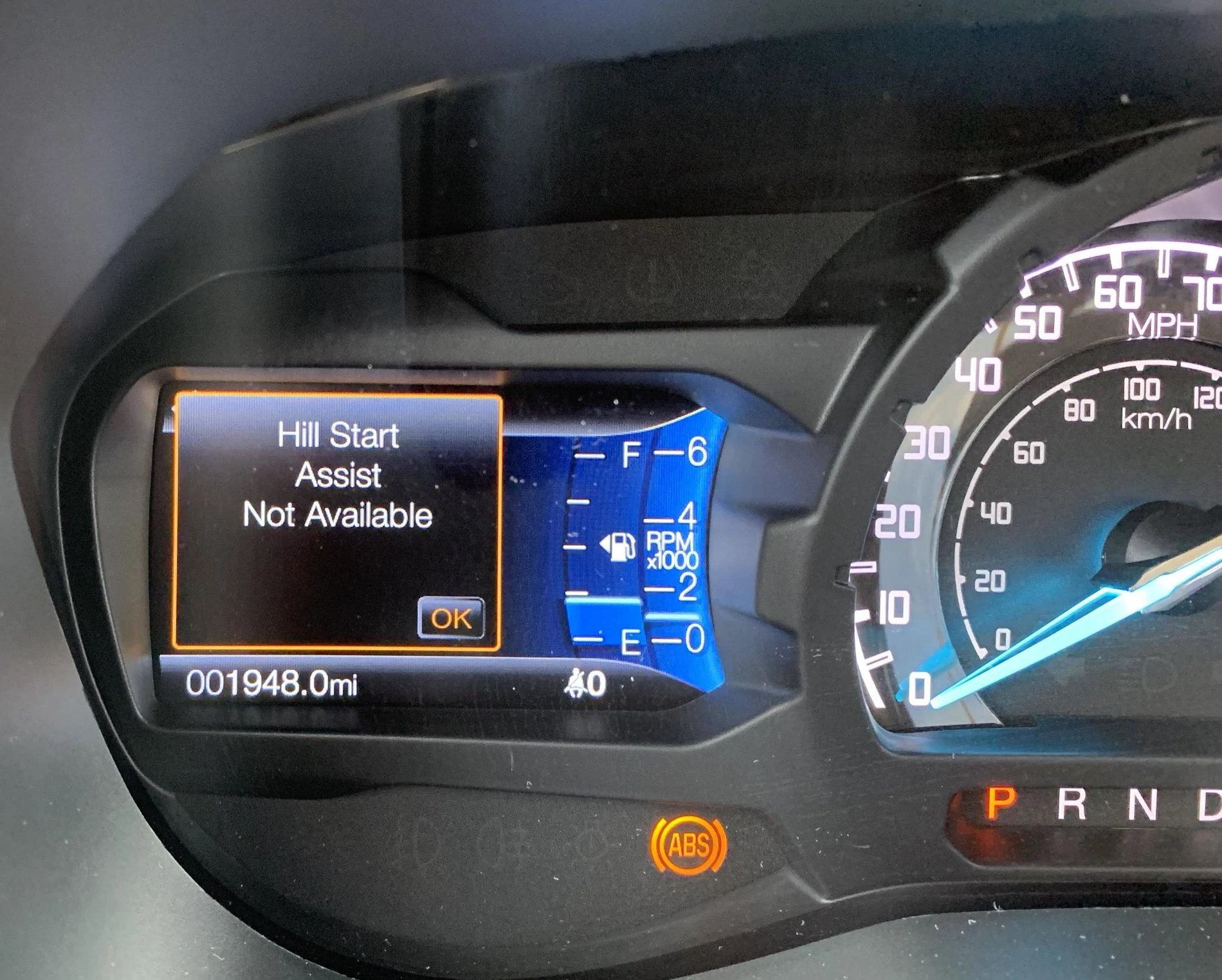

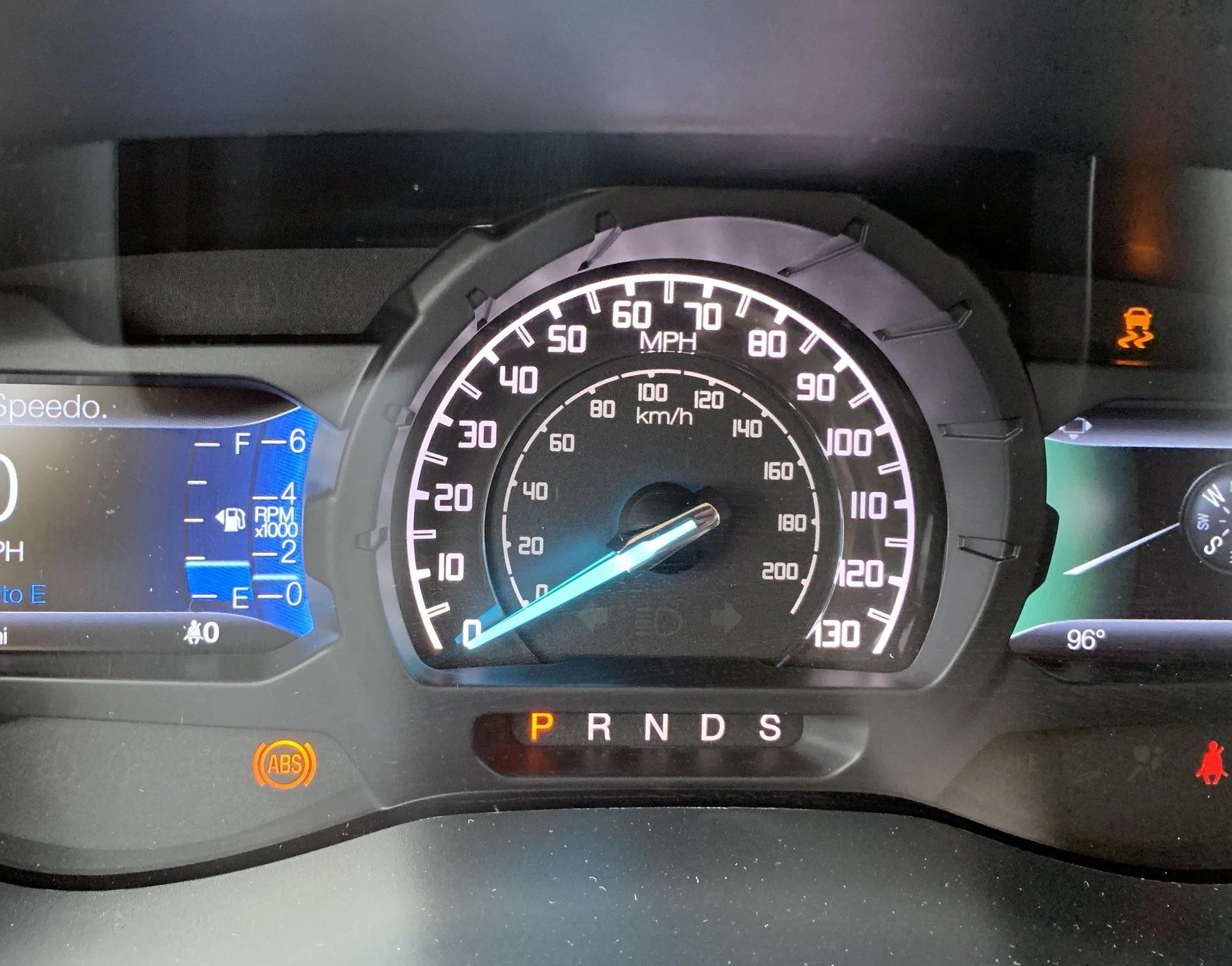

While driving to work today I got several warnings and Adaptive Cruise Control was Not Available, Pre-Collision Assist Not Available, Hill Assist not Available, Service AdvanceTrac, ABS Warning Light, Stability Control Warning Light came on and MORE!
When I started it back up later the warnings were still present and I decided to drive to the Dealer to have it checked out. On the way I had to make a hard U-Turn and all Warnings Cleared!!!! So strange!

Odd - that almost sounds like a loose connector somewhere - or an intermittent short. Let us know if it comes back.

Sounds to me the steering angle calibration was off then cleared itself. Any mods or alignment recently?
No mods that would affect this. Only about 1950 Road miles on it with no significant bump or pot hole action here in Florida. Happened just cruising down the road at 65mph.

I am sorry to read that. If those lamps came on, there is a reason and they should have thrown a code. Have the dealer run diags to see if any codes come up.

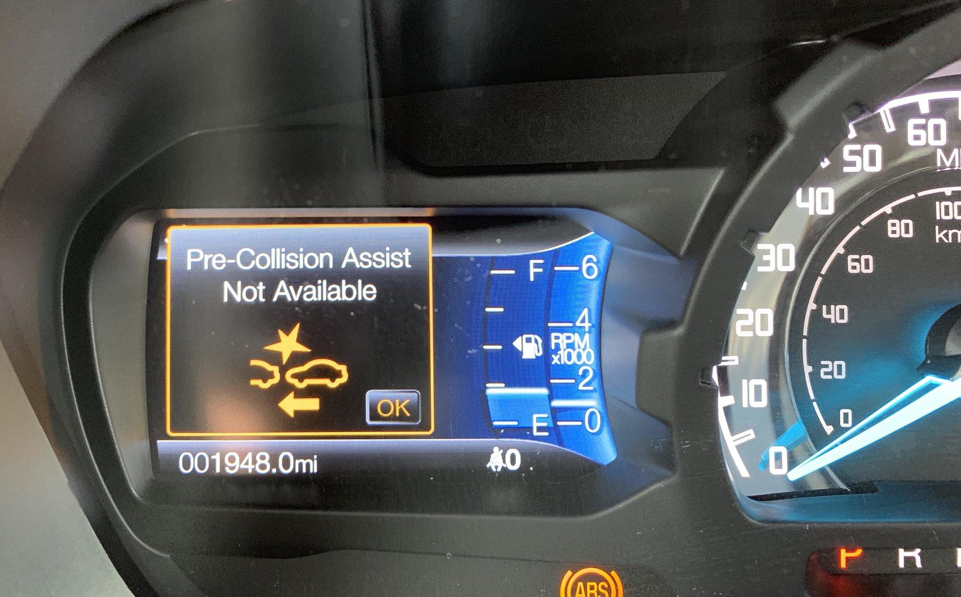

I got the Pre-Collision Assist Not Available the other day. Went away on its own.

Foreign matter on the windshield, front camera or radar can cause it to stop functioning.which would cause the message. Owners manual page 197.
Well, it is Love-bug season here in Florida and that’s exactly what I suspected but there wasn’t anything covering the camera or radar sensor areas. Warnings includes Parking sensors and other functions not related to camera or radar.

Yeah,I read your post and it sounds disconcerting, but I was actually responding to Anthony's post, with the hope that it might help anyone who reads it.

Oh I know the reasoning behind it (I actually got the alert on my FordPass app too that explains everything as well). Just letting the OP know its not quite a non-normal event.

I might suggest to check the electrical connector under the left headlight...hard to get to but I found mine was not connected solidly. One handed pinch and I heard the click of a seated connector....now the forward parking sensors came alive again.

It’s at the Ford Dealer now so it’s up to them to diagnose. There are no Warnings since the original event and e everything has been working normally. I hope they decide to just swap out whatever module controls all this stuff. It’s a Lease, and under Warranty, so it’s on them.
