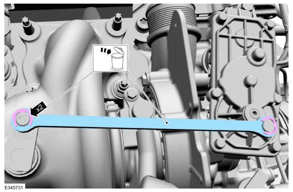

I wanted to Update this thread with some findings and a video of the noise.
Since first purchase I have had a noise when I opened the driver's door, search here led me to believe it was the Fuel Pump Priming, for intended engine start.
After doing a little investigation I found that this was (NOT) the noise I was hearing.
Now while investigating other issues with the truck for fellow members, I took a deeper dive into this noise to separate this -Wastegate Noise vs The Fuel Pump Prime.
My dive revealed that the noise is tied into the PCM Wake circuit, The PCM Wake circuit powers the PCM through the PCM Power Relay.
This Wake circuit does a few things to prep for intended engine start and I won't go into all the details but only focus on the noise's.
1. Fuel Pump Prime - This is a 1- Second prime of the (In-Tank) Low Pressure Fuel Pump, the purpose of this is to purge any vapor at the Fuel Injection Pump (HPFP)
The HPFP may be under vacuum due long periods of cold soak and fuel vapor may collect at the (HPFP) High Pressure Fuel Pump, so to prevent a long start condition the (In-Tank) Low Pressure Fuel Pump is commanded on for (1-Second) then is shut off if engine rotation is not detected.
I also want to point out that the High-Pressure Fuel Pump is mechanically driven by the camshaft and the Low-Pressure Pump is electronically driven.
I do not hear the Pump Priming
2. Wastegate Actuator: I searched for the reason for this cycle at (Wake) but no luck finding a definitive answer, I do know that is powers from the PCM (VREF) circuit and the (VREF) circuit is powered from the PCM (VPWR) circuit (Fuse 7) BJB -(Engine Fuse Box) this power distribution is from the PCM Wake signal.
VPWR = PCM Power Into the PCM and VREF = Power Out of the PCM
Now for the noise itself, I plan on pulling the heatshield off of it and attempt a lube of the rod ends, just to see if I can quiet it down some. I do not hear it any other time other that when in wake mode, as this may be internal IDK if that will help but worth the 20 minutes or so to get access to both rod ends to at least try.
There is ZERO rod end play so no rattling sound from it.
I decided to post a quick video of what I hear to compare the noise across the members here to indicate if this is all Rangers or some Rangers.
Note: The PCM Wake circuit, will remain powered for 3-Minutes, unless an Engine Start is performed or it will go back to sleep. Thus, you can create this noise, every 3 minutes just by opening the driver's door.
I believe the noise is coming from the Left side rod end or the bushing on the wastegate housing.
I have a couple of High Temp lubricants to try, as simple WD-40 won't work for this as a solution, and I am focusing on something that will provide the resonation noise on the metal during movement, and that dog bone rod is a perfect source for it.

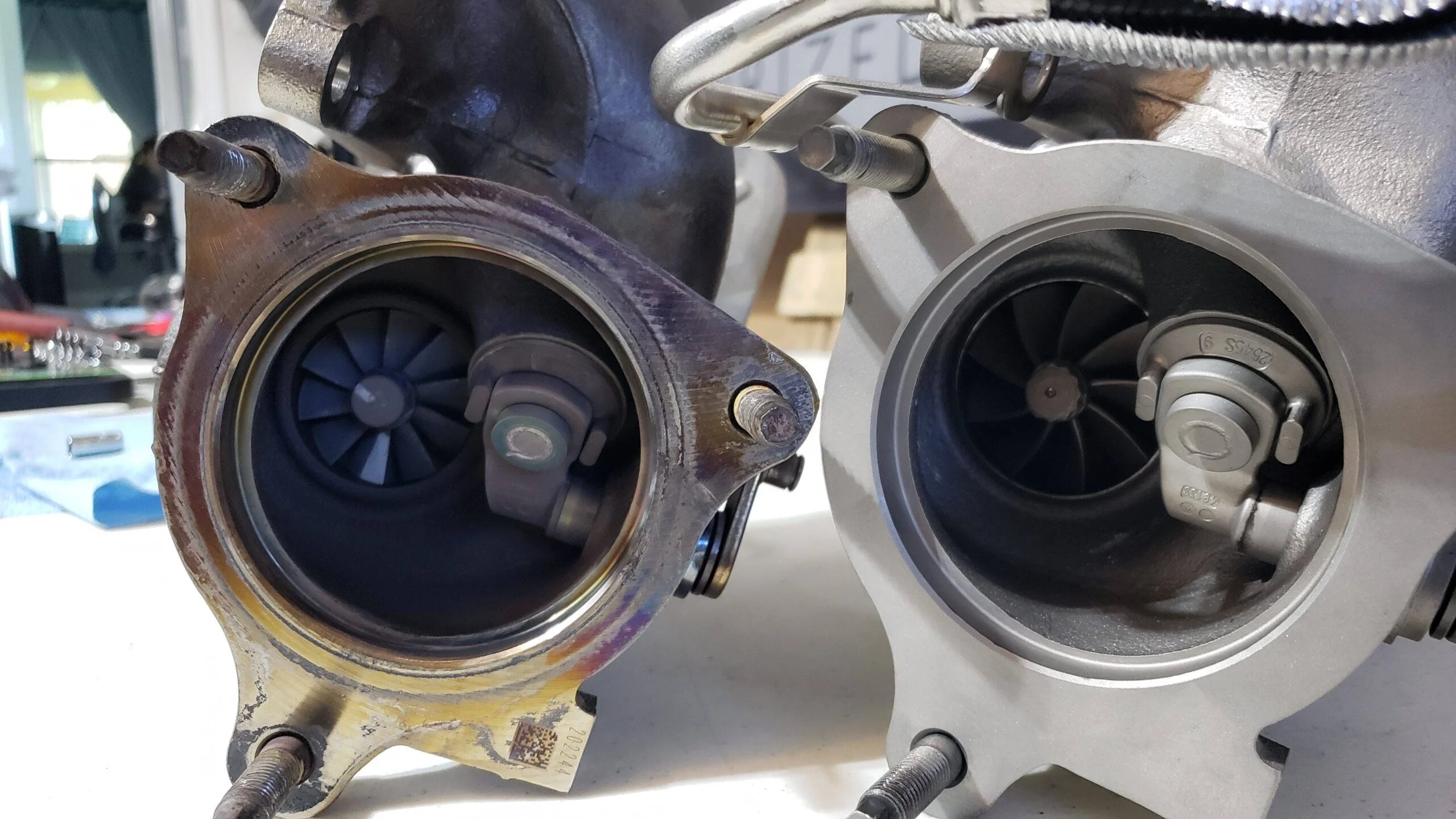

Electronic waste gate actuators will make that noise. The actual waste gate flapper that is inside the exhaust housing is designed to be loose and can make a rattle noise. It pivots on a center pin and is amazingly loose by design. The rod ends will also be a bit loose to allow for heat expansion. We never found a lube that would be effective especially on the hot side.

All the electronic actuators that I’ve encountered working at a large Borg Warner turbo distributor for 10+ years make a whining sound. Holsets, Garrett’s, IHI’s do the same. The Holset VGT’s are crazy noisy.
