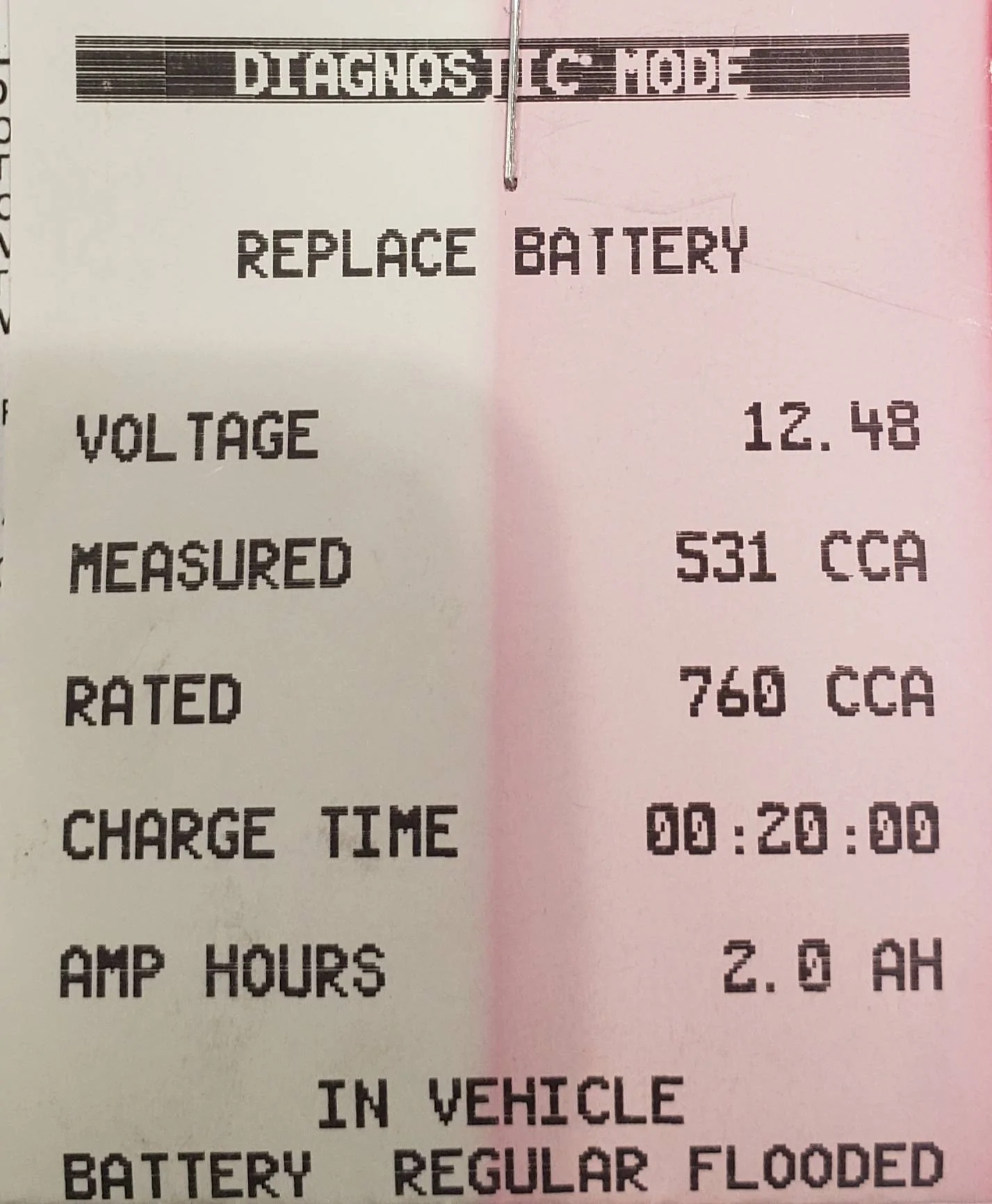

One question on the slip you posted. On the bottom it is noted "IN VEHICLE BATTERY REGULAR FLOODED". The batteries in our Rangers are not regular flooded cell batteries, they are AGM batteries. Glad you got it replaced under warranty, just hope they put the right one in.

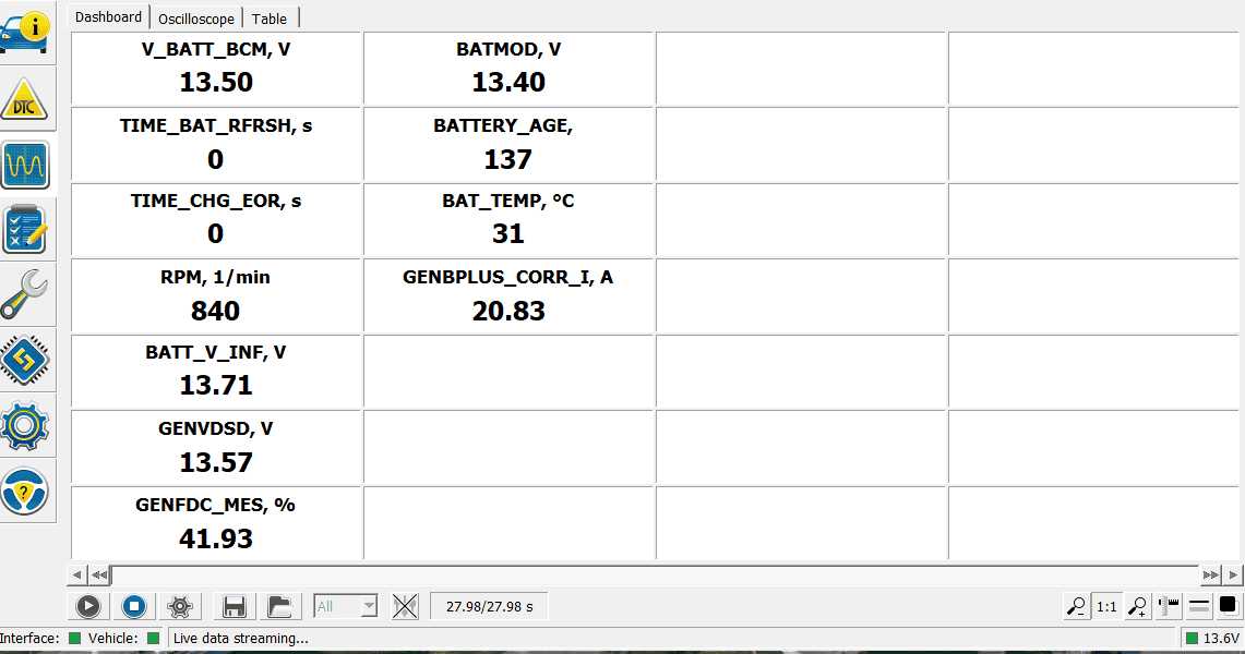

It is a bit hard to explain on how to get it set up to actually view PID's in written text, watching this video helps. The Battery Age is located in the BCM module, along with other battery charging PID's
Here is a basic introduction on how to get there.
How to troubleshoot circuits with ForScan - YouTube
Here is a Pic of my PID's
I don't remember exactly where the BMS Reset is, I think it is on one of the main screens and stands out. Just click on the Tabs on the left side of the screen and you will see it, there is a reported alternate way to perform the reset, by flashing High Beams and Brake Pedal sequence, but since you have Forscan this way you have a confirmed Reset by seeing the Battery Age change to (0) days

I did check and it is an AGM battery they replaced it with. Label is different than the old one. Not sure if they did the test wrong based on the print-out but it got the result I wanted so not about to question it.
