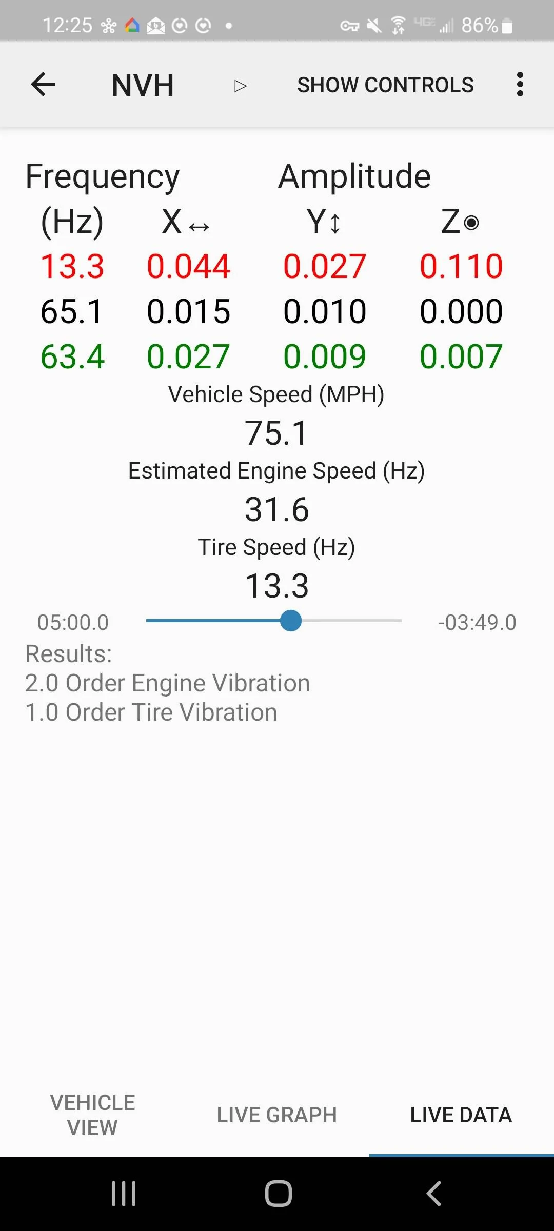

Here I'll start. This is my 1st order typical vibration frequency and amplitude....consistent at 75mph.

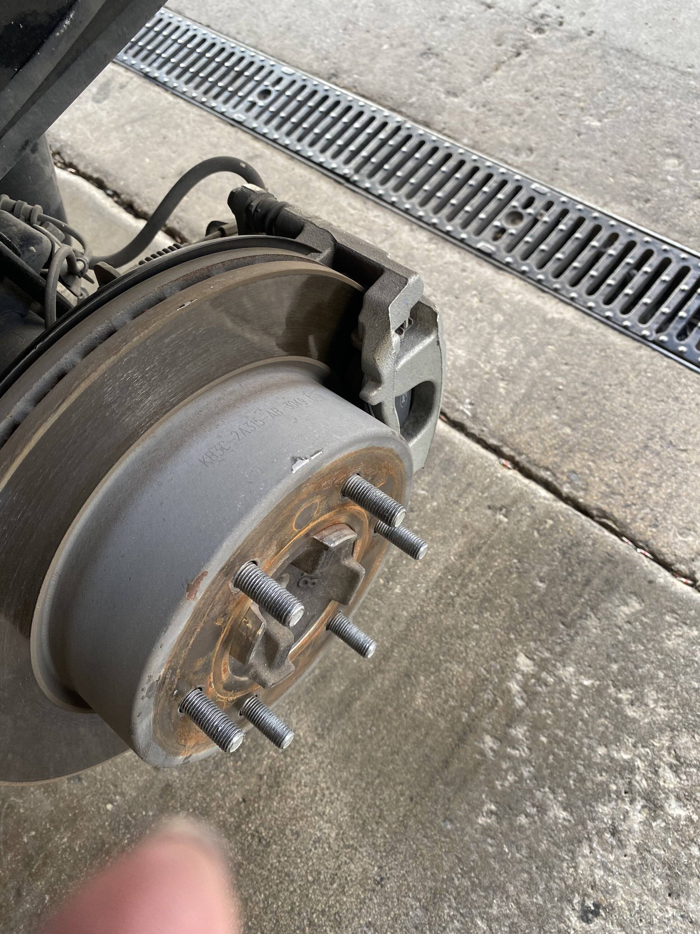

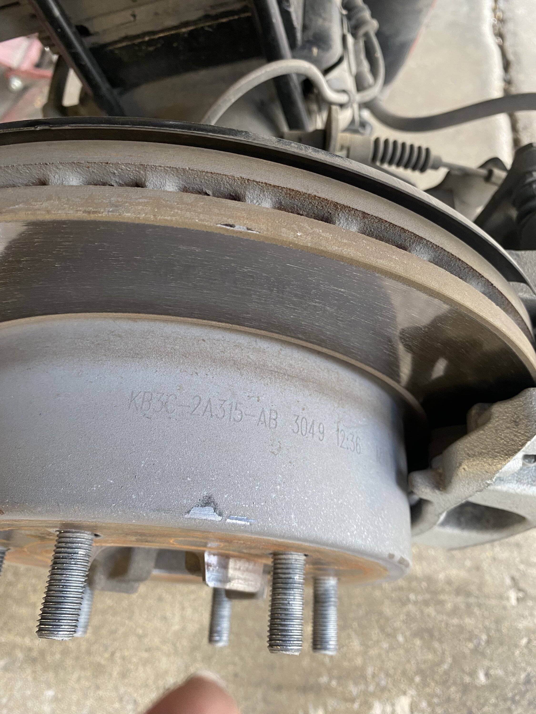

Those marks looks like when the wheel is allowed to drop on the rotor, if so, the wheel should have matching marks.
I’ll check my wheels to see if there is a matching mark, does the wheel have to be removed from the vehicle first or can I see it by crawling underneath with a flashlight?

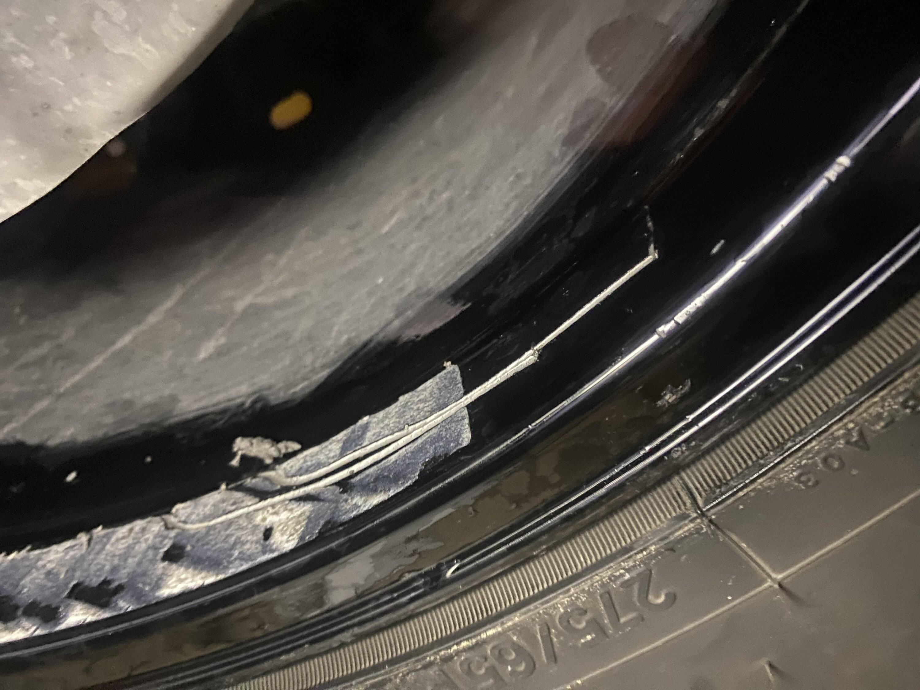

I
My steering wheel and truck started having the same issue after getting a rebalance, I’ve tried Extra Thread lug nuts, realignments, different sets of tires, reducing psi in my tires and finally hub rings for my aftermarket rims.
The biggest success was with the installation of the hub rings but the vibration and shaking returns. I believe (my situation) is that possibly a sticky wheel weight came flying off of my rim and the damages are causing this. I have photos of the hub and brake disk damage but I’m not sure if the visual damage is the cause or if the brake caliper is damaged and isn’t visible.
The Ford dealership has a machine that can diagnose where the vibration is caused such as the tires, rims or suspension etc. I will take it to them after thanksgiving but since the rims are aftermarket they said they would need to charge me for it but give me a discount.
I’m adding my photos of the damaged areas in case something jumps out to anyone who is mechanically savvy and can give me an answer on how to proceed and save me a trip to the dealership. Happy Thanksgiving to you all and I’m hoping to find a solution for me and others who have the same problem.
The detailed thread is on my page, my tuck was fine with the lift and the new rims and it was only after the rebalance when the issues began.

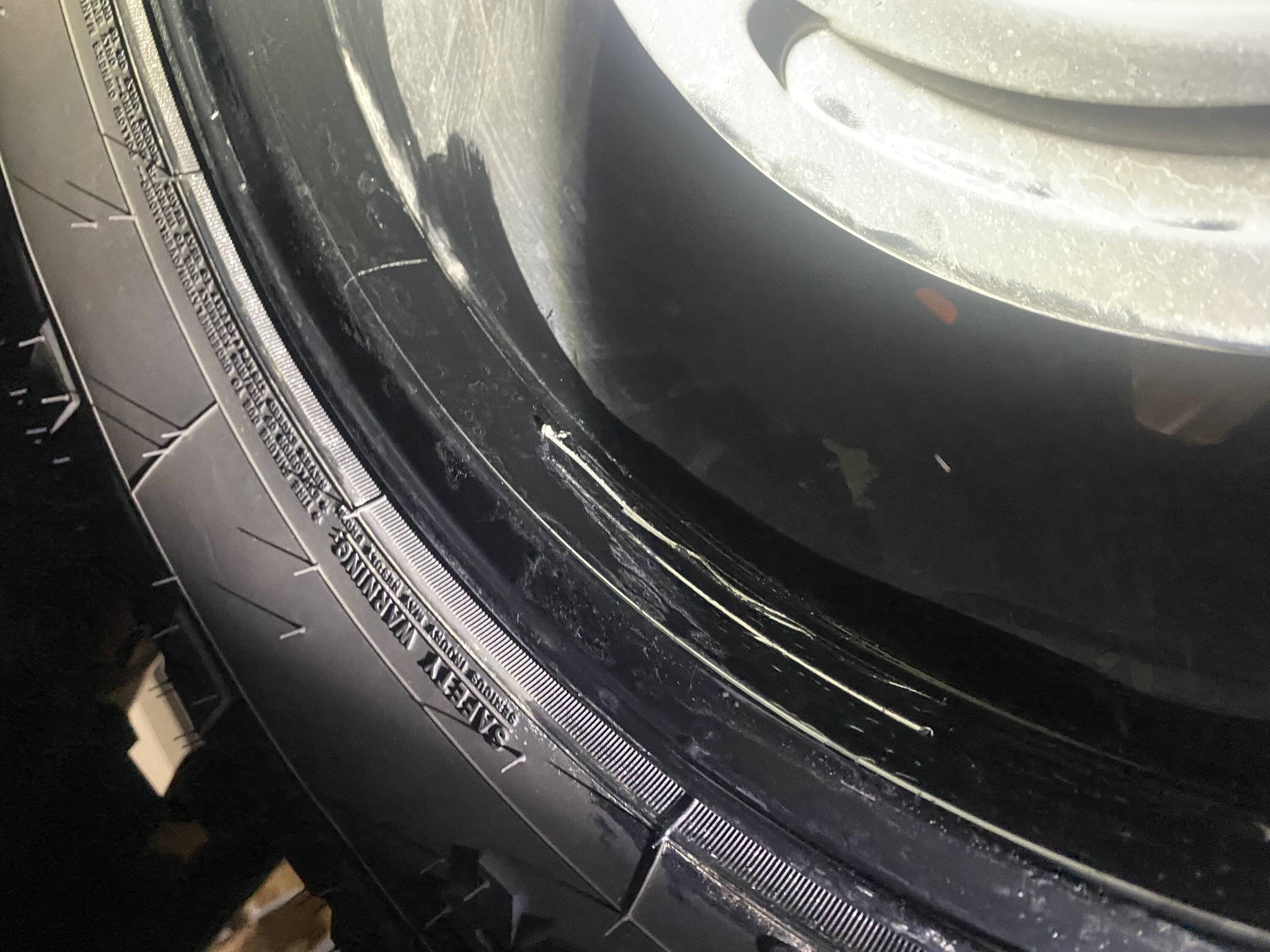

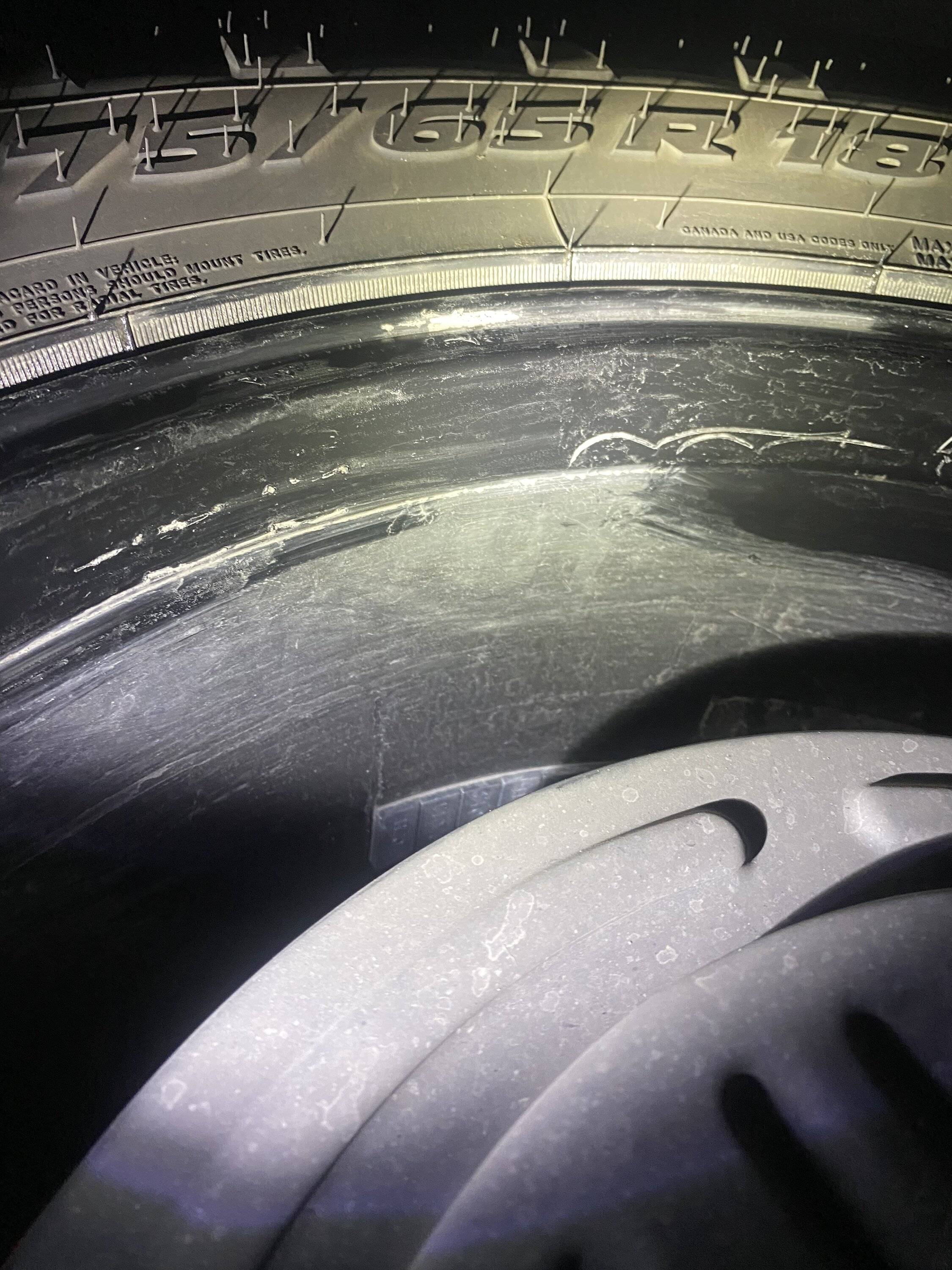

I found deep scratches on the inside back part of the wheel that is mounted on the same hub.

Those scratches look like a hack job removing the weights, well maybe.
