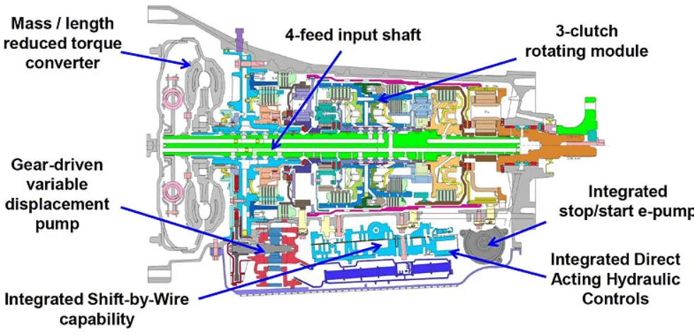

There are actually two different 10 speed transmissions. The 10R60 in the explorer or the 10R80 on our trucks which is heavier duty and higher torque rating. Apparently there is a big stink going on right now as it appears the new bronco is coming with the ā€œweakerā€ trans but it’s mostly speculation at the moment. The transmission is one of the best parts about the 5G ranger hopefully they get yours sorted out.
And a 10R140 used in the Superduty. ?

I'd expect the bronco to have a significantly lower tow rating, so the 10R60 would make a lot of sense. Is there any compelling reason for it to have the same transmission as an F150 that can pull like 18000 pounds? If you're never going to use the capacity, it seems silly to cart around the extra weight.
I assume the internet drama queens are in full form over this bit of nothing.
The Bronco is tow rated at 3500 lbs Mike. I have one ordered, and a member of that forum. It's a shit show over the 10R60. As far as I can tell from my small amount of research, the only difference between the 80 and 60 is the 60 has a little lower torque rating. Considering the intended use of the Bronco the 60 should be just fine. It ain't a tow monster, and it damn sure ain't a road racer. Myself, I'm fine with the 60.
