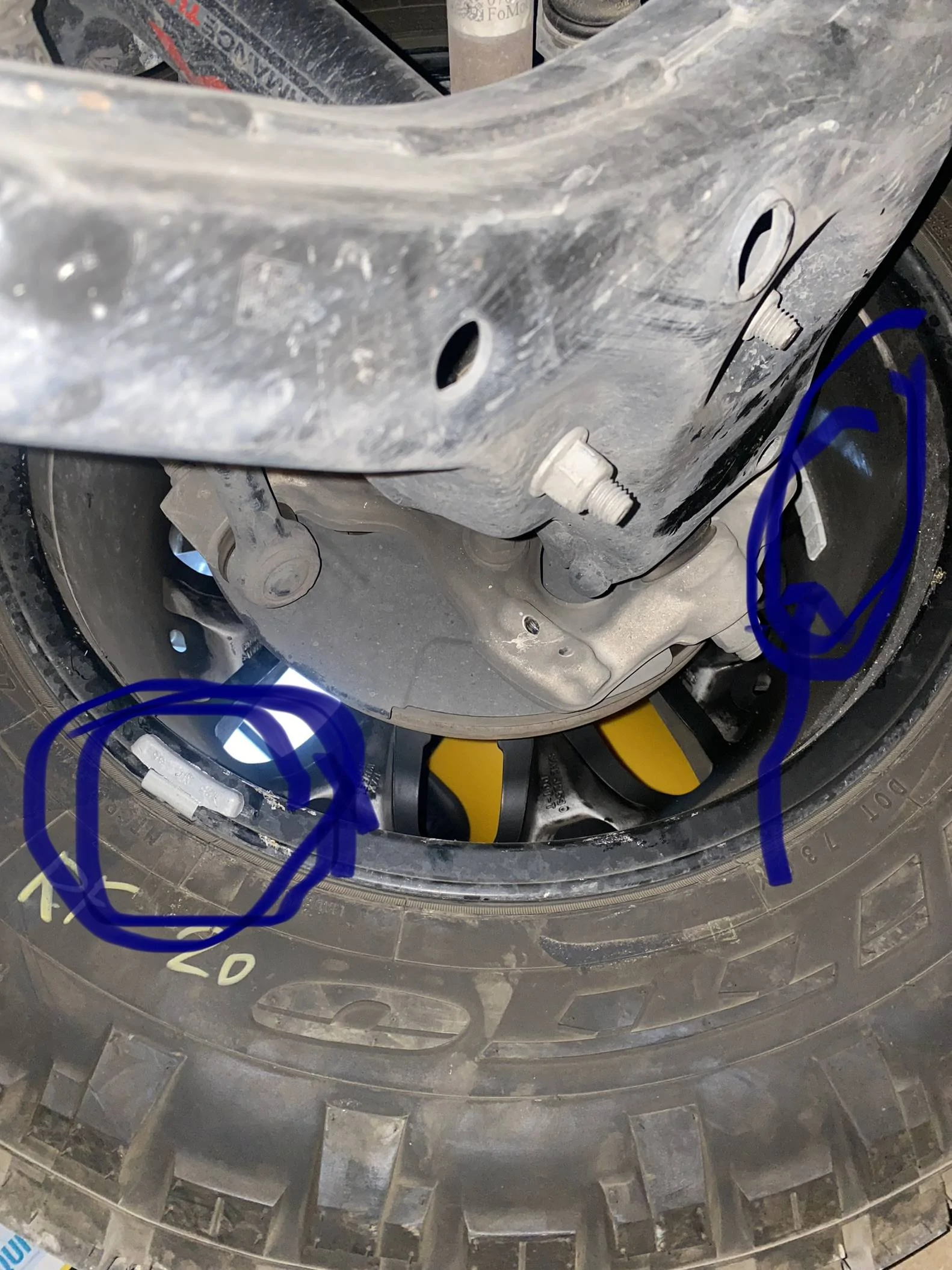

I highly recommend to get your tires road force balanced by the dealership and get the dealer to give you the road force numbers, if they aren’t to your vehicles specs you have a right to get tires that meet specs. You have a tire warranty and the information should be in with your paperwork when you bought your truck or go online to ford.com to search for warranty information. My personal opinion is that tires that don’t meet your truck’s requirements are defective and shouldn’t have been put on your truck as stock that way. My situation started the same way, all was fine until I had a balance and rotation, I even went through 3 sets and 2 different brands of tires and no resolution. It took a mom and pop shop who had more knowledge on where to place the weights to get them to reduce the shaking. You deserve to have a peaceful ride. DT put the weights in one spot and didn’t clean the residue from the previous balance off the rims so the new sticky weights didn’t stay on and flew off.
My tires were out of balance when I took it to Pruskis so they have been that way since my last rebalance from DT. I RECOMMEND that the dealership put the weights on both sides of the rims, on the inside and outside so they don’t wobble right to left and make sure the rims are clear of residue if using sticky weights. I’ll take a photo and attach it so you can see what I’m trying to explain.

I asked Pruskis what the road force number should be for my truck and he said it should be less than 15, I believe it has to do with how heavy your vehicle is but I’m not certain. I trusted Pruskis but the Ford service guy said it is probably around 20 or less for my truck, good question.

Discount Tire definitely stands by their motto “Let’s Get You Taken Care Of”, it took a while due to a shortage of my replacement tires but they definitely stood by me and got me taken care of! D.T. called me yesterday to say that my replacement rims and tires from Tire Rack were in and to come by for installation, it took all of 15 minutes, the rims, tires, sensors, hub rings and weights all ready to go with tires road force tested at an 8!!! D.T. and Tire Rack are teamed up so the manager was able to orchestrate and coordinate the replacement for me, well done Mike Carnes at the Goliad Rd store in San Antonio!! They reimbursed me for out of pocket costs for the rebalancing too. I highly recommend that you do the same.
