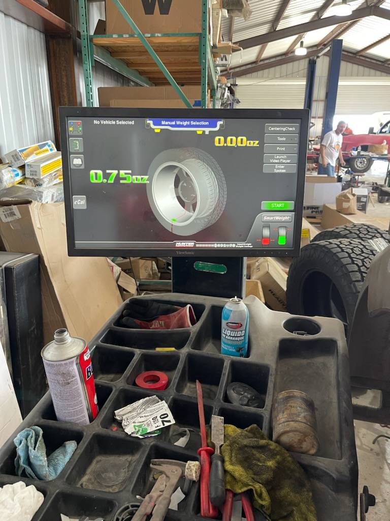

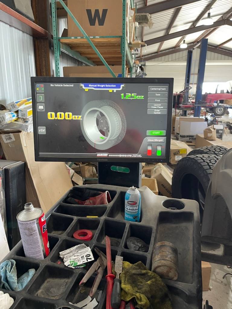

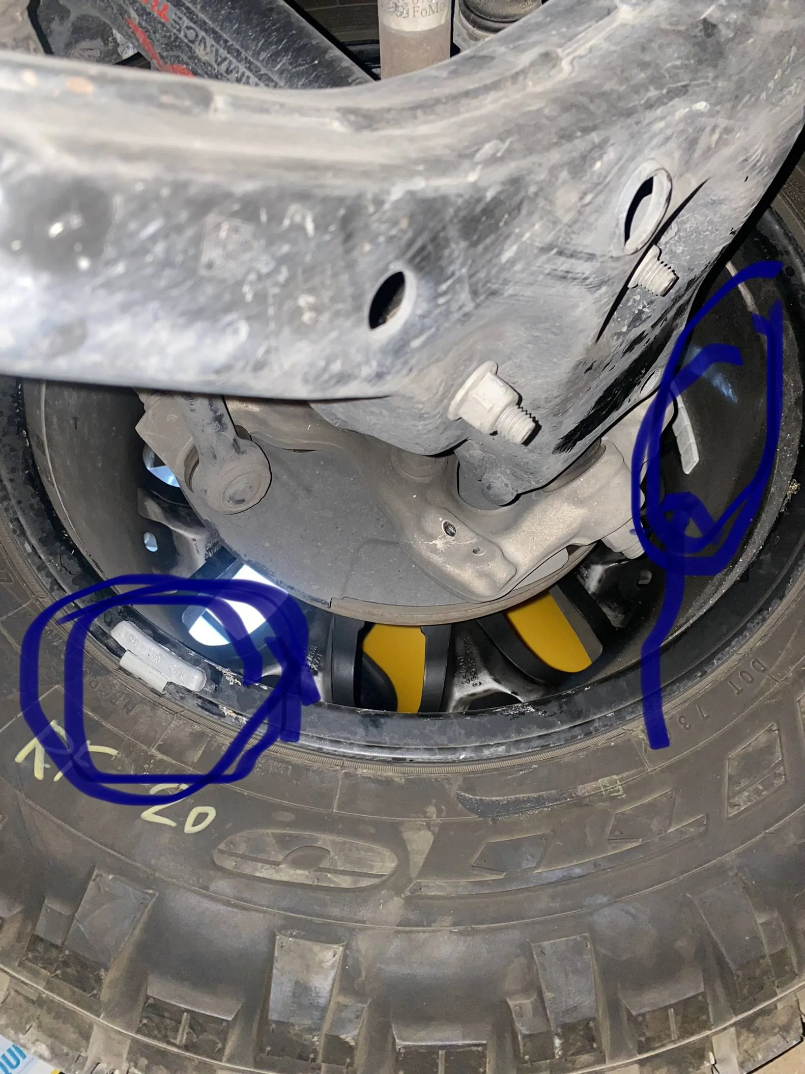

Vibration cause found!!!!!!!!!!!!!
I took my truck to Pruski’s in Floresville to get my wheels/tires road force balanced and the vibration is now very minimal!!!! It looks like the tires are misshaped and unbalanced to begin with, they balanced both sides of my rims from putting weights on the inner rim and clip on weights on the back of the rims…I can’t believe that this was the cause all along!!!!!! It cost me $100.00 to get this done but I have the receipt to get reimbursed from Discount Tire.
I believe the remaining vibe is from the tires being out of round something terrible or maybe related to my damaged rotor.
If I didn’t have such a smooth ride when I had my BF Goodrich’s initially I wouldn’t have had an issue with the ride I have now. Since my warranty expires next month I want to make sure that there isn’t anything else that needs to be fixed or done before the expiration so I’m still going to Ford Dealer next week. I hope this helps. Please see attached road force numbers, should I be correct in asking for an exchange of tires that have the correct road force number below 15 (that’s the number Pruskis gave me for my truck)????? These are the before and after numbers in photo.
Here’s a photo of the sticky weights and clip weight on the rim for an example.
