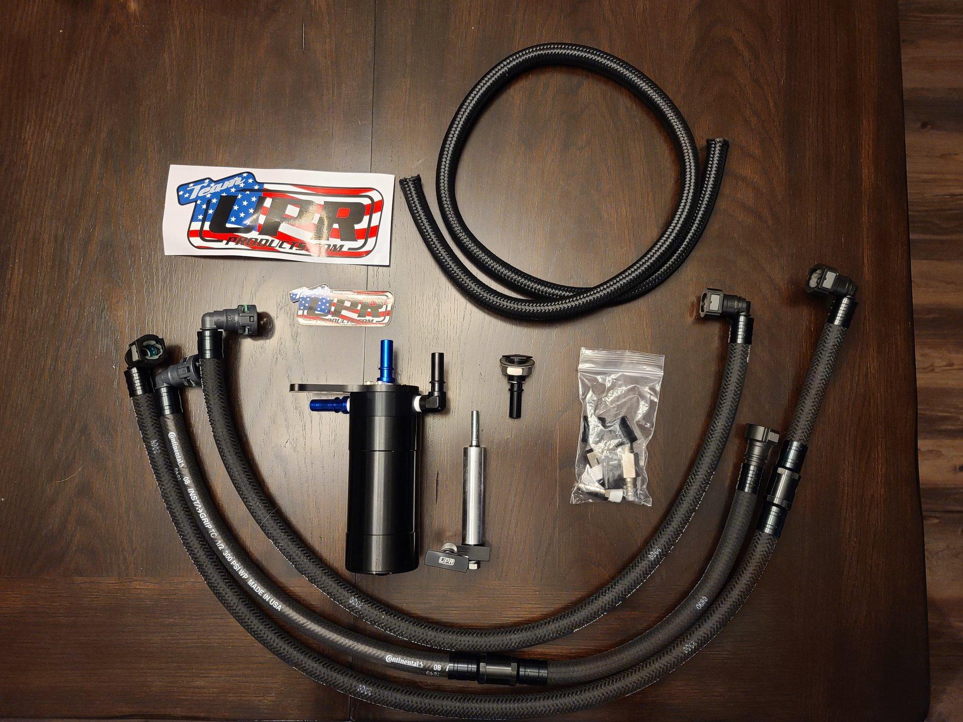

Received my UPR dual valve catch can kit today. Very excited to get this thing installed and see how much more it catches compared to the Mishimoto unit.
Mine is optioned as follows:
Finish - Black
Pro series check valves
Catch can drain line kit
Racket

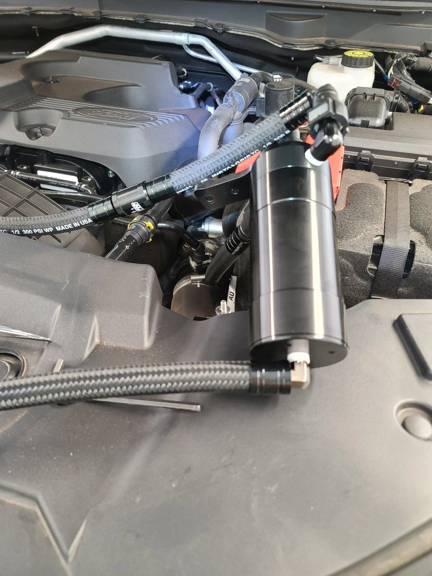

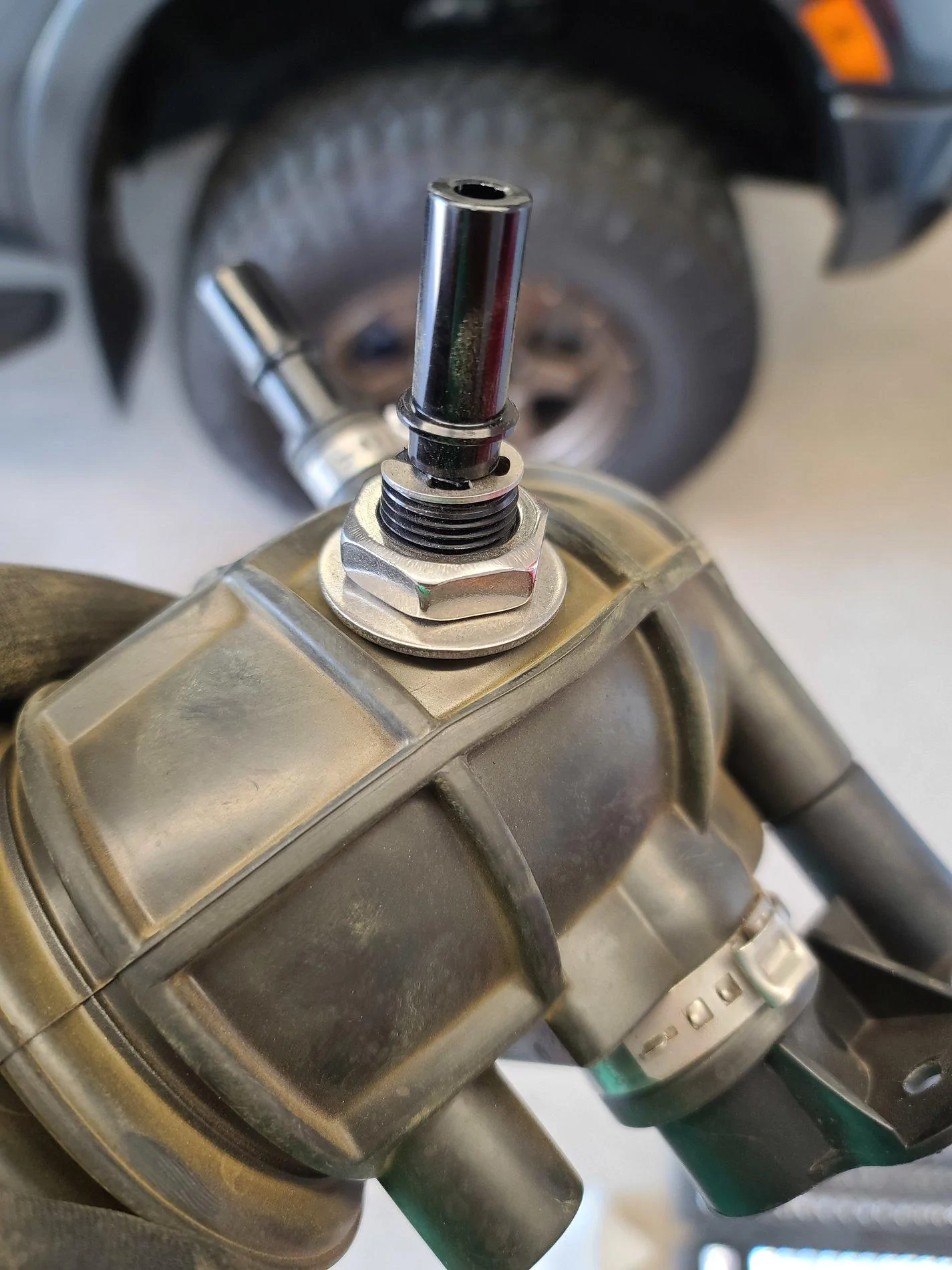

Ran down to Lake Worth yesterday, the owner came out and we spoke about this product and what to expect. I brought up competing companies' product and he had specific points that he felt made his superior and I feel even better about this investment. My original goal was to reduce the evaporated contaminants from going into the intake, and after almost 10K miles I'm thinking this should be the first mod a lo g term direct injection motor should get.

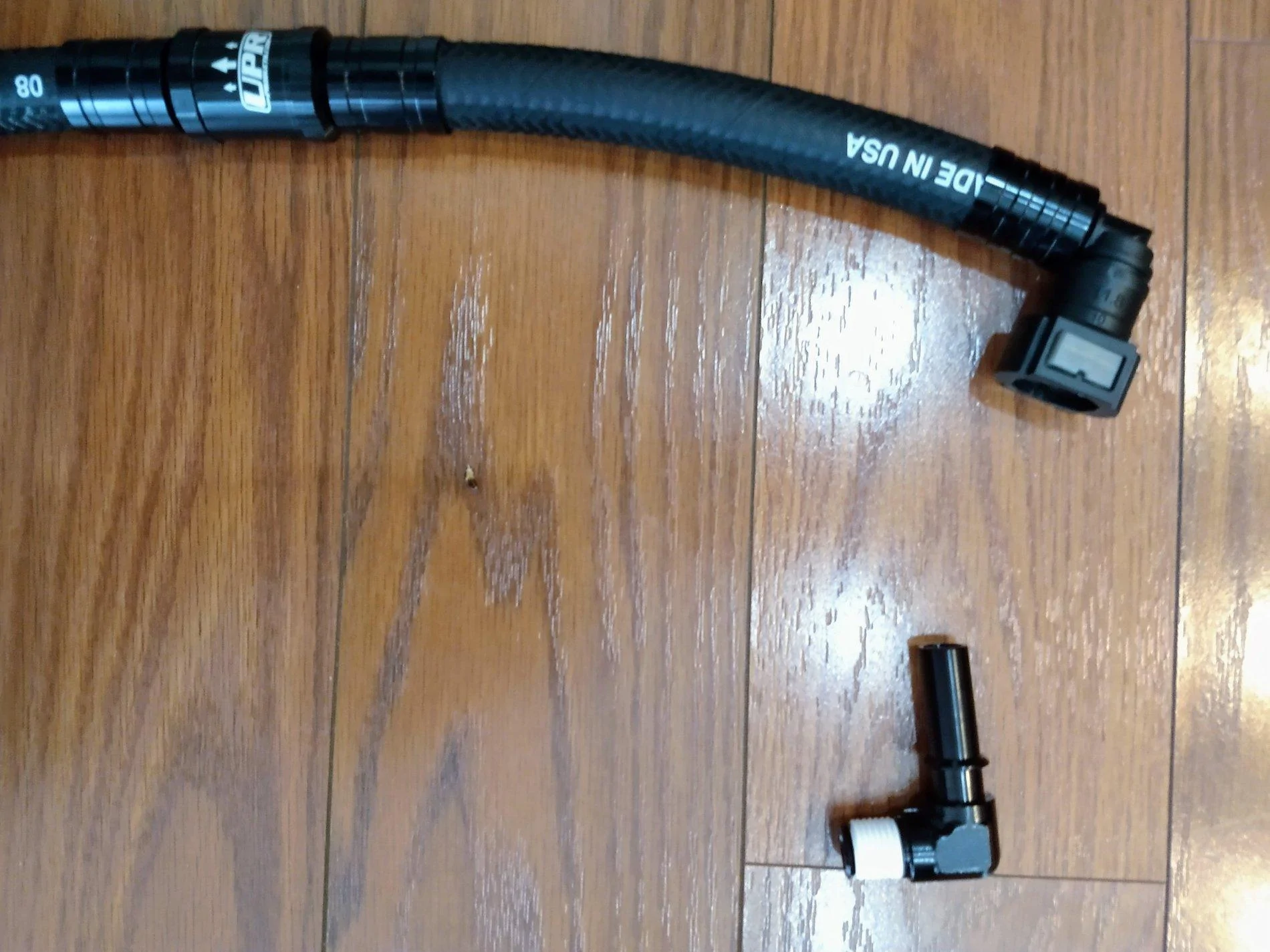

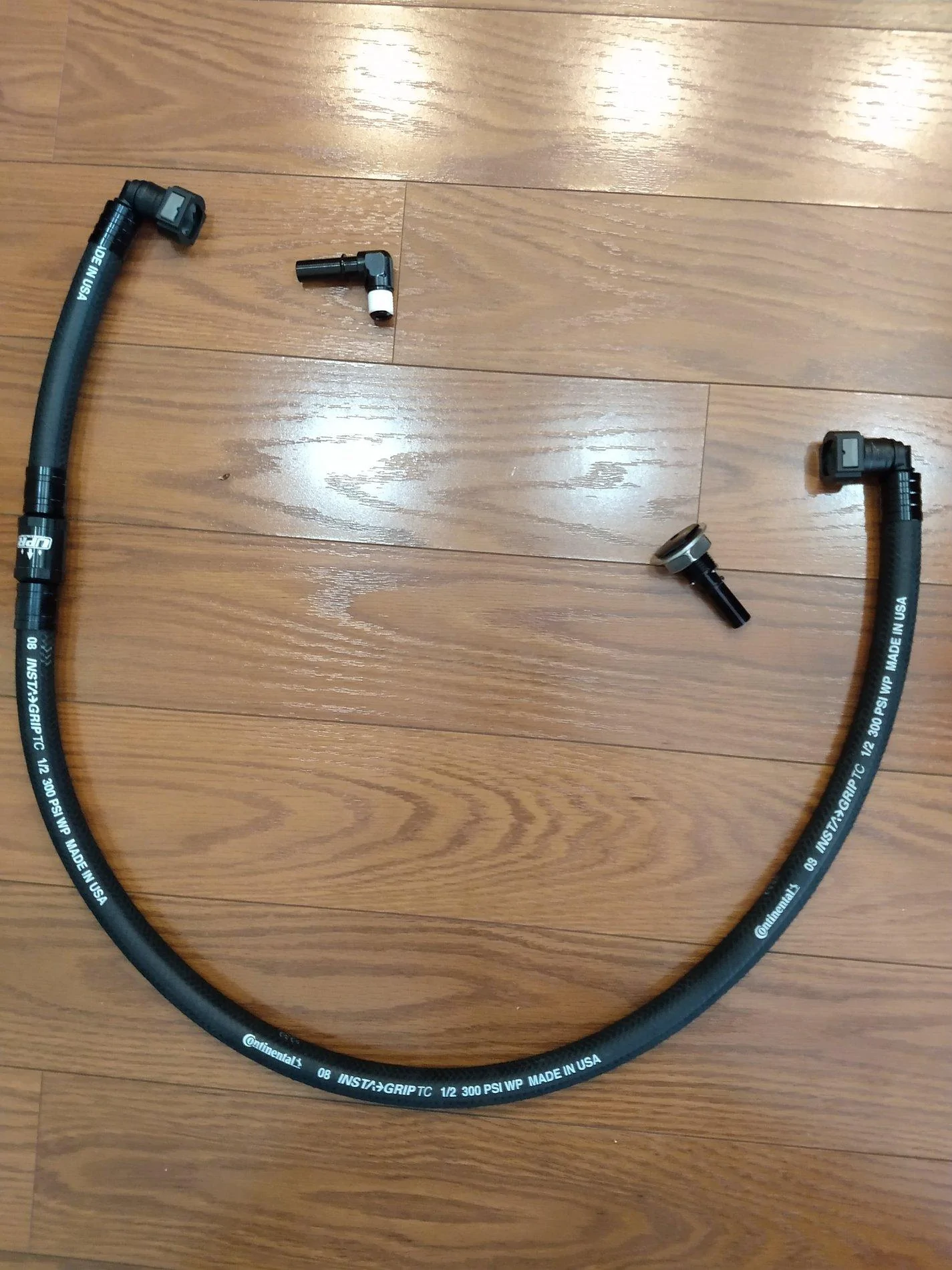

What I got to add to my existing single vacuum source UPR can:

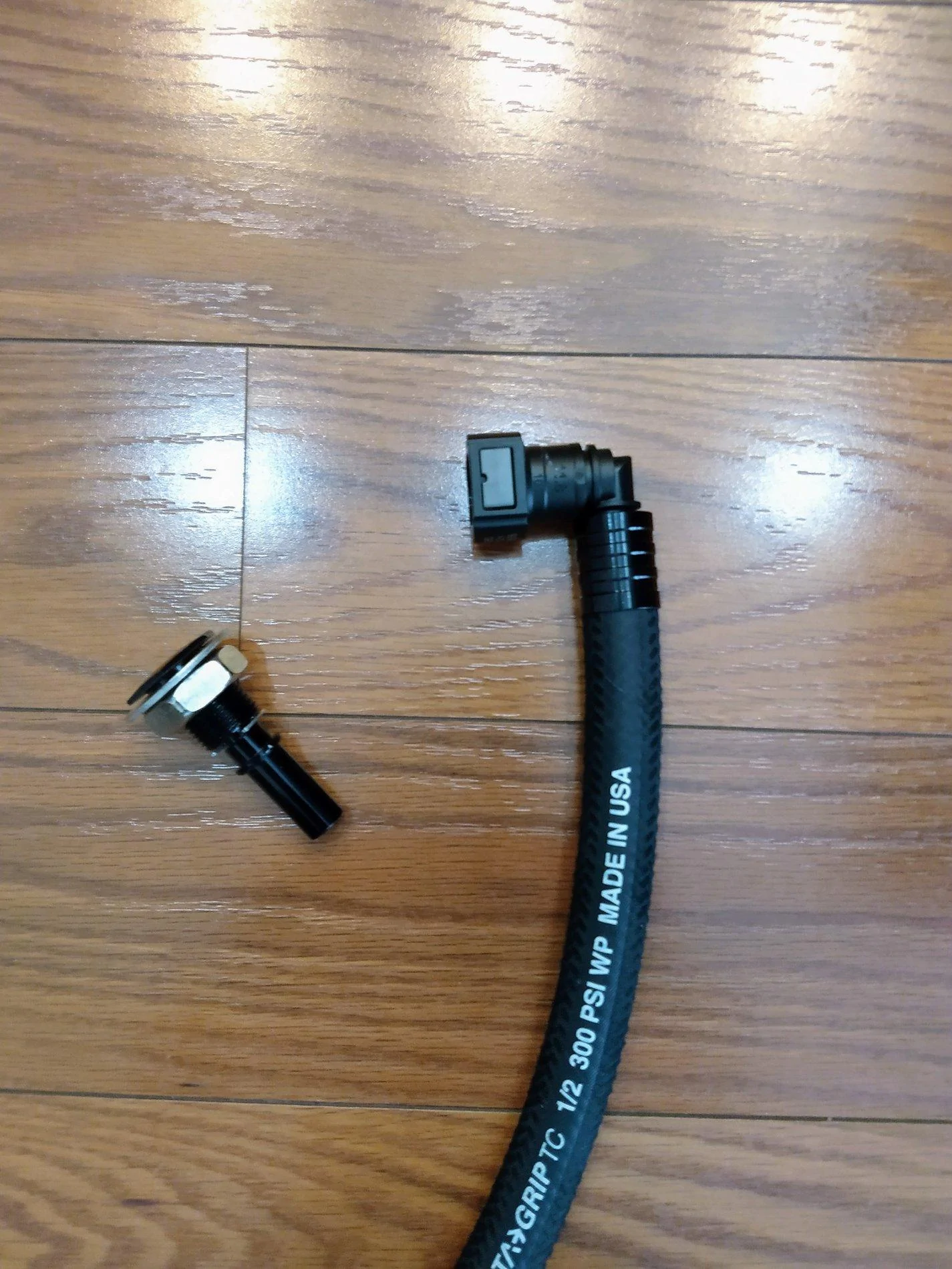

For the as of yet unused port on the catch can (see it on the left):

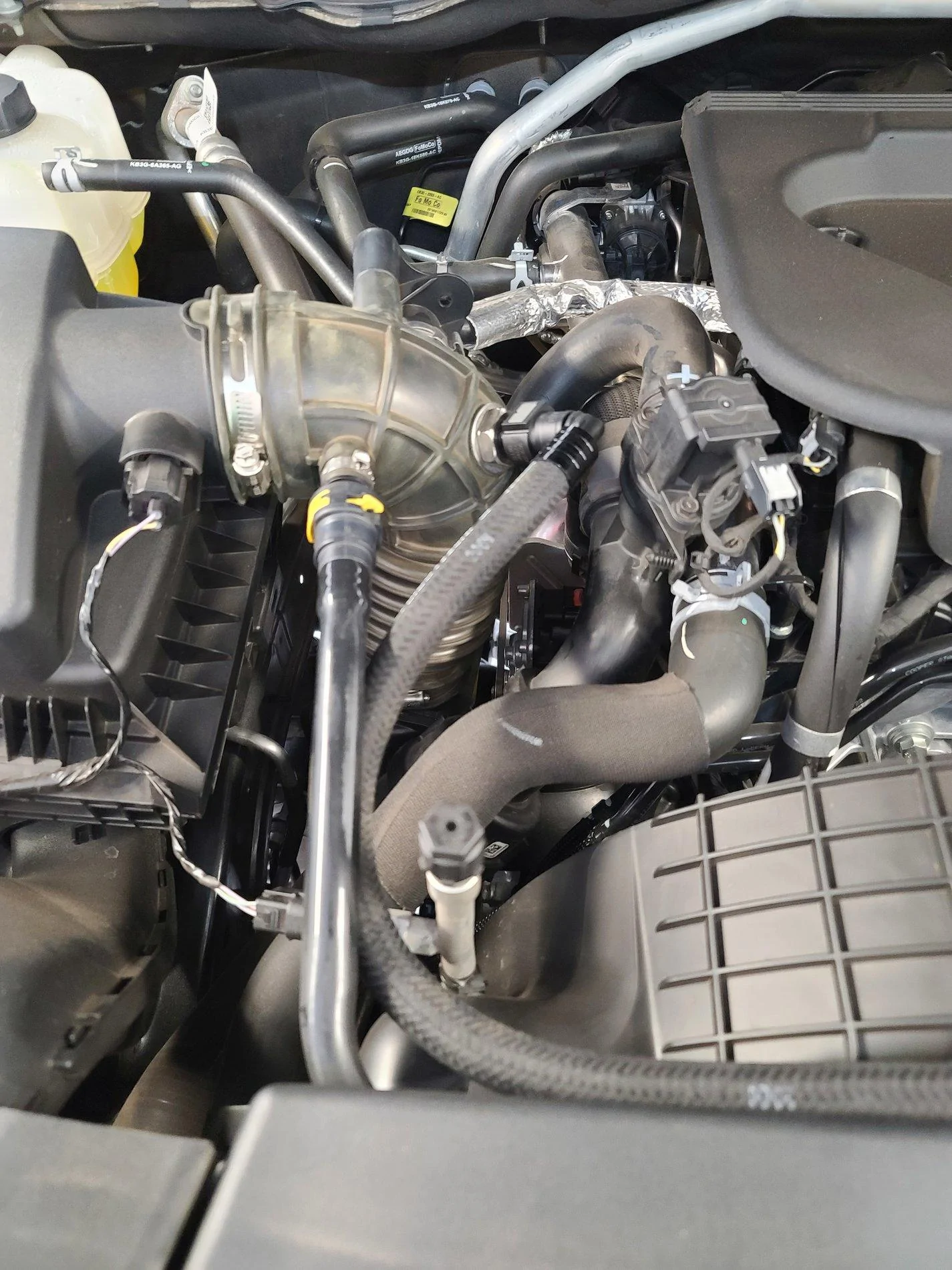

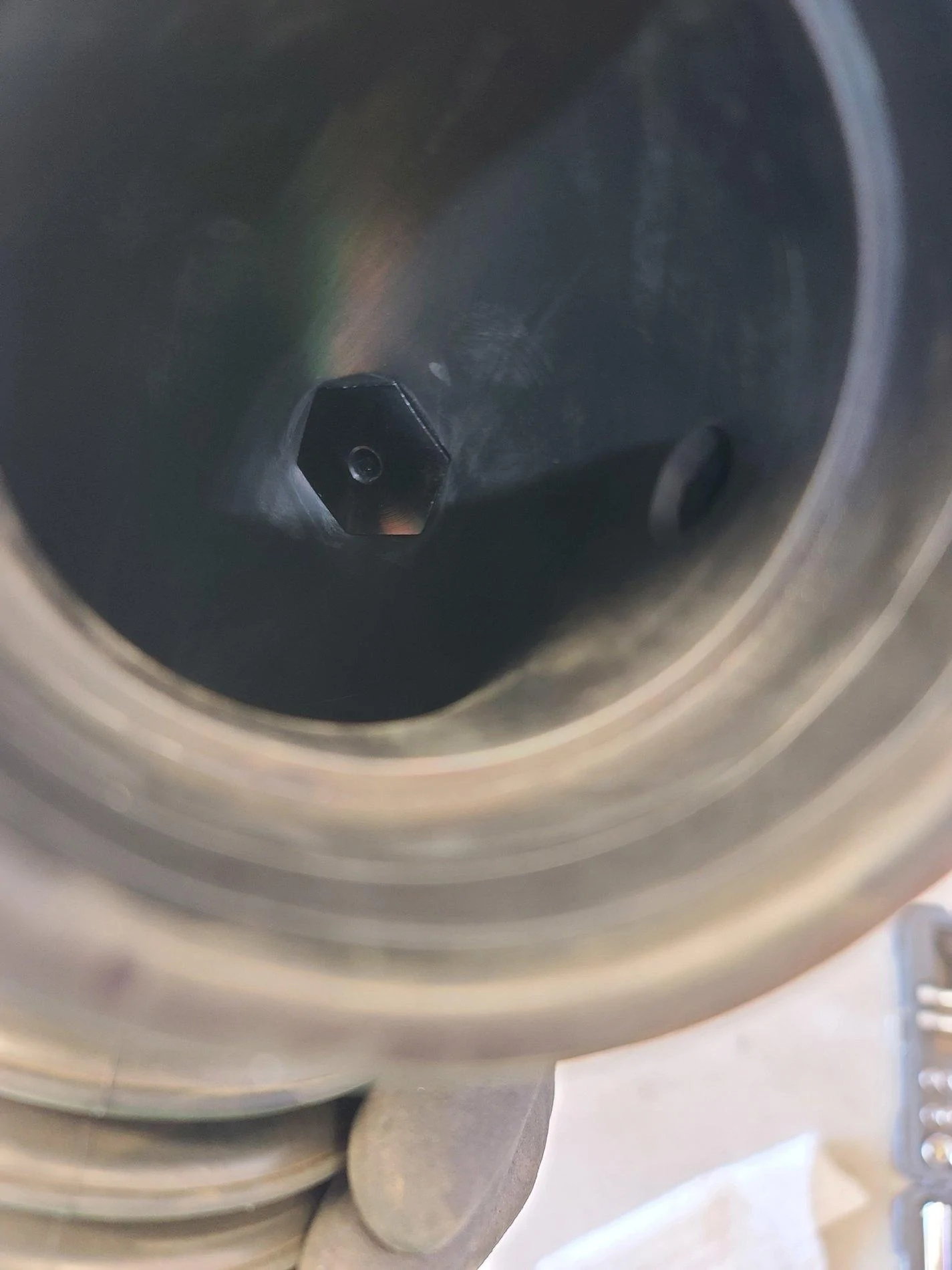

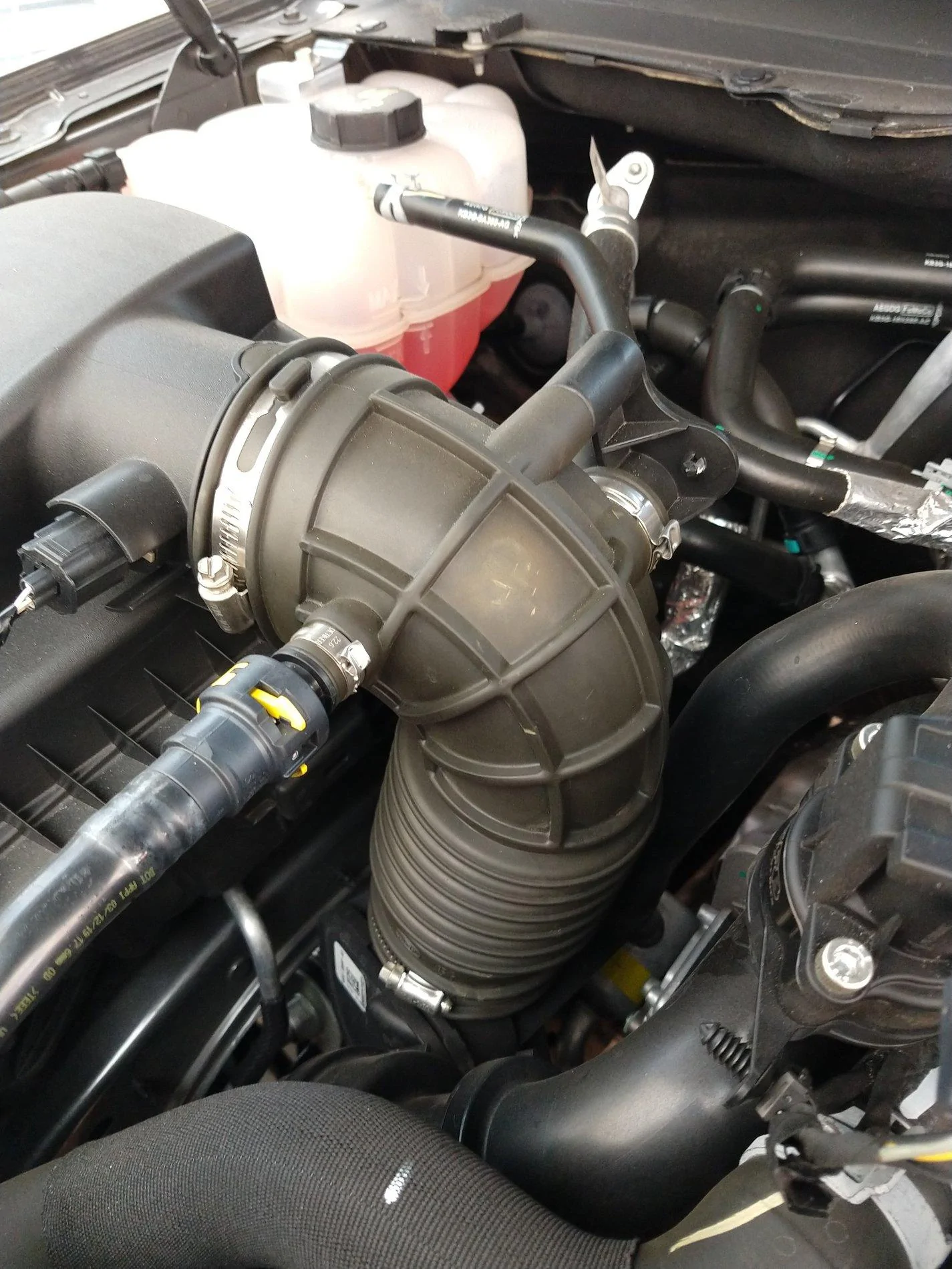

Then the part that requires a hole in the intake elbow(unblemished elbow for reference):

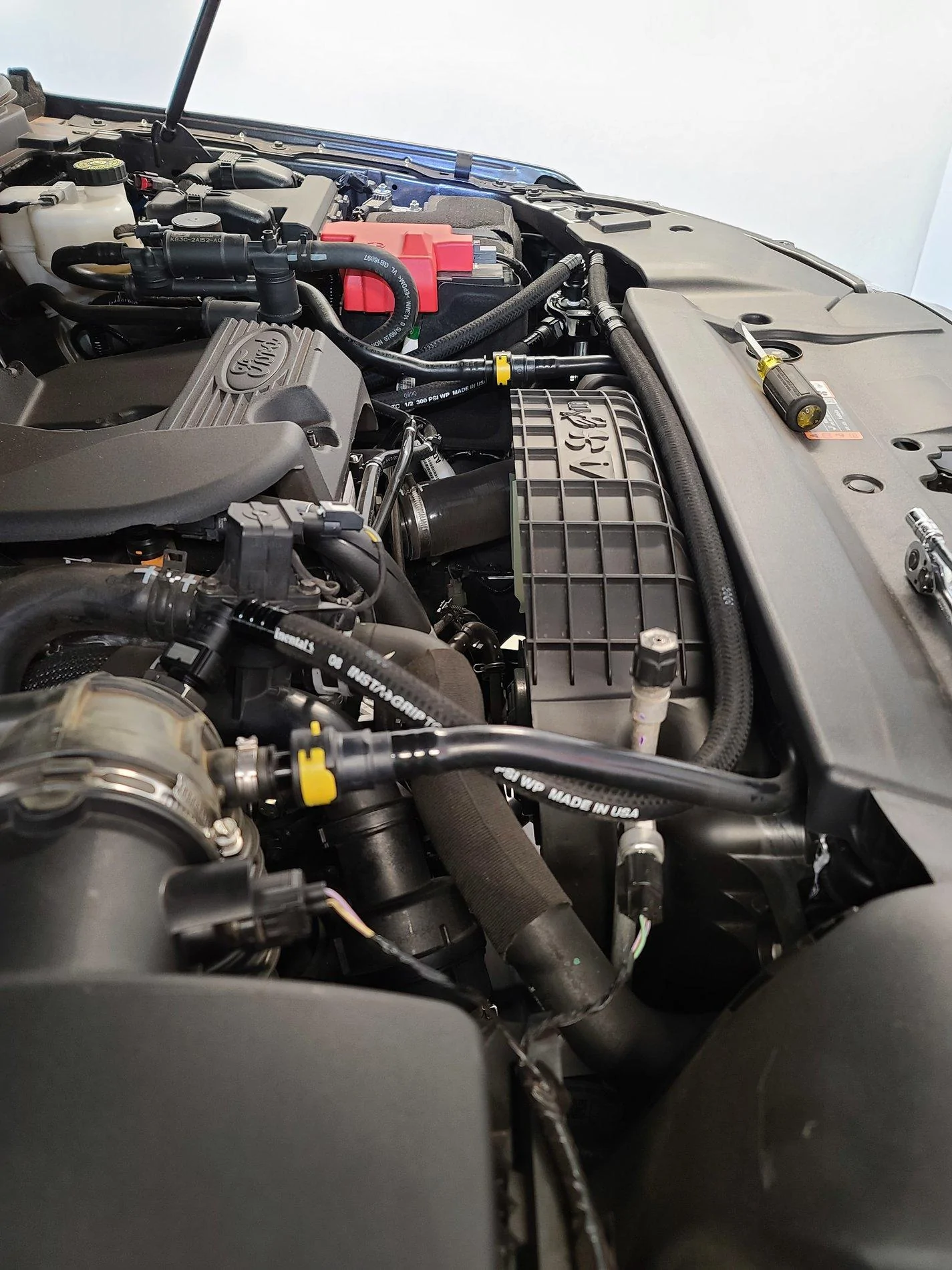

In between downpours I took off the elbow since I didn't want to get a bunch of rubber material in the intake (duh), drilled out enough to keep the fitting snug and mounted it back up. There is a clamp that holds a plastic retainer piece onto the elbow you might want to replace (I did) but I'm not sure it would be needed. You might notice I put the vacuum tap a little higher - that was because the space between the ribs was larger and I didn't trust I'd get the hole centered any better. With the washer I didn't want it distorting the rubber. Clearance to the insulation is not a problem. You might spot the GFB DV+ there, no issues.

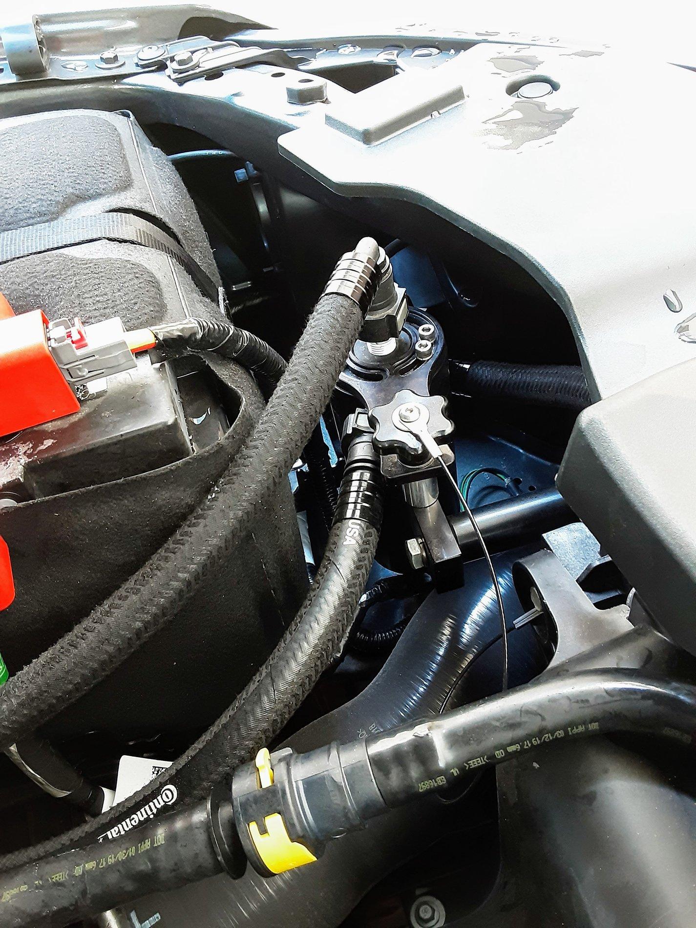

Routed the hose along side the hard line that also comes off the elbow and runs to the driver's side. Everything under the hard plastic shroud. You can't see the check valve from here.

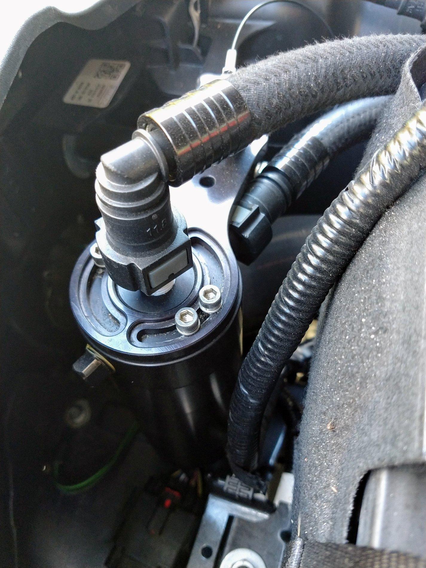

The billet body unscrews. Here's a pic of the filter:
