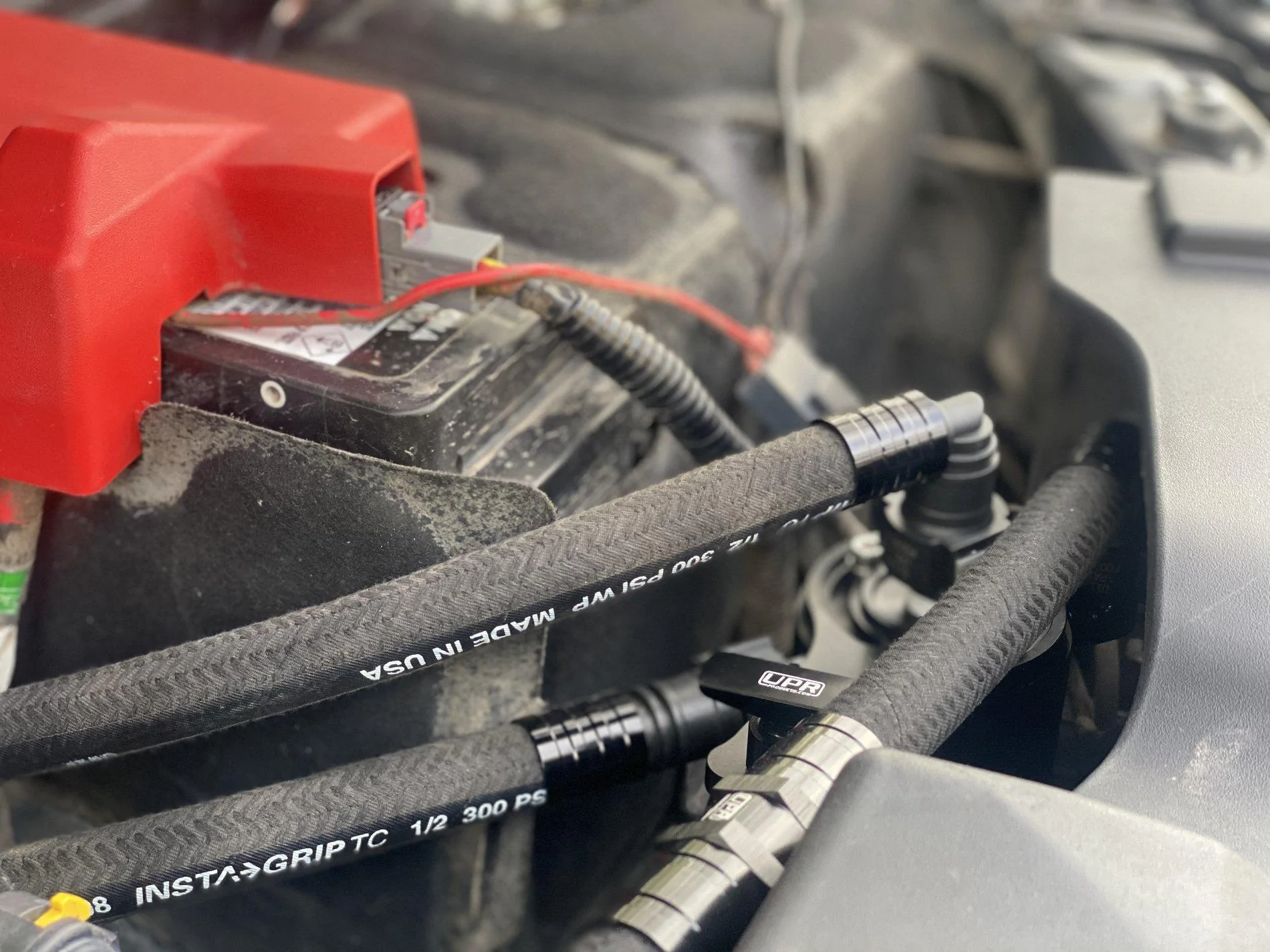

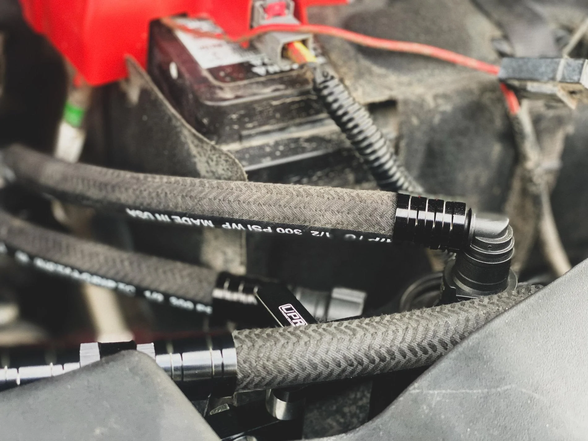

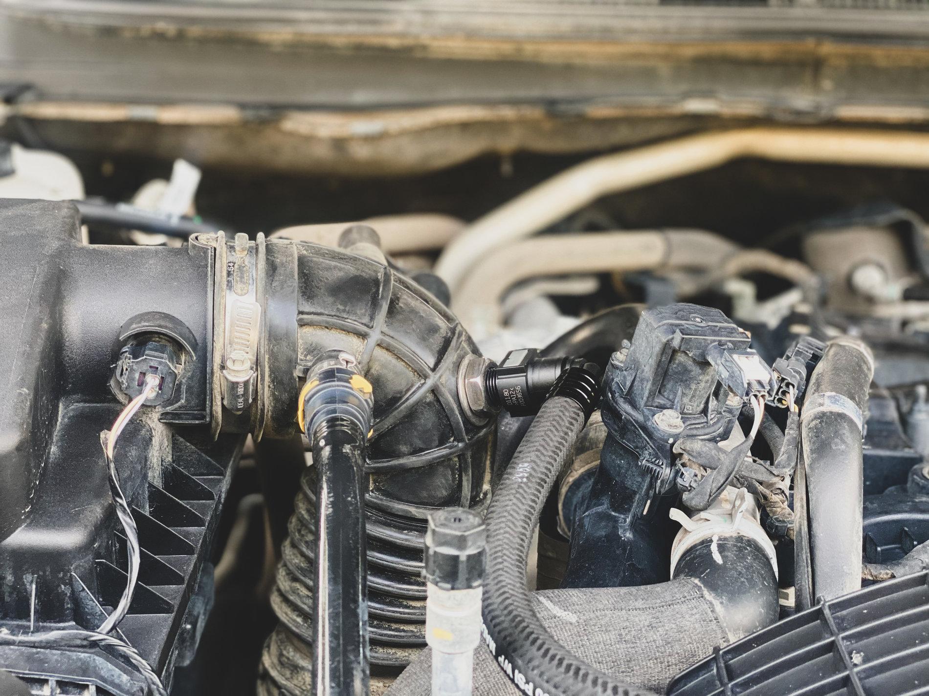

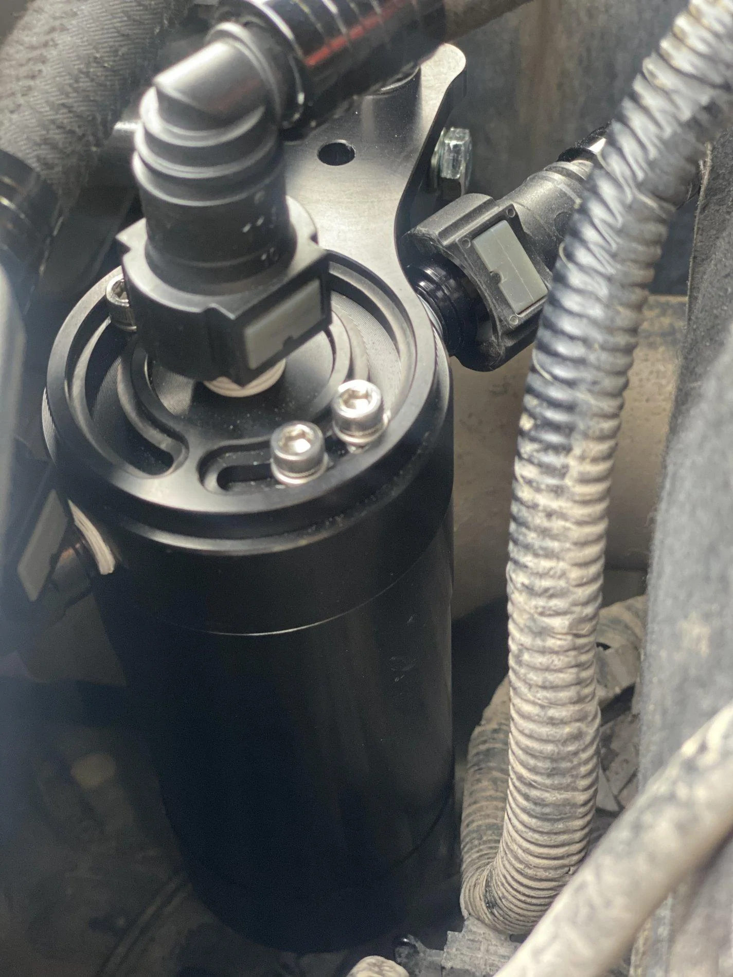

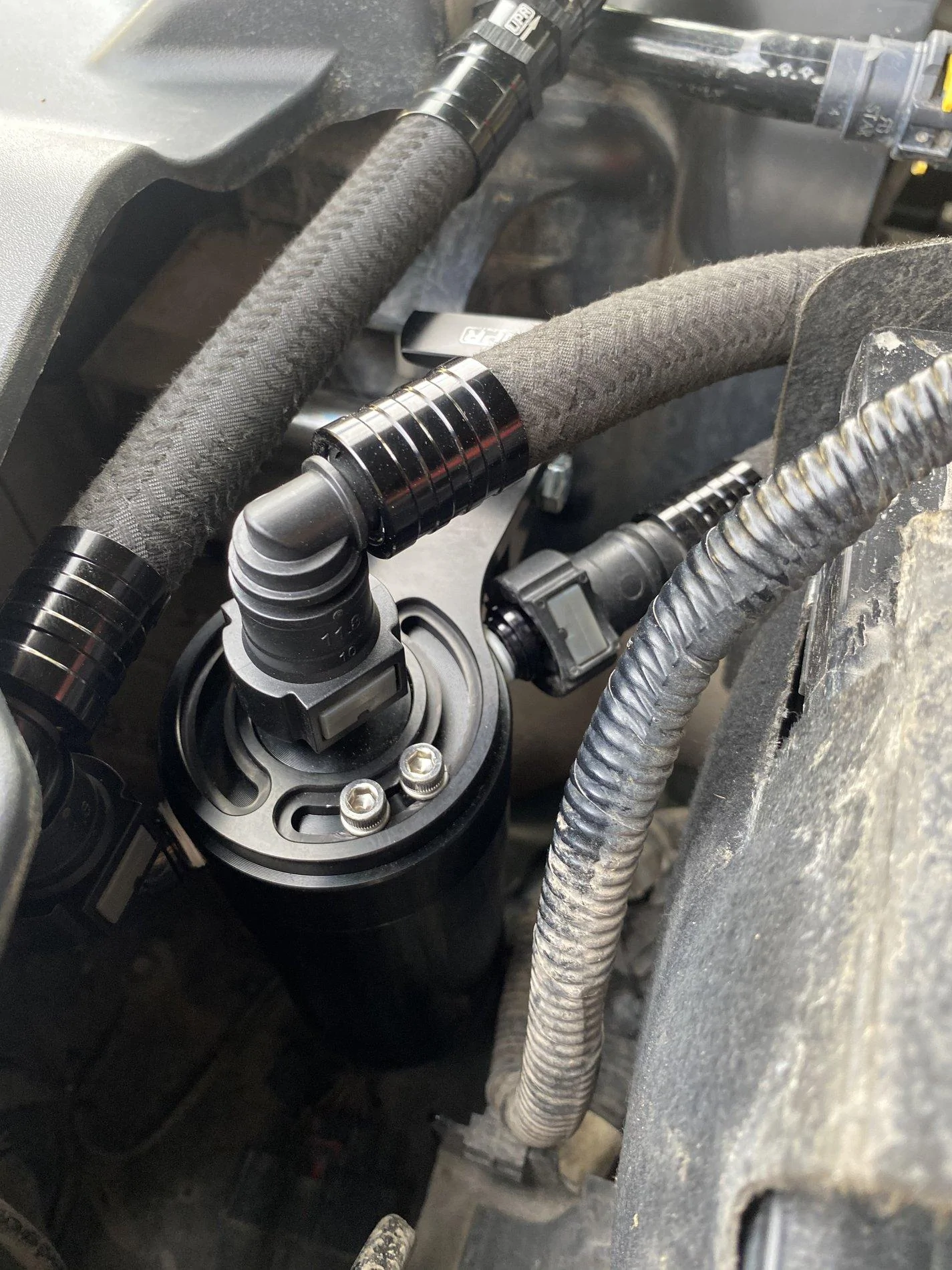

So update on the catch can from UPR Products. First off want to state they are some of the nicest people over there and very educated guys over there, especially Steve. Currently the first one to be running the UPR Dual Valve Catch Can set up. Also using their oil cap breather too. Very high quality products and ended up getting some stuff also for my race car too. Love how clean the install is, they will be making this kit plug and play to an extent. To install this you will need to be some what mechanically inclined, need to tap into the intake tube and also running the line for the intake is a little tricky; the driver side wheel needs to be removed. But all in all it’s great kit and would highly recommend buying a kit from UPR. First kit is being sent out soon. — at UPR Products.

Keep us updated on what your can collects. I currently have the Mishimoto can on my truck that only collects from the CCV using the intake manifold as the point of vacuum. The issue with that is when driving we rarely have vacuum in our intake manifolds since we are turbocharged. With the dual valve set ups we will be able to pull vacuum from the pre-turbo inlet tube while under boost which means way more opportunities to collect.

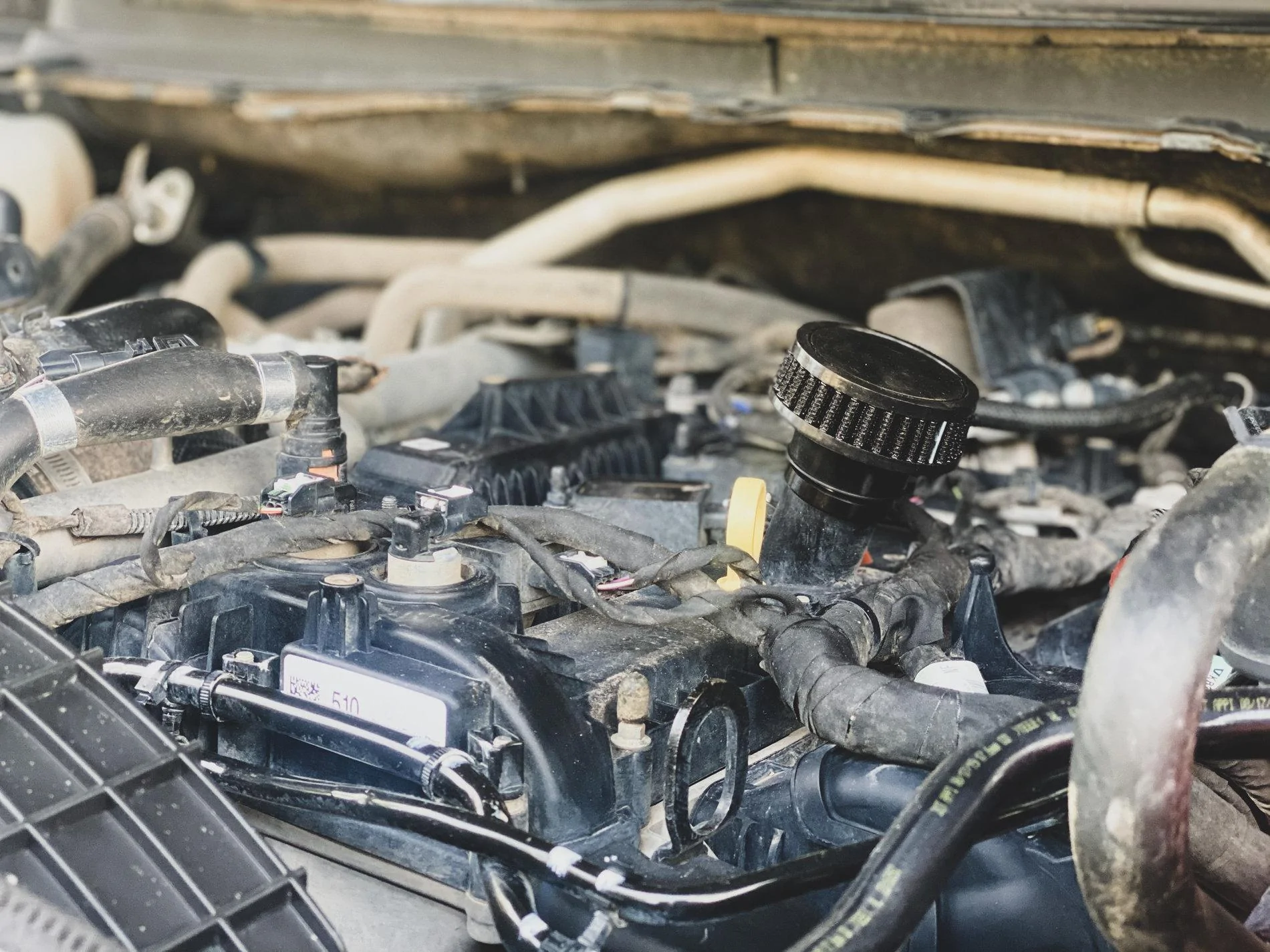

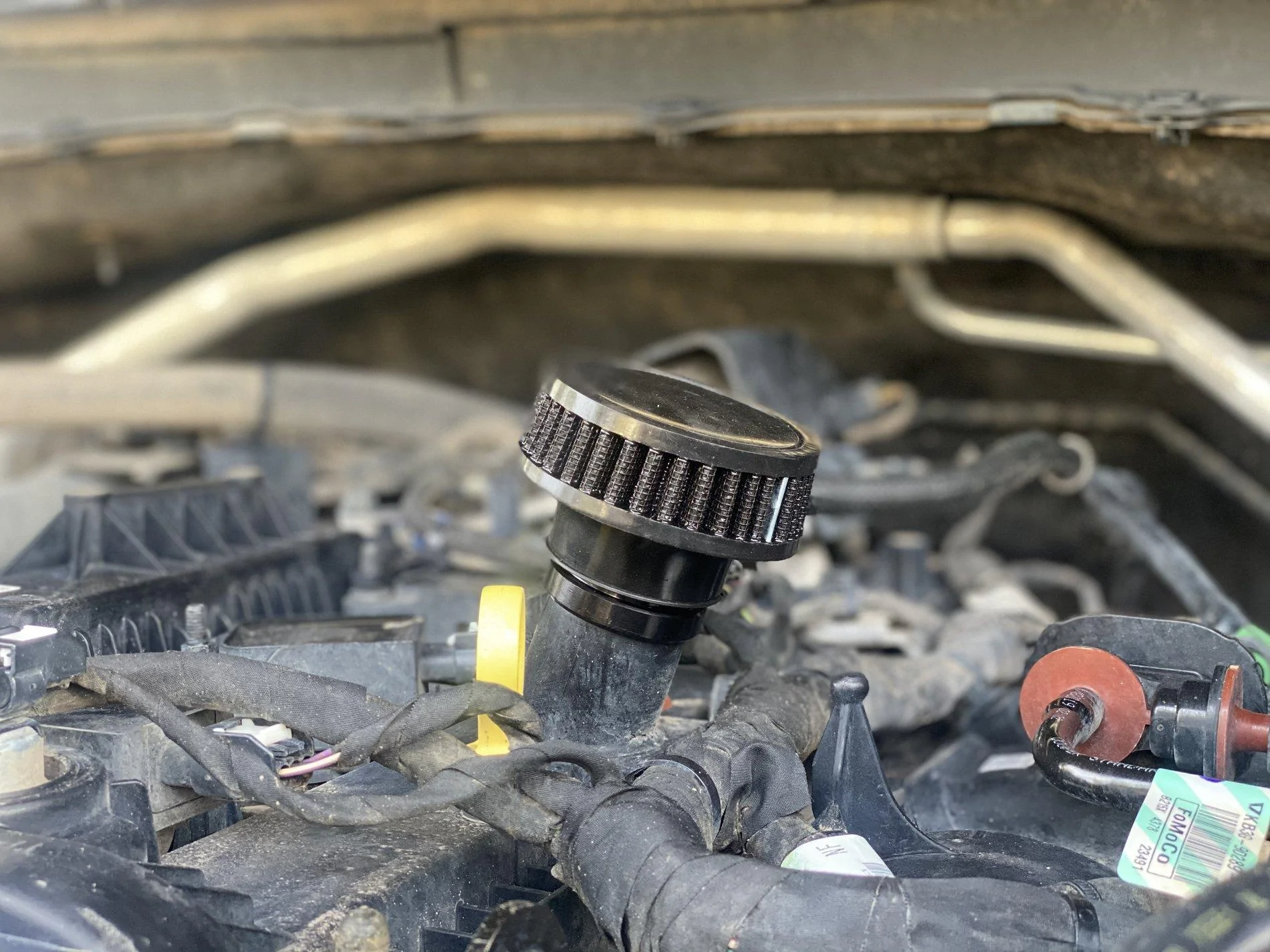

Sooooooo........... Its cool to have that catch can but you need to change your breather back to the original oil cap...... Why you might ask? That breather is causing a lean condition and in time will cause a lean code to pop up. Figured I would tell you now before you run into problems.

Glad you spoke up, that breather in that dirty engine compartment was giving me anxiety. I remember other catch can conversations challenging the vented versions.

You can still have a catch can, just wouldnt recommend removing the oil filler cap and placing a breather on it. I have see a missing oil cap cause a lean code and a breather can do the same thing.

I ran a breather cap from CFM for exactly one day. Left a huge oily mess under my hood and I immediately uninstalled it. But im also one of the people that has the fuel in oil problem pretty bad. Just did my second oil change and sent another analysis to Blackstone. Oil sample smelled 100% like gas. But Ford has informed me its normal and my truck is working as designed sooooo lol

I'm not a fan of breathers either, on modern motors.
But one thing to keep in mind is some of the breathers (not sure if this applies to UPR) are designed with a check valve in them and they only vent in the event the crankcase experiences positive pressure.

It has a built in check valve
