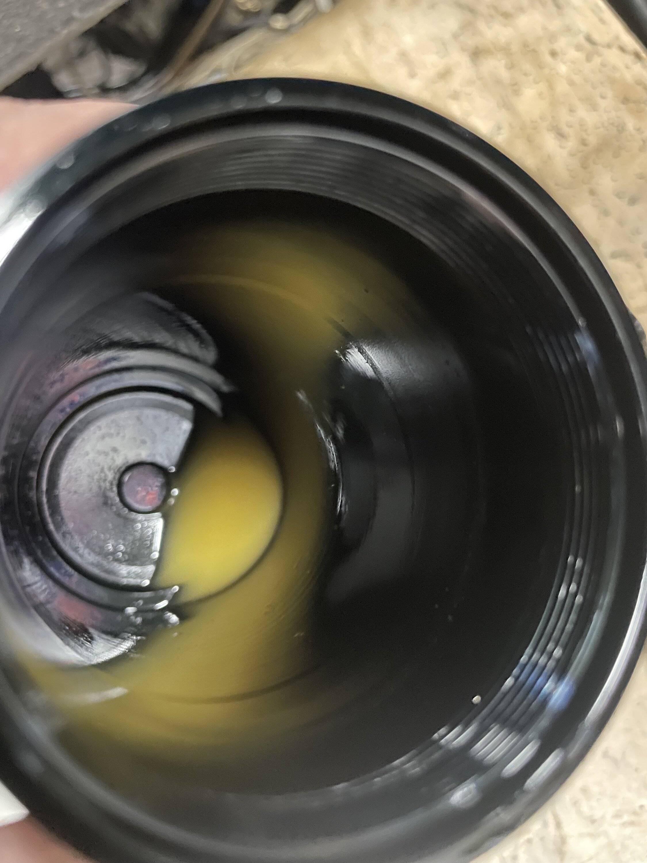

For those that have one does this look normal? Looks like water but smells like gas..

So first off, I don't have the UPR duel set up, I just have a single no name brand one.
(This does not matter though)
Second, what were your driving habits and style between now and last check?
Short trips and/or lots of idling will produce this. I get lots of water during winter, hardly any during summer.
Lastly, contents in the catch cans will always have a fuel smell. Unless you're driving on the highway all the time, that looks normal if it's all short trips and long idles.
It’s gas. In cold weather I get pretty much all fuel with a tiny bit of oil and some water. In warm weather I get almost nothing in my can.

It’s the stuff you don’t want in your intake or oil pan.

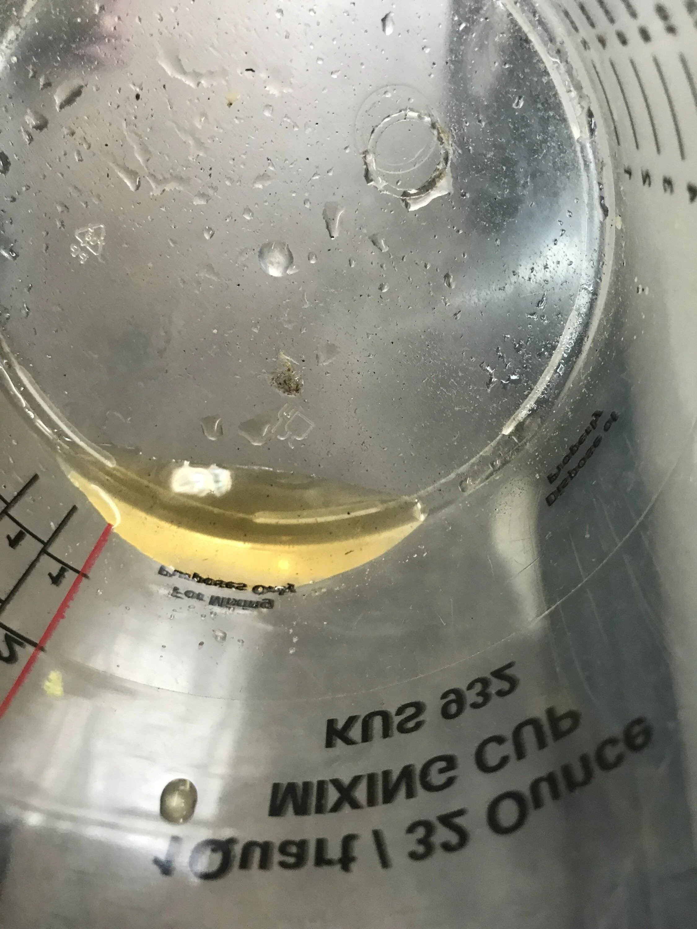

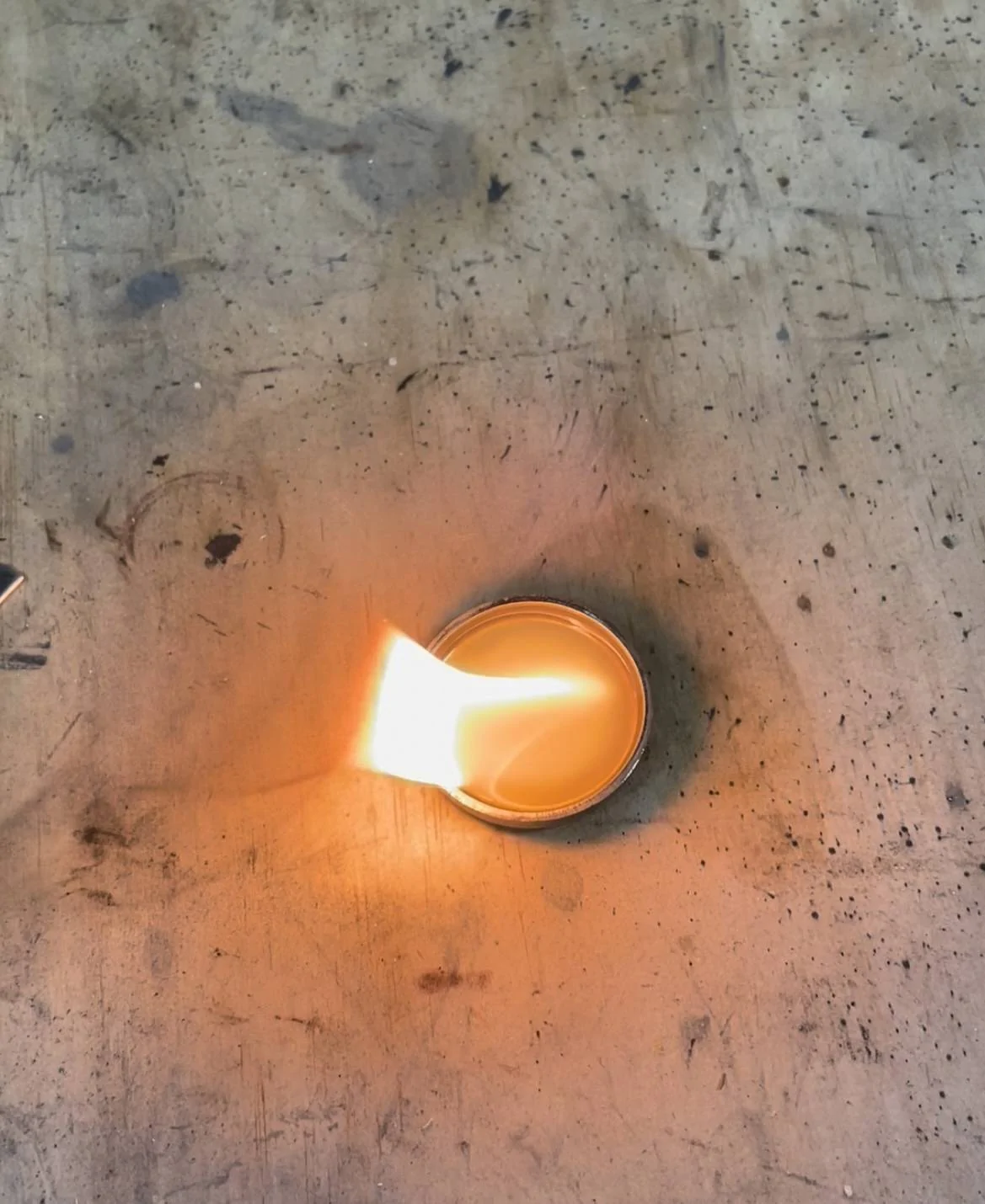

No match test done here.
