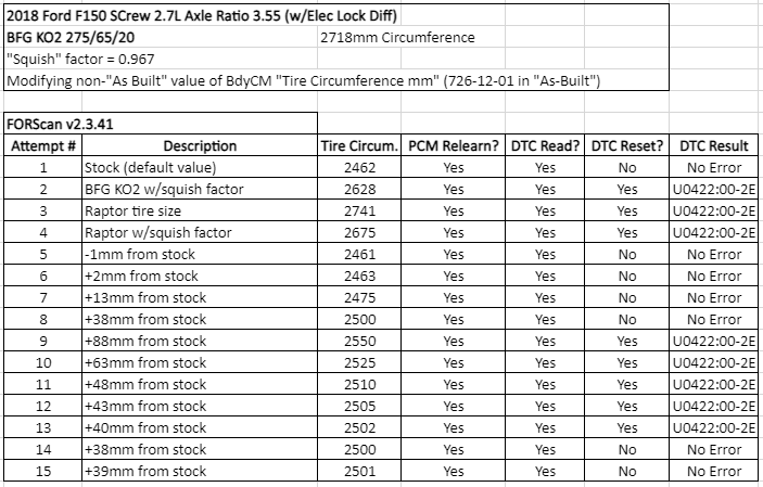

Just found this on the Forscan forum.
I do not know if any of these Tire Sizes match our Ranger (Forscan) Changes or not.
But it is interesting info: for those who have altered the Tire Size via Forscan
The poster of this was playing with the Tire Size changes to get rid of the code.
I personally am not bothered by the code but if I decide to play with Forscan or change my tire size again when my current tires are in need of changing I’ll look into this and see if the BCM is happy with certain sizes.
Here's my short story long...I replaced the 265/65/17 LT Hankooks with 265/70/17 Cooper Discoverer Road and Trail so naturally my speedometer was off. At 60 it was 1 mph off and between 1 and 2 mph at 70 not much but I couldn't let it go.
So I jumped down the Forescan well and adjusted the circumference. The original setting was 2360 and I had seen somewhere in all the threads on this that 2400 was good for the 265/70/17. I changed that and the speedo was right on but I got the dreaded U0422 error code. I tried the PCM relearn and no joy. I stumbled across this thread and with a difference of 39mm or less over the original setting there were no errors. First I tried 2399 but still the U0422. I dropped down to 2398 (38mm more than original) no U0422 but P160A popped up. I then did the PCM relearn and no error codes! In disbelief I cleared the codes and ran DTC again still no error codes. Took the truck for a drive and according to Waze the speedo is right on at 60 and 70 mph. Ran Forescan again when I got home and no errors!!!
Big thanks to @airline tech for finding this table. At least for me only going up 38mm from stock zeroed in the speedometer and eliminated the error codes. YMMV!
