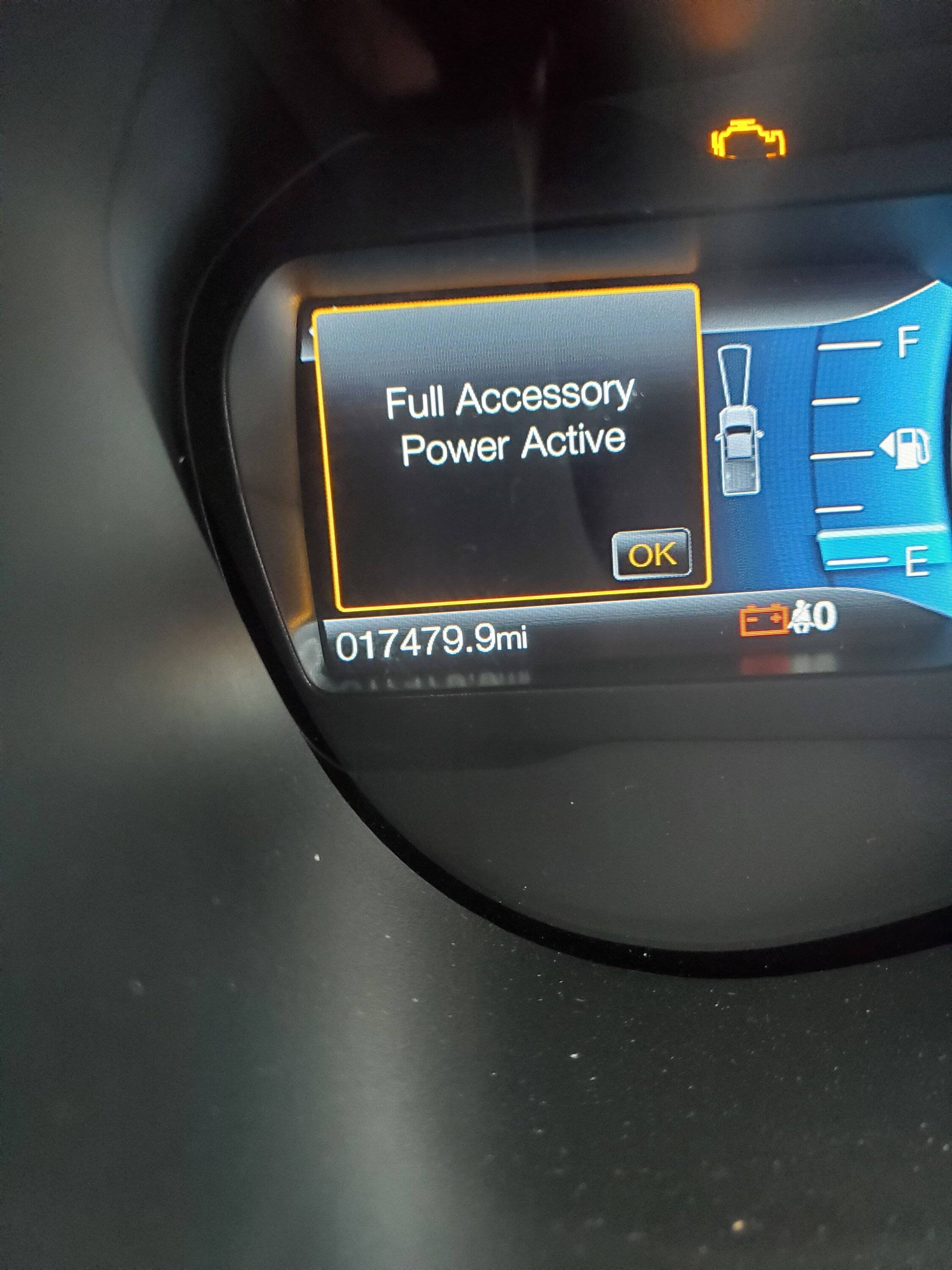

Hello everyone, I have a 2022 Ranger Lariat for a month now and twice it would not start. The lights and radio work but will not start when I push the button ( foot is on brake). The truck will start using remote start and will start again with button after. A window pops up and says full accessory. I am sure that I am doing something wrong but do not know what. Any help is appreciated. Thanks

Possibly but I do not think so because it starts strong and fast with remote and the windows meesage makes me think it is on accessory mode is on only.

It looks like it is because the accessory mode is on, to turn off just press button again without pushing the brake. Then start again as normal.

I get in truck to start normally with the push button, truck turns on when button is pushed but only goes into accessory mode and does not start. The only way to get it to start is to use remote start. After driving it it will start again like normal with the button.
