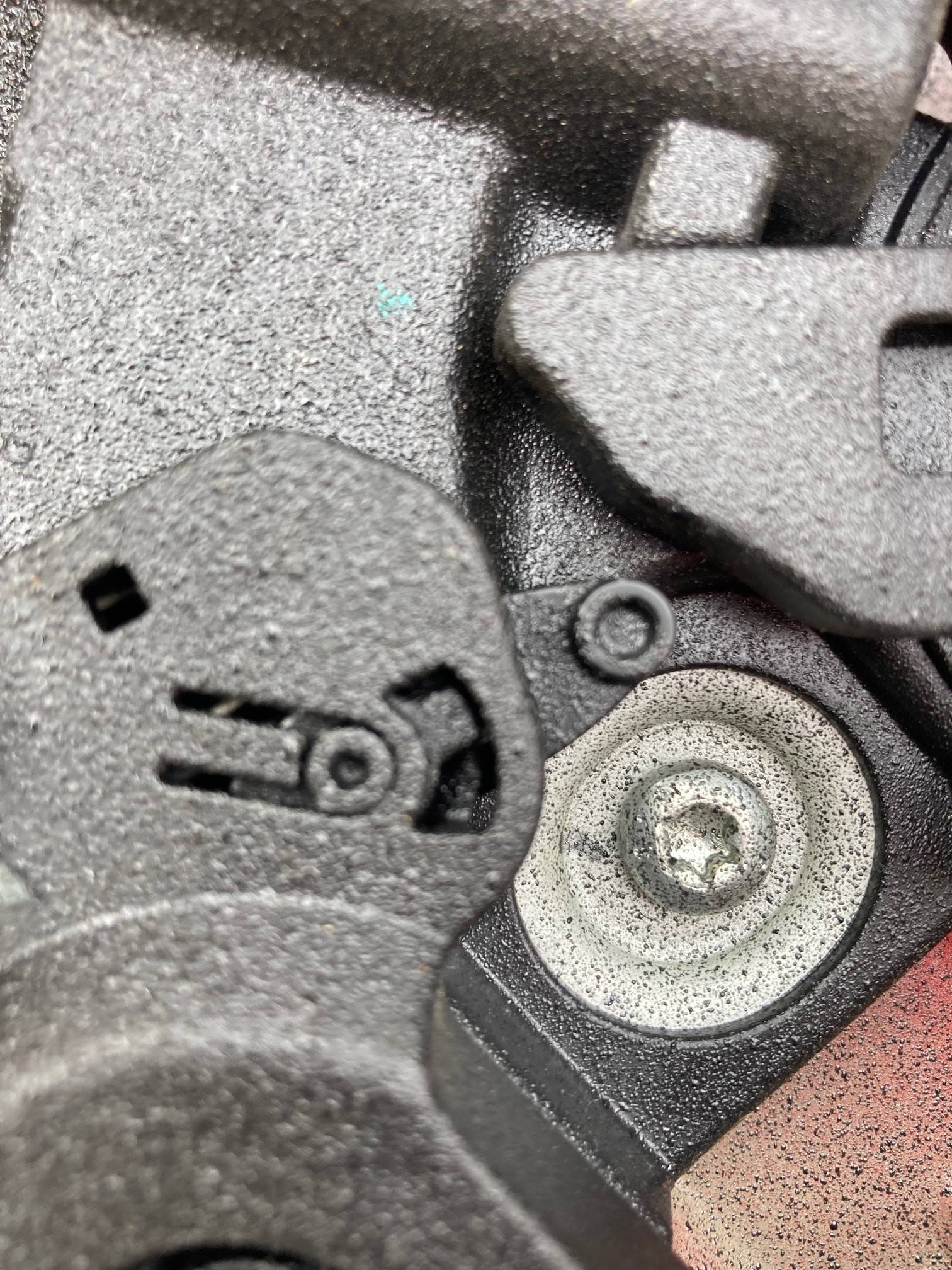

Will do Phil. I'm on the list to take it in anyway for the blower motor recall. Might as well have them check out the tailgate at the same time. To IdahoRanger's question I don't know how the latch/lock mechanism is designed on the Ranger. I'm hoping to find a parts schematic or such online to get a bit of an education for future reference. It is a fear that it will happen again at some very inconvenient time or location.

JeffB
Jeff
Aug 3, 2022
56
83
Kentucky
Muastang, Mazda 6
So what was the fix so others can know?
The half paper clip slot has a spring within it. That spring had popped off (scoop of dirt had been in bed of truck, possible a piece got in slots knocking it off) I was able to use a knife blade to slide in and put the spring back in place. That allowed the little round lever to the right to slide back to the proper place which allowed everything to unlatch properly.
JeffB
Jeff
Aug 3, 2022
56
83
Kentucky
Muastang, Mazda 6
sadly becoming an expert on this as it happened again. The issue is the locking mechanism. When you lock it the tab is pushed, when tailgate is unlocked the tab is supposed to go back to original position, but does not. Sad a little part causes so many issues. We took off tailgate cover and pushed the tab back, oiled it well and put everything back together. As of now it is working.
